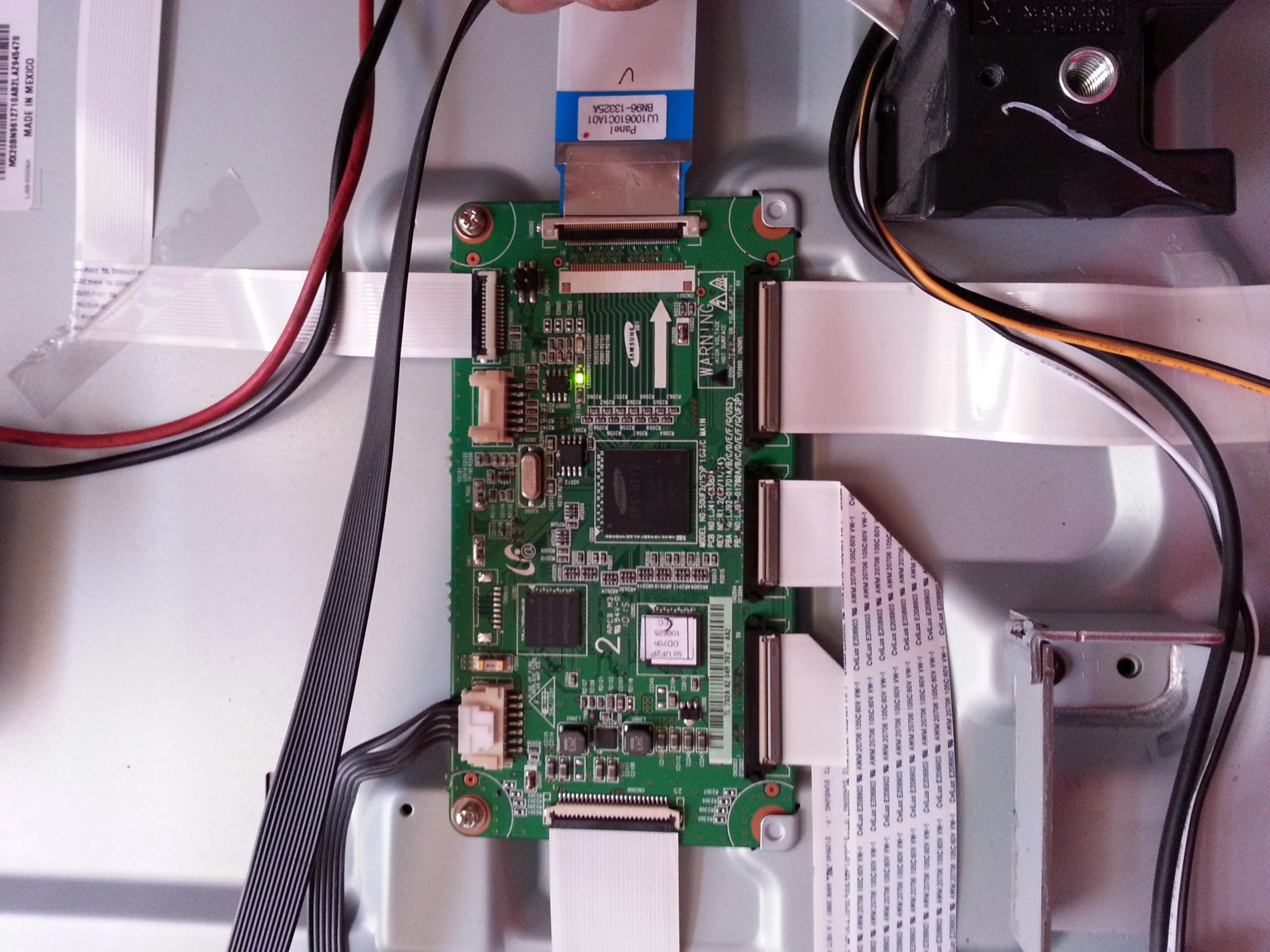

    Another thing I noticed is that there is 2 led's on the logic board
    Before I replaced the boards the led on the right would blink
    After I replaced the boards the led on the right would still blink
    After I reconnected the the ribbon cable from the logic board to the main board the right led turned off and now the left led is blinking not sure if this is relevant

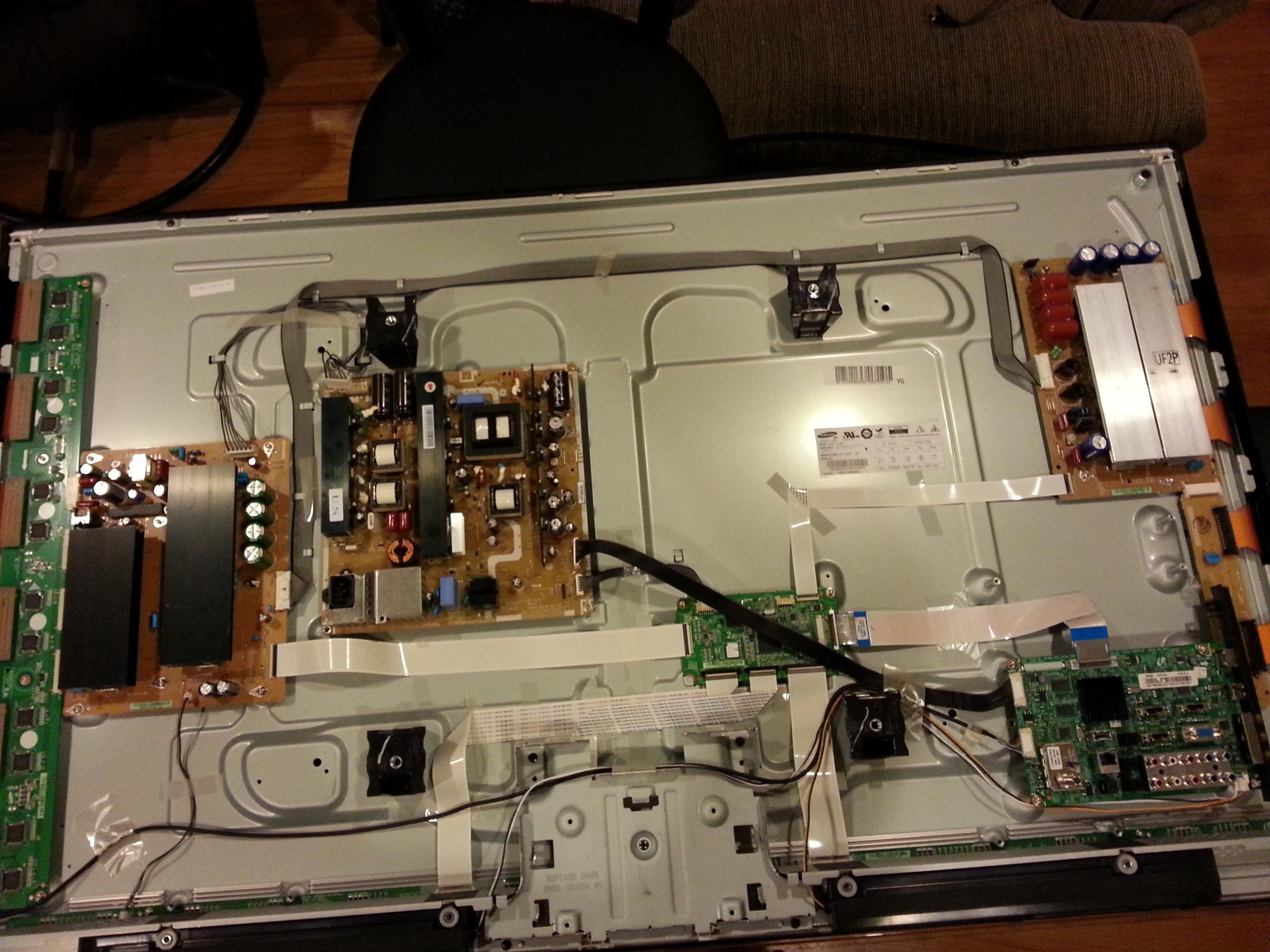

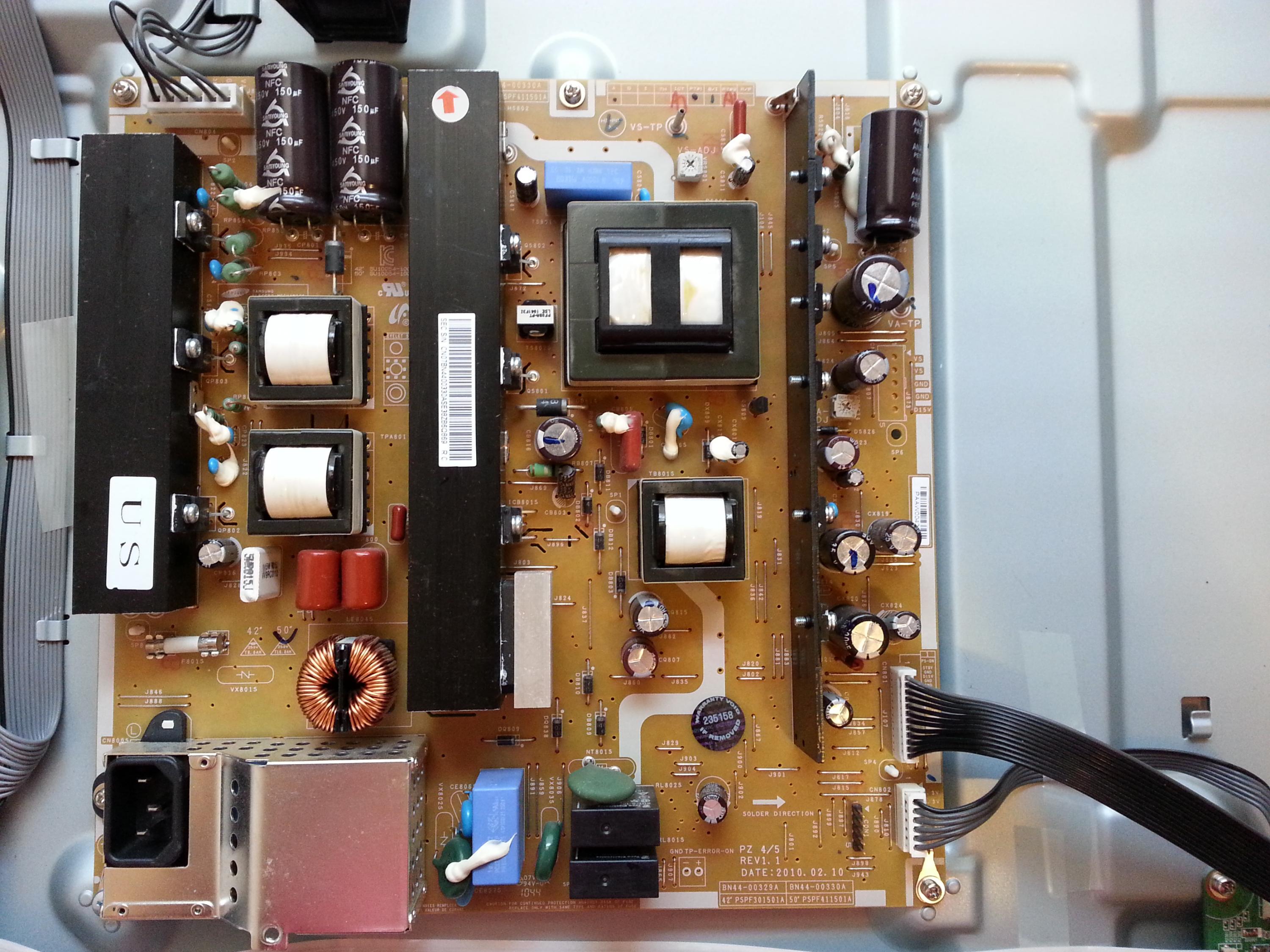

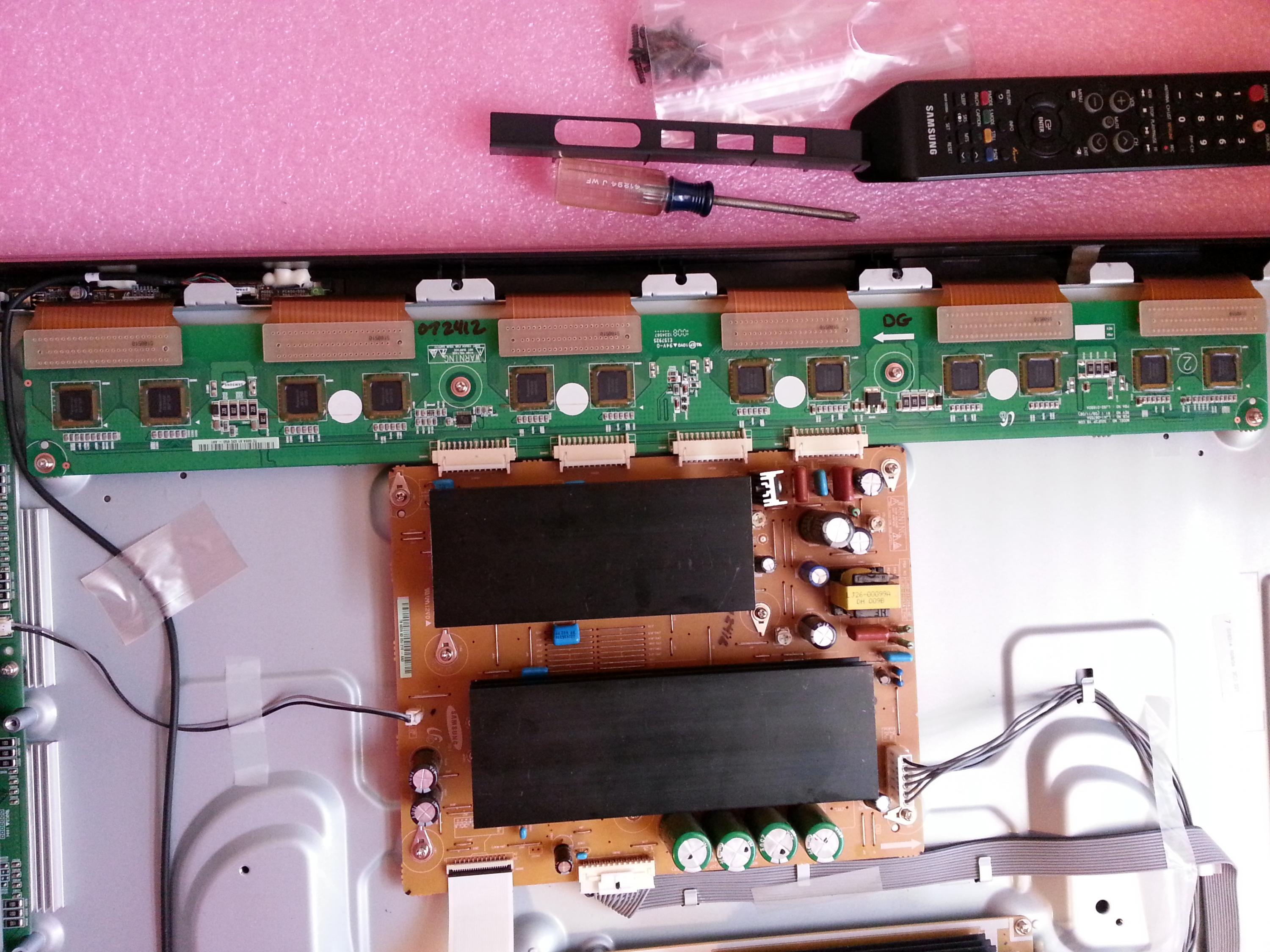

    Here are pics of the
    power supply
    Y main
    Y buffer
    X main and buffer
    Main board
    Logic board

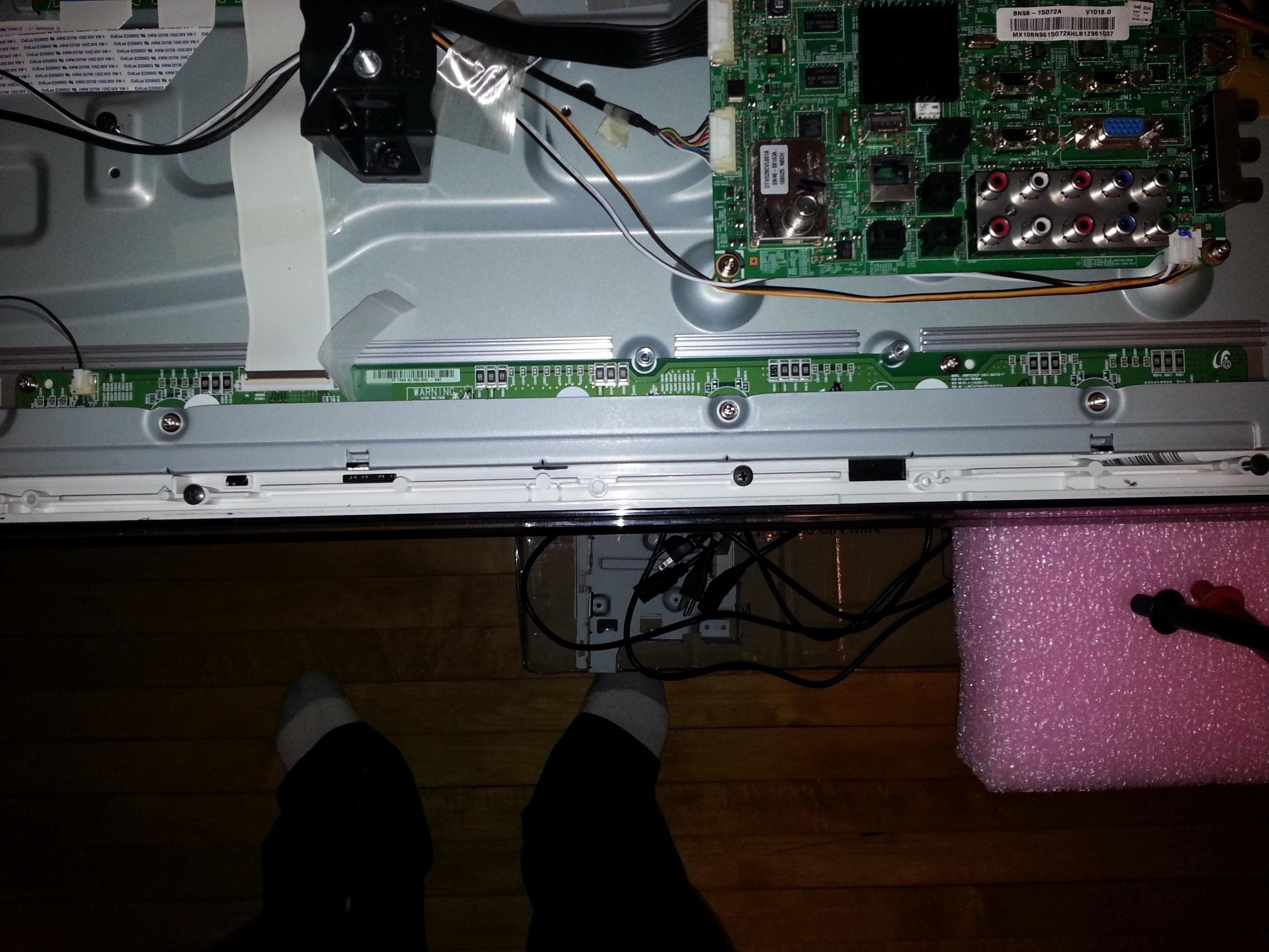

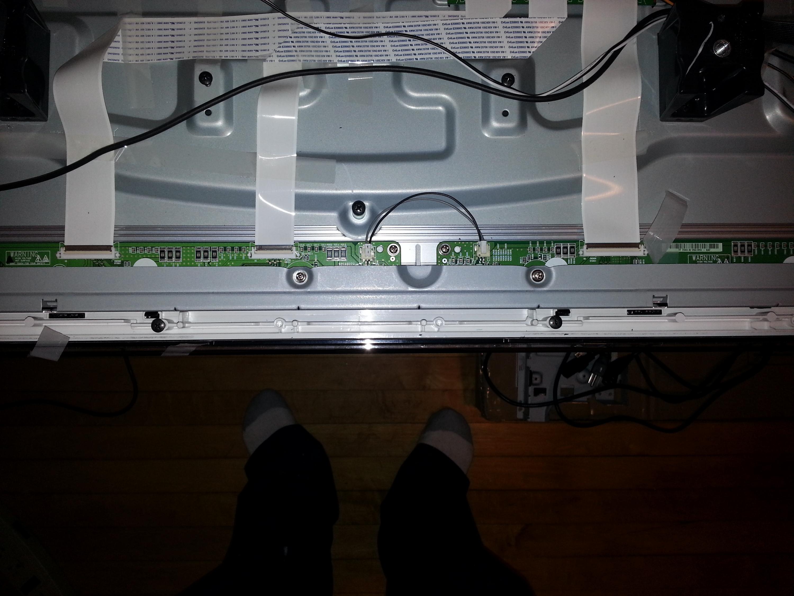

                    Yes, I have a hunch. Can I have a picture of the long thin boards that run along the bottom of the plasma panel? You may need to remove the speakers.
                    N.B. Do not disconnect any connections from these boards while the set still has power or you will FUBAR the plasma panel.
                      Re: no picture on my samsung 50 inch plasma
                      Here are the pics of logic buffer board E and F
                      I also tested the fuse that is on the buffer board E and it is not blown

                                        OK, show me how you set up the test patterns, because if that does not work you probably have a control board issue.
