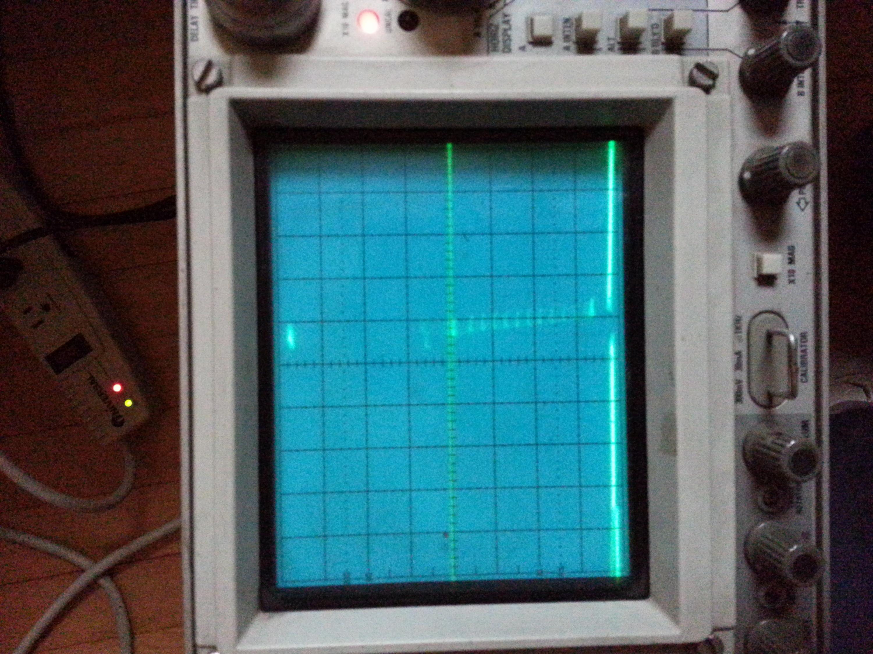

            Re: no picture on my samsung 50 inch plasma

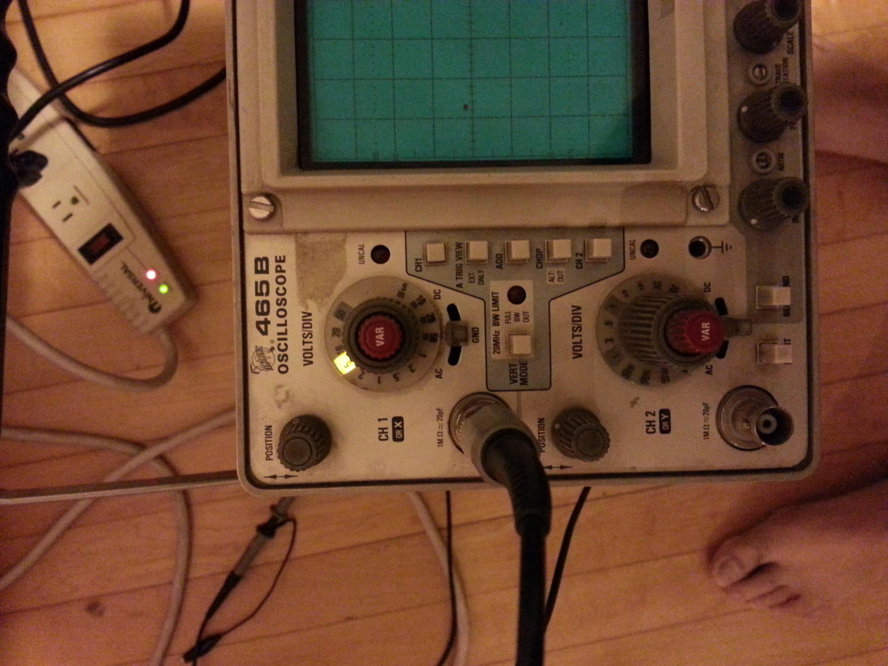

            Tom the knob will only let me select 5v even though it has 10, 20, 50v but it will not turn any further for some reason
            Also when I push the ch1 button should it stay down or up
            When the ch1 button is pushed down the 5v is illuminated see pic
            When the ch1 button is pushed and stays up the 5v illumination goes off and the green line shows up on the display see pic
              #46
              Tom I figured out that the ch1 button should be pressed down
              And I positioned the trace line to 0v
              But I still can not select 10v only 5v
              Can I still test it on 5v?

                You can test for now on 5V. Do you have a horizontal line? CH1 should be depressed, if that switches CH1 on (there may be a label nearby telling you what it should be for ON but it's usually depressed for ON.)
                Perhaps there is a 10X button somewhere on the scope which allows the selection of the other ranges.

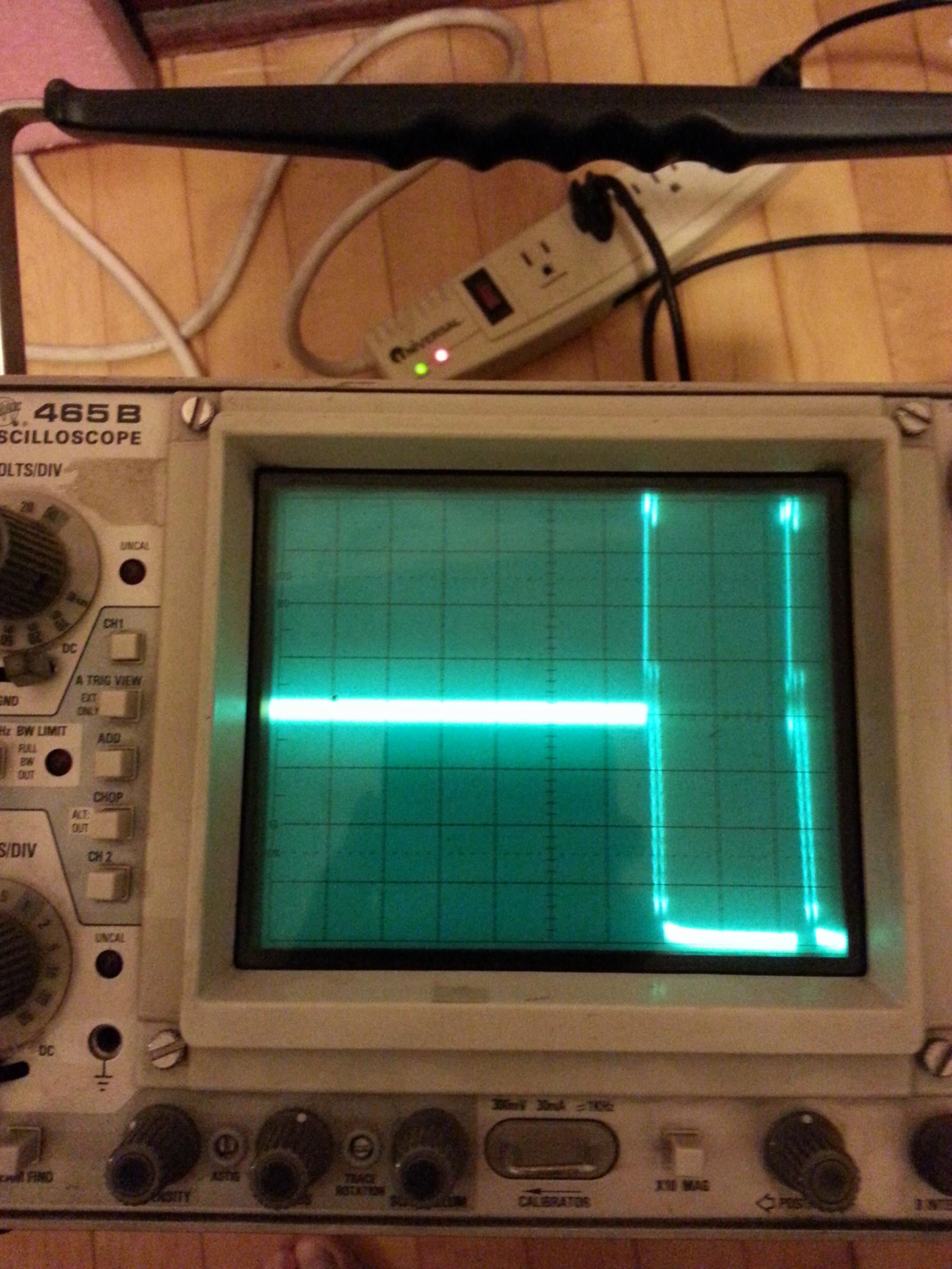

                  there is an "X10MAG" button but not sure if this is what you mean.
                  you can see this button in the center of the scope at the bottom of the display

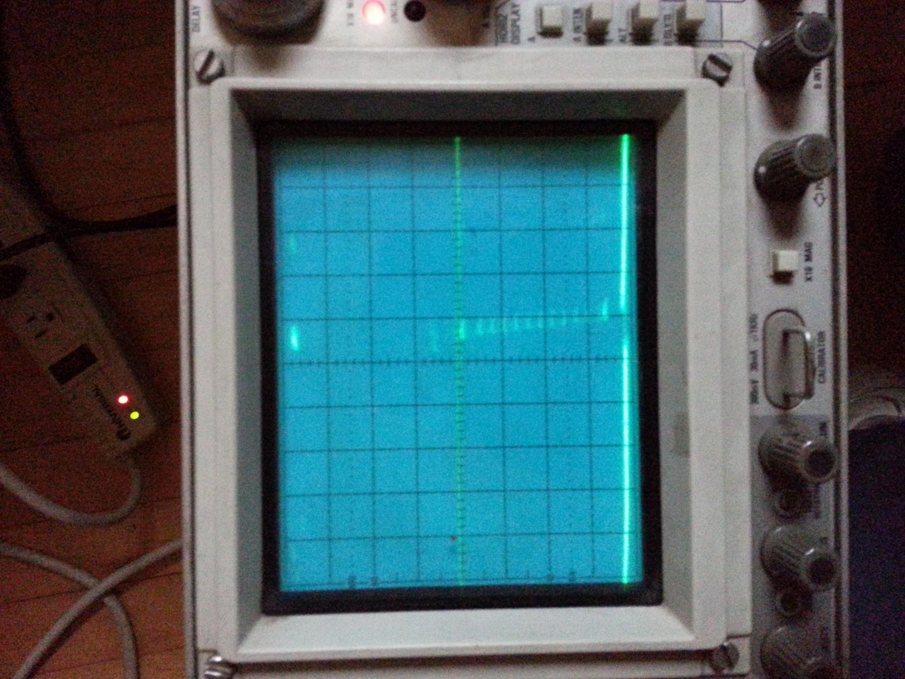

                  i went ahead and tested on on 5v yesterday
                  i followed your step by step process
                  i took several pics of the waveform when i turned on the tv
                  please excuse the barefoot in the pics lol

                    Try with X10MAG off?
                    Also, turn the FOCUS control to make the display sharper (easier with no signal input or GND position.)

                            Right now the waveform looks almost right, but it's not quite right... Just need sharper, also perhaps try at 10ms/div for the TIMEBASE?

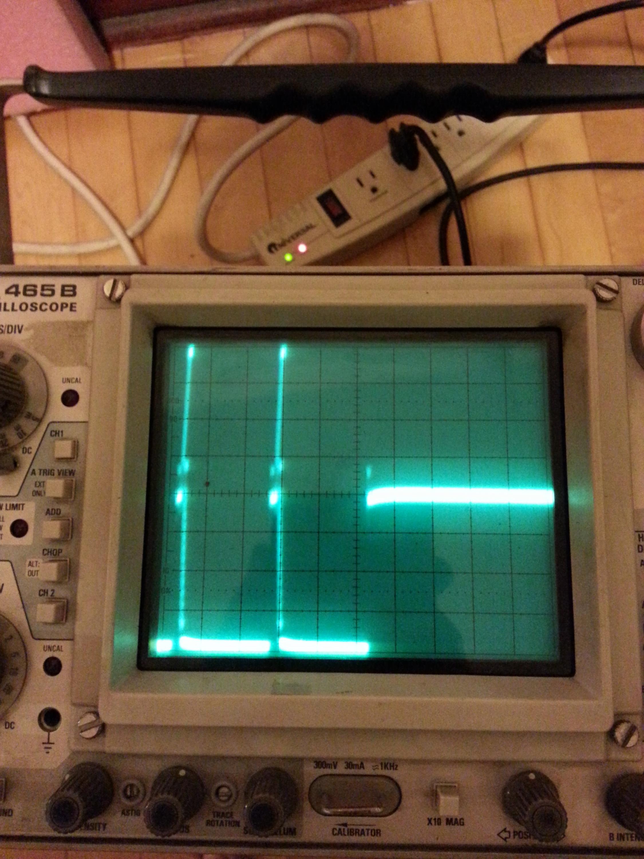

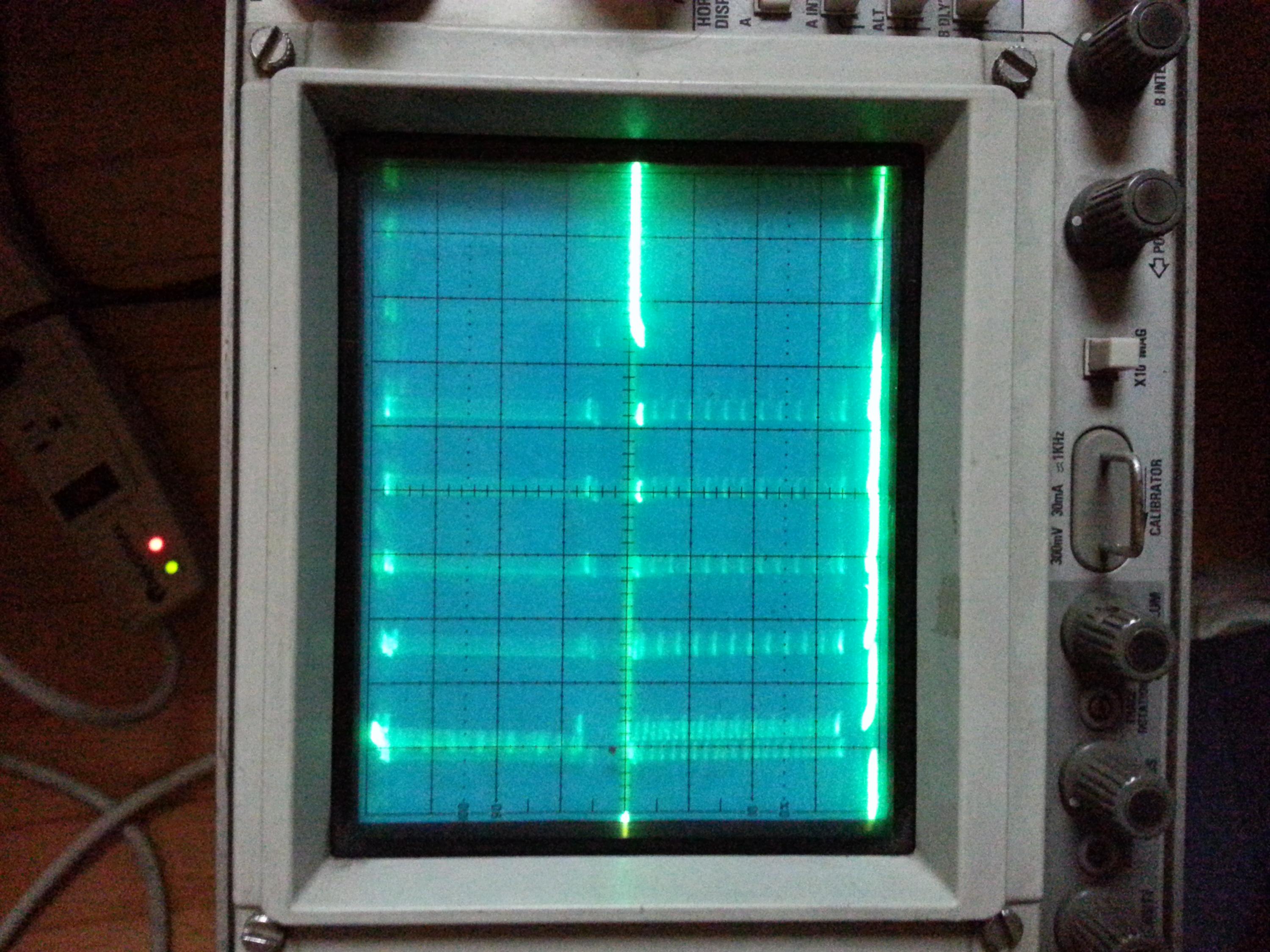

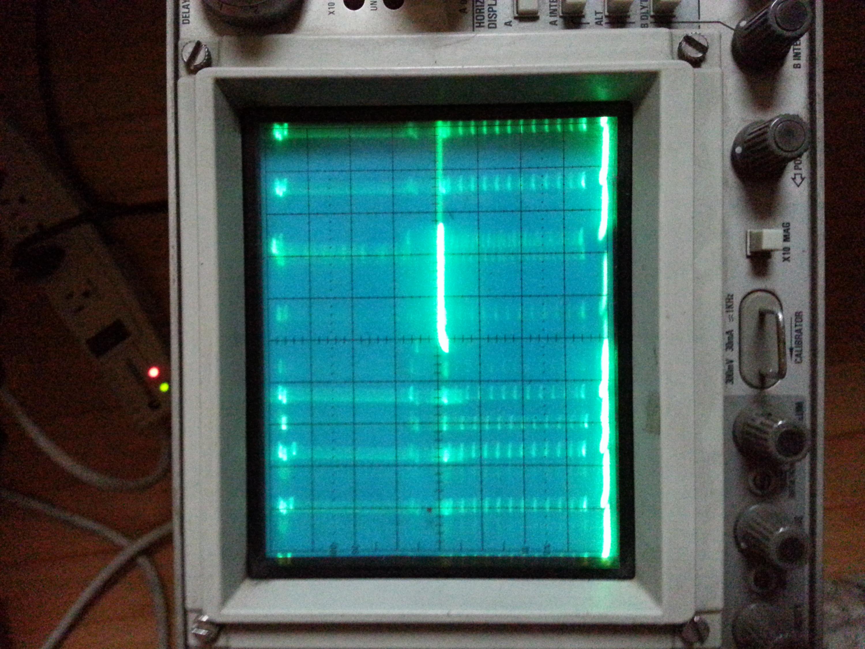

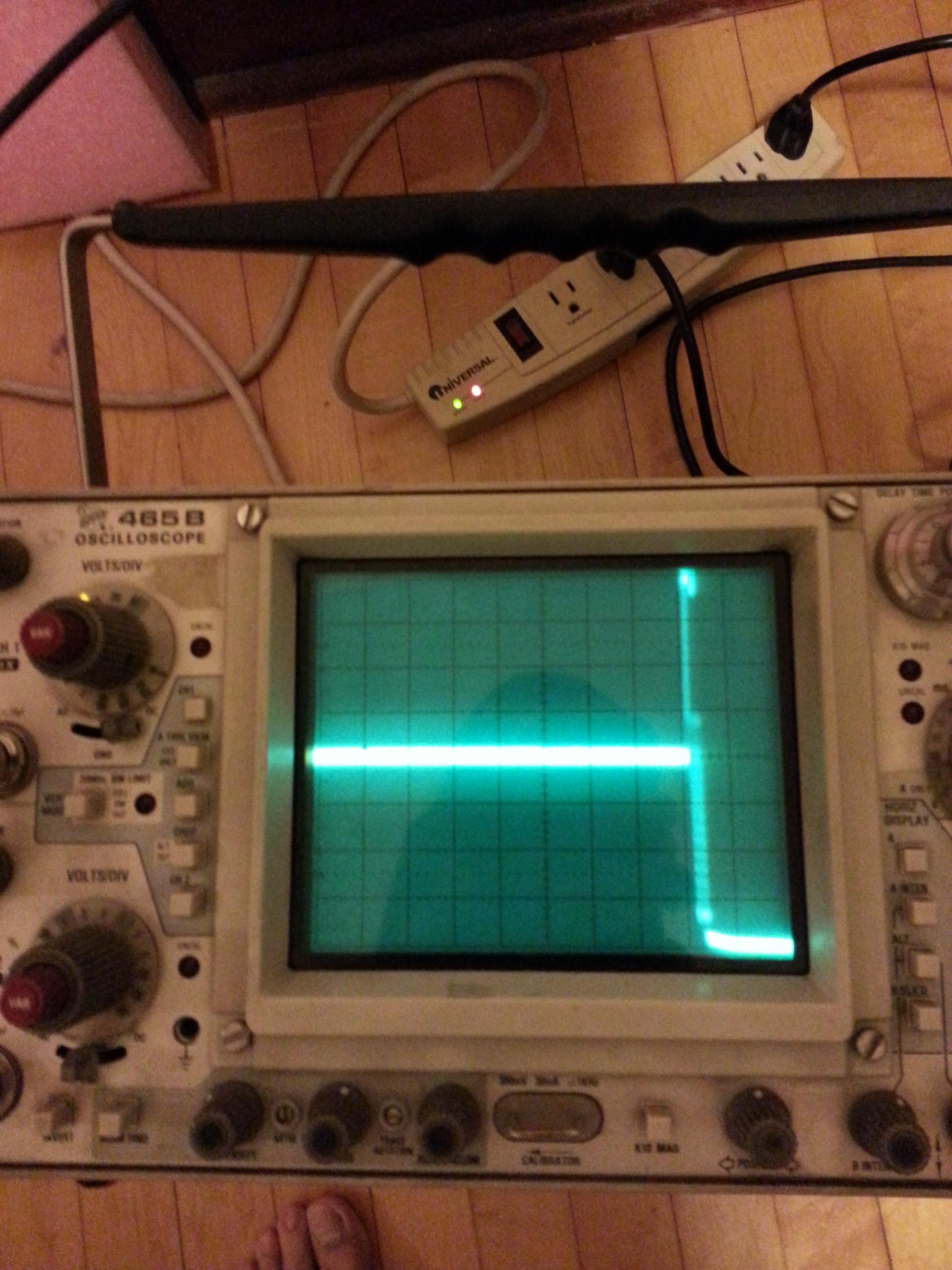

                                Tom I tested the tv at 10ms like you instructed and I focused it as sharp as possible with x10mag off
                                Here are the pics
                                Also the tv started to flicker as you can see in the pics
                                It goes to steady waveform then kind of erratic
                                Sorry about the angke of the pics I uploaded from my phone
                                I wish I could upload a video directly to this site

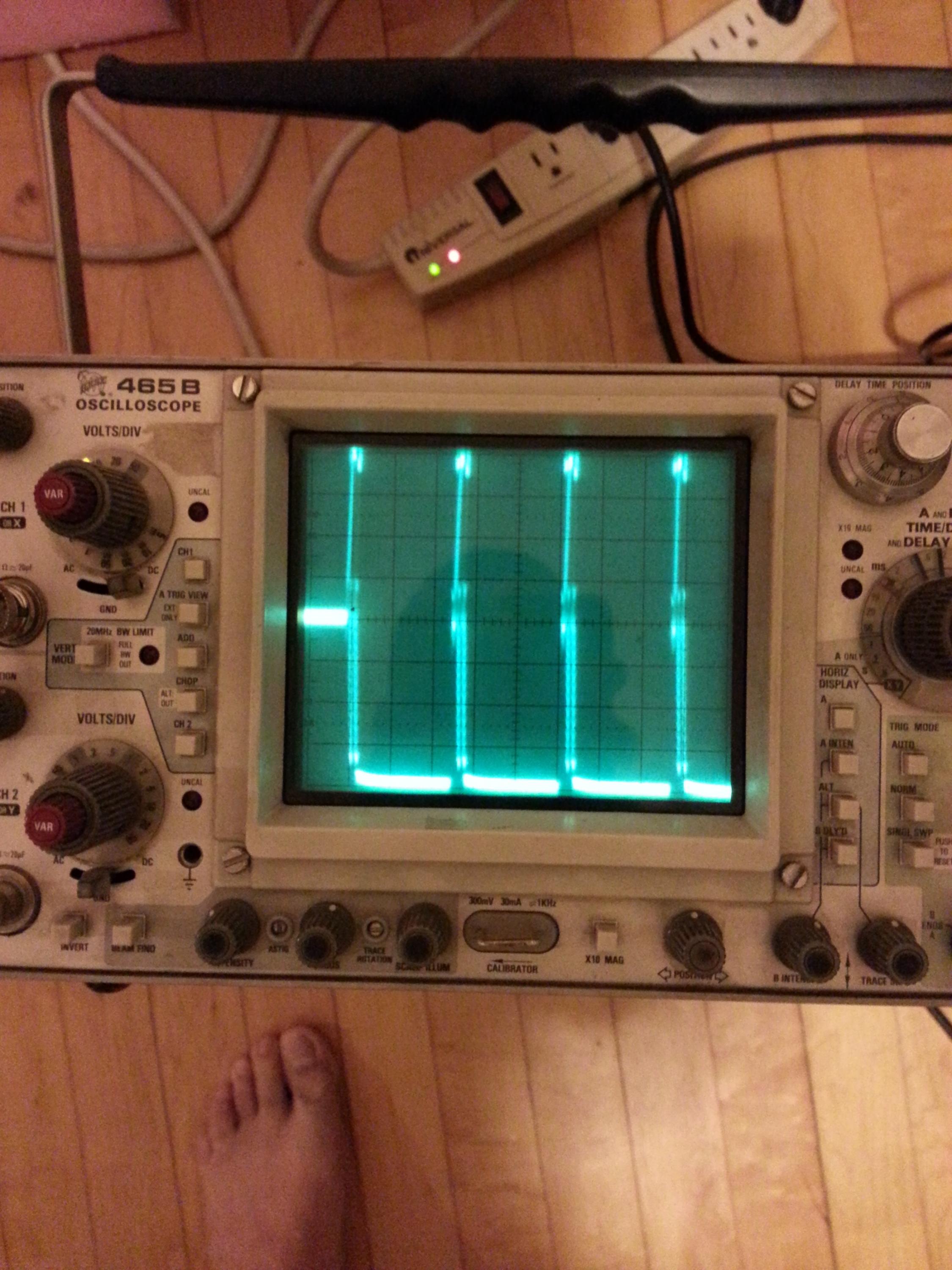

                                  Here are pics with x10mag on

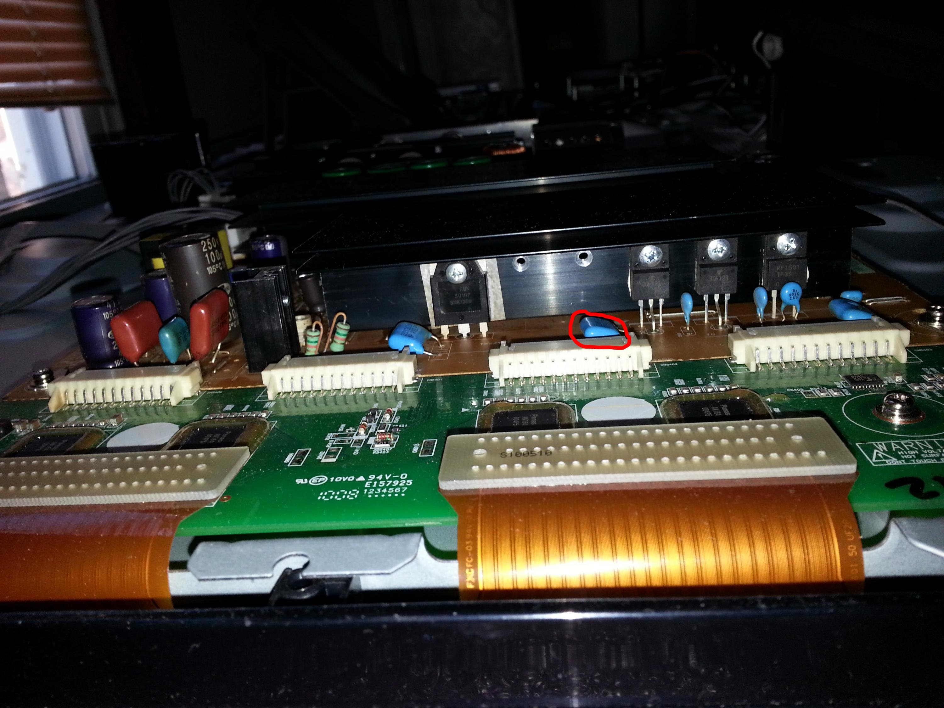

                                    Looking at your picture there I notice you say you had .00v at either side of the marked fuse? Can you clarify there is no voltage there (should be VA when the panel is on). If it is 0V with the panel on remove the connector (circled) and check resistance to ground. You can also see if you get the same effect powering up with this connector removed, and test for VA on the wire with it disconnected. Illumination from the panel suggests that the sustains are working to some degree. Missing VA at that connector would give you this problem, as would a CTRL fault as either way there will be no data going to the address lines.
                                      #58
                                      Tom I tested the fuse at both ends with the tv powered on and I got 0v
                                      I tested one end of the fuse with the positive lead and the negative lead to ground and I got 2.7v
                                      I disconnected the connector on the E buffer board as you circled in the pic with the tv powered on and the panel stayed illuminated and I got 54v for Va
                                      While the E buffer was disconnected I mistakenly tested the Vsc test point on the y main and it caused this board to shut down and the panel shut off as well
                                      I got scared for a moment thought I blew something but I didnt I powered off and reconnected the E buffer and everything is back as usual
