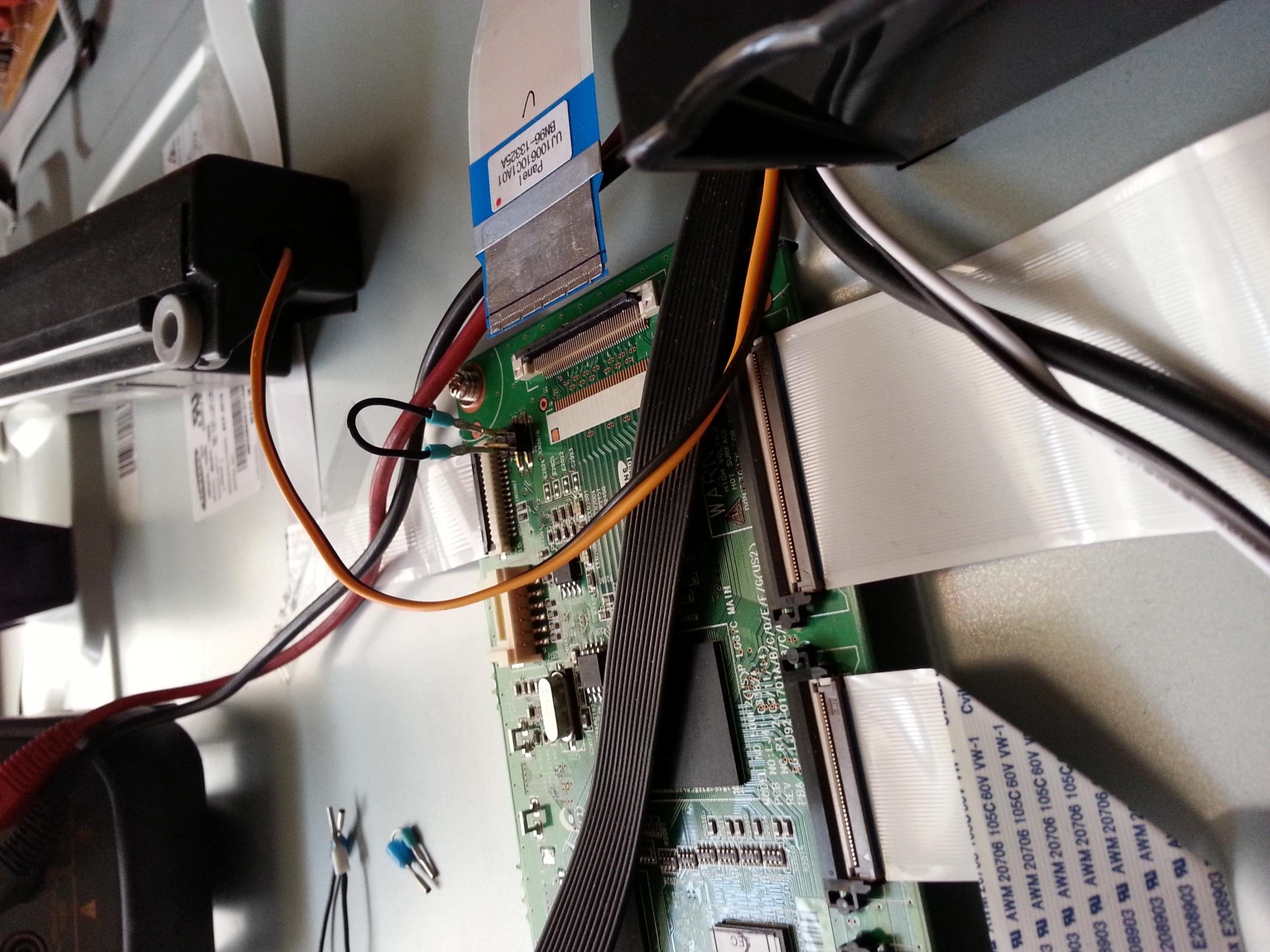

no picture on my samsung 50 inch plasma

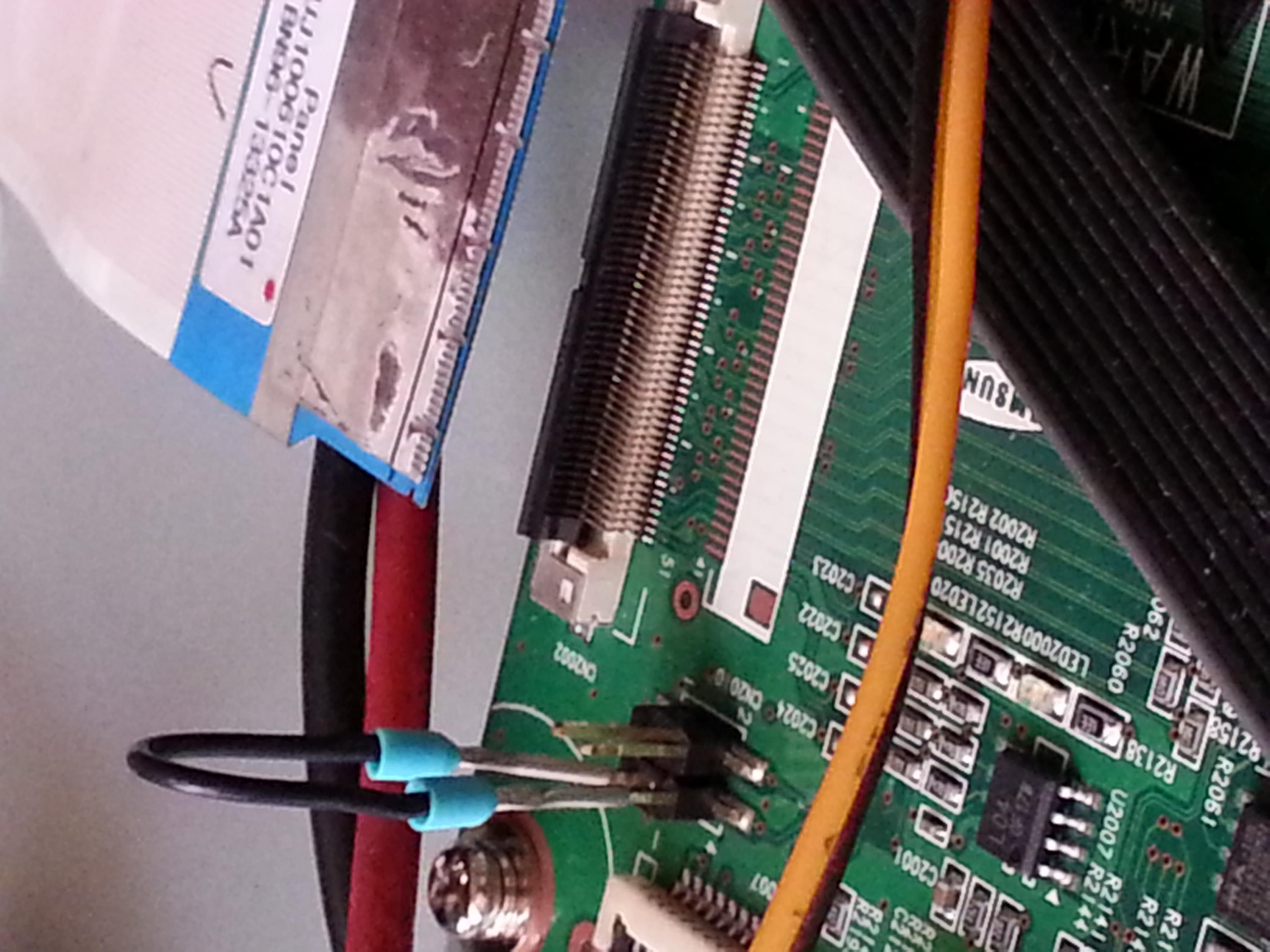

    When I get home from work I will take a picture of the jumpered 4pin connector and the disconnected cable
    • jose6326
      • May 2013
      • 707
      Re: no picture on my samsung 50 inch plasma
      Here are the pics
      I jumpered number 3 and 4 on the 4pin connector and disconnected the cable from the main board
        Well, I can't see anything wrong there. I'd consider a control board fault in this instance then.
            And again I did NOT get any test pattern

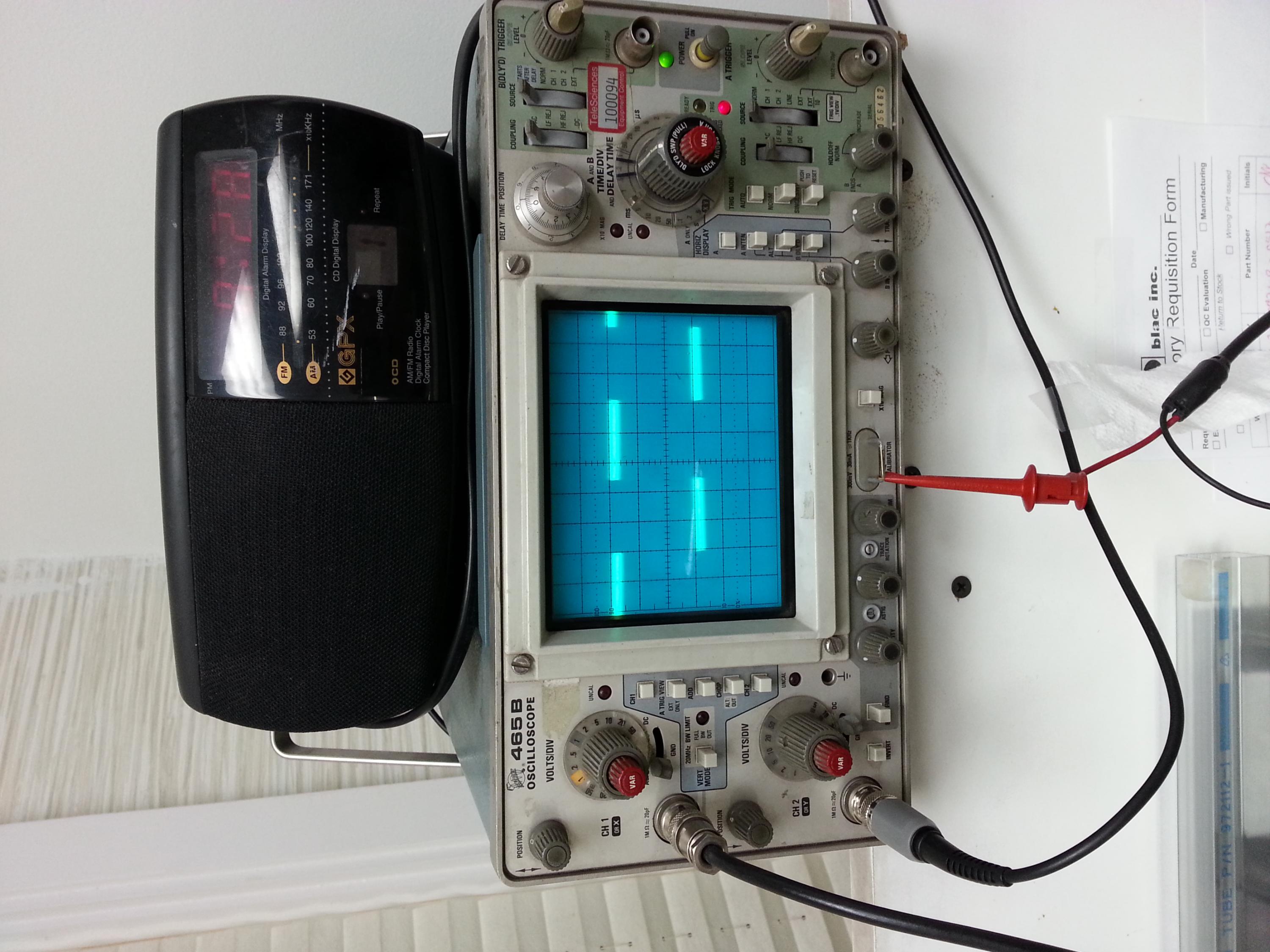

                      The only thing that can diagnose this is an oscilloscope, any chance you have one or can beg/borrow/steal one?
                        There is one at my job I may be able to borrow
                        But I dont remember how to use it
                          #32
                          I will be able to help you set it up if you can provide detailed pictures and follow instructions to the letter.

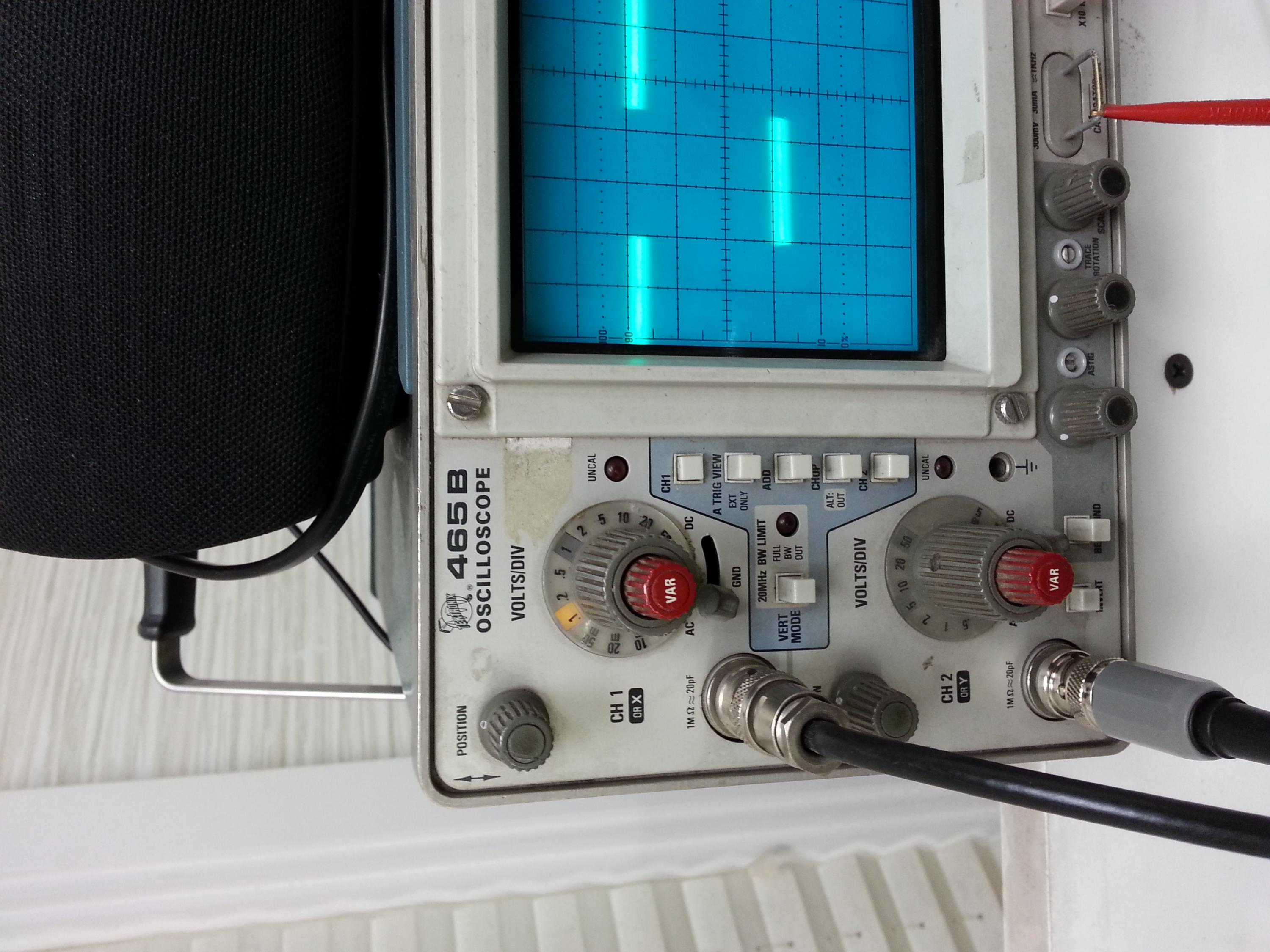

                              Here is the pic of the o scope
                              The "electronics guy" says it can only measure as high as 5v times 8 divisions and
                              5v peak to peak
                              Hope this makes sense
                                #35

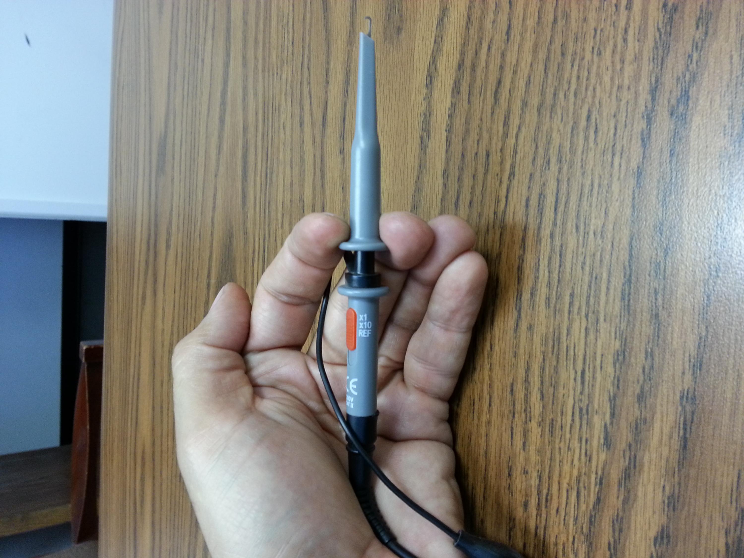

                                That scope will be fine, did you get an actual scope probe with it (with a tip and ground lead) and does your probe have a 1X/10X setting?
                                • jose6326
                                  • May 2013
                                  • 707
                                  #36
                                  Yes probe has 1x 10x settings

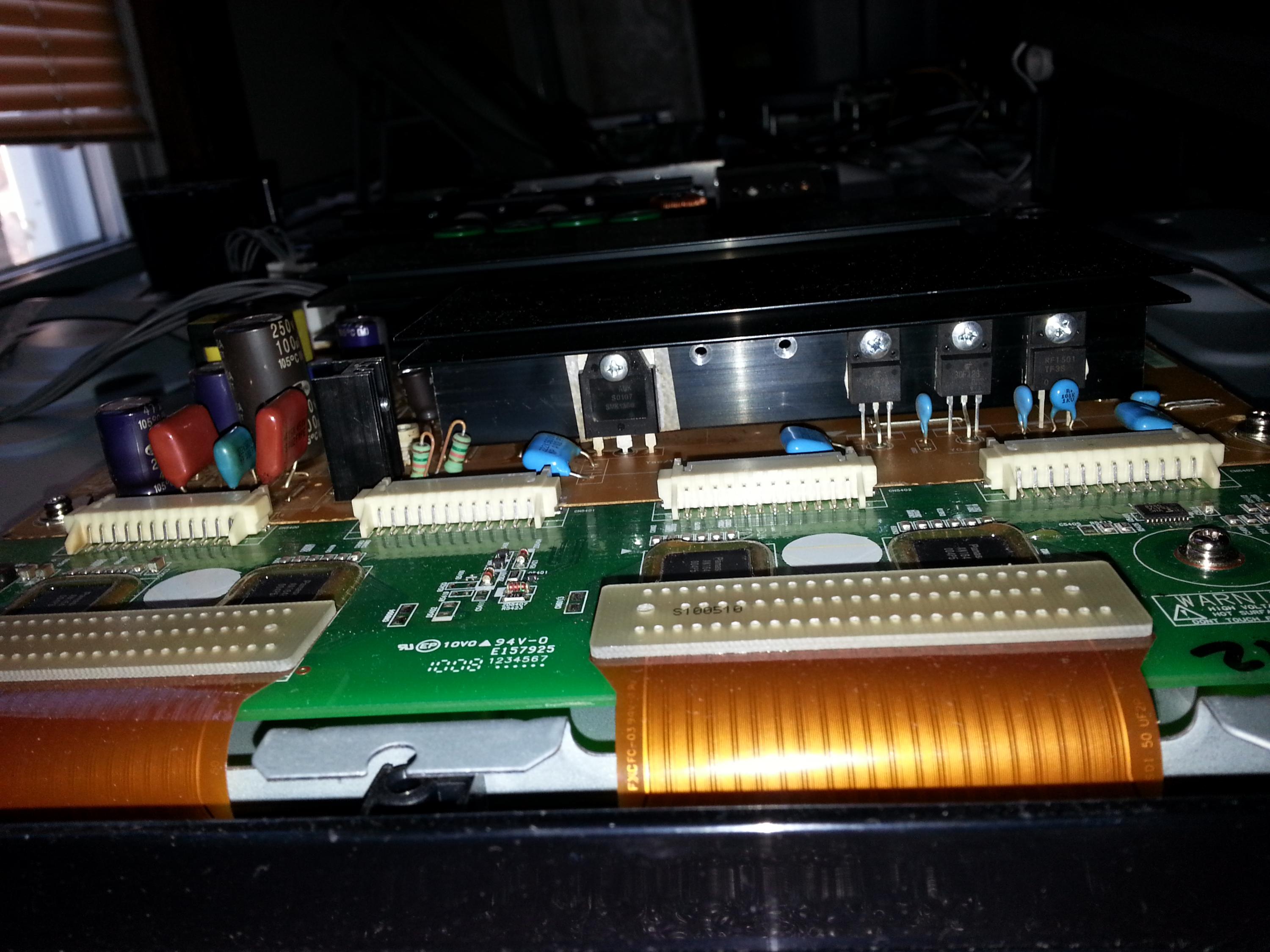

                                    On this board:
                                    https://www.badcaps.net/forum/attach...1&d=1369514611
                                    ...do you think you could take a picture from the left hand side so I can see partly under the heatsink?

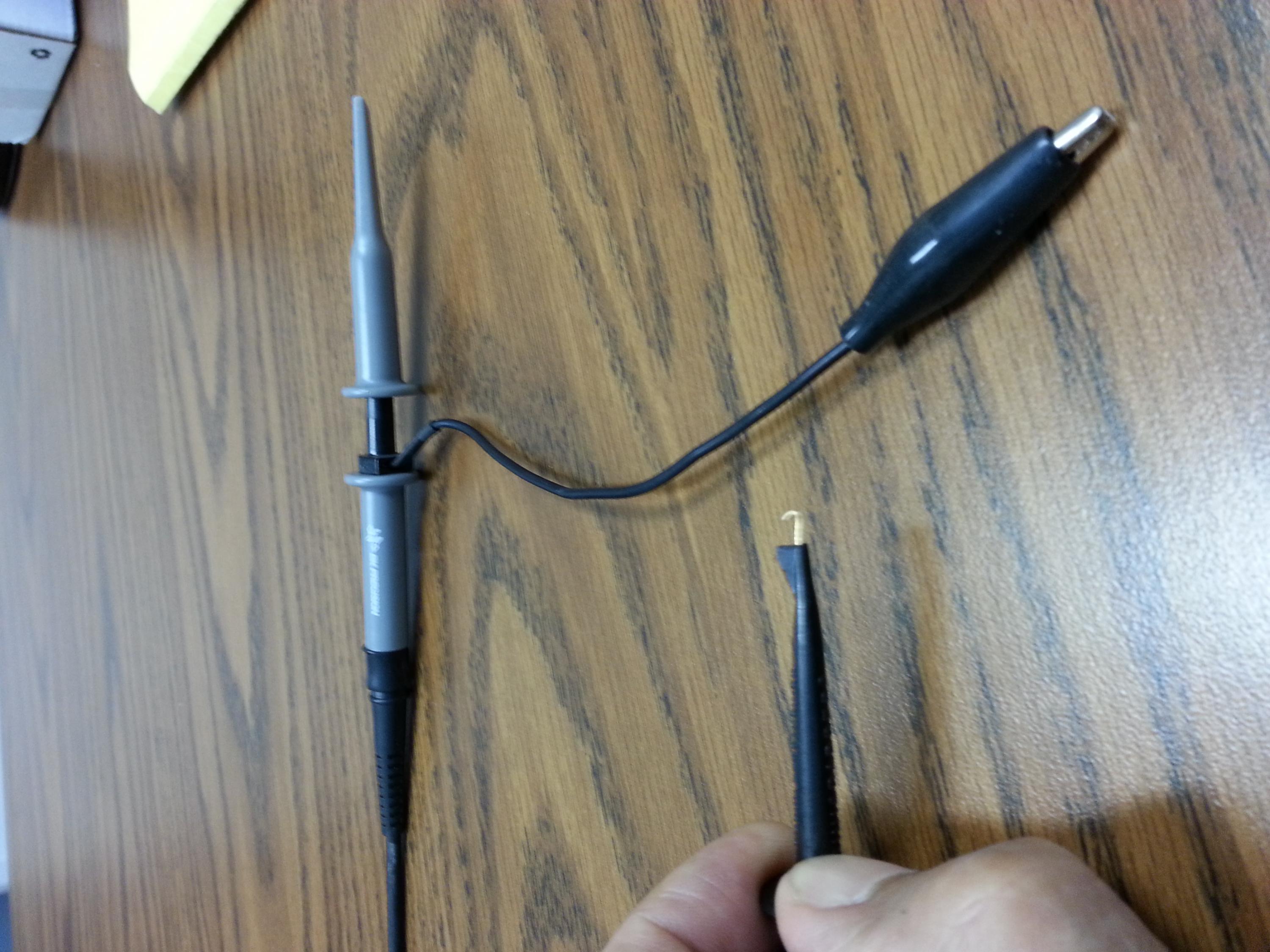

                                        Here is a pic of the probes

                                          #40
                                          Here is the pic if the left side of the y main
