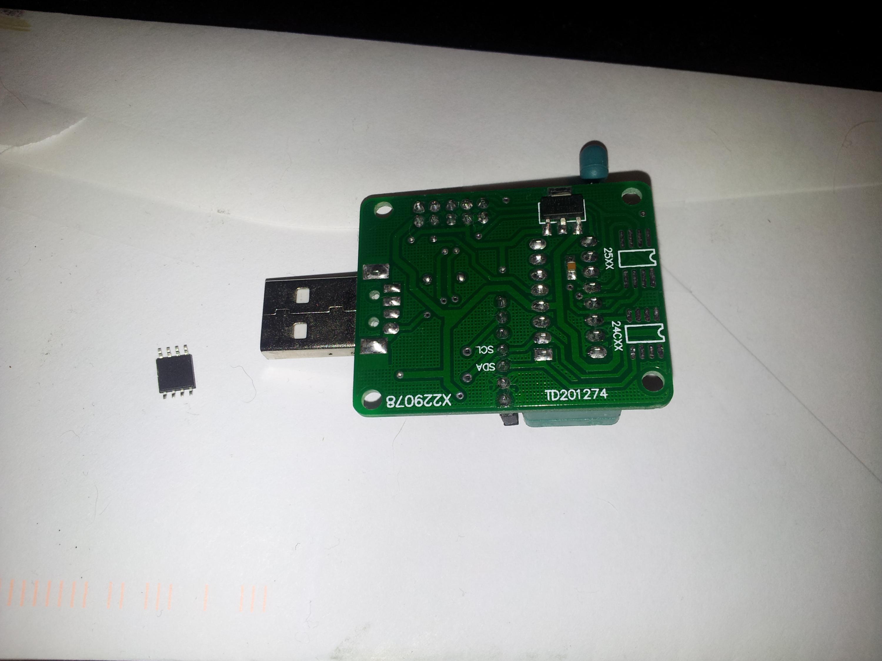

                            Re: Sony CECH-ZED1U Playstation 3D LED TV - Two Red Flash
                            I have the 6408 chips, not the 6406; I was shipped the wrong ones. Anybody have any idea whether the 640*8* can be made to work? I haven't been able to, but this is the first time I've tried to do this sort of thing. The software I am using to program the chip is CH341A. The "detect" button seems to work, although it lists things like Mfg as "other" or "unknown". The "Blank" function does in fact say that it is blank.
                            Past that, there seem to be problems. First, when I try to open the BIN file a popup says, "File length, beyond range of will be ignored." I can't get CH341A to write to the chip either. It trys to work for a while and then a popup says, "Write operations timeout failed!" I have tried the autoprogam button and the "program" button.
                            • R_J
                              • Jun 2012
                              • 9588
                              #254
                              What eeprom programer are you using? you can just ignore the file length error, I did and it programed fine. Make sure the chip is in the correct way.

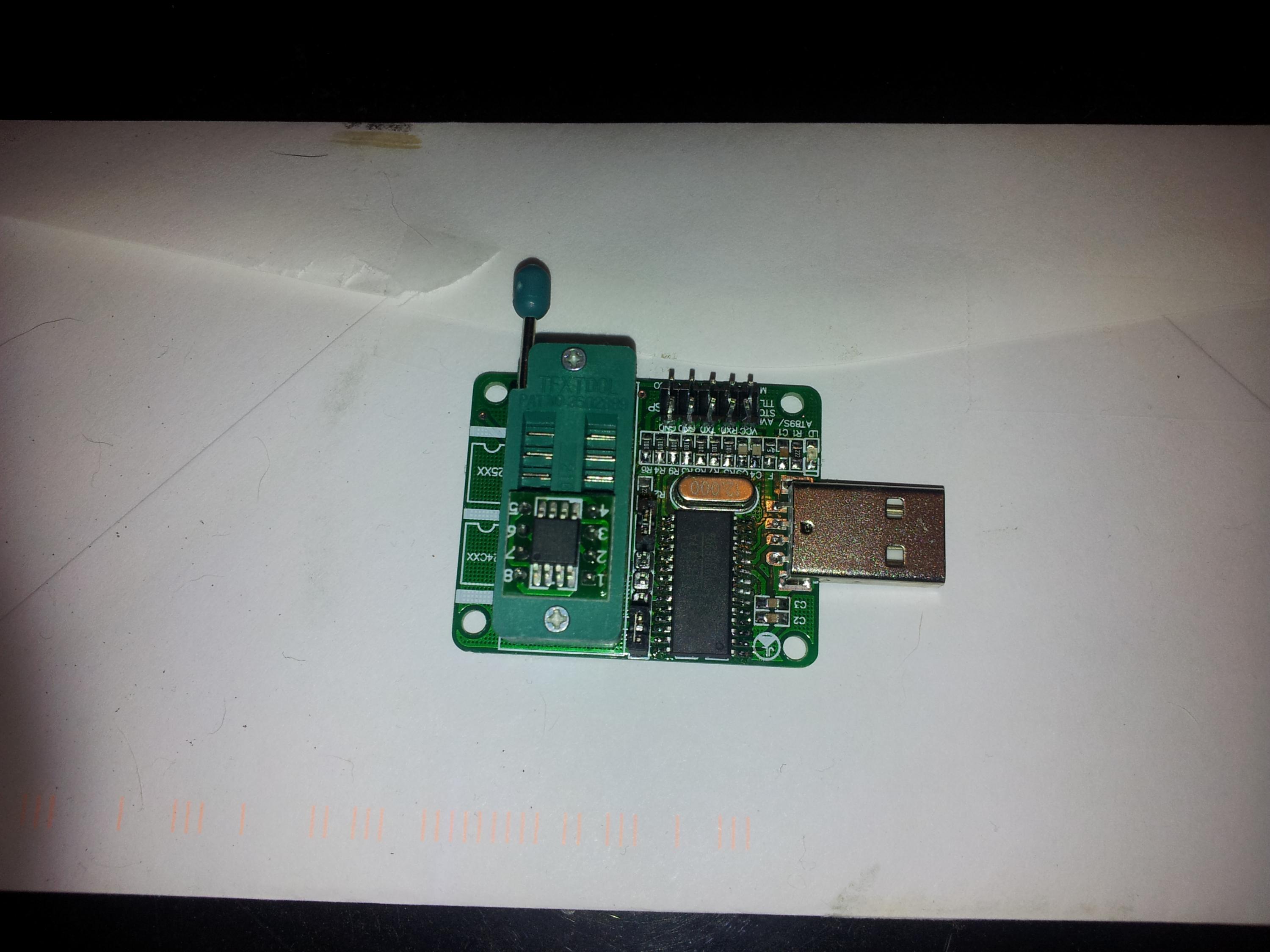

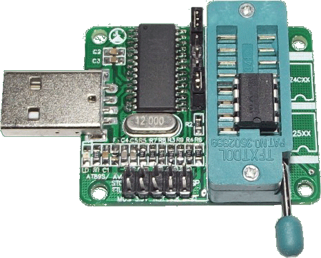

                                • R_J
                                  • Jun 2012
                                  • 9588
                                  #256
                                  It needs to be placed in the other half of the socket with pin one where the zif handle is.
                                  go by the [25xx] labeled on the pc board
                                  Where you have the chip now is in the wrong part of the zif socket
                                  Your socketed chip needs to be in this position (see picture) note pin one near lever.
