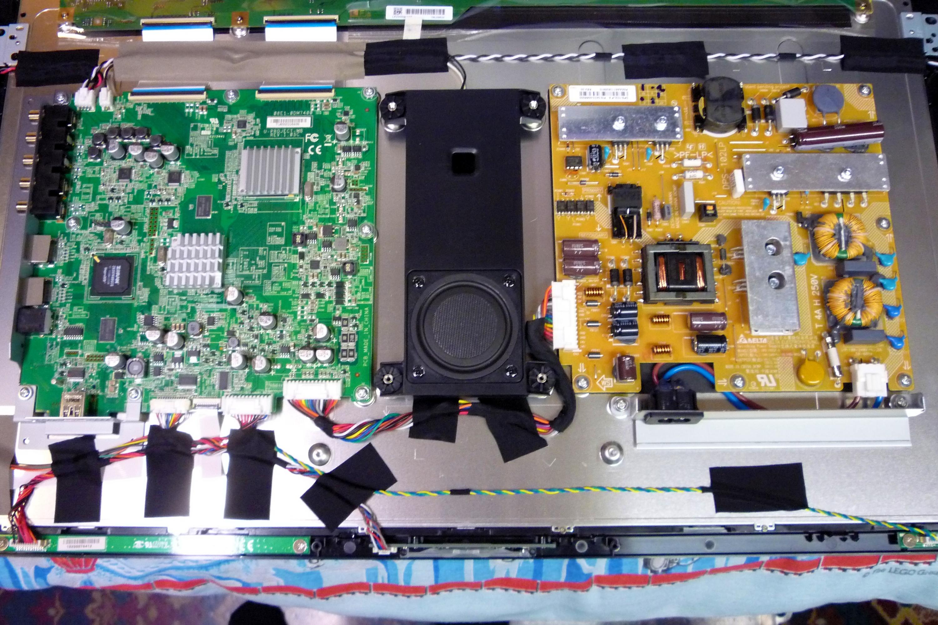

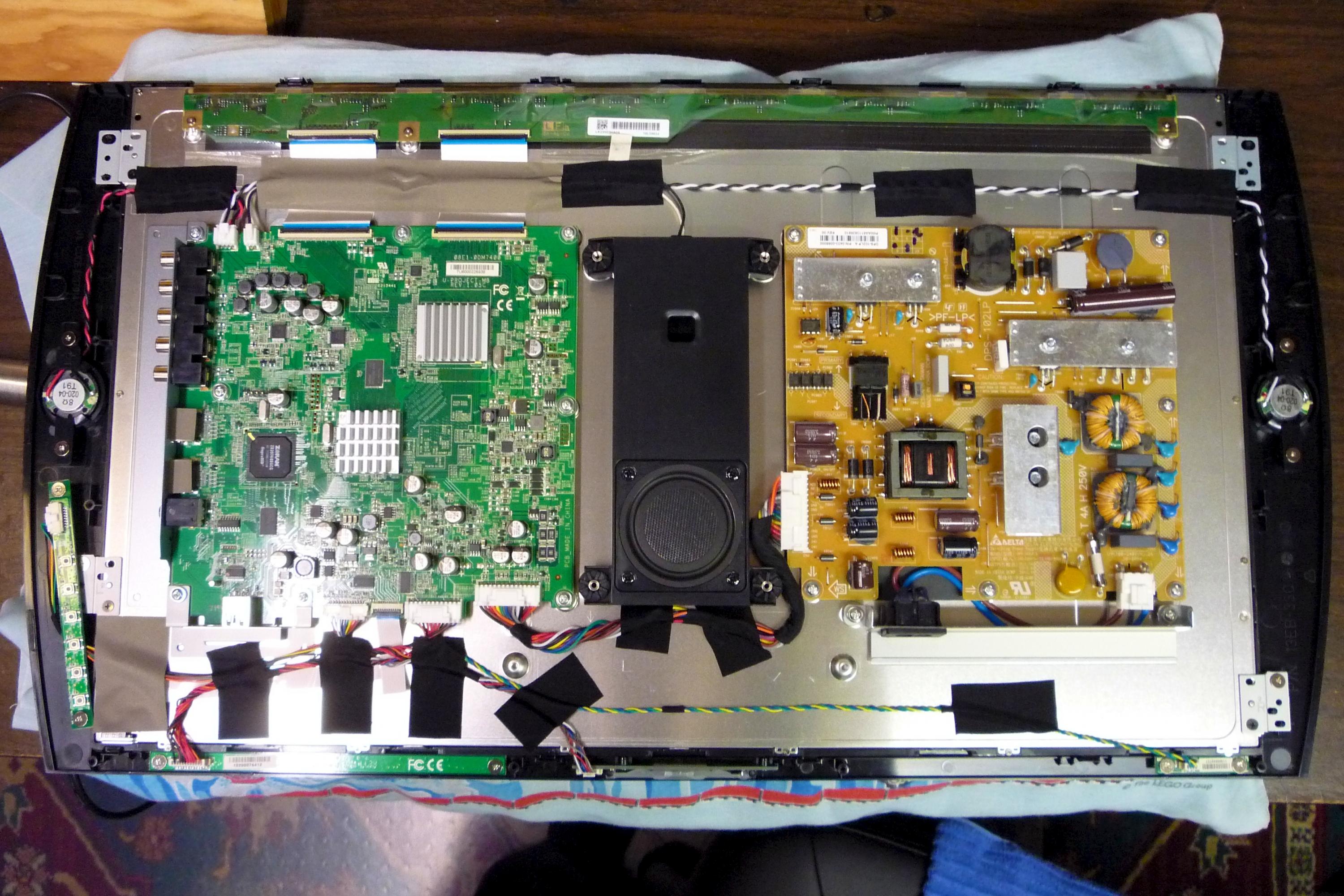

    I recently got a Sony CECH-ZED1U Playstation 3D LED TV off a guy who was very disgruntled with Sony not honoring the warranty. This display is almost new, no dust inside or anything. It has what is apparently a very common problem with these displays and when you power it on the screen never comes on and the indicator comes on blue, then green, and finally flashes red twice, a pause, red twice, a pause and on and on until you shut it off.
    I found many people complaining about their TV failing the same way, including many lengthy discussion threads on the official Playstation forums, but nobody seems to have any idea what the actual cause of the problem is or how to go about repairing it. One person reported replacing the power supply with an ebay one and having no change in the symptoms. The two blink pattern must be a code but I haven't been able to find any service literature to define what it means.
    I opened it up and checked out the power supply (which doesn't have any inverter because it's an LED backlight.) It looks to be of surprisingly decent quality and the the +5, +12, and +24 outputs are all working ok.
    I attached some quick pictures, everything looks ok and I don't see any burned spots on the boards. I don't have a scope but I do have a good Fluke DMM and I'm not terrible at soldering SMT components. This display would be quite nice if I could get it going.

    Can we see a picture of the whole chassis -- looks to be more than one main board?

      Re: Sony CECH-ZED1U Playstation 3D LED TV - Two Red Flash
      The first pic is pretty much everything that's there except the ancillary things like the speakers and buttons. The top board is part of the LCD and is directly attached to the ribbons coming out of the panel. I attached a more zoomed out pic.

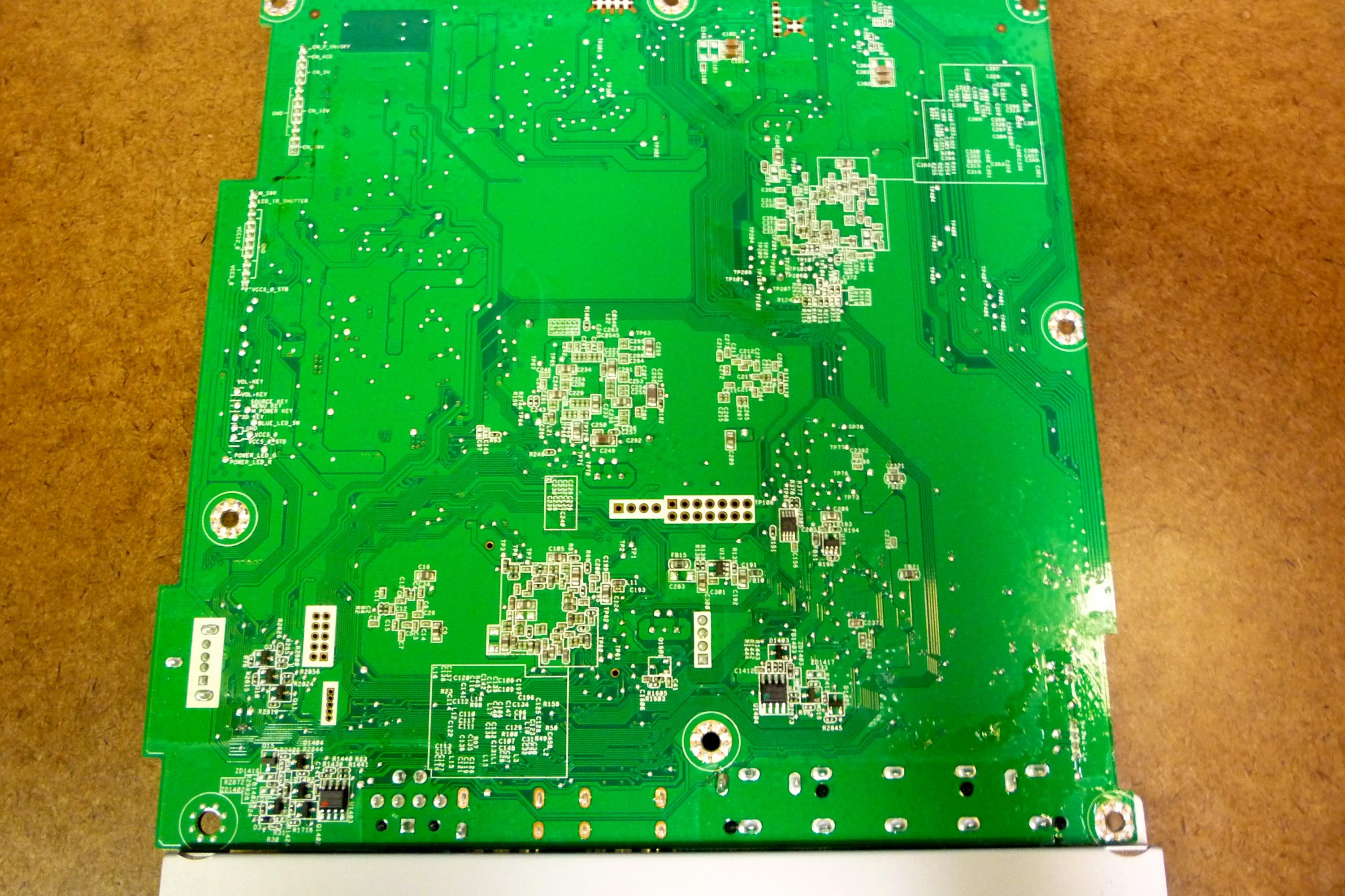

                    I then decided to remove the main board because I could just to see what was on the other side. There isn't much besides some components and some silkscreen on the PCB as to the connector pinout. I attached a pic.
                    I tried starting it without the IR bar (for driving the 3D glasses), the backlight, and the speakers unplugged with no change. I tried starting it without the ribbons to the LCD panel connected, no change.
                    That little red led just keeps on it's infernal blinking....
