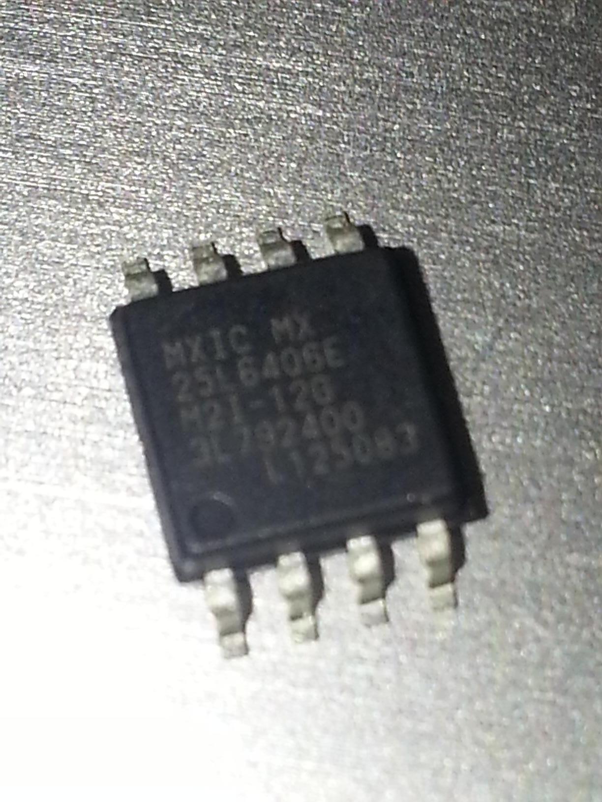

            me eh registrado en este foro solo para decir que el problema del sony ps 3d display
            es la eeprom tal y como dicen algunas personas por hay. ya eh podido solucionarlo, mi tv funciona de nuevo..
            la eeprom de repuesto la pueden comprar en ebay o amazon.
            la consegui con un vendedor llamado shopjimmy.
            una cosa mas la eeprom viene completamente programada

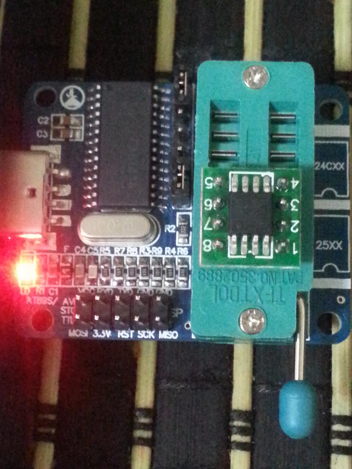

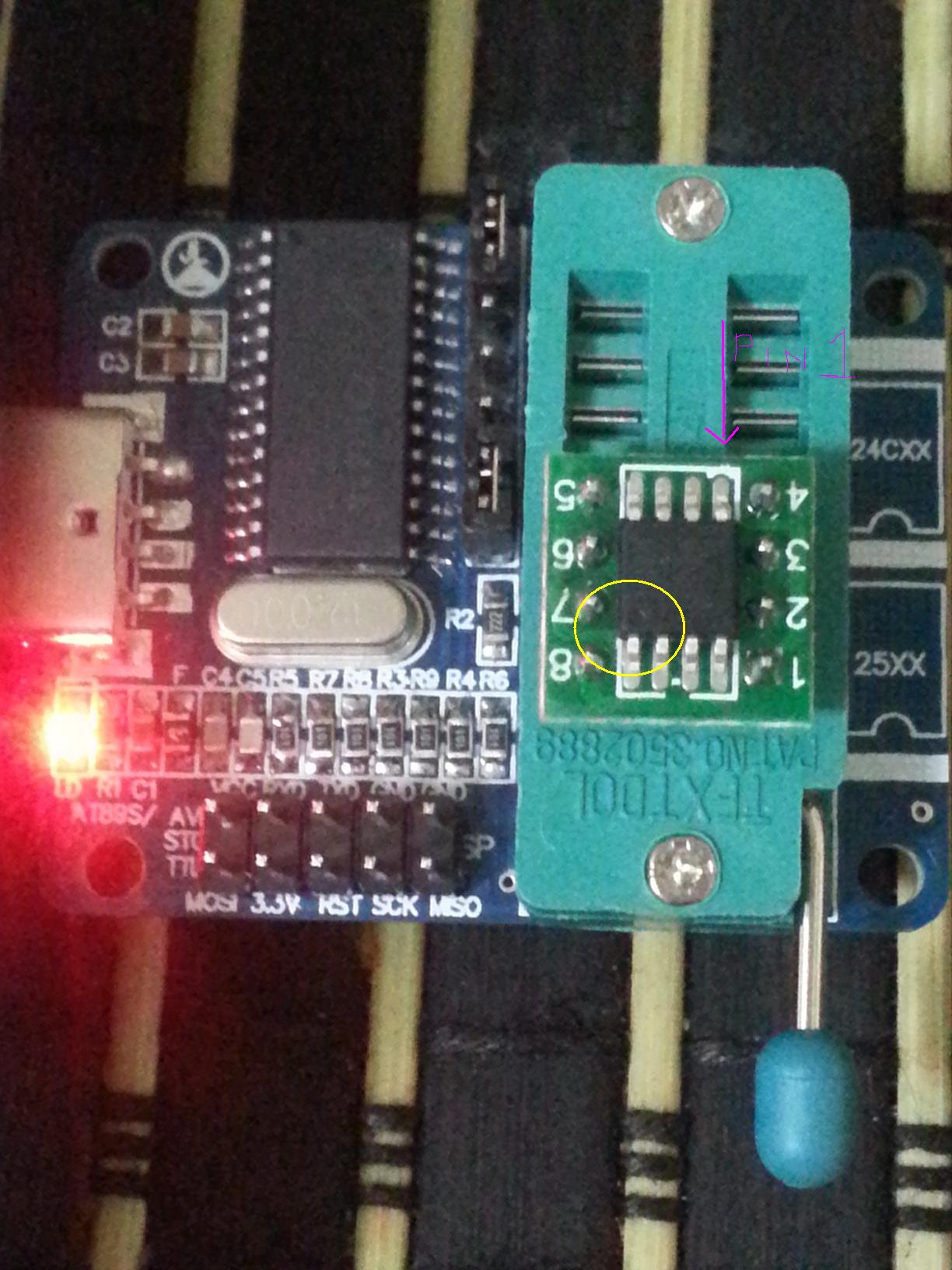

                  I'm getting "Write operations timeout failed!" I am using, ch341a v1.17, provided by you, and I attached a picture of how I set the programmer and the chip.
                  Driver is USB(used your package) OS is Win XP.
                  Seems that the chips isn't being detected. I tried all 5 chips I bought.
                  • R_J
                    • Jun 2012
                    • 9588
                    #269
                    Re: Sony CECH-ZED1U Playstation 3D LED TV - Two Red Flash
                    Thats because your chip is mounted wrong on the adaptor (I used a zif socket) The adaptor is in correct, but the chip needs to mounted the other way. If you check the adaptor board without the chip on it you will see what I mean, or look at the picture I uploaded
                    I hope you did'nt damage all the ic's.

                        Hi R_J
                        Haven't touched it yet, tied up with family and job, I'll let you know soon on what's the outcome.
                        So from what I understand,
                        My board is 08E1-0DM7200 and my old and new chip is 25L6406E
                        My firmware is this U4 25L6406E_08e1-0dm7200.zip
                        Just replace swap/replace the chip and its all good?
                        No power reset/discharge or what so ever?

                          Hi
                          @R_J
                          I did it, i was able to fixed it.
                          Thanks to all the members for the shared knowledge.
                          To all new, just look at my above post on how I how I fixed mine.

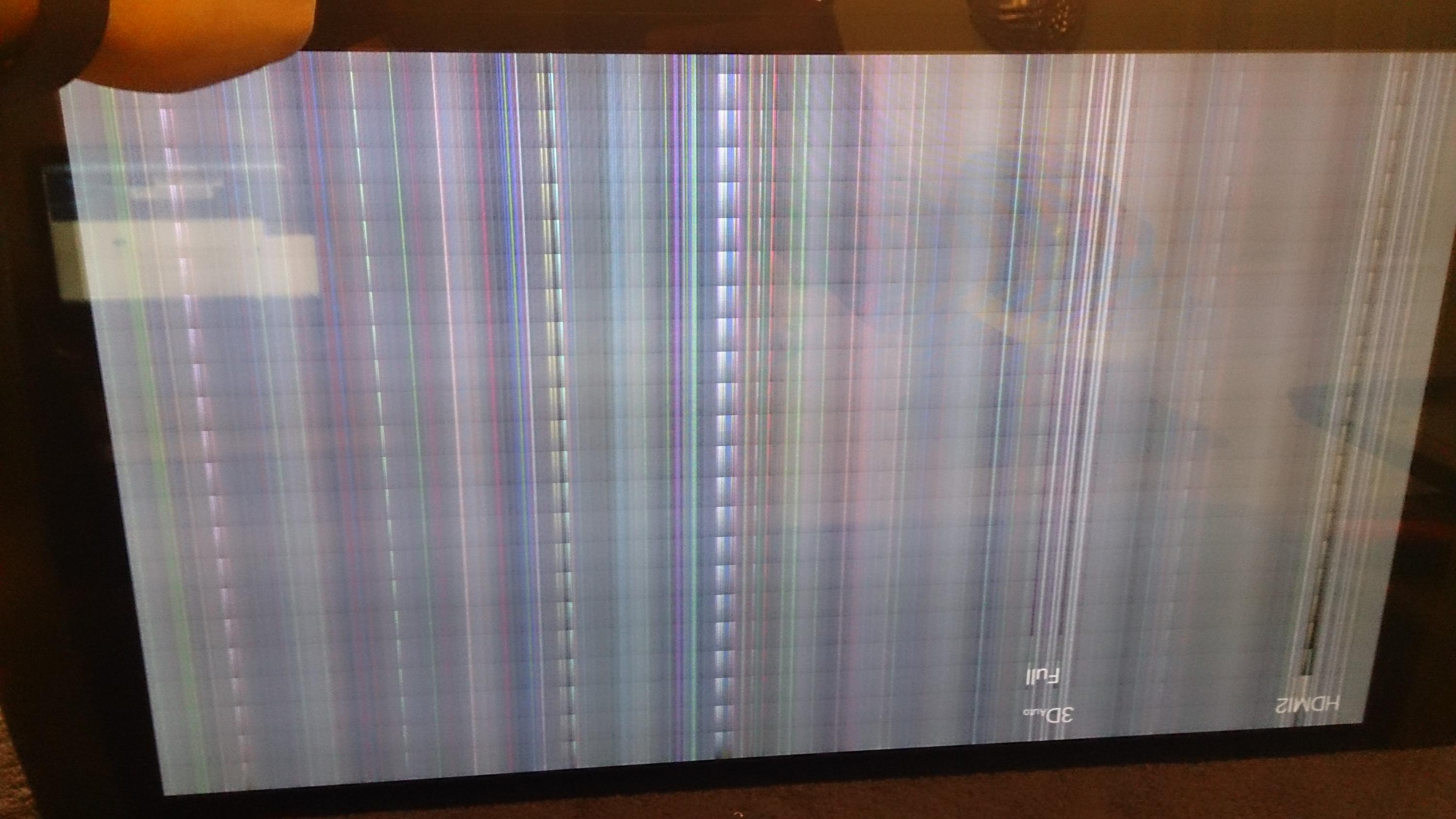

                            Hello all. I have just finished burning up my second motherboard trying to repair my PlayStation 3D Display. I have continued to burn off the small connectors on the mobo trying to desolder the bad chip. I'm at my wits end! R_J can you help me out, you seem to be the SME on this topic?! Thanks in advance!

                                Hi Lionitusofsparta, I did the second approach the R_J mentioned, I cut the old eeprom with a pliers, and after a remove the eeprom body, I used the solder to clean the contacts in the mainboard. Regards

                                        replaced the motherboard...and this is what comes up. I can navigate fine on my ps4, but the whole image is distorted. Is this another eeprom problem, or did I not hook up the mobo correctly?

                                          Hi lionitusofsparta, it looks like a HDMI problem, because the menu is showed ok, that mains that part of the image processor is working fine. Try the other HDMI, try using the composite input, and also try with other cables.
