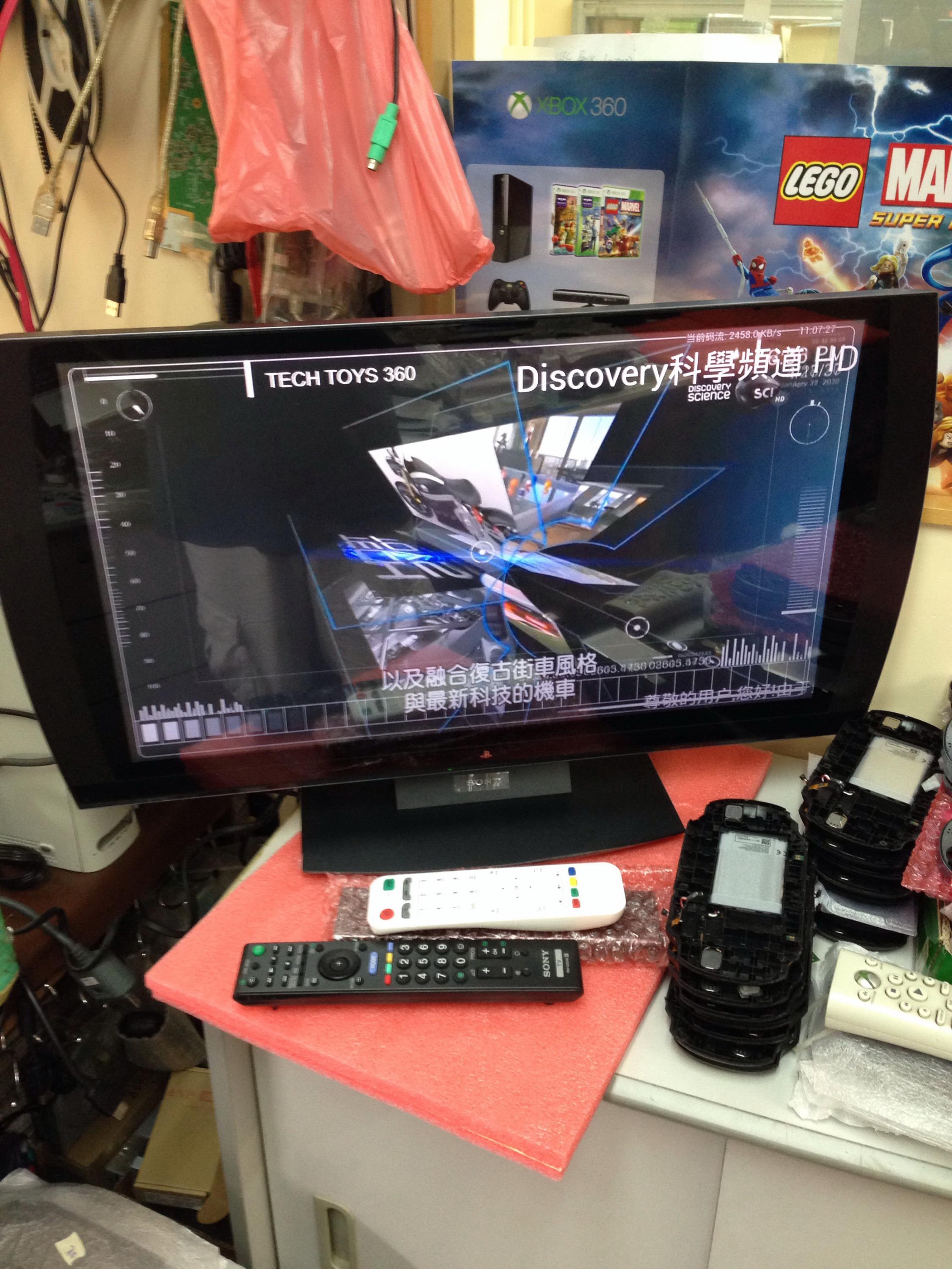

              • bobby8850
                • Jul 2014
                • 2
                • Hong Kong
                #287
                Re: Sony CECH-ZED1U Playstation 3D LED TV - Two Red Flash
                i repair 2 sets of my 3D Tv,
                Thanks everyone here.
                Regards,
                Bobby

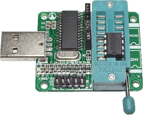

                                  • mario_pic
                                    • May 2014
                                    • 6
                                    • canada
                                    #297
                                    was wondering if any one has both bin files for both models i got a 7200 board and a 7400 board i got my programer in today id like to get a copy of both roms so i can fix them both thanks

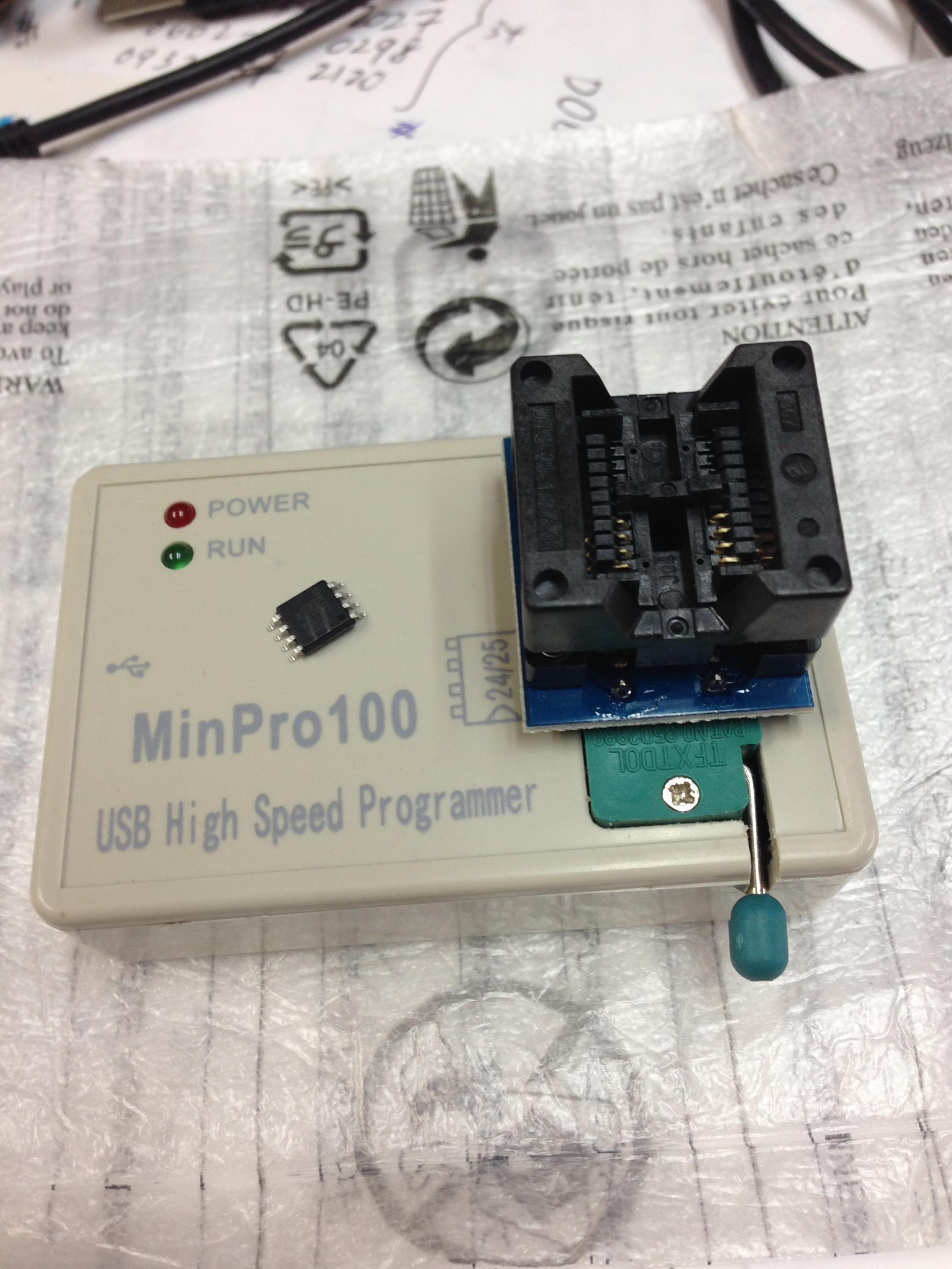

                                    • Mordi
                                      • Jul 2014
                                      • 3
                                      • France
                                      #298
                                      I have bought 2 times this screen and the both screen have this issue: "red light blinking ..."This screen make me crazy !!
                                      I bought these eprom :
                                      http://www.ebay.fr/itm/321477494481?...481%26_rdc%3D1
                                      and this programmer:
                                      http://www.ebay.fr/itm/151065888182?...182%26_rdc%3D1
                                      But the software does't recognise the chip and i don' understand why ?
                                      I tried on 3 different computer win7 64bit et win7 32 bits,installing the driver works correctly. The softawre always says "usb status ok" but it never detecs the chips.
                                      Could anyone have an idea ?

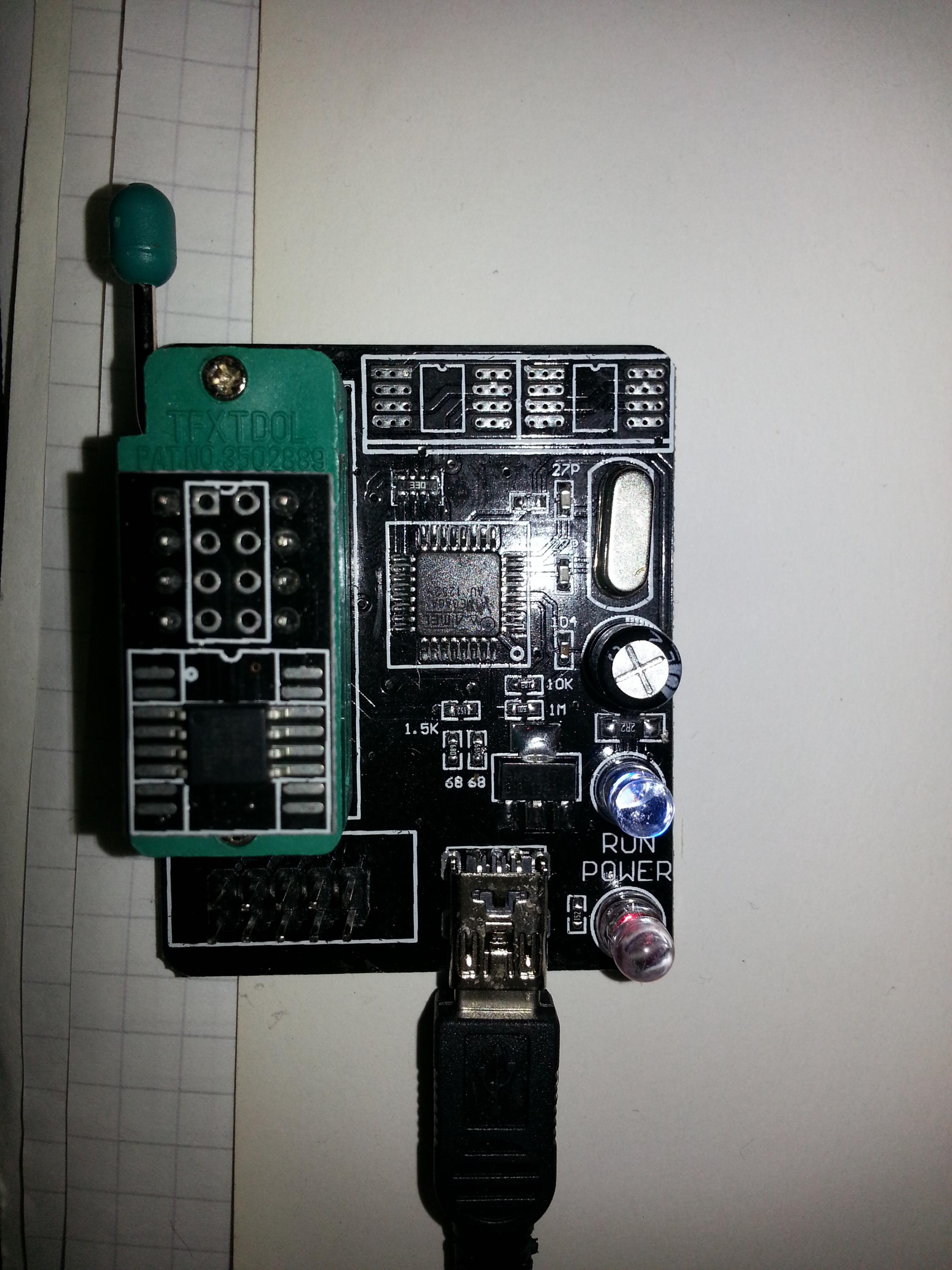

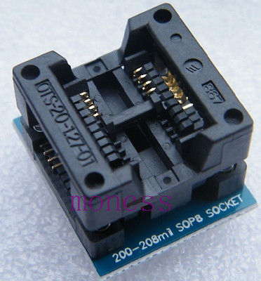

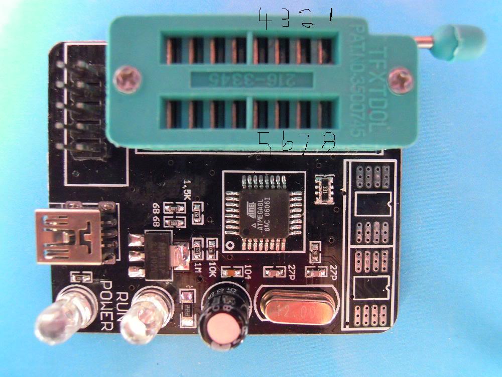

                                      • R_J
                                        • Jun 2012
                                        • 9588
                                        #299
                                        I suspect the chip is not correctly installed usually it would sit with pin one closest to the ziff handle
                                        I would have also ordered this adaptor http://www.ebay.com/itm/SOIC-SOP8-to...E:L:OC:CA:3160
                                        using an ohm meter check that pin one of the chip goes to pin one of the ziff socket pin two, three etc.
                                        I used the software I posted in thread #258 and it worked ok but also used a slightly different programer

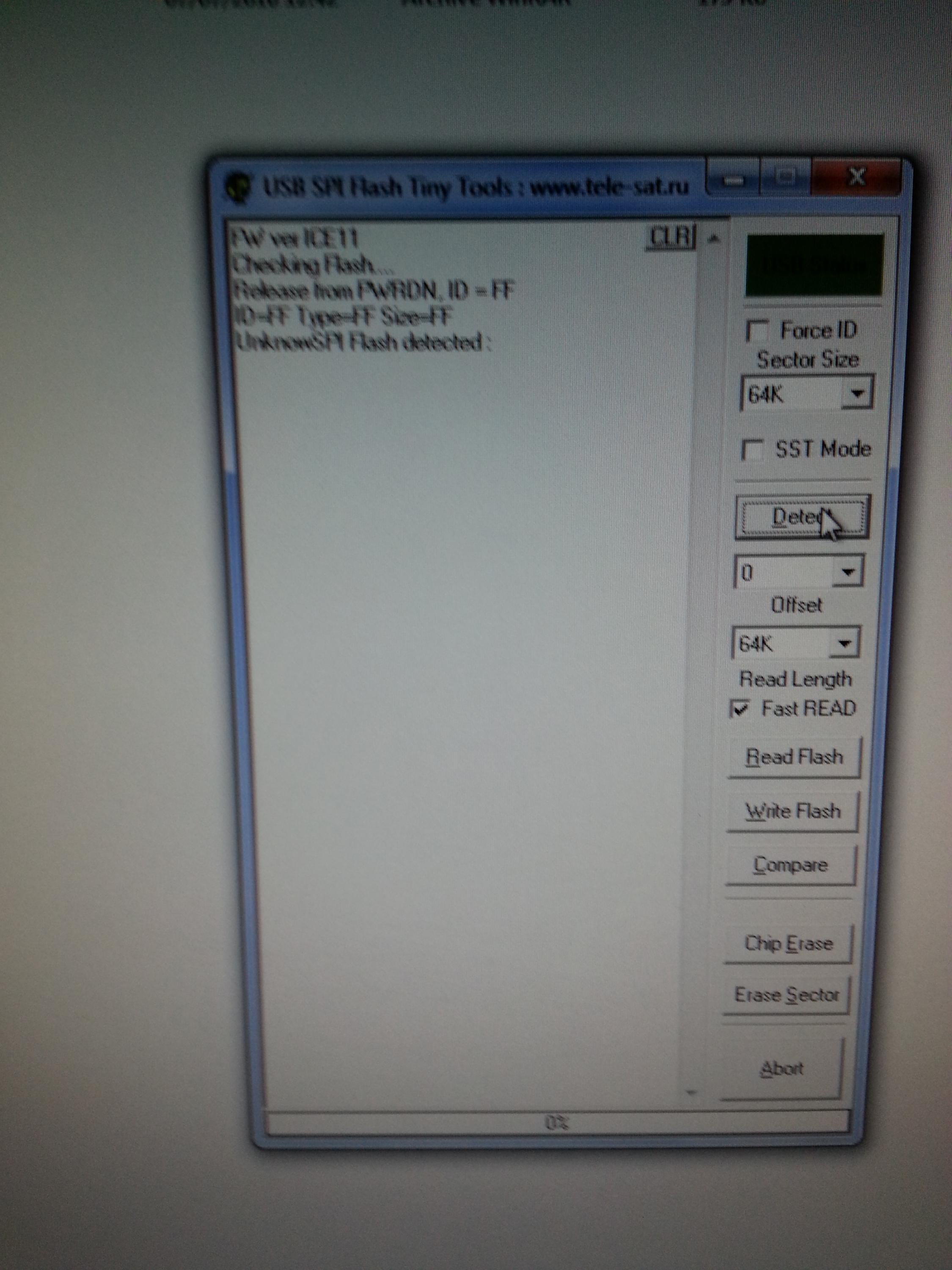

                                        • Mordi
                                          • Jul 2014
                                          • 3
                                          • France
                                          #300
                                          first thank for your reply.
                                          I have checked the pin with ohmeter, all seems to be ok.(one to one, two to two, etc...).
                                          I already try the software you used in thread #258,CH341A.exe, but no success for installing the driver wich come with, so it doesn't detects the programmer.(tried on win 7 32bits and win 7 64bits).
                                          If i install the driver from USB_SPI programmer, the USB SPI Tiny Tool software detects the programmer but not the chip.
                                          And with this same driver installed,CH341A.exe doesn't detects the programmer.
                                          Amazing !!!
