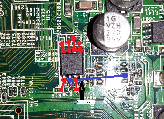

              I have a few problems with the monitor I just bought. the screen looks like it's in 3d all the time with a double image but the glasses don't fix the image it's like the screen resolution on a pc when it's not at correct setting. I also noticed that the 3d button doesn't fix it. I have it set on auto 3d detection. finally there is a vertical green line at the very right of the screen that does not go away. any ideas?
              • Dominikin
                • Jan 2015
                • 5
                • usa
                #307
                Re: Sony CECH-ZED1U Playstation 3D LED TV - Two Red Flash
                hello fellas, I'm new here. I've joined the forum to try and find a fix for this display. I'm having the same problem you guys are having. I called SONY and they said they would charge me $70 to fix it. After reading through everything and watching a video on youtube, I decided to give it a go myself without sending it to them. I'm a total noob at soldering and fixing boards so I left it to my uncle who has somewhat experience on boards. I went ahead and bought the pre-programmed eeprom from shop jimmy and gave my uncle the instructions on how to do it. Problem we're having is that I believe he lifted the traces and removed the pads when he took off the old eeprom. Is there a chance I could still recover this project or should I call it quits? I don't see any main board on sale anywhere, just the power boards on ebay. Could I just solder the old eeprom back in and send it to SONY? I read somewhere that they just switch the whole board out when you send it in for repair. Any help would be appreciated. Thanks
                  Hi Dominikin, follow the paths to some other component in the path and sold a thin cable to it, sold the other end to the eeprom leg. Do it for each leg. Regards

                    #309
                    hola, estaba siguiendo tu video en youtube. Desafortunadamente, se levantaron los pads cuando removimos el eeprom chip. Soy un novato en esto, podrias subir una foto señalando el componente de cual hablas? Me harias un gran favor. gracias

                      #310
                      Hola Dominikin, por favor subí una foto en alta calidad de como quedo así trato de indicarte como soldarlo. Saludos

                        #311
                        http://postimg.org/image/ffp3t1ydl
                        @as1, es la mejor foto que pude tomar.

                              #314
                              Hola, acá te deja la imagen con las indicaciones, fijate que hay una pata que no se conecta. Lo que te recomiendo es que uses alguna plaquita como la de los adaptadores de SOP8 a DIP para hacer las conexiones. Saludos
                                muchas gracias @as1. Lo intentare. Cual es el proposito del adaptador? Tengo que soldar el eeprom a el adaptador y adaptar las patitas del adaptador a donde me indicas?

                                  #316
                                  Hola, claro, soldas la eeprom en el adaptador, y luego usas cables bien finos para unir los puntos que te indique en la imagen mas fácilmente. Avisame por favor después como te fue. Saludos

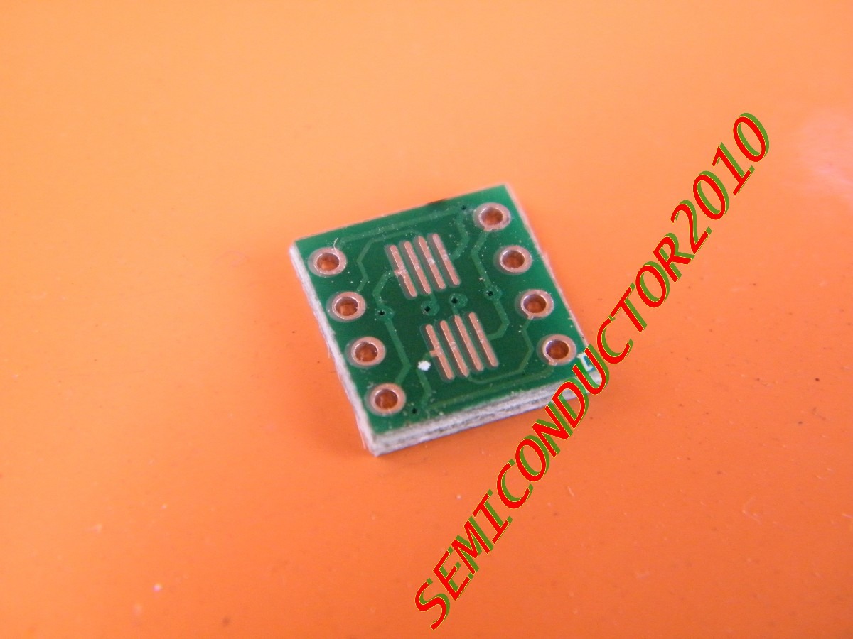

                                      Alright, I'm having a real fuckin hard time finding a MX25L6408E SOP8. There are a bunch of fake sellers on ebay right now selling the SOP16 chips as SOP8, and the one chinese source wants $100 for shipping. Can I use the MX25L6406E?
                                      • R_J
                                        • Jun 2012
                                        • 9588
                                        #319
                                        use a MX25L6406E which is an 8 pin ic, the mx25l6408e is a 16 pin ic, order it from Digikey
                                        • as1
                                          • Apr 2014
                                          • 25
                                          • Argentina
                                          #320
                                          http://www.ebay.com/itm/10pcs-MXIC-M...52459571&rt=nc
