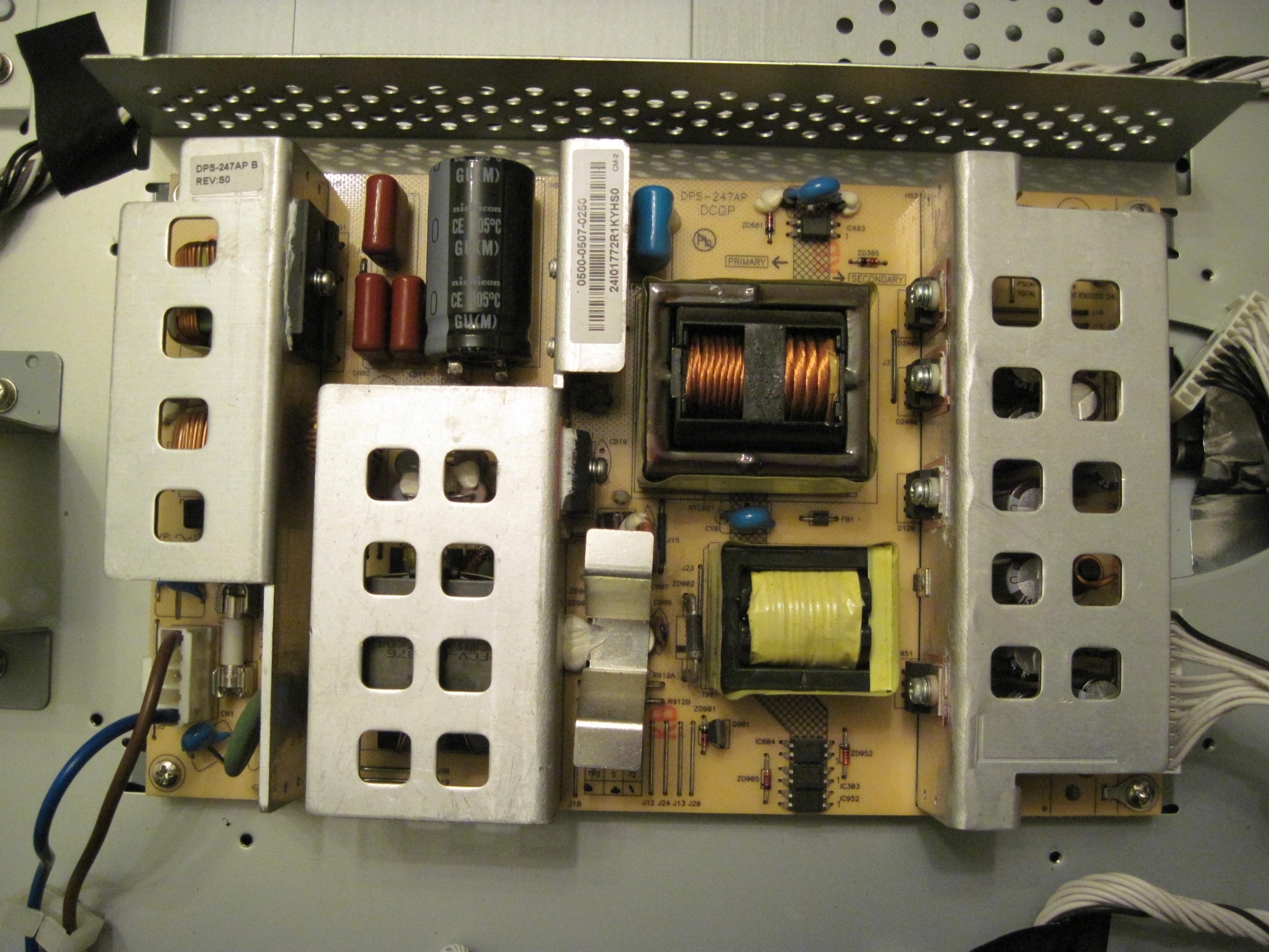

    I am trying to diagnose my visio vw37l
    I have only orange light
    5vdc standby voltage present on output of power supply but no "ps on" signal present at power supply when power button pushed.
    I was reading another thread and they suggested unplugging the inverters (the other two output plugs of power supply i'm assuming) with no change.
    anyone have any ideas on what to test to isolate (seems like main pcb maybe?)
    Two fuses i could find on main pcb by the input cable test fine
    I also have my 5vdc control voltage at switch/button board
    thanks
    scott
    Update--- I unhooked all connectors on power supply and hooked 3vdcto "ps on" input pin, the power supply voltages 12vdc and 24vdc are present on output pins of the 3 p/s connectors. so p/s appears to work when it gets the "on" signal..
    any ideas why the "p/s on" is not coming from main pcb?

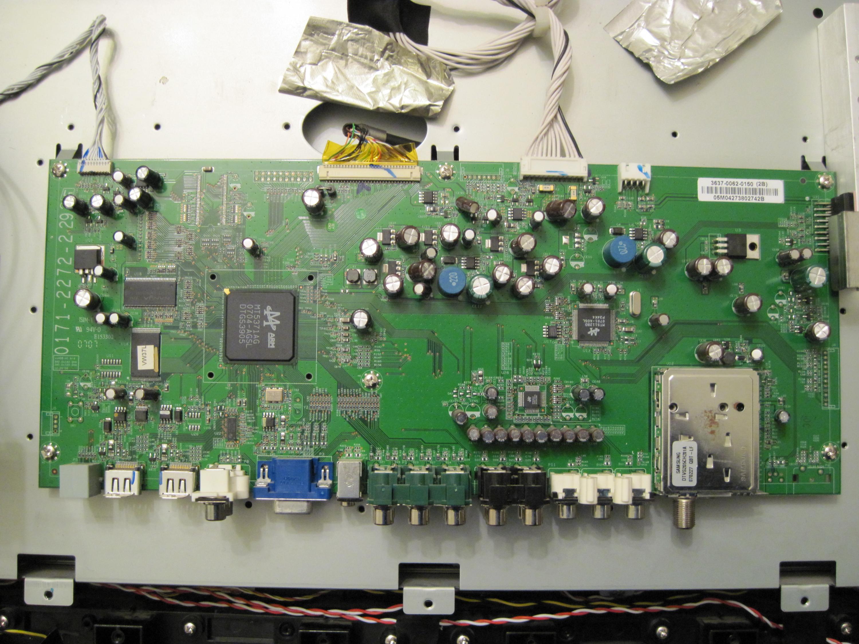

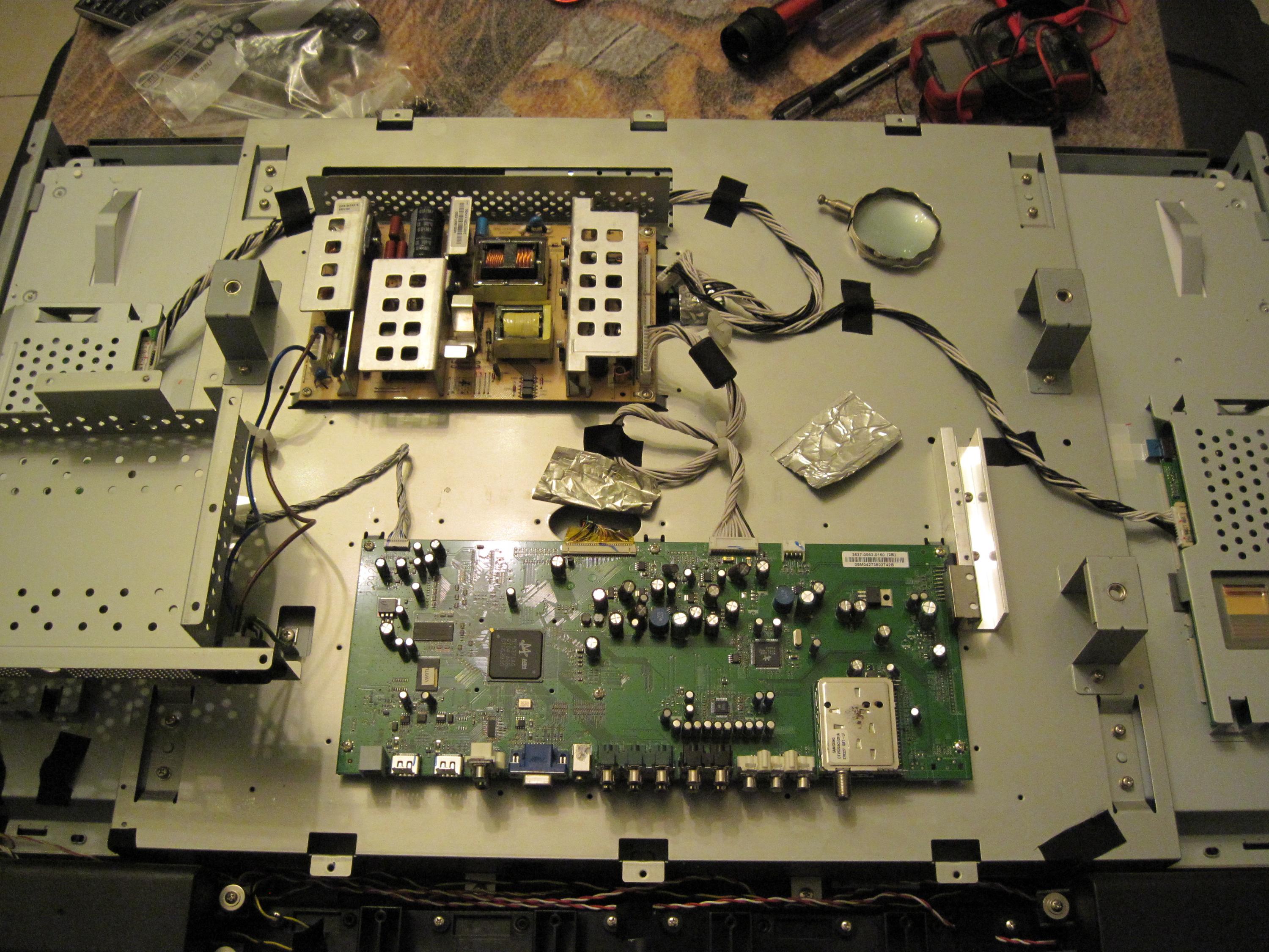

    Post a picture of the set layout of the boards internal. Then post pics of the boards close up, starting with the power board.
      Re: Vizio vw37l Amber light only will not power on
      I would check all the voltage regulators on the main board, please see the link below my signature on how to check the regulators.

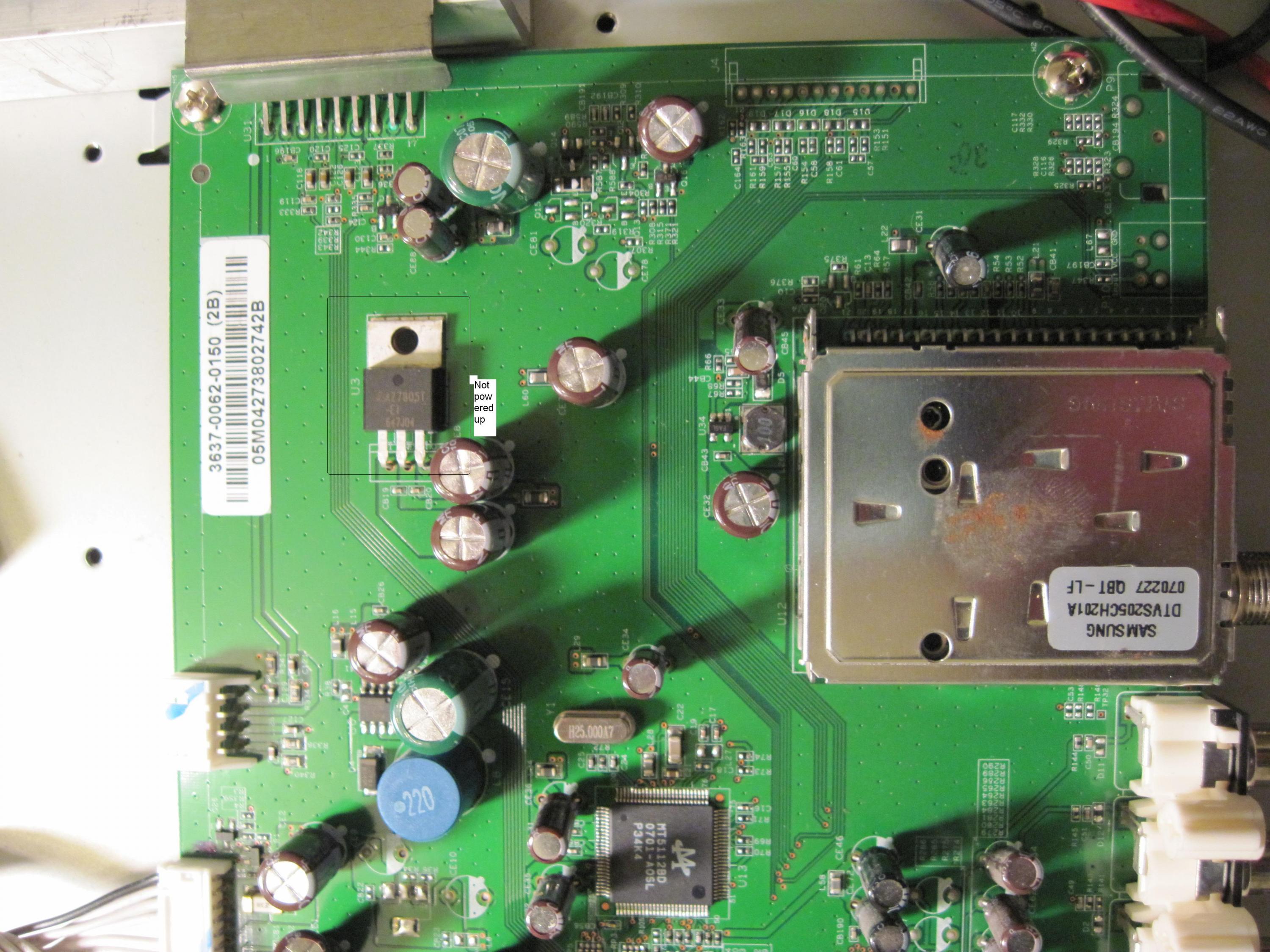

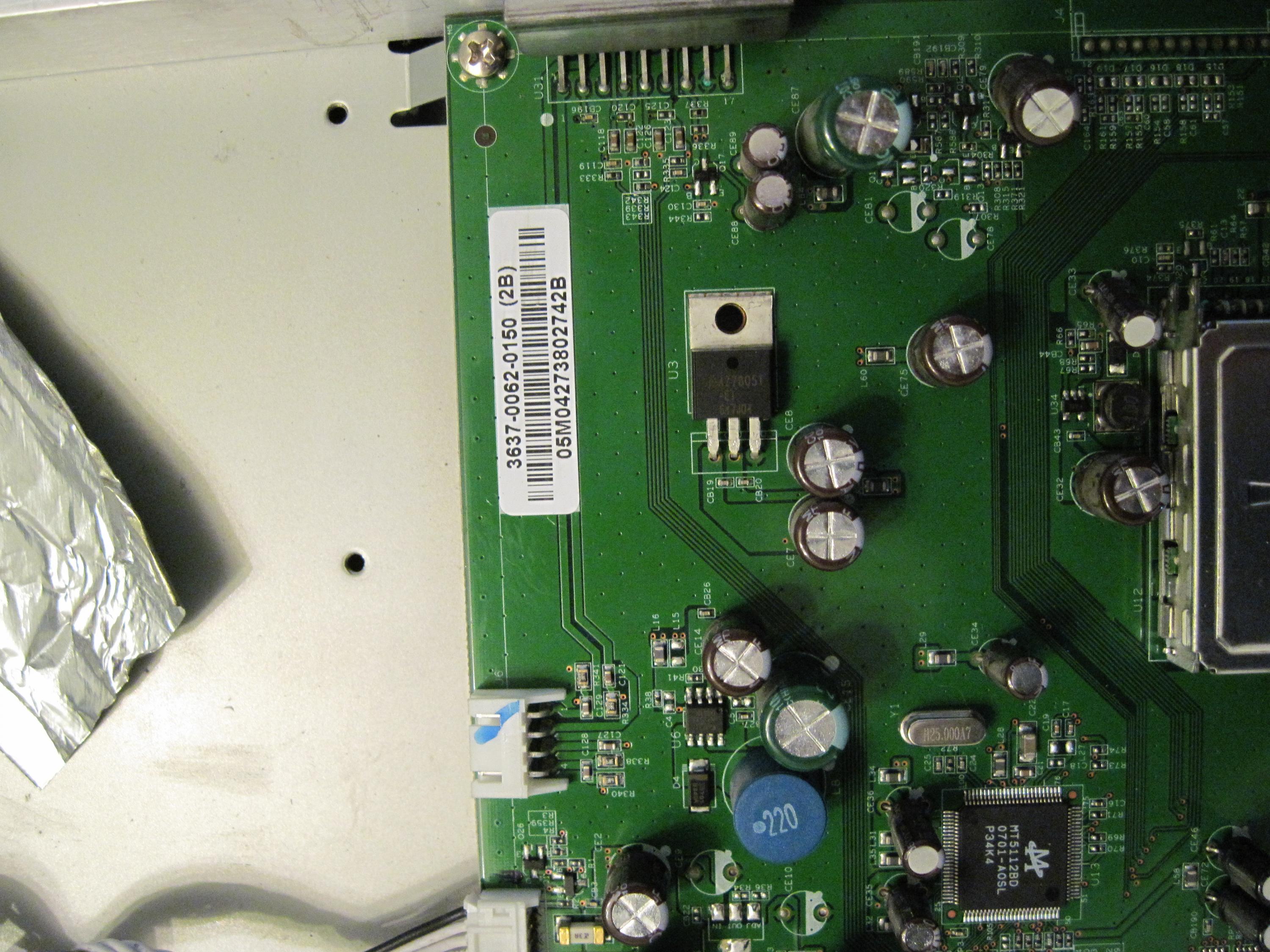

        Tested all the v-regs I could find... Aside from u-3 2nd of the largest two risiding on the right side not having any input power ( i am guessing this part of the board is not active in standby) all looks good except u7 which is in the middle upper center just below connector has input but no output. Doe this mean its bad? I was getting readings i that trust/understand trying to test the resistor and cap in the area.. (Differed from other readings (ohms) i tried to sample from caps in circuit next to similar vregs in area )
        Admittedly I am traveling a smidge beyond my experience level so my apologies if i am saying incorrect methods

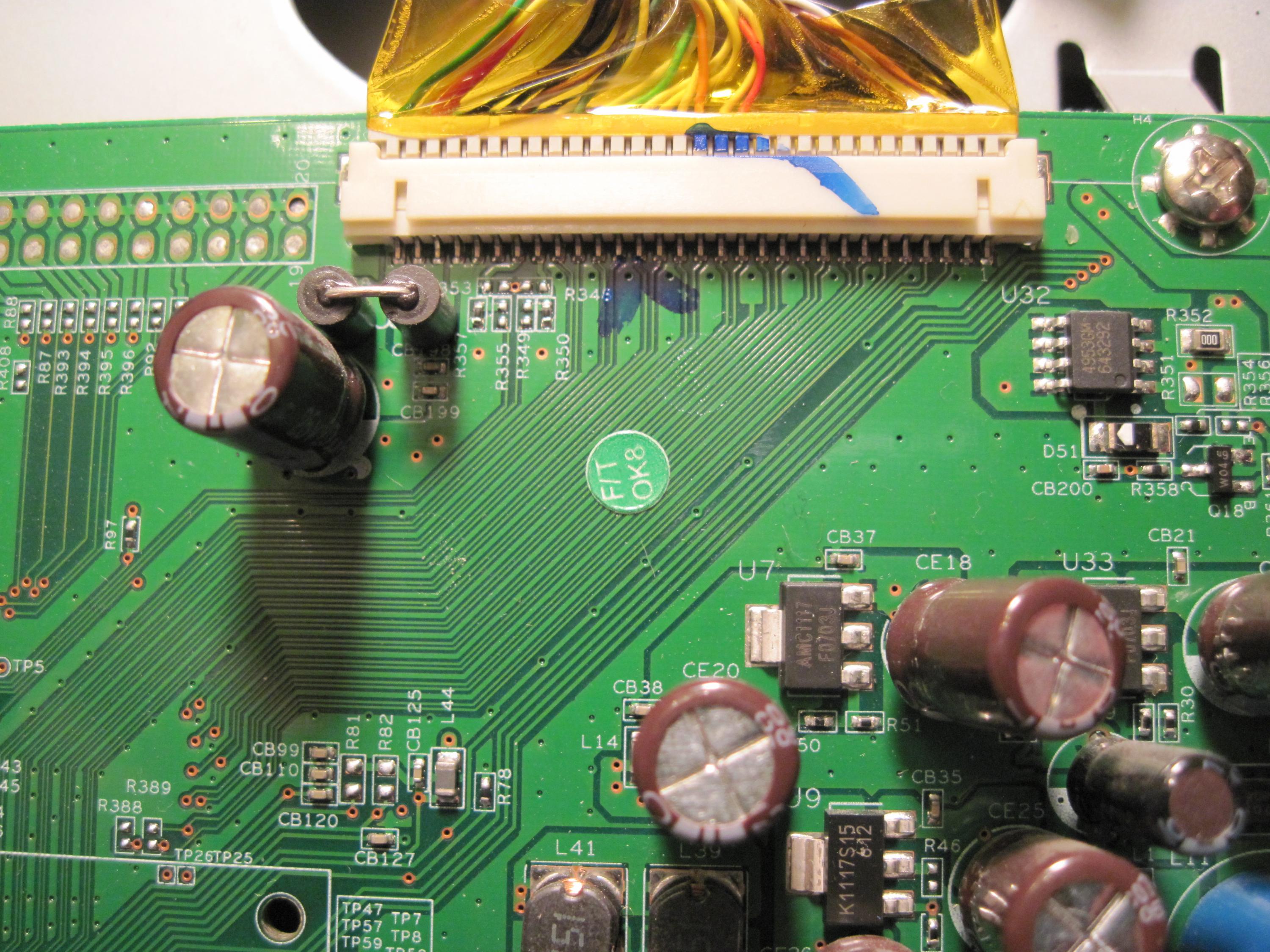

            u7
            amc1117
            pin1 -0v
            pin2 -.5v
            pin3 -3.36v
            u33 and all other amc1117's i could find were all the same readings
            amc1117
            pin1 -2.1v
            pin2 -3.36v
            pin3 -5.15v

            u3
            az7805t
            pin1-0v
            pin2-ov
            pin3-85mv

              U7 pin 2 should be 1.25V DC. Double check your readings.

                      looks like U7 has a 3.3V input where the others have a 5V input. Pin 2 of U7 should read right around 1.25V.
                        Yes, output voltage (pin #2) = pin #1 voltage + 1.25V, as long as regulator has more than ~0.8V between desired output and input.

                          Is it just coincidence that the input of u7 is 2.1 v lower than it should be ( which is the same voltage that the other similar 1117s ground legs are reading--2.1v....
                          And why would it be low.. Is that a u7 failure or a indication of associated circuitry failure.
                          Could u7 be shorting 2.1v of its input to ground causing the 2.1v on the other 1117's gound leg?
                          Or as asked in a previous post, is the ground leg supposed to be off zero on these 1117s...
                          thanks
                            Yes. The regulator can be configured to output any voltage and this is determined by the voltage on that pin. All the main regulators put out 3.3V (2.1V + 1.25V), but there's also a 1.25V regulator (U7: 0V + 1.25V), and the failure is with that.
                            Nobody knows why Vizio have this problem so often, perhaps an instance of "sort by lowest price" on the manufacturer's catalogue, or by accidentally (or deliberately..) buying counterfeit parts. Also, they often run very hot due to being used near their maximum power rating. I have also encountered failed regulators on Samsung and Haier/Bush TVs.
                            No, each regulator is independent.
                            It can be any voltage you like. A 1117 can output anywhere from 1.25V to around 18V, depending on the requirements of the circuit different voltages are used.
                            Replacing U7 should be all that is necessary.
                              U7 gets the input voltage from the output of U33. U7 is bad.
                              As shown in post 6, U33 output is 3.36v, THE INPUT OF THE u7 IS 3.36V. If you check out the connection between the output of U33, it will be connected to U7 input pin. Pin 1 (ADJ/ or GND (for fixed regulator) and pin 2 (output pin) will ALWAYS BE 1.25V due to the 1.25V Vref of the regulator.
                              Pin 1 will be grounded for 1117 Fixed regulator, or will have voltage on pin 1 due to resistor network for setting the output voltage for the Adjustable 1117 series.

                                Do you think that my assumption of why u-3(the 2nd of the largest two regulators, residing on the upper right corner of board)does not have power input is a correct one?
                                (see my first post) ( i am thinking this part of the board is not active while in standby or is it due to the failure upstream?)
                                thanks much
                                  Yes, that regulator is correctly functioning (as it receives essentially no input, it gives no output.)
