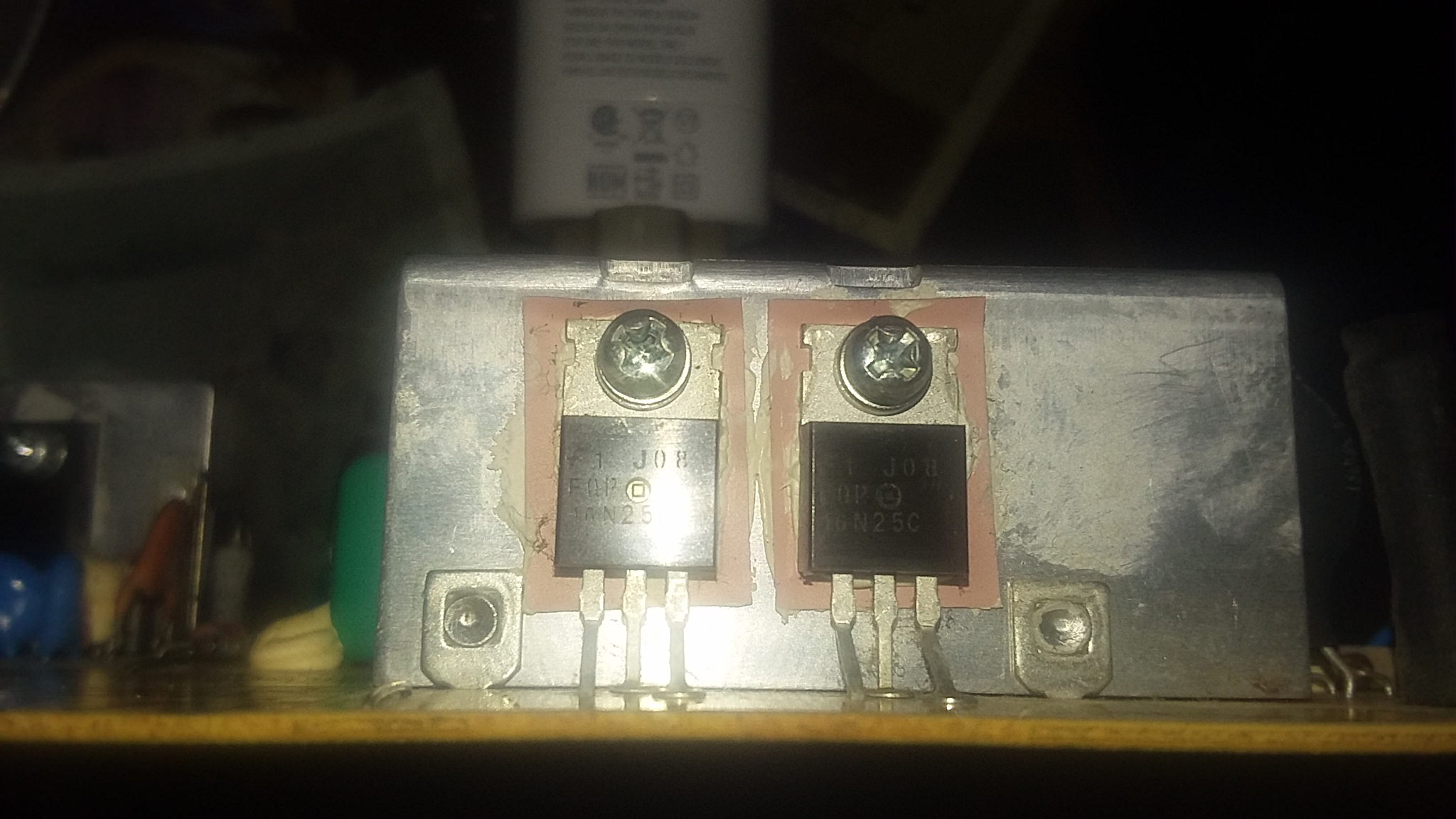

    What is the number given on those two mosfets attached to the heatsink?
    It looks like the DLA001A can be replaced by L6598D if it comes down to it.

        mosfets = Q601 & Q602
        16n25c

          A repair kit from Shopjimmy for no 12V /24V includes IC601, Q601, Q602, R619, R622 (both 0 ohm from Shopjimmy but both 10 ohms looking at the picture you posted. So I would check all these components.
          I checked those R619 & R622 earlier, they measure 10Ω exactly, i dont know how to check mosFets w/ a Ω meter other than to look for dead shorts/opens

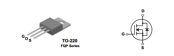

              Turn the power off to the set. To test the mosfets put you meter into diode mode --!<!-- and check between the Drain and Source pins and then reverse the leads. One way should be around 0.4 and reversing the leads should be no reading OL. This checks the diode across the mosfet.
              It wouldn't hurt to change the IC if you have one.

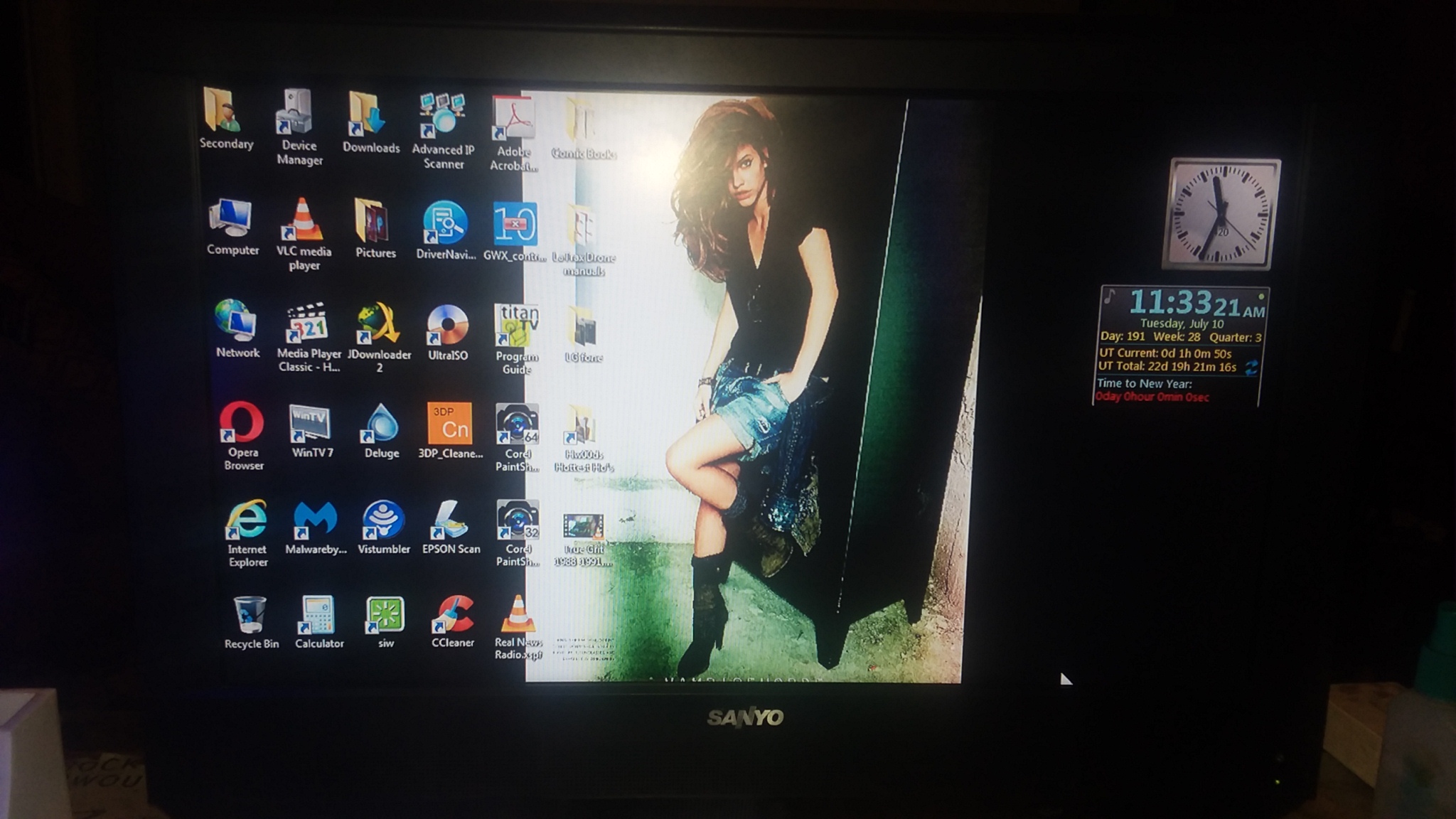

                        Hey DB, & anybody else who cares, I got this puppy fired up today, but don't ask me what component failed, lol, I replaced that 16pin IC601 w/the subbed one (L6598D) & the 2 mosfets Q601 & Q602 as well, Boom!, got my 12v & 24v & 384v PFC back!!!, went thru 3 fuses in the process, but don't tell anybody about that one..D'ohhh
                        Thanks again, I would have never gotten anywhere without the assistance here

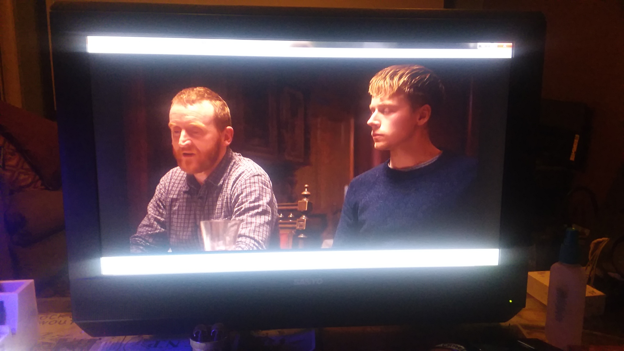

                            just got my camera/phone back, here's a pic to show I'm not shucking & Jiving....lolz
