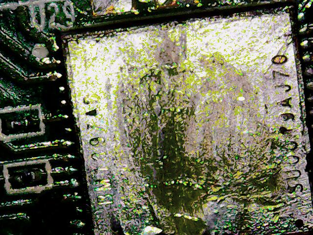

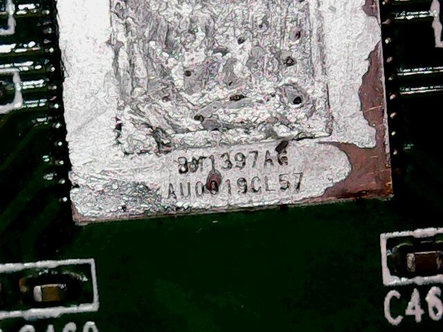

    somebody familiar with hasboard repairs? BM1397AD interchangeable with Bm1397AG ? S17+ and T17+
    i got myself a complete Antminer T17+ with 3 dead hasboards for a very good price.... for parts i bought S17PRO boards.... i replaced all missing resistors and changed some asics because they were bad... but wihout a tester... i used the miner instead and changed firmware to awesome miner firmware for better and faster diagnoses via miner log and lower fan speed...
    for my understanding and what i read on the internet these asics should be interchangeable in one chain but in my case i´m getting no more communication to none of the asics on all 3 boards. 2 of the boards weren´t in that bad condition. only lost some heatsinks rippin´out some resitstors and capacitors. on one there was 1 asic found and on aanother 43 asics of 44 per board... one was "zero asics" so i spent more time on the others...
    aren´t these interchangeable? risky without a hasboard tester i know...
    if i´m not able to fix the board i bought them for building a "hex Bitaxe" from them with few of the asics
    thx

    ....hm ok...
    made some progress by the way by rippin´the ones out and changing them back...
    glad to see it´s not my soldering

    work in progress... i´m at number 5 at one Board...
    seems the chips are not interchangeable...
