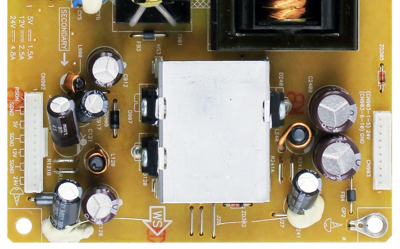

    Ok guys, this is my first post so please be nice.
    Im not a complete noob, I have repaired numerous monitors with bad caps, but mainly only because I could tell that they were bulging or visually bad.
    I dont really know much about these circuits, but I am proficient with a DMM and have all the tools needed to test/repair....
    I am pretty good with soldering new caps in and other components from a lot of practicing. I am very familiar with electrical concepts but not so much with electronics. I am familiar with testing continuity, resistance and capacitance as well as ac and/or dc voltages.
    Im going to start with this TV as I am trying to fix it for a friend.
    The tv has a green light on the front when the power button is pressed, but no reaction from the backlights. The capacitors look good and I replaced a few just to be safe, but still have the same results. I dont know where to start in troubleshooting further. Can you guys help. Please let me know. I can provide more pictures if necessary.

    Does the green LED stay on or does it turn back off after a couple seconds?
    • thetonywarren
      • Feb 2013
      • 149
      Re: Sanyo LCD TV DP26649
      It stays on.....until I press the power button again.
                With the tv on set your DMM to DC volts and list what voltages are present. List them like so
                5v - 5.02
                12v 12.23
                24v 24.34
                ect ect..... I upload a picture of the 2 connectors you'll be checking.
                  5v - 5.01
                  12v - 11.96
                  24v - 24.28
                        what is the pson voltage?
                        • thetonywarren
                          • Feb 2013
                          • 149
                          PSON - 5.00vdc
                            I fixed this model before, if you disconnect K8L connector and the backlights comes on, then you have problem with the main board.
                            http://s807.beta.photobucket.com/use...ml?sort=6&o=21
                            K8L has the BL_ON signal that turns on the Backlights.
                            Try it and see what happen.

                              Did you get 24v on CN903? It's the connector on the right of the pic i posted earlier. From what i see it appears your power supply is turning on correctly and it's getting the right pson voltage from the main board.
                              • thetonywarren
                                • Feb 2013
                                • 149
                                Yes, I did check CN903, 24v is there on pins 1-5. I did disconnect K8L and the backlights did come on.
                                What can I do to troubleshoot the main board?
                                  I did not try to fix my main board either, no diagram. I can only check some voltages and that's about it so I replace the board instead.
