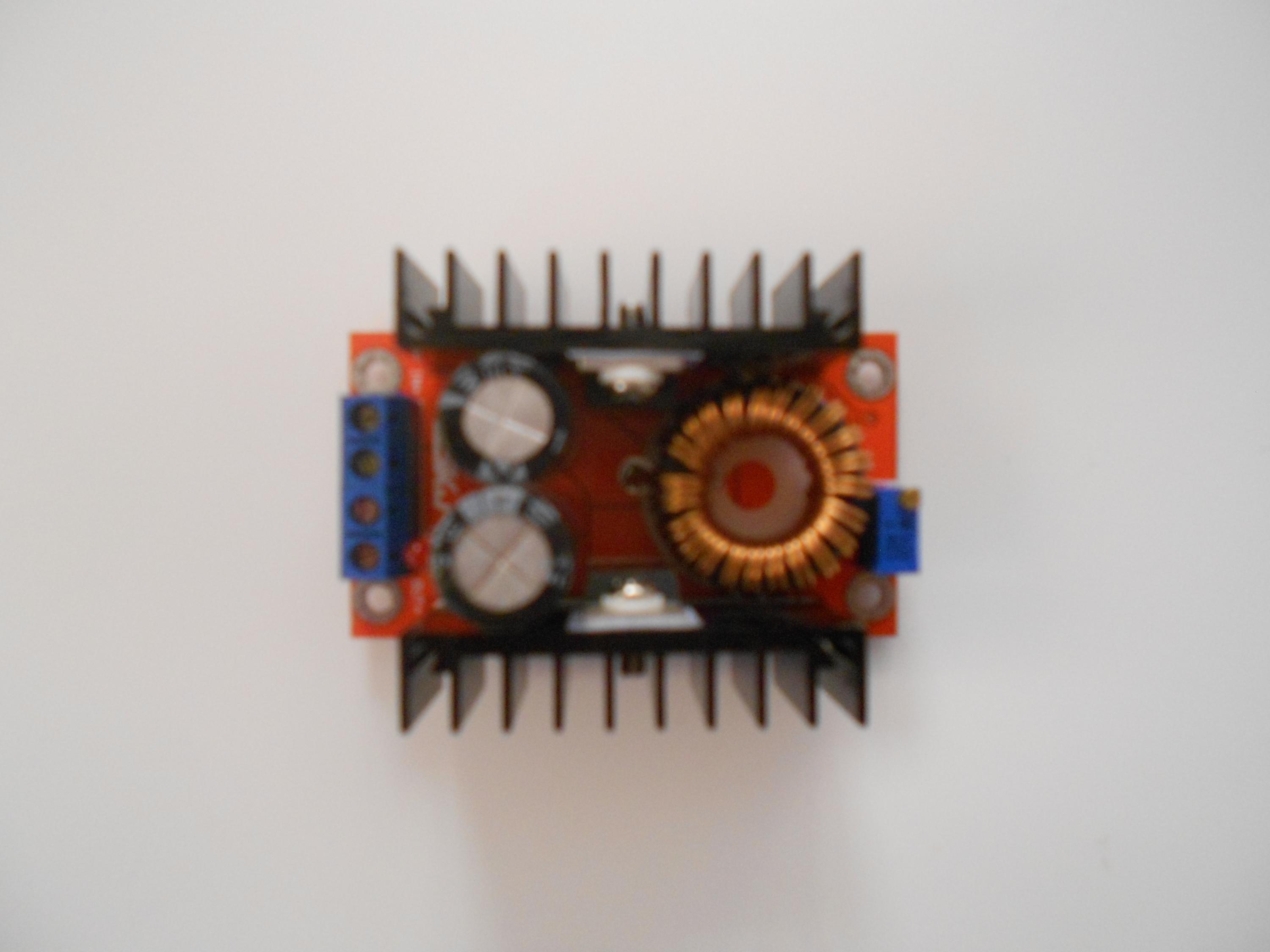

    That is multi-turn (10-turn pot) trimpot for fine adjustment, it is either for the output voltage fine adjustment or the constant current output adjustment, I am surprised the kit did not come with the instruction.

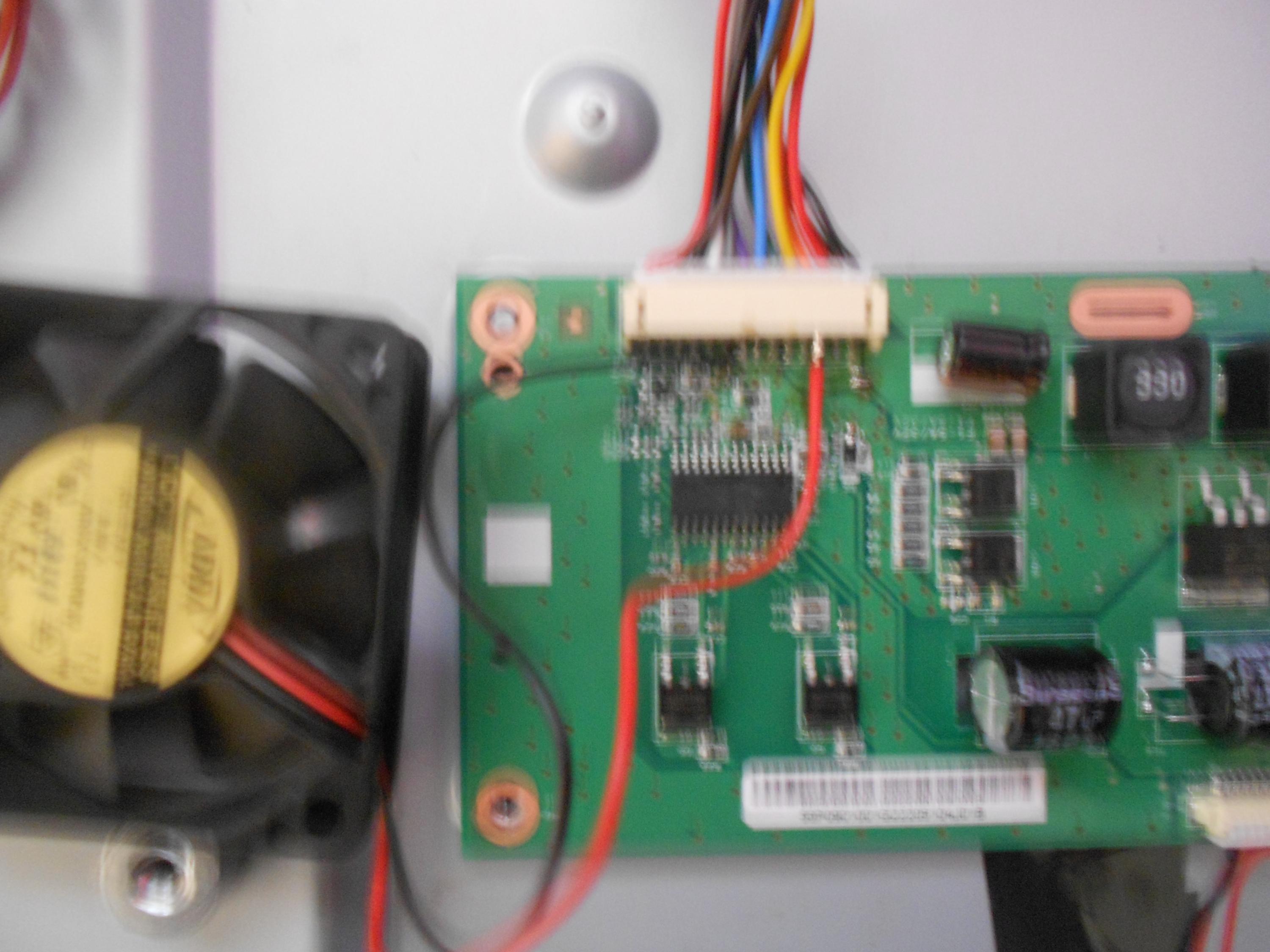

            Re: e420vse no standby light

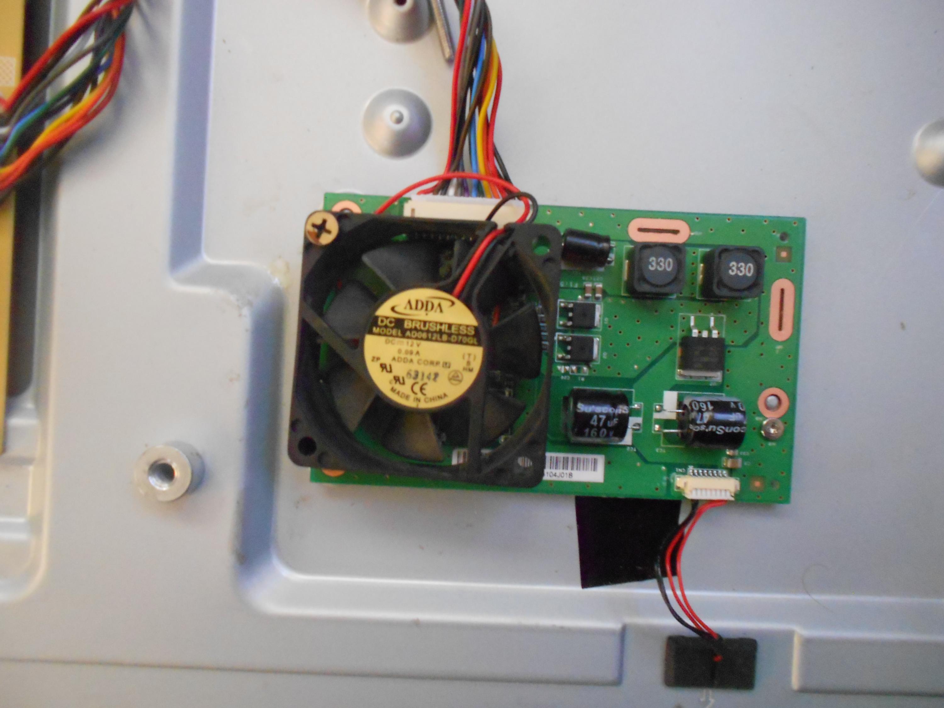

            Easy fix for Vizio e420vse that works for a couple of minutes and then the Image goes out (black screen), I'd tried to do the mod we discuss before without any luck, but in the process noticed that chip HAI 7201PC get's to hot causing an internal short. so I added a 12vdc Fan I had , and that fixed the problem, +vcc pin 3 red and -vcc pin 8 purple. its been working for a week so far
              One way of solving it. You may try using old heat sink from MB also. Good to see you get it running.

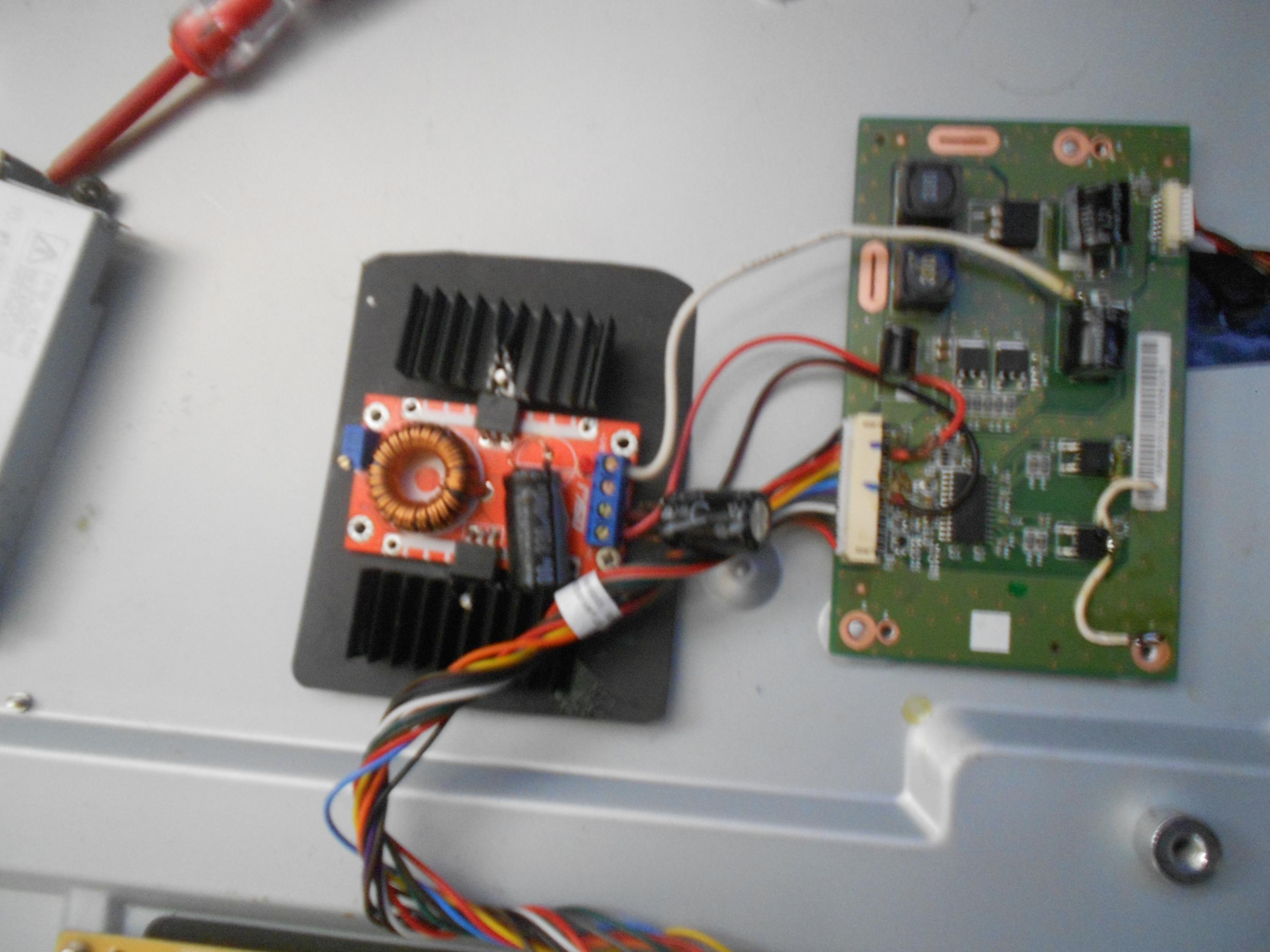

                I did tried a heat sink, but after a while it get hot and shot the display, I'd notice the ebay guy is selling the power inverter kit again ($40) if someone got the kit from him maybe will like to share the instructions, I did the wiring as the picts. but didn't work for me (got the $16 inverter from china)

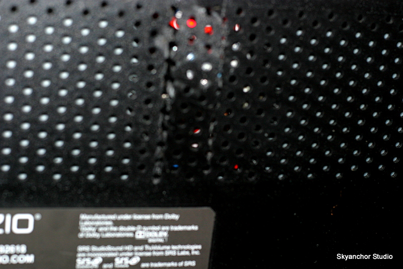

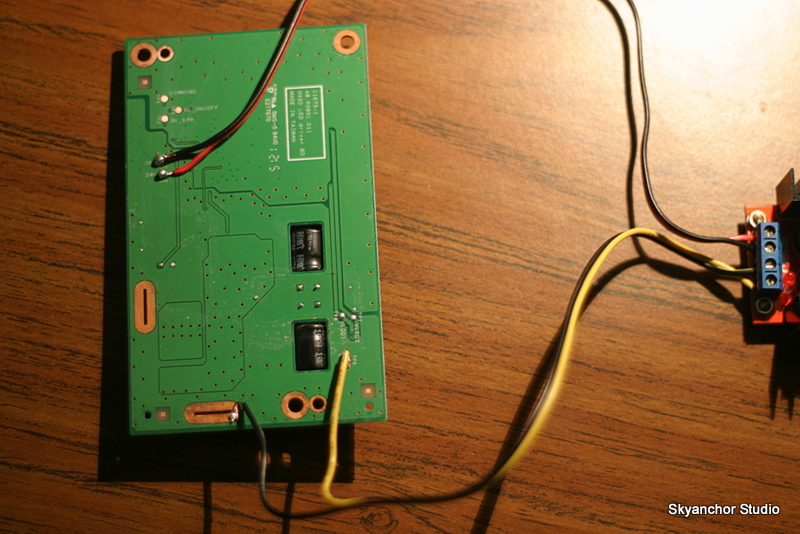

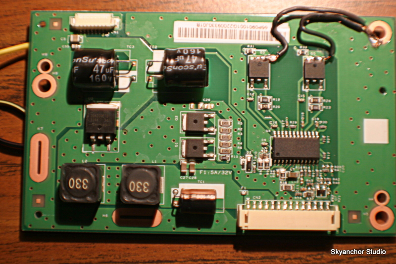

                        I haven't checked back here for a while. I do have the original picture somewhere, but I figured it would be quick and easy to solder onto the bottom of the board where the test points are marked (+24V, GND, VLED). Furthermore, since it's my own TV and I didn't feel like reconfiguring the heat sink and large capacitor, I left the eBay converter board as is. I merely cut out a couple of slits in the back of the TV, using a knife to cut the plastic vertically along the air vent holes, such that the case bends around the large capacitor. I think if you put that capacitor sideways across the output, you don't need to unsolder the heat sinks from the board or cut the case. The trick is to affix the board far enough down so that it's vertically near the center (and directly beneath the air vent holes), and so the plastic case will easily bend around it, such that there's really no noticeable bulge. I used double-sided foam sticky tape to affix the board to the chassis.
                        So when I first plugged the TV in after installing the converter board, I heard a high pitched squeal from the power supply and the LEDs were very bright...voltage was 90 some volts!..I panicked and unplugged the TV. Turned the voltage pot way down...tried again...same thing. Voltage would not go down below 86 volts no matter how many turns I made on the potentiometer. Then, something failed on the Vizio driver board, I think, as the high-pitched squeal suddenly went away. It was like the two power supplies had been competing with each other for a time.
                        The original failure mode of the TV as I remember was that it did work for a few moments when it was first turned on, then the screen went dark. The takeaway from this anecdote is that the original board wasn't completely dead and also didn't appear to be completely disabled as the jumpers (top diagram) were supposed to accomplish. Anyway, I was subsequently able to adjust the voltage way down to below 60 volts (very dim backlight), then back up to 80 volts, where I left it. That seemed to be a pretty decent brightness. I wanted to go a little lower than full brightness as this isn't a constant current supply, which is what you should have when driving LEDs.

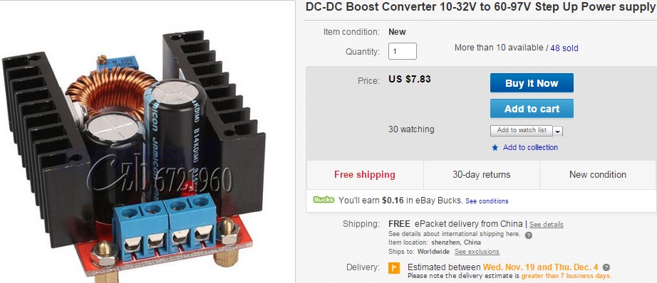

                        As luck would have it, I see there is now a constant voltage/constant current 80V boost converter for sale on eBay, for just $5 more than the original $14 eBay converter (which, I noticed, is now available from some sellers for less than $10).
                        http://www.ebay.com/itm/DC-600W-10-6...-/131190113105
                        The way that works, as I understand, is that there are two pots (pictured), one for voltage and one for current. Since only one mode works at a time (constant current or constant voltage), there is automatic switchover from one mode to the other, based on which mode is the most restrictive. So, if I set a maximum voltage of 80V, no current setting can make the voltage go higher than that. Likewise, if I set a maximum current of 0.60A, no voltage setting can make the current go higher than that. I was thinking that when I install one of these boards, I will set the voltage a little higher, maybe 83V if it will go that high, and then set the current adjustment till it brings that voltage down just a hair. Thus, the current limiting has taken priority and should keep priority, which is what you want for protection of the LEDs.

                          I should clarify my previous post, as I think I gave out misinformation. I was assuming a single series string of LEDs comprise the backlight, but I believe there may be two independent series strings, which are shorted to series/parallel operation when the original mod is performed. It's very important that each series string have its own independent constant current source. Otherwise, if there were two series strings connected in parallel across the same constant-current supply, and one string went open, I think you can see from basic electronics that the voltage would double to try and force the lost branch current through the remaining good series branch (doubling that current through each LED in the branch). That would be a bad thing!
                          So when I said that constant current is what you want for protection of LEDs, that only applies to an individual series string of LEDs. That's why these original manufacturer's TV driver boards appear to be more complicated than you or I might otherwise have expected: there are 2 (or more) independent (yet tracking for brightness control) constant current sources on the board!
                          Please jump in with any further questions/corrections/clarifications. In the meantime, till we get this all figured out, I'd advise sticking with the original 60-97 volt boost converter offered on eBay, now priced at only $7.83 with free shipping:
                          http://www.ebay.com/itm/DC-DC-Boost-...-/141316789506
