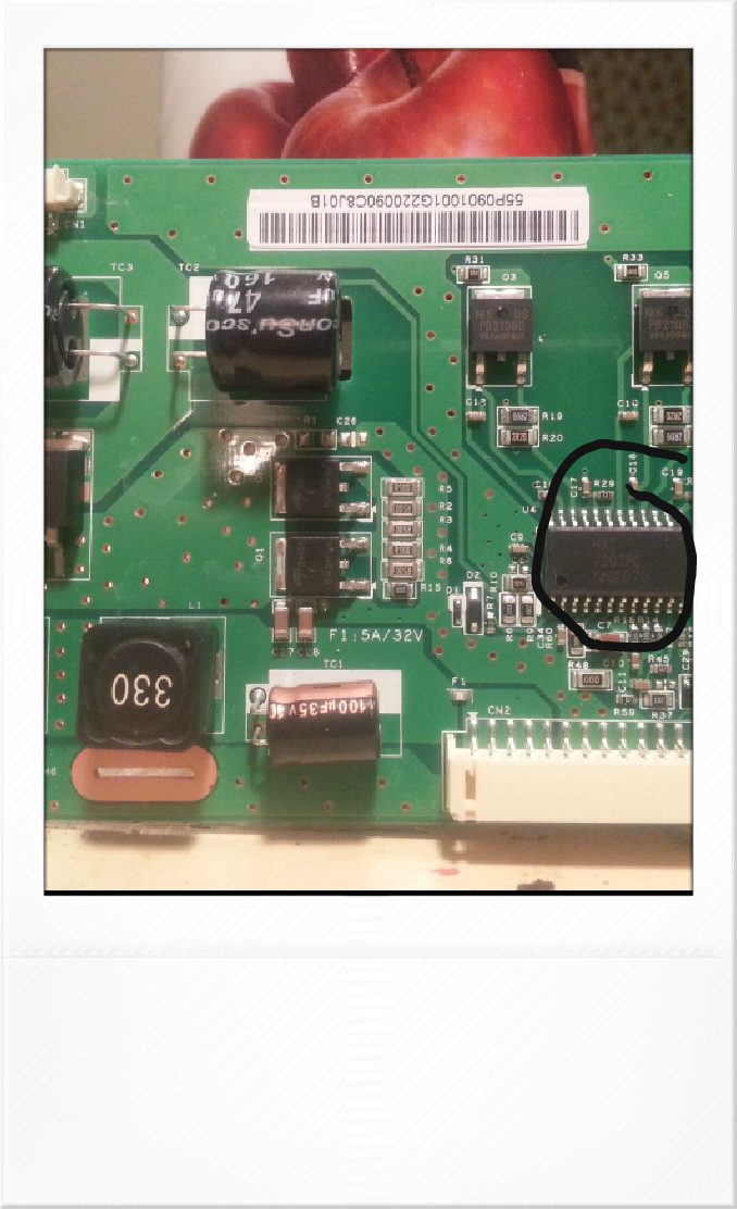

    e420vse no standby light
    found one of these at a recycling place I have done some testing on it .it dosent display standby light
    but has 3.3v standby going to mainboard one fuse was bad f2 on mainboard which is 12v power
    on inital plug in no standby power light only have 3.3 coming from power supply pson and on/off have 3.3v also if I press power button the power supply turns on and sends 12v to mainboard but still no light on vizio logo also I dont get 24v to led panel but I do have 3.3 going to it from power supply

        I came across 10 of these Vizio E420VSE and all had the same problem, a fail LED driver board, check the LED driver board fuse and goes from there. If the fuse isn't blown then check the IC chip HAI 7207PC to see if it getting too hot to touch when you power on the TV

            ok so that hai chip is hot after a min or two the fuse is good
            theres a short from source to ground on the 2 aod4454
            chips

              Ok, here is the good and bad, the good news is you found the problem with your LED HDTV, the bad news the HAI 7207PC is completely out of stock world-wide. I have been trying for months to get the IC chip and I have not been successful.

                  I haven't came across the HAI 7207PC in any other Vizio LED TV, I have three of these E420VSE, I can't fix them until the 7207pc is available. A seller on eBay have a fix but he sold out for now.
                    are we sure these are not the issue
                    and ive contaced a few people about those chips and like you said there are none available
                    the guy on ebay said he will have some in a week or so but who knows but im gonna remove those 2 chips and test them properly
                      Re: e420vse no standby light
                      Source is often grounded on a MOSFET. Not always, it's topology dependent, but often.

                          heres a pic of that led board and the bad chip circled

                                  ok with the driver board unplugged 24 volt isnt turned on when the power putton is pushed 12 volt comes on to the mainboard actually even pluged in it isnt there so theres only 3.3 going to driver board

                                      I have this LED TV on my work bench and there is 83volts on the output where you connect the LEDs, so he had to step-up the output voltage for those LED's to work correctly
