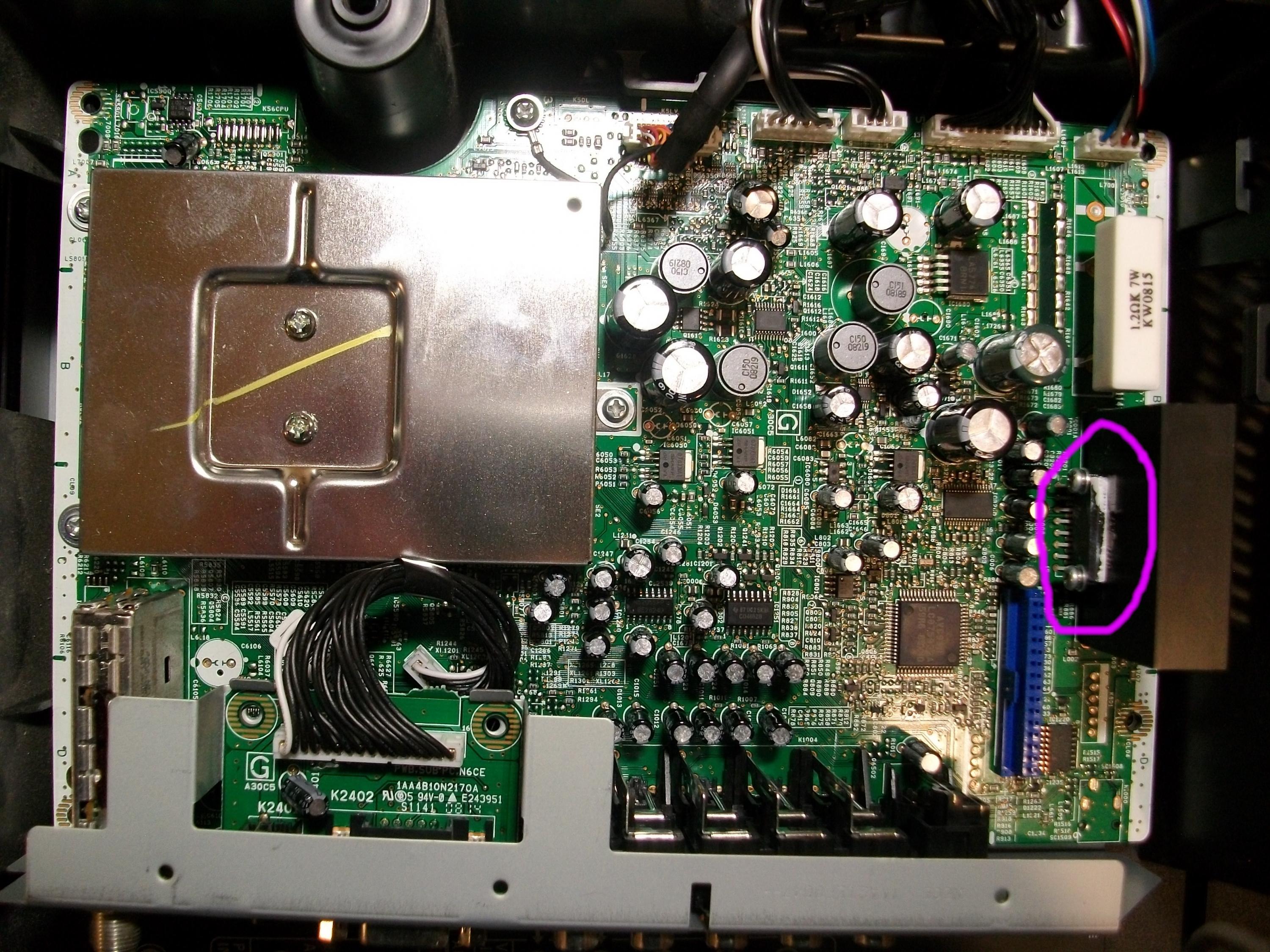

          Thanks for all the help on this TV, You have been great.i guess just wait for the main board to show and hope it works. Should we check anything else?We did not check this see picture circled component

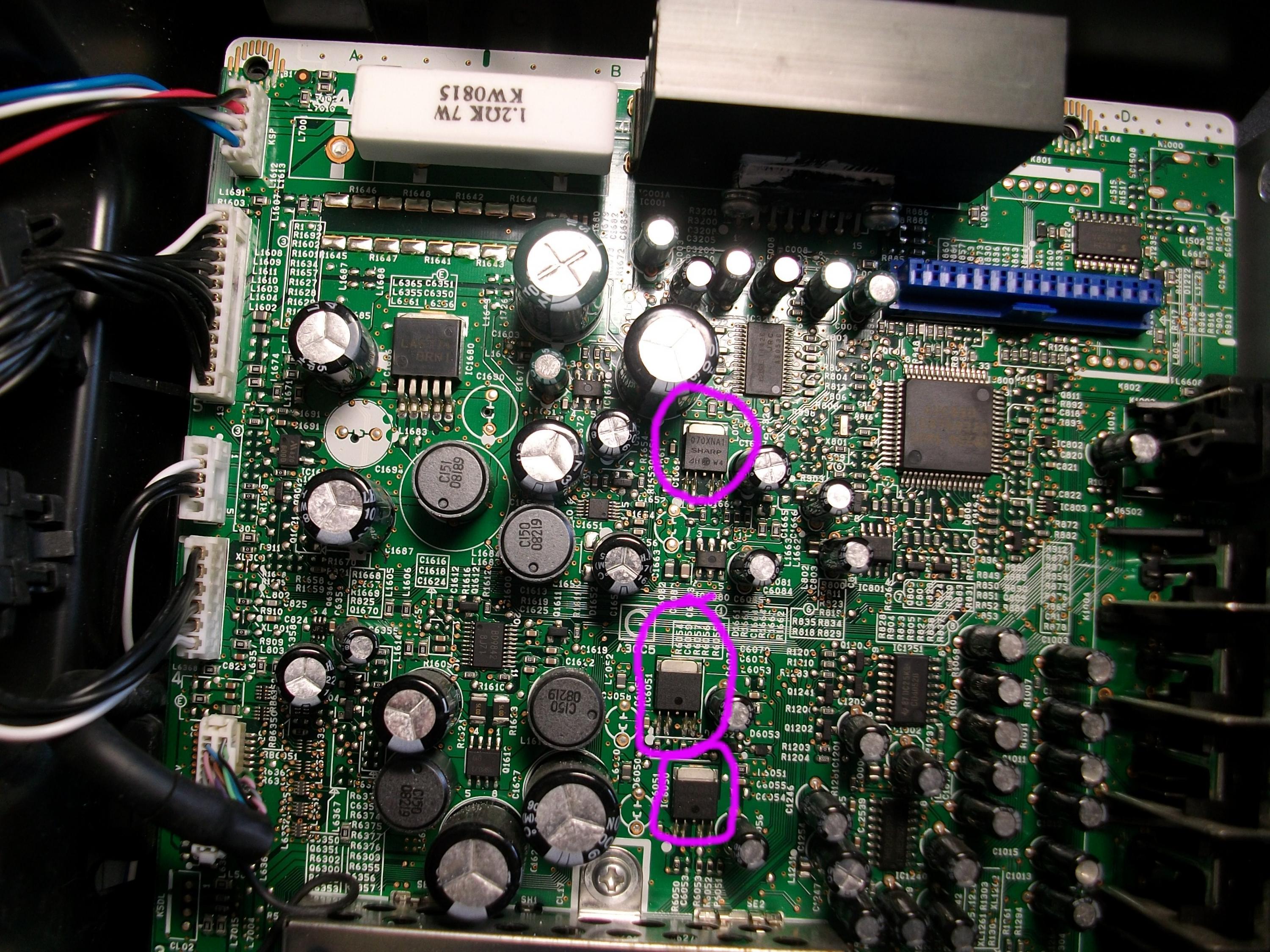

            listed wrong picture here's the right one

              Im not sure what that part does, but if you tell me the part number (im at work so not infront of my dp32648) we can try to find a data sheet and figure out if theres an easy way to test it. I do know that 5v runs to maybe pin 3? i was probing around with contuinity and it was one of the few places where 5v power ran.

                It is an audio amplifier, probably class AB. Less efficient that class D, but lower cost.

                  here's the part number: A42205 8RN4

                    gave you wrong part number here it is again LA42205 8RN4

                      As tom said, its a audio amplifier. id assume the large white resistor there is also for that purpose. Most likely its not what is shorting the board, but either way idk how to test an audio amplifier.
                      https://www.badcaps.net/forum/showpo...2&postcount=44 the part you mention in this post could be the failed part, we never tested it, and i honestly dont know a good way to test it. Pin 1 looks to be the input and Pin 2 or 3 is the output? I could test mine later and tell you what voltages it should have , but that wouldnt prove that the problem is there. Perhaps tom knows how to test that part, should have a diode reading most likely?

                          Re: sanyo DP32648 tv will not turn on
                          I dont have a multimeter at home that has diode tests, which would probably be the more important test to run on some of these parts...
                          But i tested that part and have 24v on pin 1, 12v on pin 2, 0v on the tab and the 3rd pin, and ~ 1.5v on both pins 4 and 5.
                          Pin 2 is 200 ohms from the 5v rail, and pin 1 is >700 ohms, there must be a cap in the way because the resitance rose as i tested it.
                          Based on my tests above, and the data sheet on this part, im very confused why they would put a part to convert 24v to 12v, when they already had a 12v rail going to the mainboard >.> , it does allow a soft start though vs instant on with the power supply...

                            Tested part, I got on pin 1 0.02,on pin 2 0.41, on pin 3 0.00
                            on pin 4 0.05 on pin 5 0.00 and on tab 0.00. How would you test resistance

                              How Would you do diode test? I put my DDM on diode red on pins and black on tab the numbers just rose ever stopping
                                Most Multimeters over 10 dollars have a Diode test, it looks like --|>-- on the dial on the meter ( http://en.wikipedia.org/wiki/Fileiode_symbol.svg ), usually you connect the red probe to the same plug as for voltage readings.
                                It tells you the voltage drop over a diode. A diode is a simple electronic component that allows energy to go in only 1 direction. All chips / regulators / ic's are made of of transistors and diodes for the most part. Because they only allow energy in 1 direction, you have to test each pair of pins twice, once with red probe on the first pin, and once with red on the 2nd pin. If parts that should only allow power in 1 direction are failed / shorted they allow energy in both directions / or dont allow energy to pass through at all.
