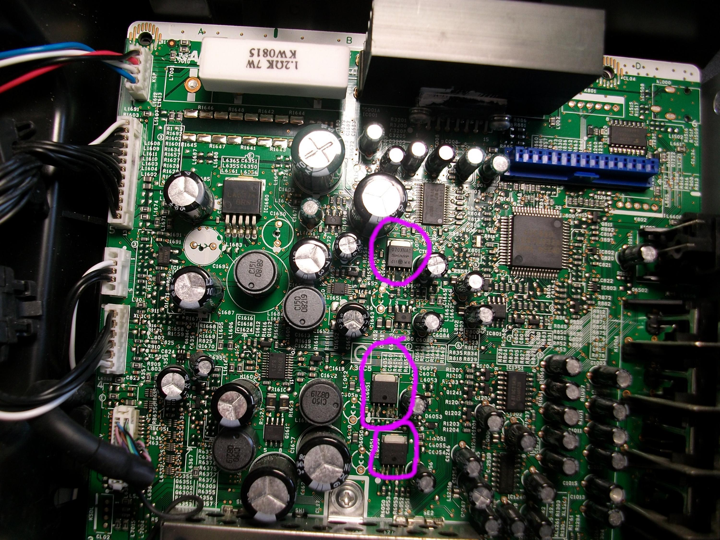

        Need help selldoor in reading data for these 3 regulators see picture and data sheet

          here's that large regulator see picture and data sheet Need help on this one to.

              #46
              Re: sanyo DP32648 tv will not turn on
              That first data sheet makes it sound like its expecting a dc input of 5v most likely on pin 1, and then based on the output voltage adjustment (pin 4) it will fluctuate the output voltage (pin 3 / the tab)? But it also sounds like the choice of resistors on pins 3,4,5 will effect the output?
              So id sugest while it is running tell us what pins 1, 3(the tab) and 4 measure in dc volts. x 3 if there are 3 of these same regulators.

                #47
                Here's the readings
                1 .................2 ................3
                1. 0.33........ 1. 0.32 ....... 1. 0.33
                3. 0.13 ........ 3. 0.00........ 3. 0.22
                4. 0.04......... 4. 0.00 ....... 4. 0.04

                  #48
                  Assuming you read the pins right with 1 as the furthest to the left and 3 as the middle pin / tab, then none of those are receiving the right voltage, or outputing a voltage that would be usefull from what i know...
                  If you upload a picture of the back of the board, we can try to trace where the 12v wires go / where the traces run after entering the board. You do at leaast get 12v while its plugged in at the power socket on the main board (you already tested the 12v at the power supplys socket, and im saying to test for 12v where the same wire connects to the main board. ) mostly just to confirm that the tv is still in the state where all the voltages are turning on and should be reaching the mainboard.

                    #49
                    That's how I read them, We lost 5v on pSB It's now pulsing between 1.8v and 2.9v Same on main board
