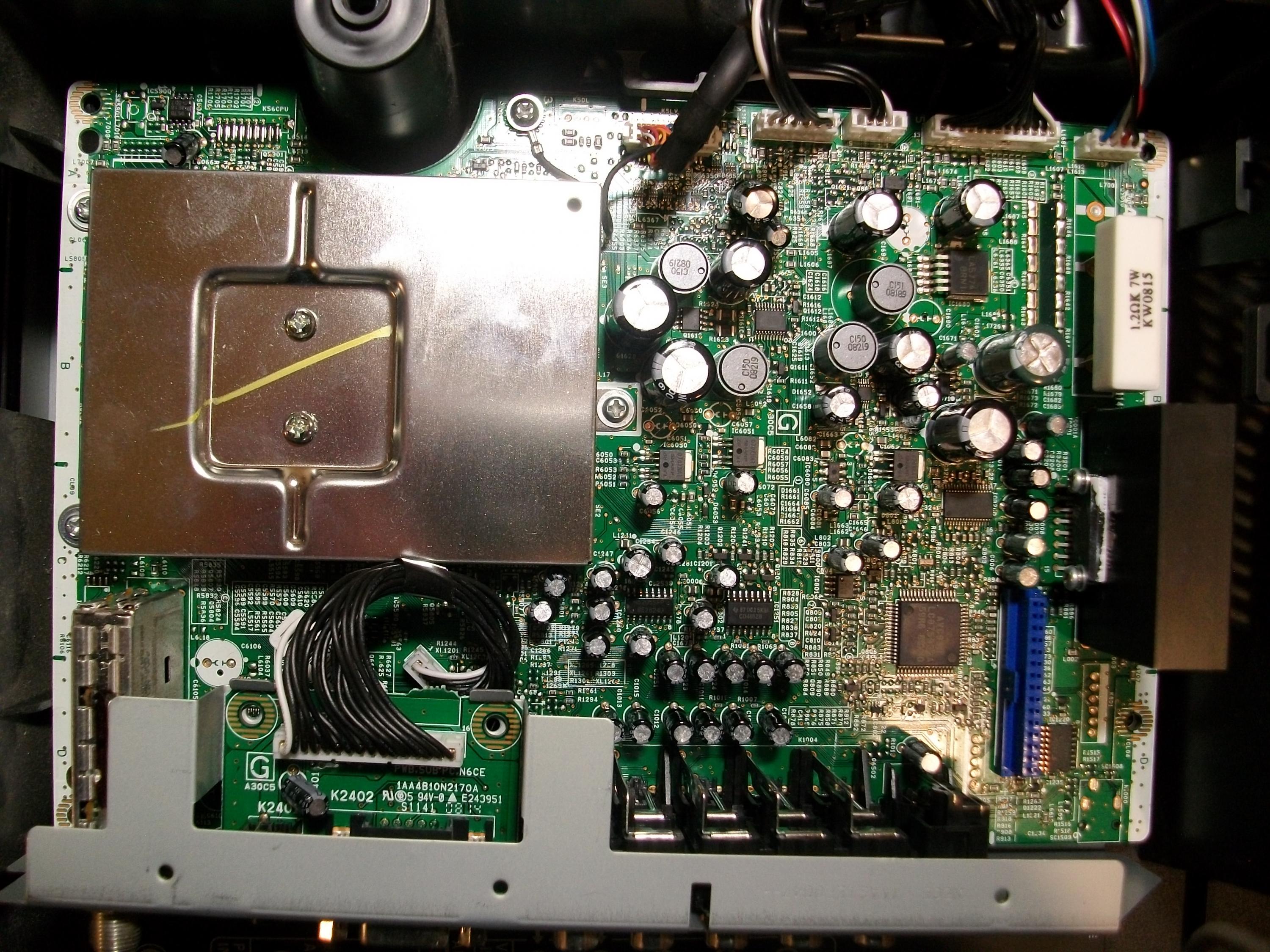

                          Here's a picture of the Main board
                          • CR Designs
                            • Dec 2012
                            • 430
                            #33
                            Re: sanyo DP32648 tv will not turn on
                            What's next?
                            • cashkennedy
                              • Aug 2011
                              • 668
                              #34
                              Thats a incredibly complex / proprietary looking board, even the regulators arent basic 3 pin models... Without a really detailed step by step in the service manual (sanyo service manuals are fairly basic) it would be quite hard to diagnose that board.
                              Id recomend checking any fuses on the board / they are usually tiny white rectangular parts with metal on each end, and are usually designated with a F begging the component number printed on the board. You could also probe around carefully for 12v reaching the board near where the connector from the power supply comes in, usually a fuse will be the first stop for the 12v power after coming from the connector .
                              Fixed so far 12 lcd's , 1 plasmas, 5 monitors, 0 dlp's (plan to keep the dlps at 0). and 3 atx power supplies, and 2 motherboards.
                              • CR Designs
                                • Dec 2012
                                • 430
                                #35
                                has me confused

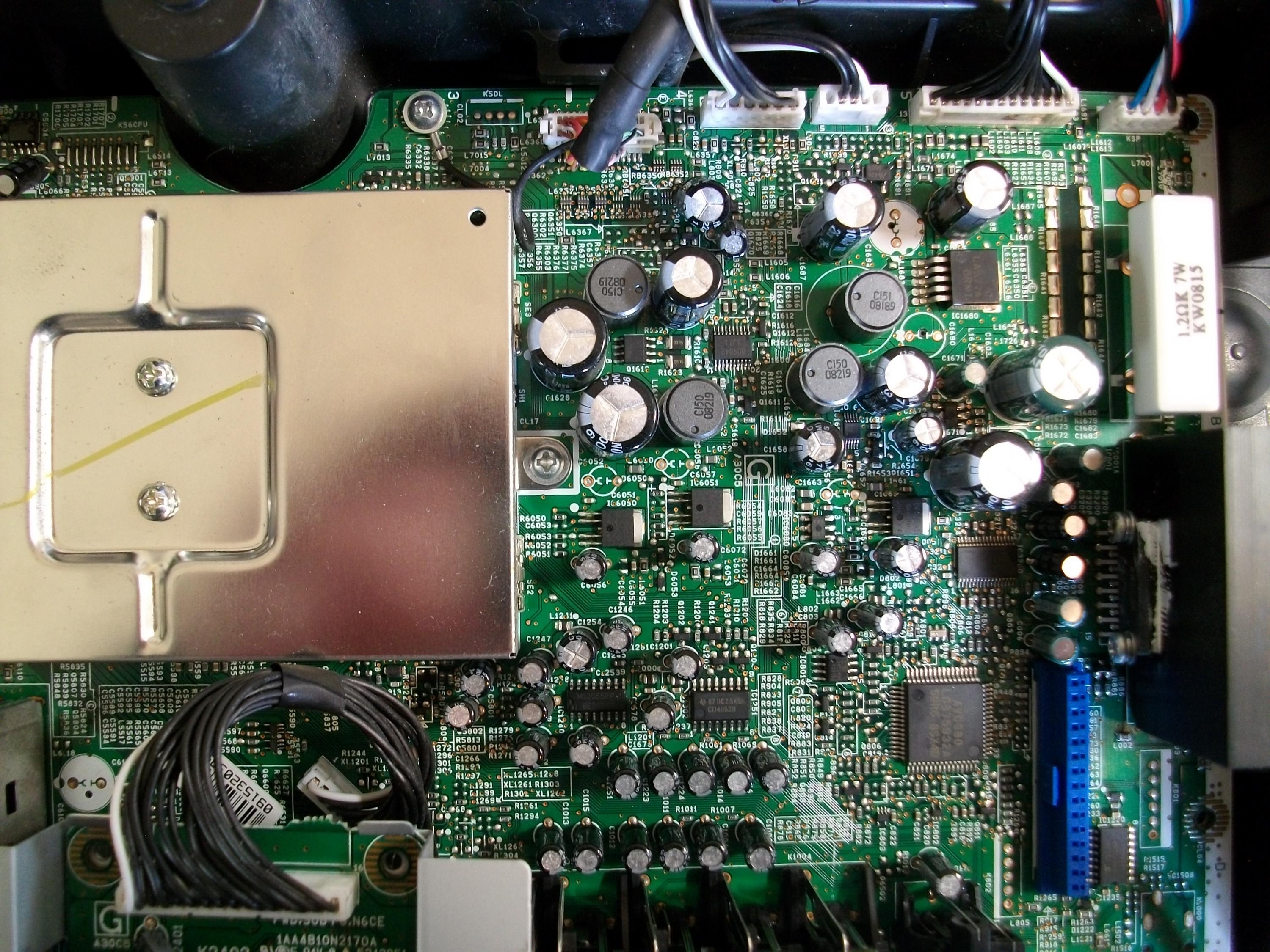

                                  • cashkennedy
                                    • Aug 2011
                                    • 668
                                    #37
                                    Can you post a better picture of the whole main board, i cant tell if the power is comming from the top right of your current pic, or from the small board in the bottom left that is partially cut off in the picture. A picture of the whole back of the set with all the boards in place might help too if you have one / dont already have all the boards spread out.
                                    I dont know how to test 4-5 pin regulators , if thats even what those parts are, im refering to the ones marked ic6050, and ic6051 in the center. With the part number from them i could probably find a data sheet and figure out whats gate source drain so on and figure out how to test it, but perhaps someone here will know if those are even worth testing on this board.

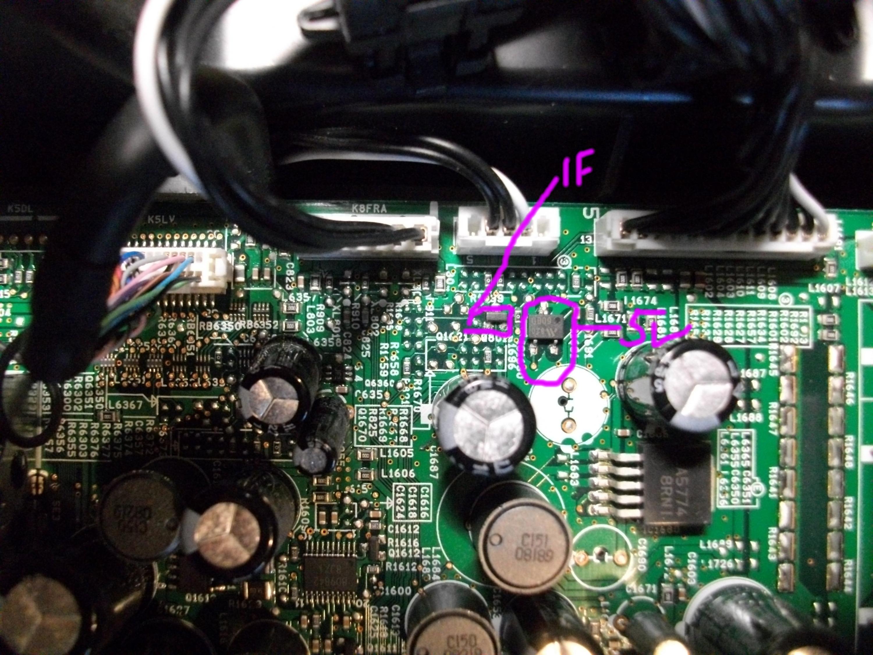

                                    • CR Designs
                                      • Dec 2012
                                      • 430
                                      #38
                                      Check this picture circled items one has 5v and the other has 1f on it. could that be a fuse? I will get more pictures of boards
                                      • CR Designs
                                        • Dec 2012
                                        • 430
                                        #39
                                        try loading the picture again
                                        • CR Designs
                                          • Dec 2012
                                          • 430
                                          #40
                                          More pictures
