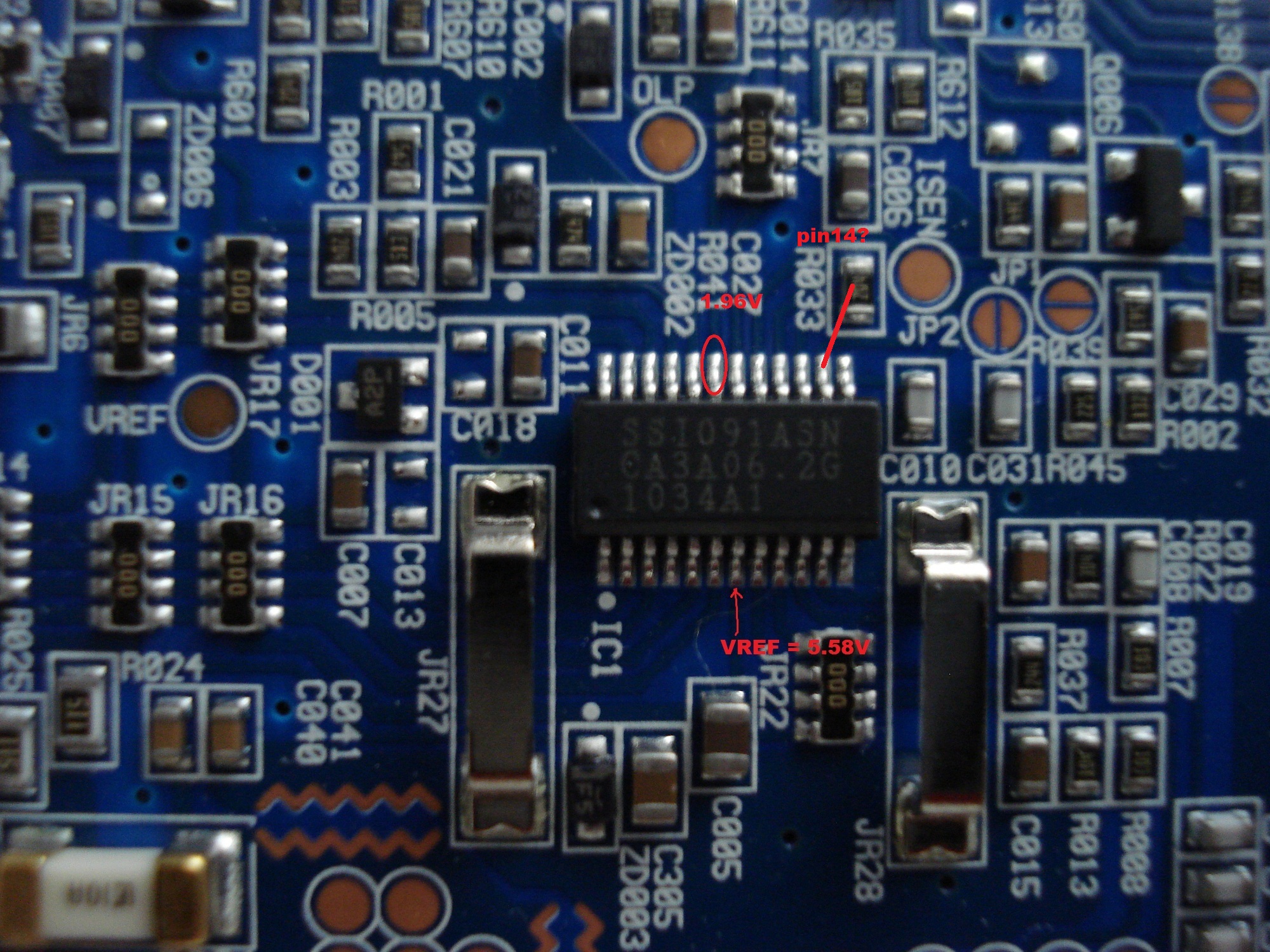

    Re: 40" Sony LCD KDL-40EX500 Seconds to black (6 blinks)
    Originally posted by budm

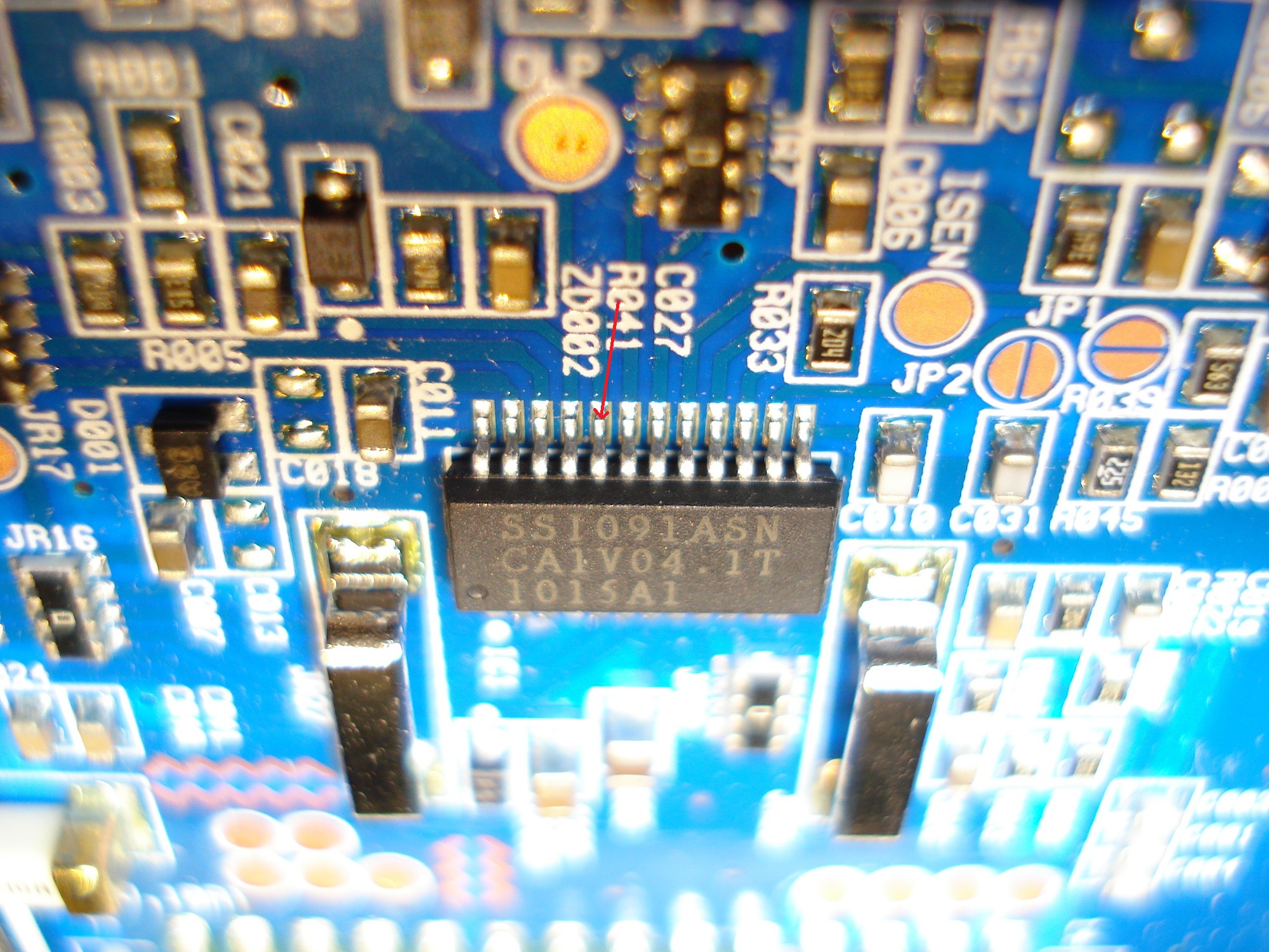

    You are using the new inverter board, correct?
    Yes I'm using the new inverter board.
    Originally posted by tom66
    Those numberings appear correct; OLP is 4th from left on top of chip.
    Do you mean 5th?
    24, 23, 22, 21, 20<-

      Very good. Indeed, I cannot count.
        So measuring this pin, I'm getting -0.004V when the lights go off, and -0.063V on.
          #124
          Does it rise at all when it cuts out, or fixed <0.1V?
          • tieny
            • Feb 2012
            • 478
            #125
            when the backlights turn on it goes to -0.063V on, when the lights dim, -0.006, and off -0.004. and thats it as it cycles
              #126

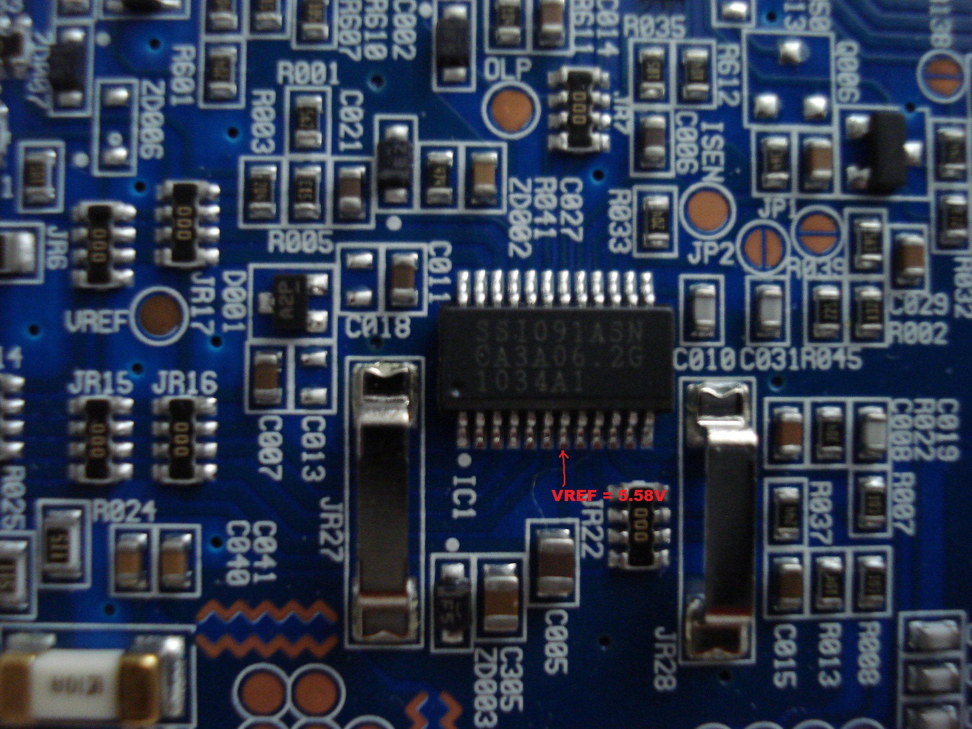

              Is nearby bad OLP the same voltage?
              What's VREF measure?

                #127
                What do you mean by nearby bad OLP?
                pin 7 (VREF) i'm measuring is 5.58V
                  #128
                  bad->"pad".
                  Noted there is VREF pad, so check that too.

                    #129
                    Heres something interesting I found...
                    When I'm measure this pin, (PIN #19 i think) ill be 0.01V when the backlights go on.
                    And as it dims when it gets to the HDMI input. It'll raise up to 1.96V steady THEN the TV actually stays on and works!! But as soon as I remove my probe from the pin the TV turns off and starts cycling through the problem again?
                    I had a similar problem like this with that 32" dynex, where I just resoldered the ground pins and it fixed the problem (But only lasted 20 minutes til it fully died with a main board problem and I gave up on it)

                              #134
                              On the pad, VREF reads 5.56V, OLP measures -0.01 when lights go off and -0.09 when its on
                                #135
                                Everything looks fine.. Very odd!
