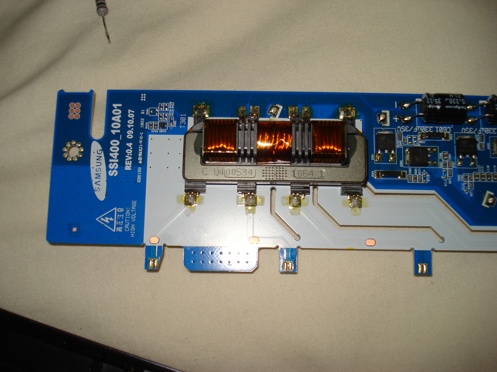

40" Sony LCD KDL-40EX500 Seconds to black (6 blinks)
    Re: 40" Sony LCD KDL-40EX500 Seconds to black (6 blinks)
    It is Samsung LCD, so it uses U-shape CCFL
    http://backlightweb.co.uk/images/lar...ture%20007.jpg
    So each group of two pins (going to transformer secondary) is one bulb connection; that is where you should test.

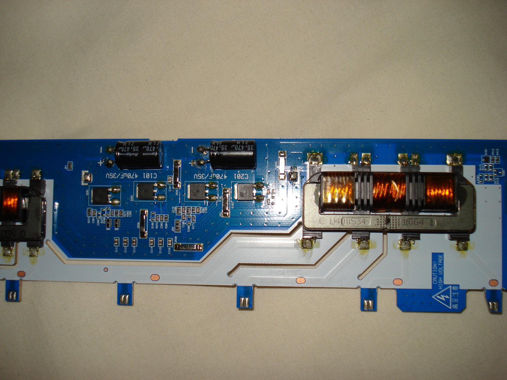

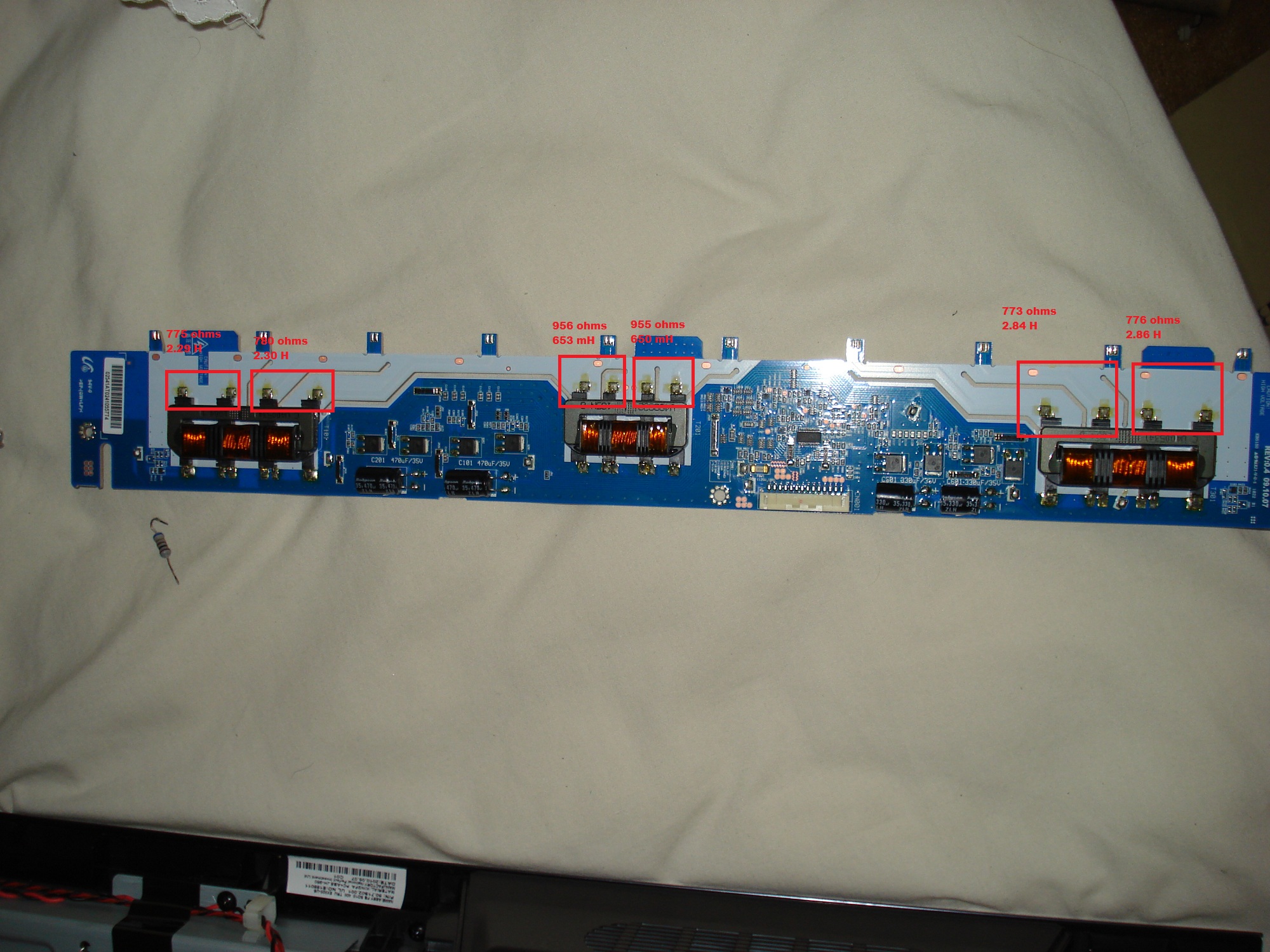

      heres what I got (see photo)
        Seems OK. Looks to use a design where the middle of the panel is driven using a smaller transformer, odd design. I'd look elsewhere on the inverter, can we have close up pic around each transformer?

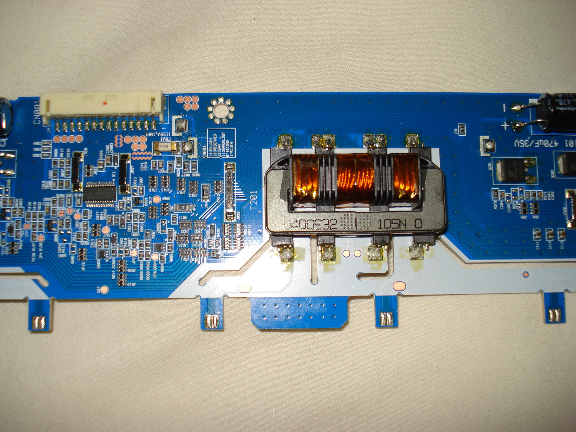

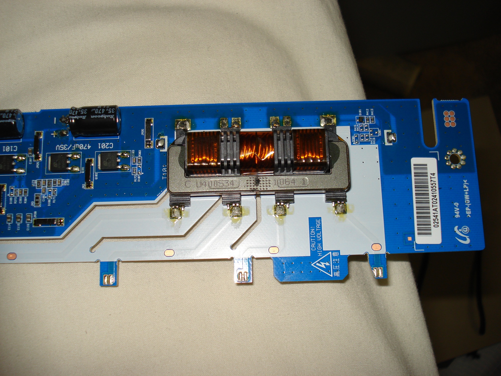

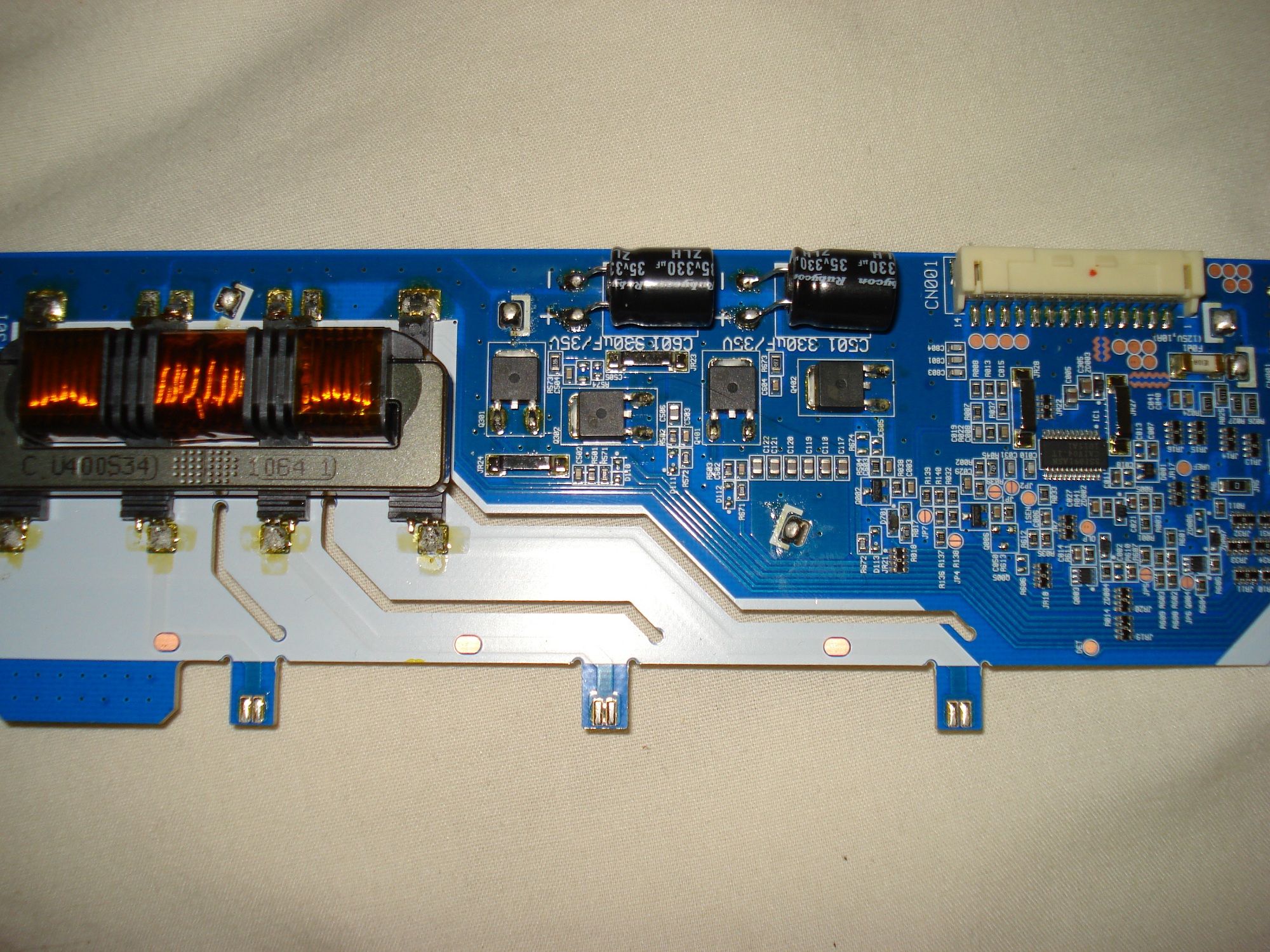

          more photos
            OK, looking at pic:
            https://www.badcaps.net/forum/attach...9&d=1359332628
            D101 is one diode for the error feed back.
            There will be one other diode for each transformer.
            Check the single lone pin for a voltage on each diode.
              I found the diodes for the left and right transformers but couldn't find the one for the middle one.
              Both D101 and D103 measure at 3.63V when the backlights come on and 0V when off then itll increase by 0.04V with each cycle.
                3.6V is too high (will cause shutdown... normal working voltage 1~2V), so measure each of the two pins adjacent, and we will find which bulb or transformer is causing the problem. (Use volts AC.)
                  So AC voltage, black probe on right pin and red on the left pin?

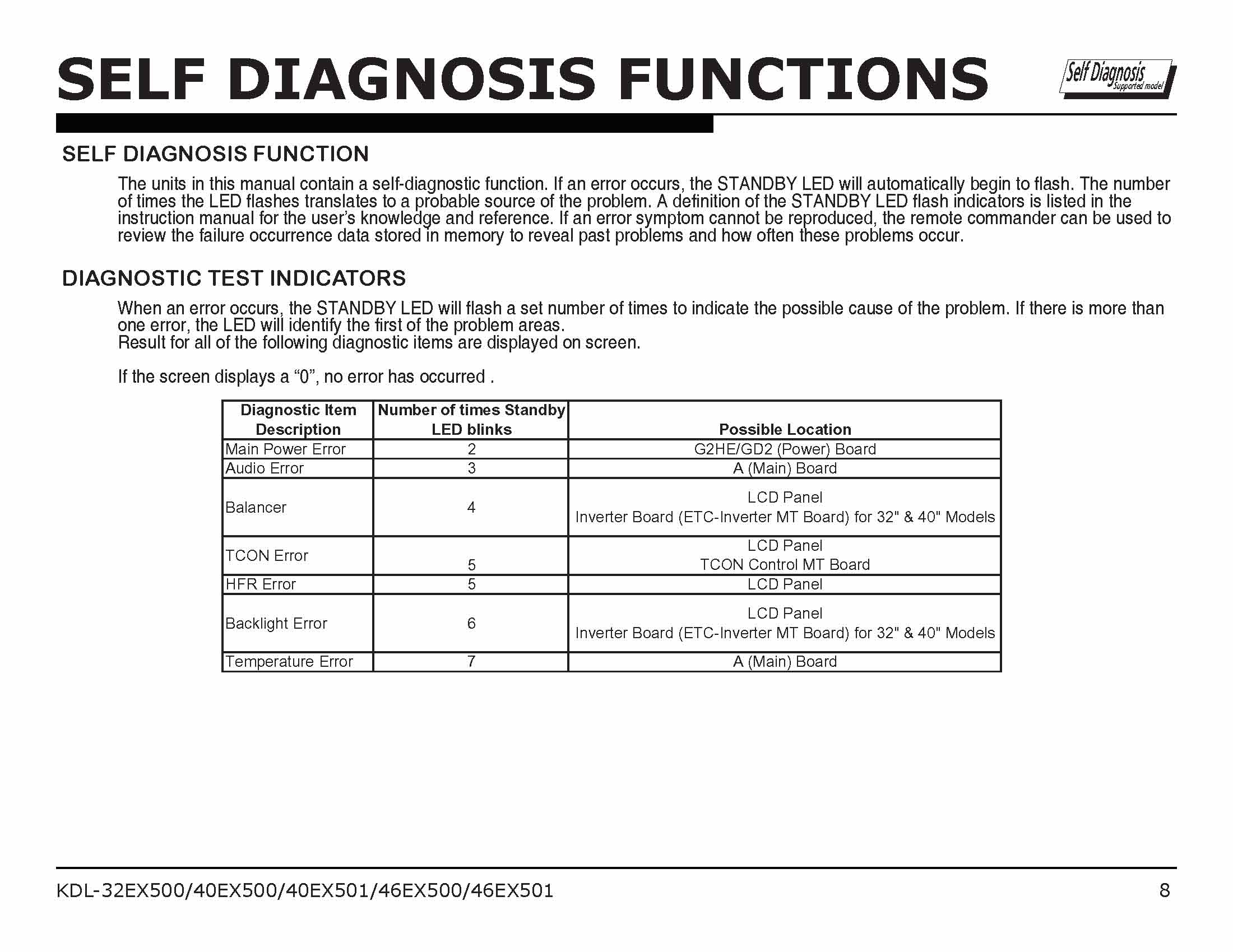

                    Service manual:
                    http://elektrotanya.com/?q=showresul...oria=&kat2=all
                    You may want to look at shopjimmy for the replacement Inverter board.
                        Ebay is selling a bunch of these inverter boards for only about $12 including shipping, pretty cheap.
                        Even though the lamps are able to turn on prefectly, is it possible for it to still be bad?
                        I measured both diodes and they give me 9.5VAC
                          I'd just go for the board at $12. It's pretty unusual for the bulbs to fail without showing obvious signs (pink colour/flickering/dimmer than the rest, etc.)
