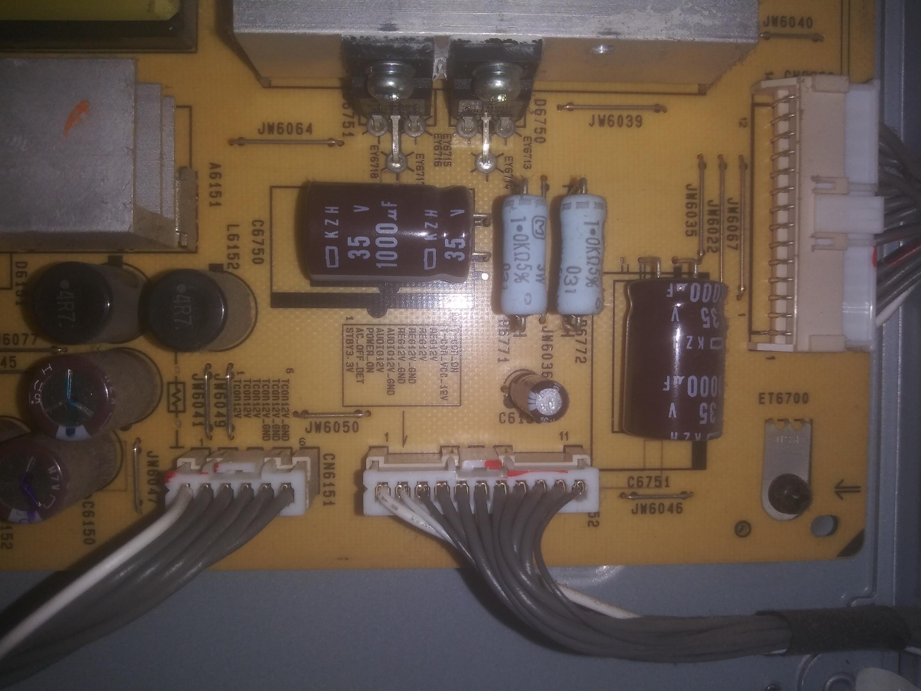

        Pic of Powerboard:
          Re: Sony XBR-52HX909 No Power -Red LED blinks 5 times
          Please avoid adding pictures to posts in line, instead use the manage attachments feature in future.
          I need a picture of the chassis to determine what design this uses (24V or high voltage inverter.)
            This TV uses LED backlights, still cannot find the error codes for this TV yet, still researching. Try disconnected the CN6752 which feeds the LED backlights assemblies and see what happen.
            Please take the DC voltage readings on CN6151, CN6152 also.

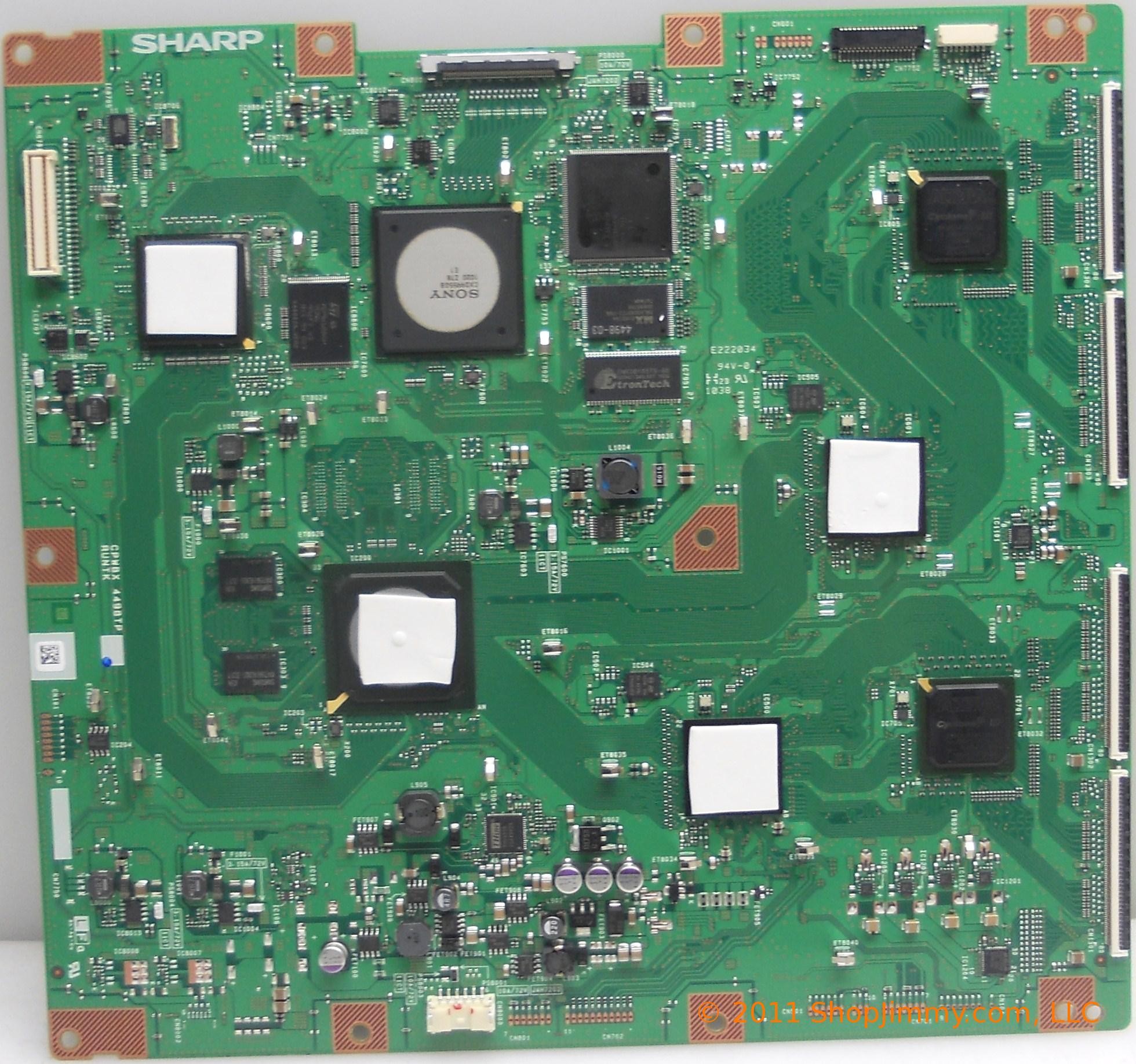

              Check the T_CON fuse... five flashes is a t-com problem.

                So guessing there is something off with the t-com?
                Going to check the fuse on the t-con board. Will post back with results.
                • DigitalStone
                  • Jan 2011
                  • 39
                  Count 5 fuses labeled SOC72v T 3. (White)
                  Didint see anything labeled F1. only 2 had an f ( F1000 and F1001 )
                  All give readings that they are still good. Unless I missed one... Bit new at this. These things are Sooooo. Tiny.
                  Link to a zoomable pic. T-CON
                  Cannot see any sign of damage to the board. No burning or smelling burnt.

                    I soldered a fine piece of wire on top of my fuses and my screen came right on and blinking light stopped. I shut it down and got two new fuses and soldered them on. TV works great now. We had a transformer in the neighborhood that surged before it burned out.Your pictures are not the best quality to work with. f-1000 & f-1001 are the fuses to check. Dont trust there reading unless at least one end is off circuit board..
