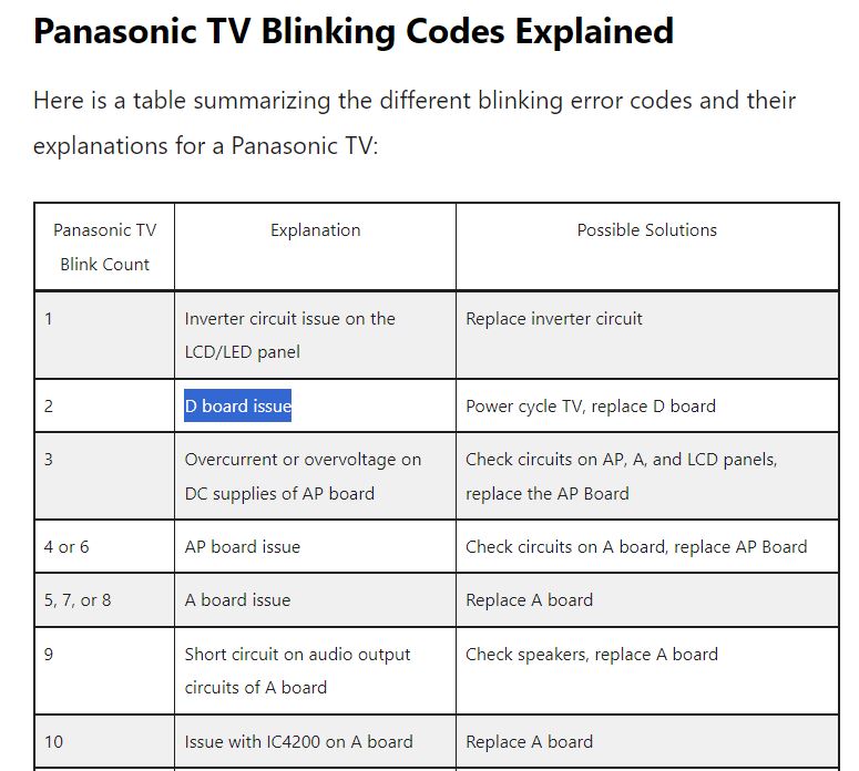

    Hi there
    I have this set with no power, blinks power led twice.
    This seems to point out to D board issue
    My first question is which one is the D board?
    The main board?
    Or one of the power boards?
    Are they labeled with this? (did not checked the boards yet)
    Thanks for any inputs

    Re: TX-65FZ800E - blinks 2 times red led no power
    D board seems to be the equivalent of a T-CON in a normal TV, I don't know why Panasonic have create a whole list of cryptic names for their boards
    A picture of the inside on the TV would help in further diagnosing it!

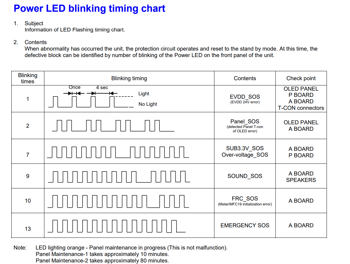

      TX-65FZ800E - Chassis LA76
        Thanks Lotas.
        So could be the Tcon or the OLED panel...
        Gonna try with new TCON and see if it works again.
