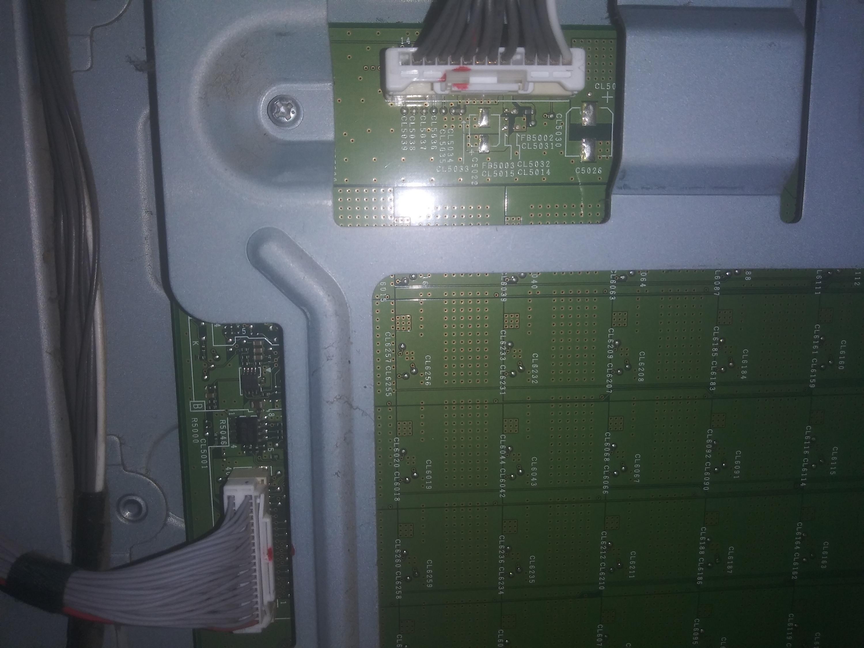

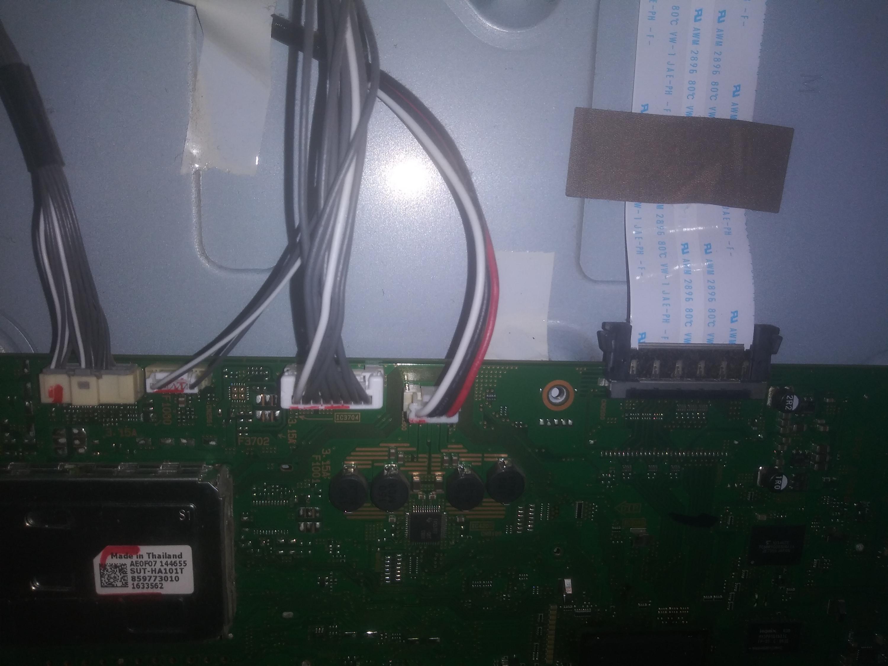

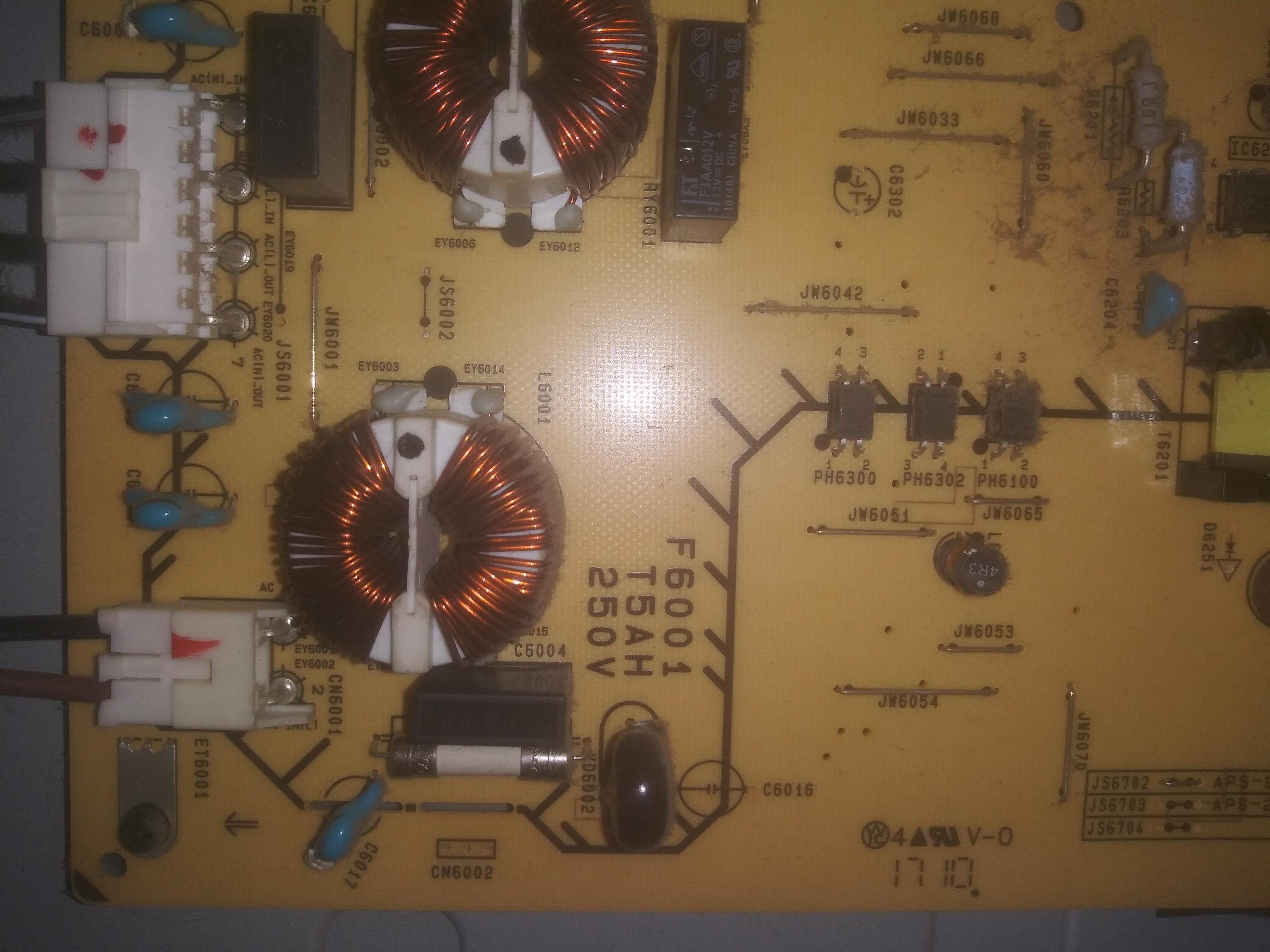

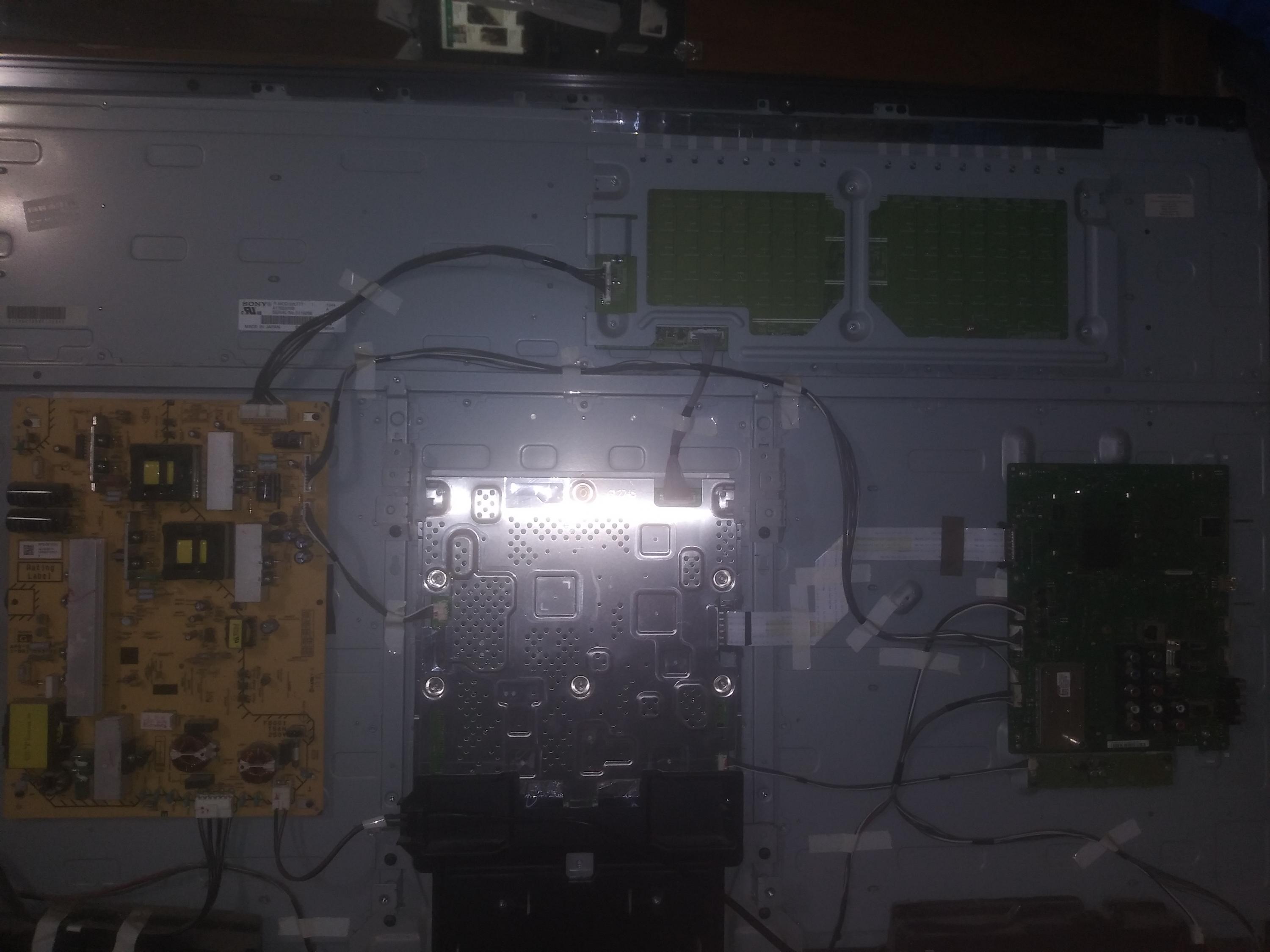

Sony XBR-52HX909 No Power -Red LED blinks 5 times
  • renee
    replied
    Re: Sony XBR-52HX909 No Power -Red LED blinks 5 times
    please help me to find volts PRI_VCC on C6206 sony G6 power supply
    Leave a comment:
  • tvfixer007
    replied
    Re: Sony XBR-52HX909 No Power -Red LED blinks 5 times
    Sorry I had to take a break and do tons of house work. I got back to the TV. On the LED drive board I used Ohm to test the fuses.
    On the t-con board I tested voltage with one probe on chassis I get 12.56v on each side of every fuse. Before the red light sequence.
    Leave a comment:
  • nomoresonys
    replied
    Re: Sony XBR-52HX909 No Power -Red LED blinks 5 times
    So two weeks then?
    Leave a comment:
  • tvfixer007
    replied
    Re: Sony XBR-52HX909 No Power -Red LED blinks 5 times
    I'll check the fuses today and report back.
    Leave a comment:
    replied
    Re: Sony XBR-52HX909 No Power -Red LED blinks 5 times
    Originally posted by tvfixer007
    I checked the fuse on the LED board meter reads 000.1
    Tested voltage across each end of fuse and meter reads 12.68
    Can you please clarify as to how you perform the test?
    Did you put meter probes on each end of the fuse and it shows 12V, or you keep one probe on the chassis at all time and then probe each end of the fuse one at a time and it shows 12V on each end?
    Last edited by budm; 08-08-2019, 09:48 PM.
    Leave a comment:
  • nomoresonys
    replied
    Re: Sony XBR-52HX909 No Power -Red LED blinks 5 times
    There are two connectors going to tcon, one going to mainboard and one going to powerboard, looks like one of those signals is missing?
    Last edited by nomoresonys; 08-08-2019, 05:56 PM.
    Leave a comment:
  • nomoresonys
    replied
    Re: Sony XBR-52HX909 No Power -Red LED blinks 5 times
    OK, just to verify, turn tv on, check tcon fuse, black probe to chassis ground red probe to each side, is there around 12 volts on each side, might be 0? Check it for continuity too.
    Last edited by nomoresonys; 08-07-2019, 04:19 AM.
    Leave a comment:
  • tvfixer007
    replied
    Re: Sony XBR-52HX909 No Power -Red LED blinks 5 times
    Originally posted by R_J
    The led board supplies the LED_ON command, if it is not there the VLED_VCC will not be there. There is a fuse on the led driver board (PS7000)
    I checked the fuse on the LED board meter reads 000.1
    Tested voltage across each end of fuse and meter reads 12.68
    Last edited by tvfixer007; 08-06-2019, 01:21 PM.
    Leave a comment:
  • tvfixer007
    replied
    Re: Sony XBR-52HX909 No Power -Red LED blinks 5 times
    Thanks for the replies.... here are the results. Seems the t-con isn't receiving voltage.
    TV OFF readings
    1.STBY3.3 3.342v
    2.AC_OFF_DET 3.343
    3.POWER_ON 0.002
    4.AUDIO12V 0.055
    5.AUDIO12V_GND 0.000
    6.REG12V_GND 0.000
    7.REG12V_GND 0.000
    8.REG12V 0.055
    9.REG12V 0.055
    10. T-CON_VCC_12V 0.055
    11.T-Con_ON 0.000
    TV ON readings
    1.STBY3.3 3.342v
    2.AC_OFF_DET 3.343
    3.POWER_ON 3.284
    4.AUDIO12V 12.68
    5.AUDIO12V_GND 0.000
    6.REG12V_GND 0.000
    7.REG12V_GND 0.000
    8.REG12V 12.67
    9.REG12V 12.67
    10. T-CON_VCC_12V 12.67
    11.T-Con_ON 0.000
    Last edited by tvfixer007; 08-04-2019, 08:19 PM.
    Leave a comment:
  • R_J
    replied
    Re: Sony XBR-52HX909 No Power -Red LED blinks 5 times
    The led board supplies the LED_ON command, if it is not there the VLED_VCC will not be there. There is a fuse on the led driver board (PS7000)
    Last edited by R_J; 08-01-2019, 01:02 PM.
    Leave a comment:
  • nomoresonys
    replied
    Re: Sony XBR-52HX909 No Power -Red LED blinks 5 times
    Test connector from mainboard to powerboard on powerboard side with all boards hooked up, test with tv plugged in but off then hit power, report both conditions here, give pin number, pin description/name and condition both off and when you hit power on. So we can see all the voltages and what they are doing.
    Leave a comment:
  • tvfixer007
    replied
    Re: Sony XBR-52HX909 No Power -Red LED blinks 5 times
    Originally posted by newworlds88
    Hi; regarding your power board. Do you have any additional pics with the board assembled with all connections. For example: CN6752 so I can view the cable connection there? Please advise. Thanks and be well.
    Maybe we can start where OP left off? I came across this same TV with 5 blinks as well.
    Checked t-con board fuses and they are okay. Checked voltages on the PSU and During power on phase before the LED blinks all voltages are normal, except for backlights only shows 1.5v during power on phase, and then it drops to 0v with and without the LED driver board connected.
    Did a reflow on the mainboard. Thinking it's a power supply issue. Any other assistance would be grateful!
    Leave a comment:
  • nomoresonys
    replied
    Re: Sony XBR-52HX909 No Power -Red LED blinks 5 times
    Originally posted by newworlds88
    Hi; regarding your power board. Do you have any additional pics with the board assembled with all connections. For example: CN6752 so I can view the cable connection there? Please advise. Thanks and be well.
    Always check date of last post, no post on this thread for 6 1/2 years.
    Leave a comment:
  • newworlds88
    replied
    Re: Sony XBR-52HX909 No Power -Red LED blinks 5 times
    Hi; regarding your power board. Do you have any additional pics with the board assembled with all connections. For example: CN6752 so I can view the cable connection there? Please advise. Thanks and be well.
    Leave a comment:
    replied
    Re: Sony XBR-52HX909 No Power -Red LED blinks 5 times
    Testing it first would be a good idea. Is it actually failed?
    Leave a comment:
  • DigitalStone
    replied
    Re: Sony XBR-52HX909 No Power -Red LED blinks 5 times
    Where can I get a suitable fuse replacement? Never ordered a smd fuse from Digikey before.
    Leave a comment:
  • splitcrete
    replied
    Re: Sony XBR-52HX909 No Power -Red LED blinks 5 times
    I soldered a fine piece of wire on top of my fuses and my screen came right on and blinking light stopped. I shut it down and got two new fuses and soldered them on. TV works great now. We had a transformer in the neighborhood that surged before it burned out.Your pictures are not the best quality to work with. f-1000 & f-1001 are the fuses to check. Dont trust there reading unless at least one end is off circuit board..
    Last edited by splitcrete; 01-21-2013, 11:37 PM. Reason: more info
    Leave a comment:
  • DigitalStone
    replied
    Re: Sony XBR-52HX909 No Power -Red LED blinks 5 times
    Count 5 fuses labeled SOC72v T 3. (White)
    Didint see anything labeled F1. only 2 had an f ( F1000 and F1001 )
    All give readings that they are still good. Unless I missed one... Bit new at this. These things are Sooooo. Tiny.
    Link to a zoomable pic. T-CON
    Cannot see any sign of damage to the board. No burning or smelling burnt.
    Leave a comment:
  • DigitalStone
    replied
    Re: Sony XBR-52HX909 No Power -Red LED blinks 5 times
    Disconnected the CN6752 and got the same pwr on for a bit then shuts off with the 5 red blinks. Unplugged the CN6151 and got the same thing.
    Took readings on the CN6161 and got:
    pins 1-3 = 12v
    Pins 4,5 & 6 = 3.4v
    On the CN6152
    pin:
    11 = 3.3
    10 = 12.6
    9 = 12.5
    8 = 12.5
    7 = -1.5
    6 = -1.5
    5 = 3.8
    4 = 16.6
    3 = 3.3
    2 = 3.3
    1 = 3.3
    So guessing there is something off with the t-com?
    Going to check the fuse on the t-con board. Will post back with results.
    Last edited by DigitalStone; 01-21-2013, 08:54 PM. Reason: oops
    Leave a comment:
  • splitcrete
    replied
    Re: Sony XBR-52HX909 No Power -Red LED blinks 5 times
    Check the T_CON fuse... five flashes is a t-com problem.
    Last edited by splitcrete; 01-21-2013, 06:57 PM. Reason: update
    Leave a comment:
