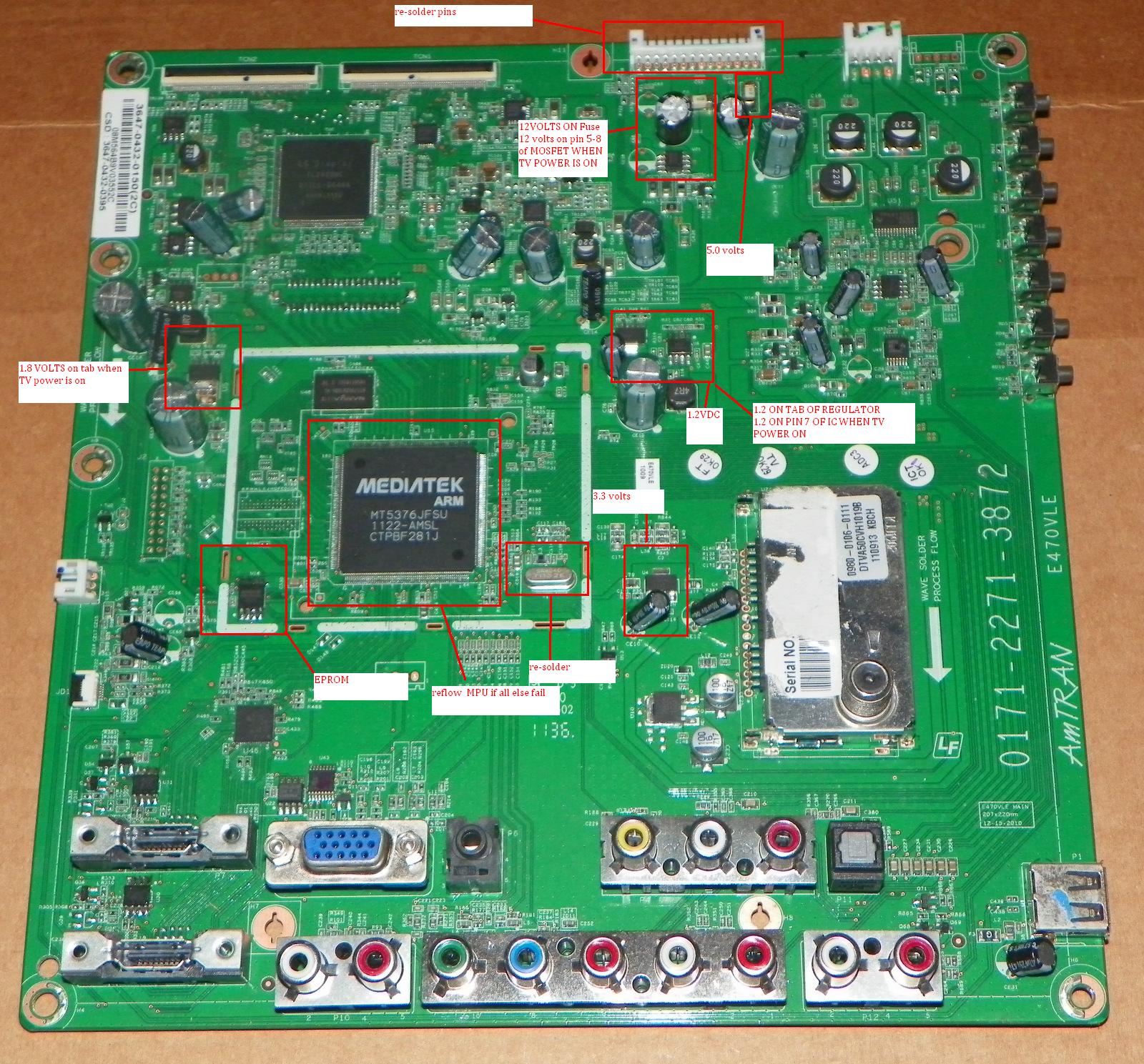

      Went and got voltage from EEPROM - U18 and this is what I got. Can anyone let me know if this is reading right or is this a way to tell if it is indeed defective? Not sure if anyone has tried to pull the voltage ever from this Chip.
      Just Ordered the New one just in case.

              I have a working E470VLE main-board, I took measurements with the TV is in stand by and then power on.
              measurement in stand by:
              only U4= 3.28VDC
              F1 FUSE= +5VDC
              Measurement TV power on:
              See picture.
              The sound like an EPROM problem
              hope this help

                Ill check it against mine here on a minute. Mine just stays with orange vizio logo on "standby" mode. Nothing ever shows on the screen or even attempts to come on at all!

                  Ok checked it against mine. I get 5v at the fuse on both sides. So while waiting on the EEPROM I will re check solder points where you suggest. Since I cannont check any connections that would have voltage with tv on.

                    you didn't check U4? Its a 3.3 volt regulator

                      I am checking it now. I realized I forgot to check that. I haven't re soldered anything yet.

                                * Update: With ecking767's Picture I measured 3.3v on U4 Tab and 1.2v from the tab directly north of U4. Still no sign of the new EEPROM yet...

                                  You didn't read my measurement correctly, I only had +5 volts on the fuse and 3.3 volts on U4 regulator. all other regulators became active when the TV power is on.
                                  I will reconfirm my measurements later

                                    I didn't test the 8 legged IC next to the north chip, because I cant get the tv on. Stuck in what appears to be stand by. See Attached!
