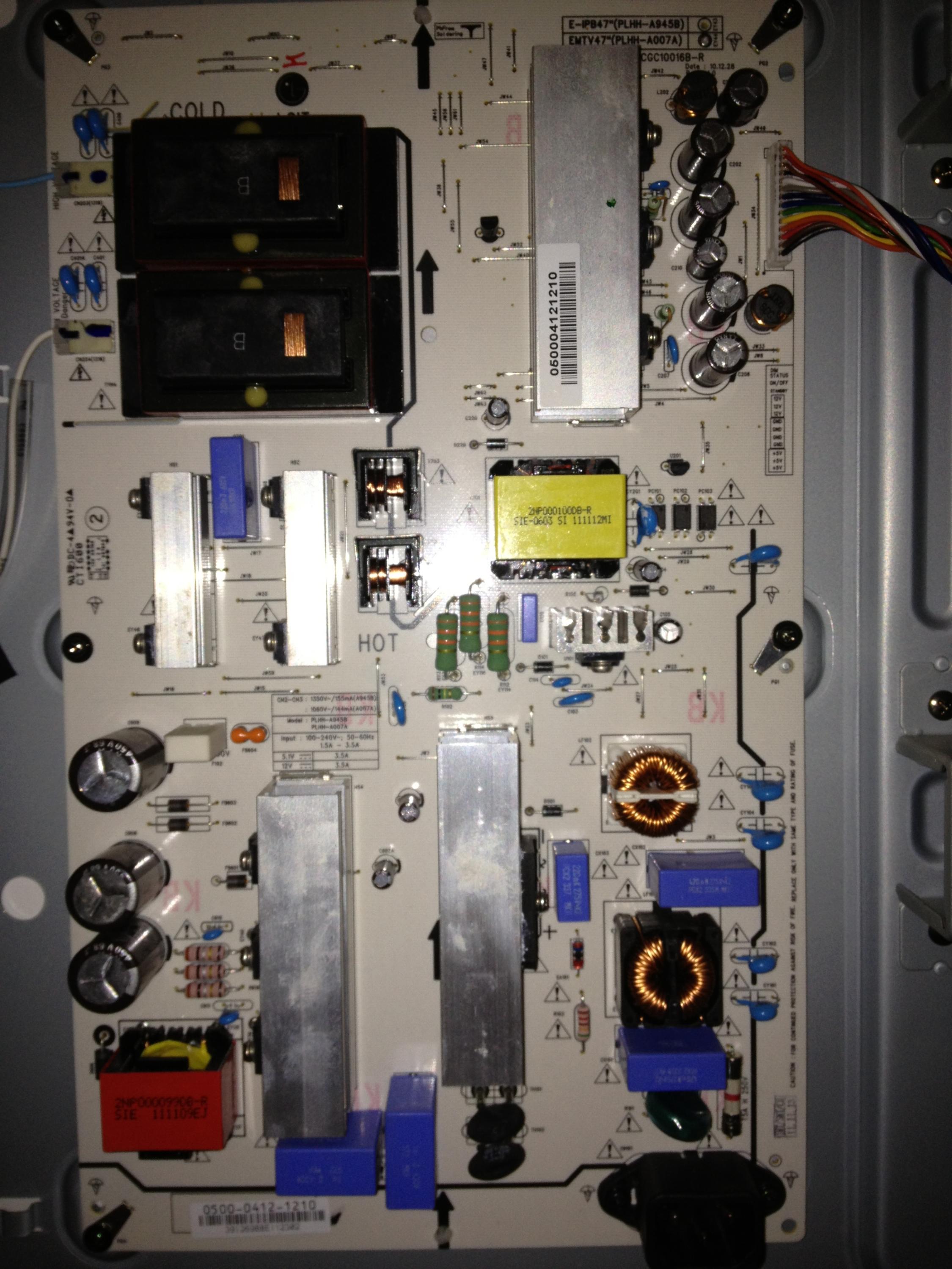

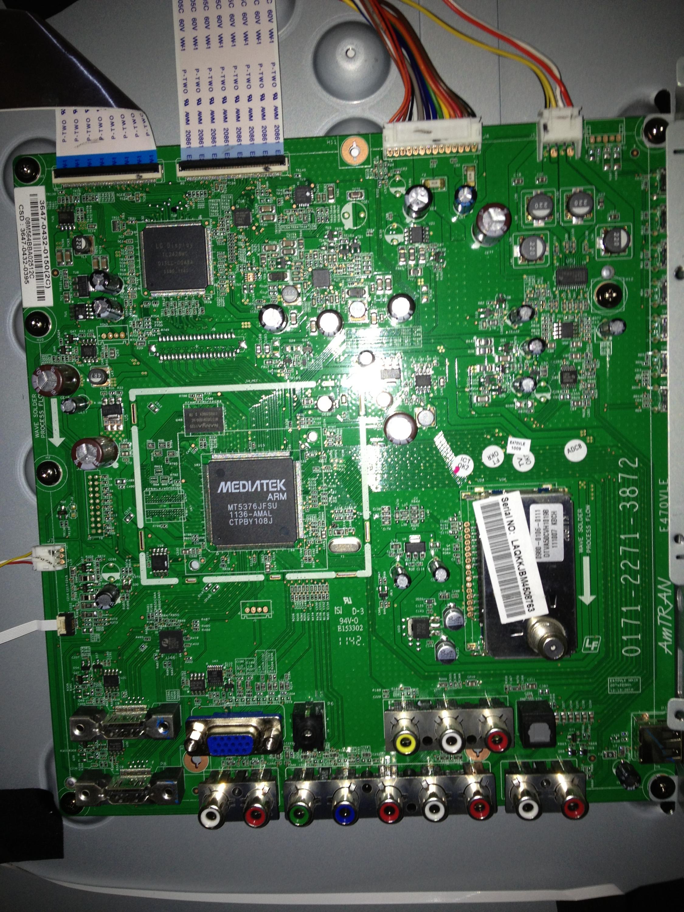

    Ok, yes I am new here and no I didn't think of joining til I had my first issue I cant seem to solve. I have as stated above a E470VLE in pretty good condition come into my hands because the owner could not invest time into it to fix the issue. Now I saw this TV power up actually a day ago actually last night with no source hooked up to it.
    Now I am some what knowledgeable and of course plugged the tv in once I got home and nothing. Just Orange light, no blinking, no powering up. I have had to replace caps before on a few tvs Polaroid, Samsung, and even Sony. But this tv doesn't appear to have any caps needing to be replaced. I mean visually I cant see any cracking or deteriorating. I have checked the main PCB Fuse and it is not blown. Also checked the two tiny little fuses at the end of the bridging wiring harness and they have a connection fine. But other than that I am stumped. Ohh and I even tried the Vizio Approach, and unplugged the tv held the power for say 50 sec to a minute and then plugged back in and not joy.
    Help guys please. I will post pics of the two boards and I don't know what else may be needed to see but just ask me and I will upload as soon as I can.

    Have you removed the back and done any basic voltage tests yet and found what voltages are present.& what voltages are not present .
    I have a tester that i hold against the switch mode transformer it tells me if the transformer is running or not .
    Simple but it helps at knowing where to start!

        The first thing to do is to measure the voltage accross the mains filter
        capacitor negative lead on meter to negative pin on the capacitor and positive to the positive pin on the cap and report back , set meter to DC. We need to know if the power supply won't start for example no start up voltage to the pwm chip or bad start up resistors etc.
        Or is the fault some thing shorted on the secondary side which is disabling the psu from running.

            If the main cap is that first blue box next to the main fuse I get 113-114v dc through it.

              Could you take your Meter and check the DC voltages on each wire connection on the top right 14 wire connector on your power supply board, I see the legend marked on the board just below the connector, Plug the TV In, Set your meter to DC Volts and hook the black negative lead to chassis ground and report the readings back here.
              DIM __?__Volts
              Status__?__Volts
              On/Off__?__Volts without pressing the on/off button. __?__Volts while pressing on/off button
              12 V__?__Volts
              12V__?__Volts
              GND
              GND
              GND
              GND
              +5V__?__Volts
              +5V___?__Volts
              +5V__?___Volts
              Also check this thread and read all posts as you may possibly have an eeprom failure.

                DIM __0__Volts
                Status__0__Volts
                On/Off__0__Volts without pressing the on/off button. __0__Volts while pressing on/off button
                12 V__0__Volts
                12V__0__Volts
                GND
                GND
                GND
                GND
                +5V__5__Volts
                +5V___5__Volts
                +5V__5___Volts
                Thanks I looked at that thread I dont really know how to test eeprom to see if it is bad. I know that its not burnt up or leaking anything around it.

                  I'm Sorry I missed the one marked Standby and you missed one of the 12 Volts,please report the voltages you find on these 2 where I put the new ? marks, also are there any labels on the Power Supply board right where the connector plugs in? the wires are blocking that view in the picture.

                    DIM __0__Volts
                    Status__0__Volts
                    Standby__0__Volts
                    12V__0__Volts
                    12V__0__Volts
                    12V__0__Volts
                    GND
                    GND
                    GND
                    GND
                    +5V__5__Volts
                    +5V___5__Volts
                    +5V__5___Volts

                      Also you say you saw this TV Powered on before you took it home, one other thing I would try is to take a hair dryer and heat the main board some just to see if it will power on after that. I see other threads saying they soldered connections on the main board and others saying they replaced the eeprom chip, I think it is U18 (has 8 legs) inside the white square on the main board.
                      Hopefully Budm will chime in and give his input.
                        Re: Another E470VLE with "Orange Light of Death!"
                        Right now the main is not working, it is not sending out the Voltage to the standby pin to turn on the power supply, that is why you do not have the 12V. It is also not sending out the Backlights ON/OFF signal for turning on the backligts.
                        These Vizio E series seems to have lots of problem with EEPROM, it you search the forum, you will get lots of info on it.

                            I'm not sure if heating up the main board will prove that the eeprom is the culprit, I would think that would point to a bad solder connection somewhere but I guess an internal part of the eeprom chip could open or close with the temperature differential, I'm just curious to see if it will get the set to power on by doing that since it was coming on prior to you taking it home but you also say the previous owner didn't get it repaired so maybe it is an intermittent problem.

                                  No, I haven't really seen anyway to test it, I think since it's been found to be the problem in several Vizio's with Model number starting with "E" that when the symptoms like you have and the required voltages to turn on the Power Supply are not coming from the main board, it's usually a bad EEPROM, if you do order one make sure it is programmed. Here's a post from one of the other threads on the same model as yours.

                                    I think your power supply board is good, the problem is the Main Board but could just be the EEPROM located on the Main Board. you can get the eeprom chip for only $ 25 already programmed. If you do get a new EEPROM, be sure to make sure it is placed correctly (notch in same direction as the old one was before removing it) before soldering it in.
