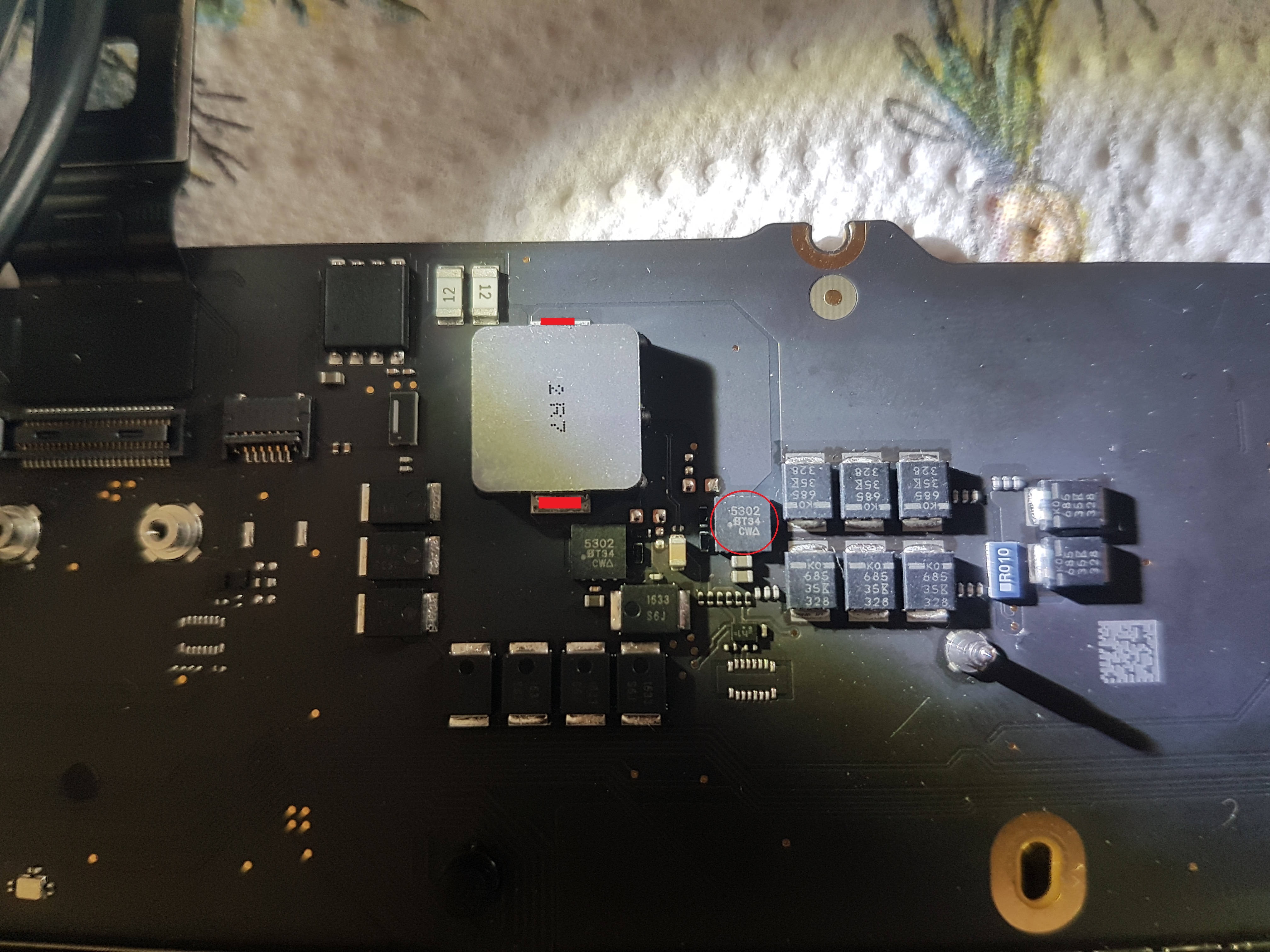

    When i fully shut off mac, orange light goes off and wont react to power button. I have difficult time resetting with combination "shift+control+option and power button", because it rarely works (reason unknown), when i manage to get orange light and then press power button macbook wont turn on and orange light goes off. When i hold combination with power button it turns on, and works fine if put it to sleep mode.
    Works with battery and charges, but when i shut off i get this problem.
    It had liquid spill. Board has no corrosion, keyboard is working, power button and fingerprint is working, but angle sensor is gone - so i removed it. It worked fine till this day.

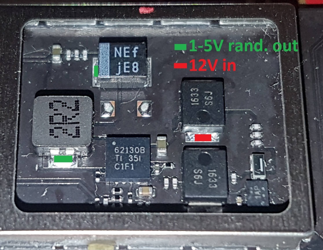

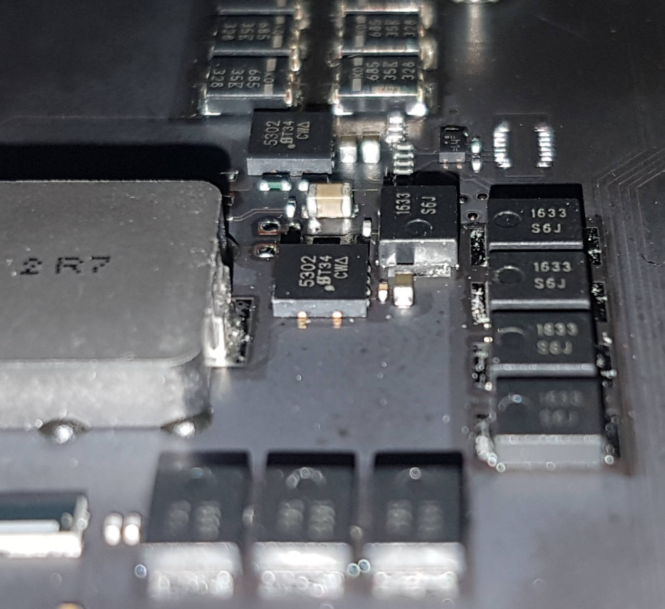

    Apple silicon only resets by pressing power button for about 10 seconds. Such a noob. But still i get this problem and discovered an anomaly on the board. So i guess this component was semi alive and i got some lucky resets.
    Voltage goes from from 1.2 to 5V in random values.
    Photo shows highlighted components. Need second opinion, i'm a hobbyist.
    Can't find any info about this component
    5302 t34 cw​

      Cannot find a schematic in my database for this logic board.
      Share side view pics of this '5302' marked part. They may be mosfets.
      5302 mosfet - Google Search

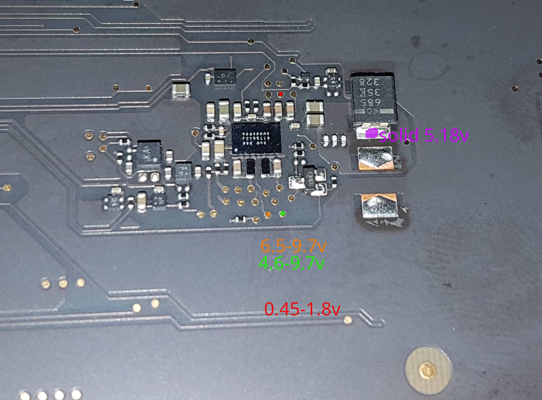

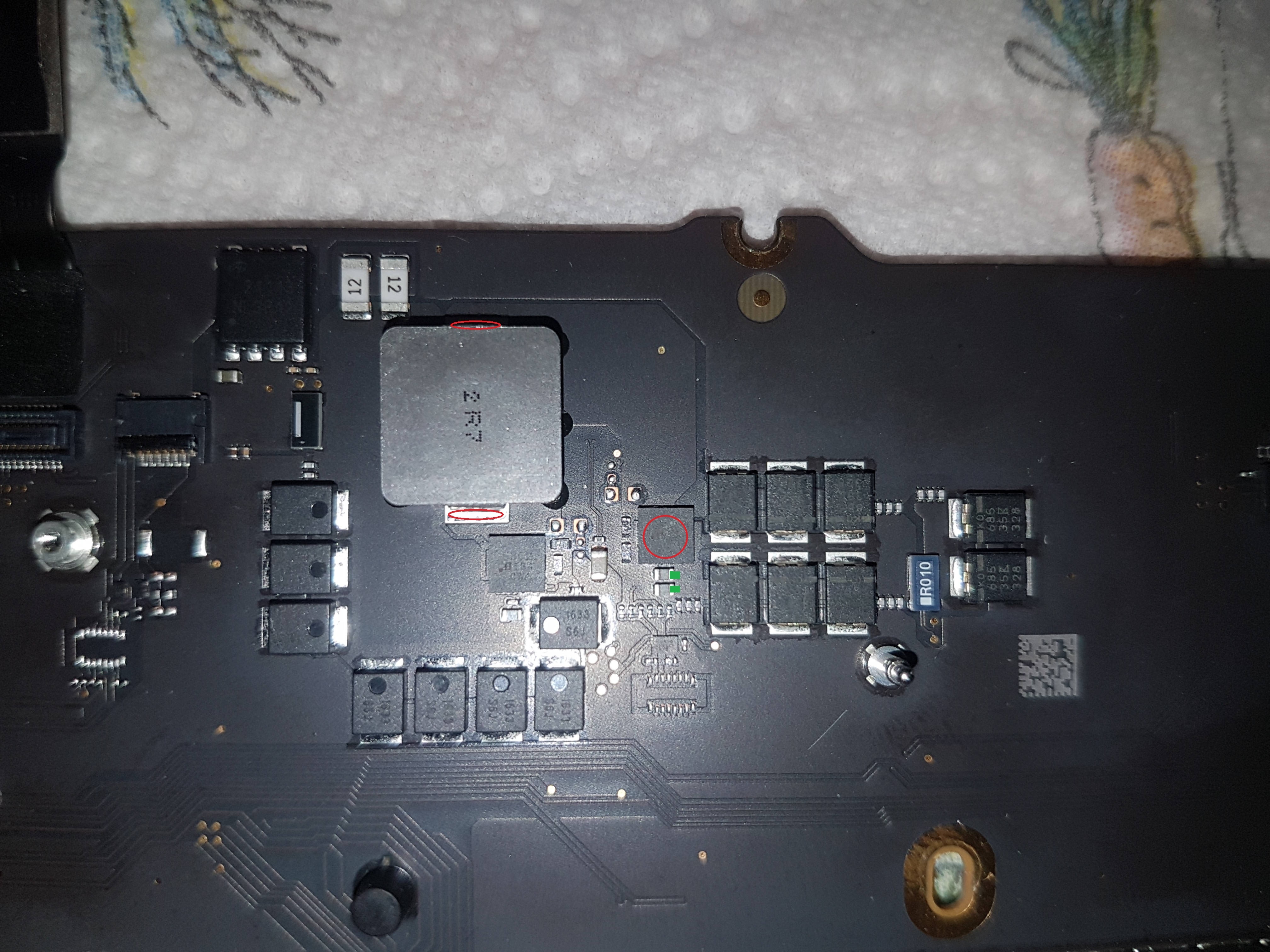

        Measured voltage on caps before that component - color green. Solid 5.18V.

          cant edit previous post to add image

            The parts with the 5302 markings are mosfets.
              https://www.infineon.com/dgdl/Infine...53561b58dc1ec3
              the look like AONE36196
              • mosfetratus
                Sure Not
                • Feb 2019
                • 174
                • Resistron

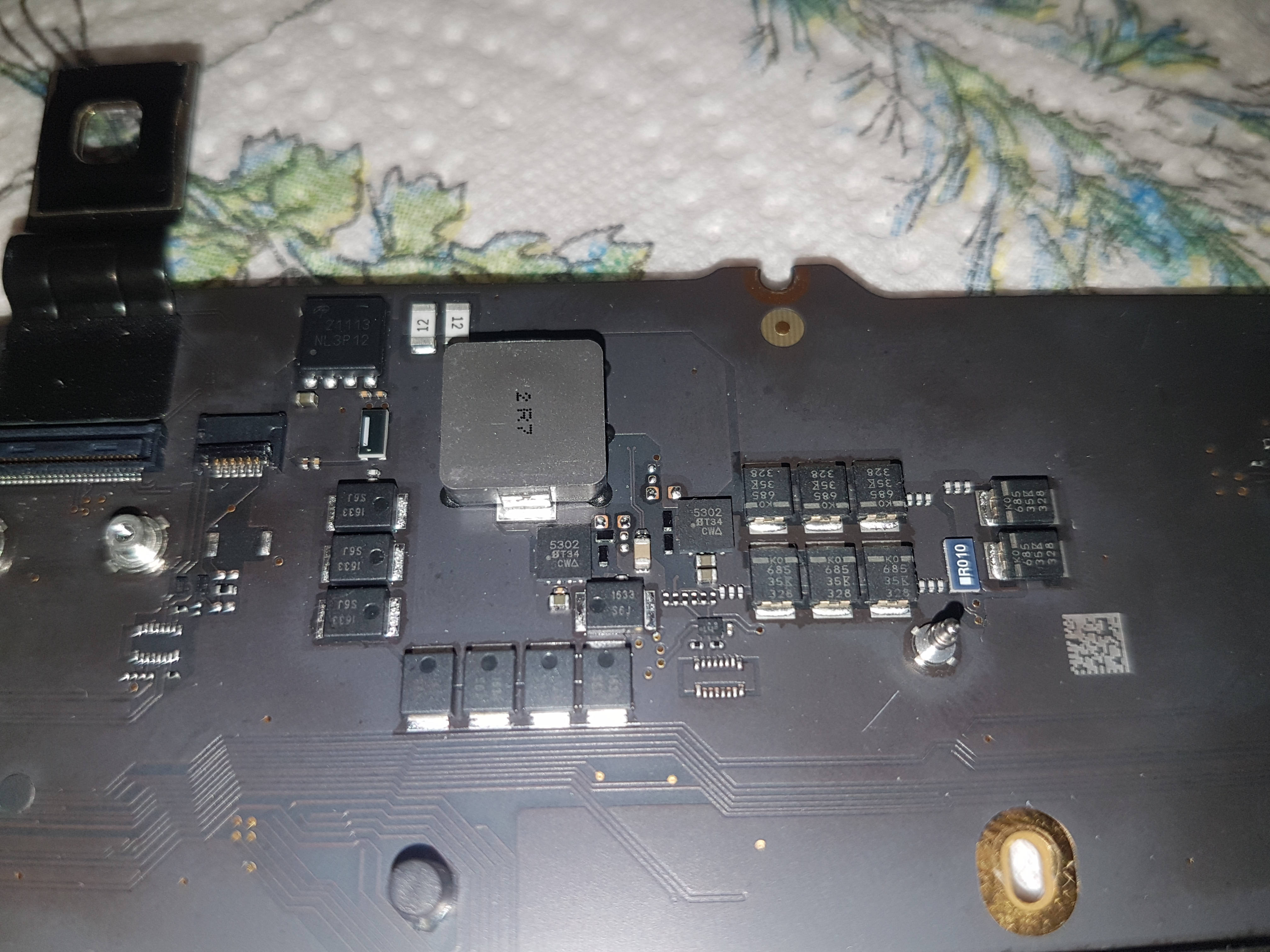

                https://www.vishay.com/docs/62055/sizf5302dt.pdf
                it looks like sw pins are getting random voltage if the design is the same, so likely mosfet is not the problem. I found other places with random voltage.

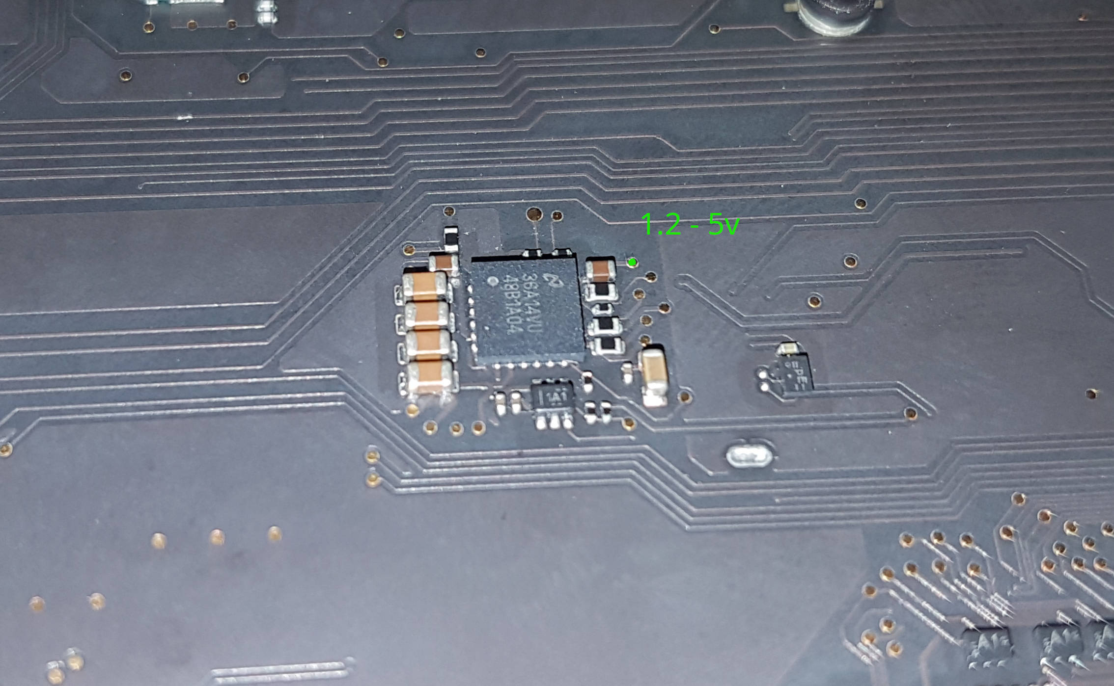

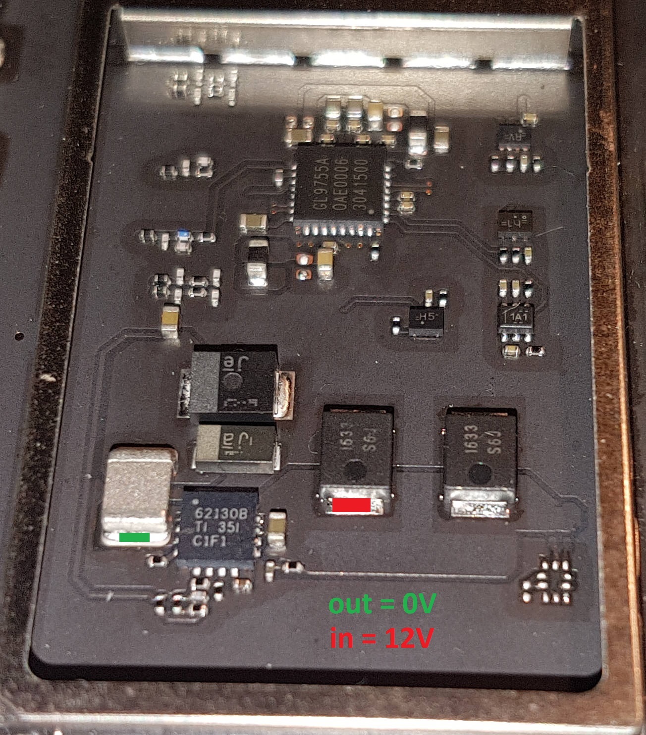

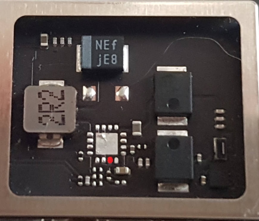

                  found two DC - DC converters - https://www.ti.com/lit/ds/symlink/tps62130.pdf
                  one spits out 1V to 5V garbage, other is no output, maybe system needs to be fully on.
                  Cannot trace out connection to where it goes when disconnected from power supply, i get megaohms.

                    removed the chip, turned out clock was bad - pin 7, voltage goes random, dont have scope for proper analysis. Now im lost. Still get random voltage on that mosfet and on some other parts of the board.

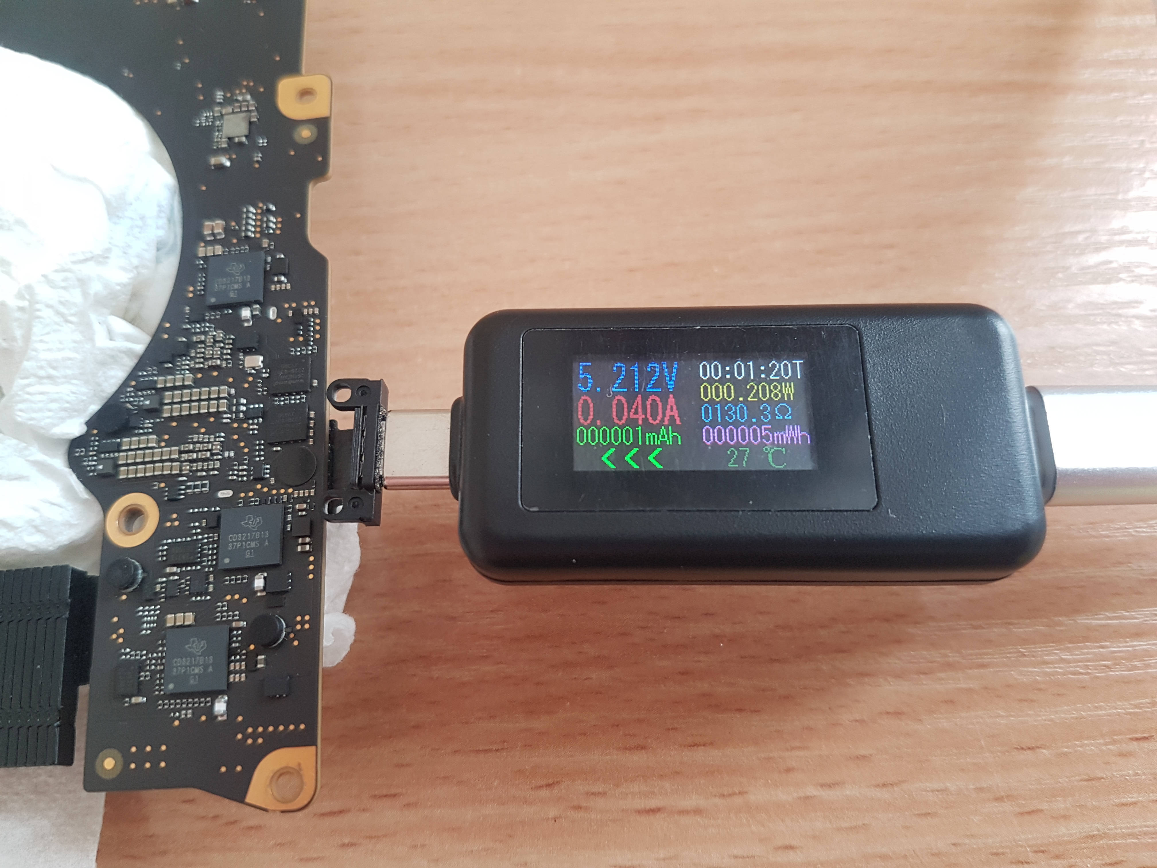

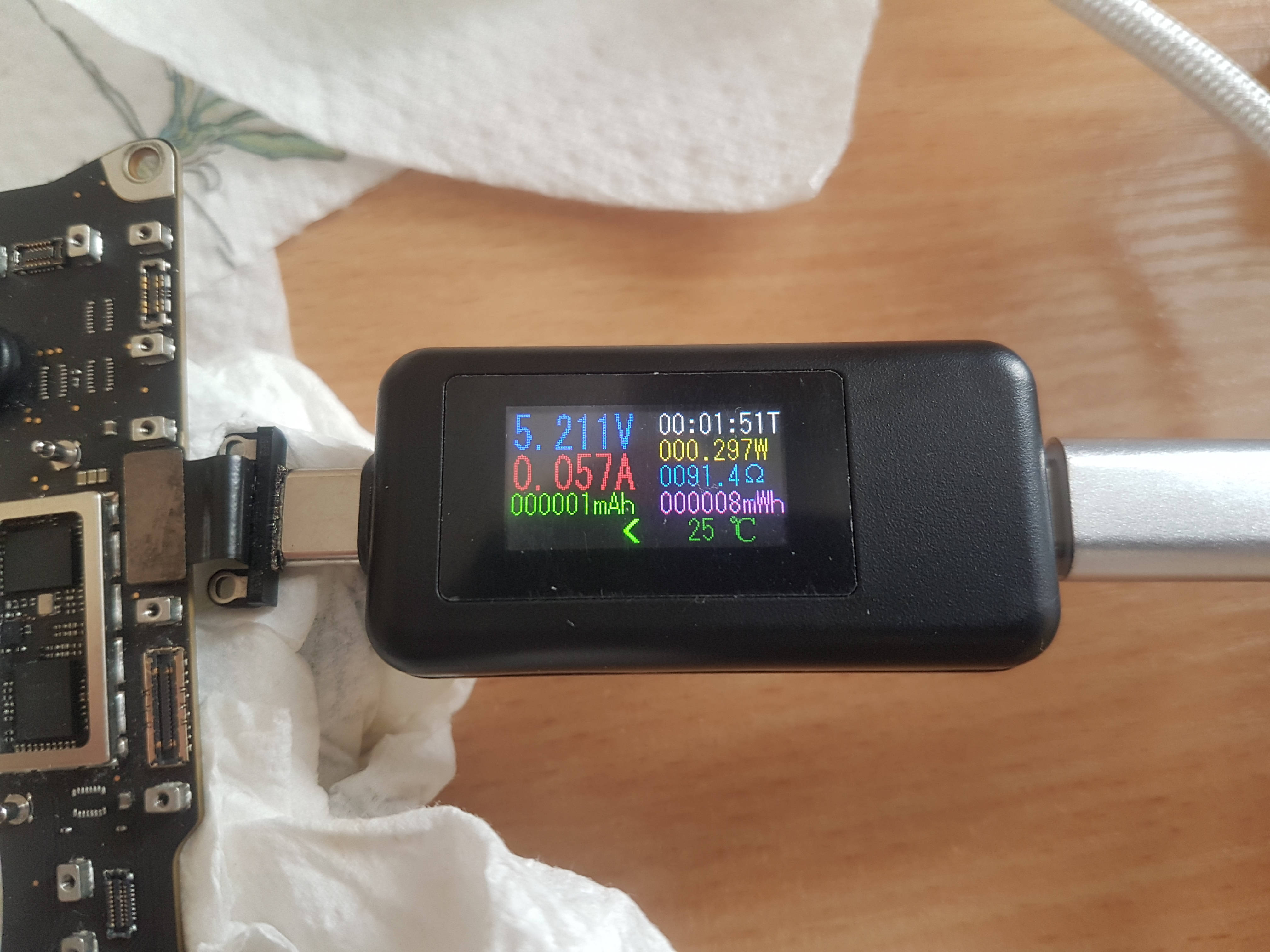

                      noticed that pros using usb C device to measure voltage, etc.
                      so bought one. Maybe someone will tell some pointers by watching at these results.

                        The 5 volts is a power on default voltage and the board is drawing ~57 mA which is an extremely low current draw. The boards usually communicate with the power adapter over the CCx pins on the type C connector and negotiate a 20V PD contract from the power adapter. It is possible that you have a defective CCx pin due to an ESD event.
                        Power down -> rotate the adapter power head by 180 degrees and then insert onto the type C paddle board. This process will then mate the other half of the type C connector circuits. Still the same voltage / current draw?
