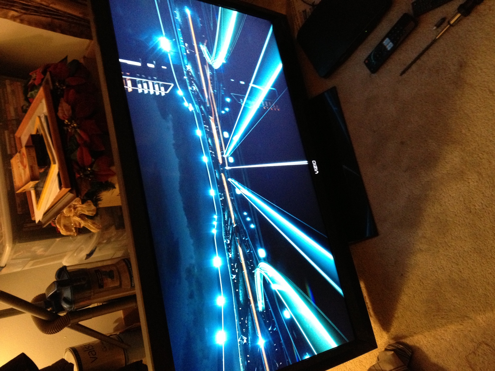

                          Ok back again everyone. Well here is what I have come back with...
                          1. Recieved EEPROM yesterday.
                          2. Soldered it in and my Vizio stand by goes white then back of and to orange again. Checked all cables. Everything.
                          3. In my rage and frustration found an exact same TV an hour away that had a unfortunate ending with a fall and LCD cracked. Picked it up for 50 for the whole TV and brought it home.
                          4. Switched out both boards and transplanted them into my TV.
                          5. I've got picture and sound. TV works like a champ. I salvaged all components from the Cracked LCD one and kept them in case, even the housing. So consider this closed.

                              Are they really? I grabbed everything except the cracked screen. Thats outside by the road.
                              Here is a pic I took last night of it working.
