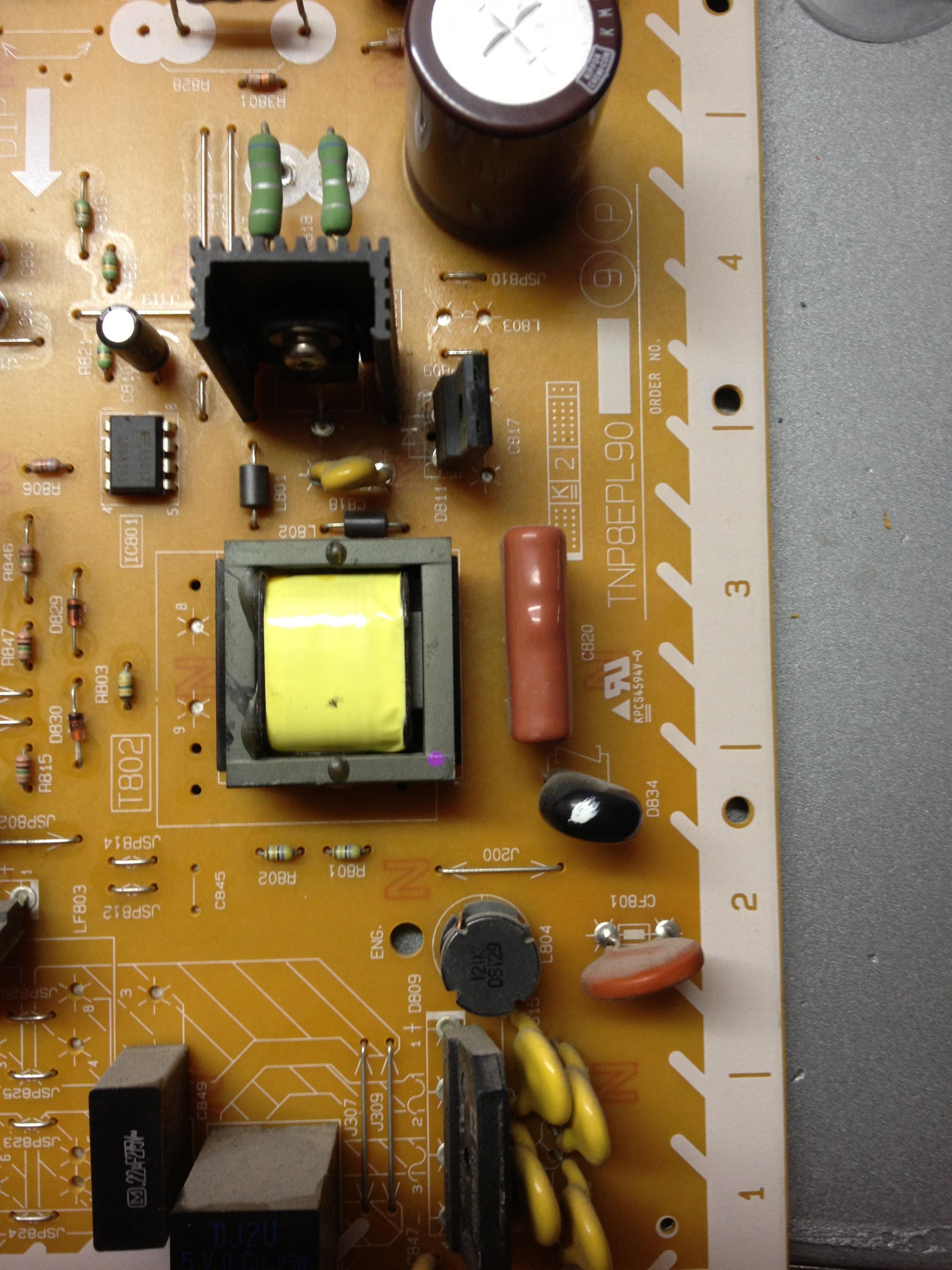

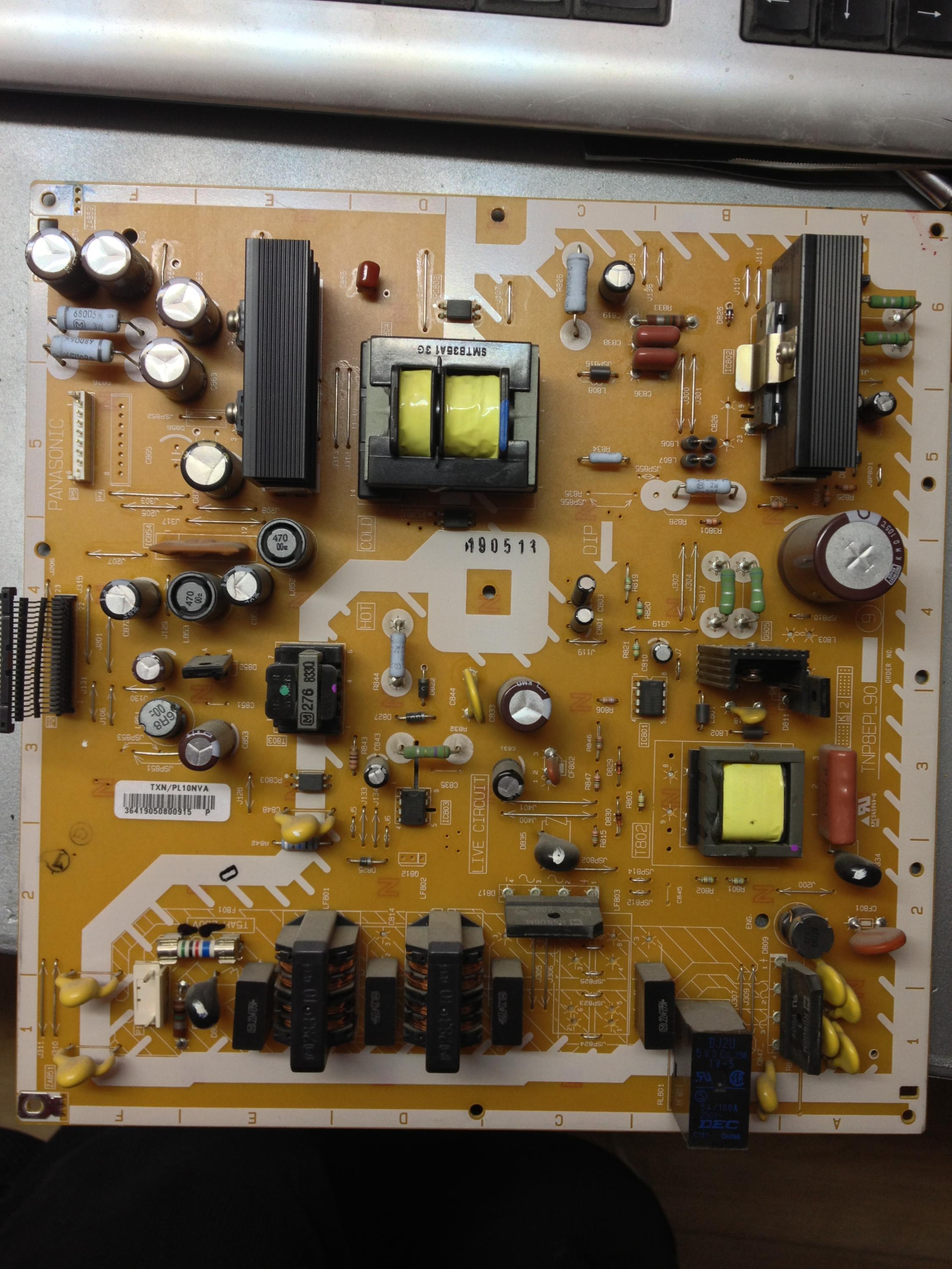

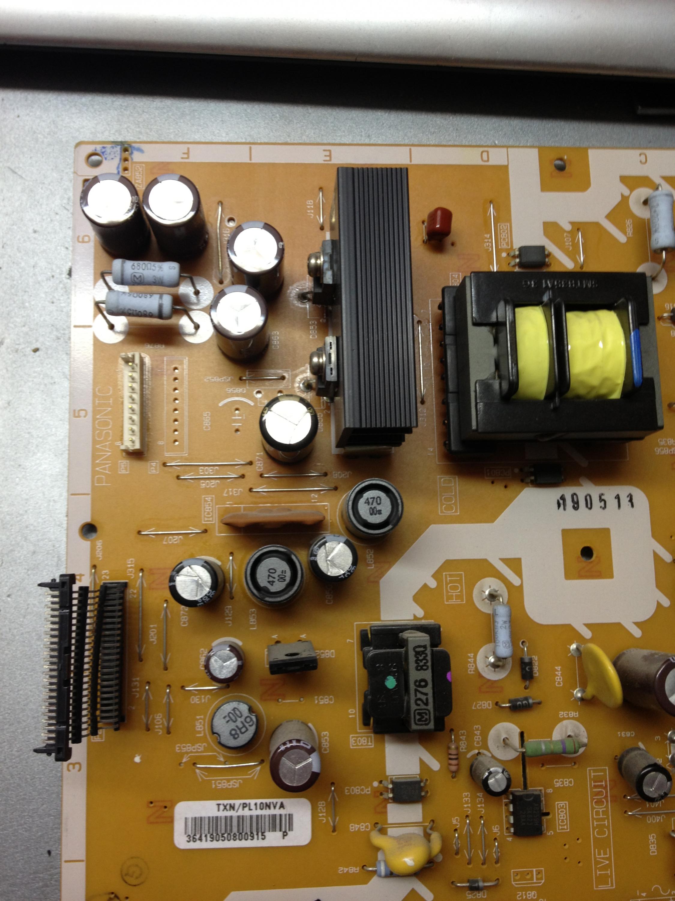

    Hi, i have problem with Panasonic LCD TV, when pluged in there is no picture just red LED blink 3 times. I think it's a faulty PSU.
    I upload the picture of power suply board, on output i got 5V and 1.1V, all other pin are 0.
    PSU model is: TNP8EPL90

    3 blinks - A Board SOS.
      Re: Panasonic TX-37LX85P blink 3 times

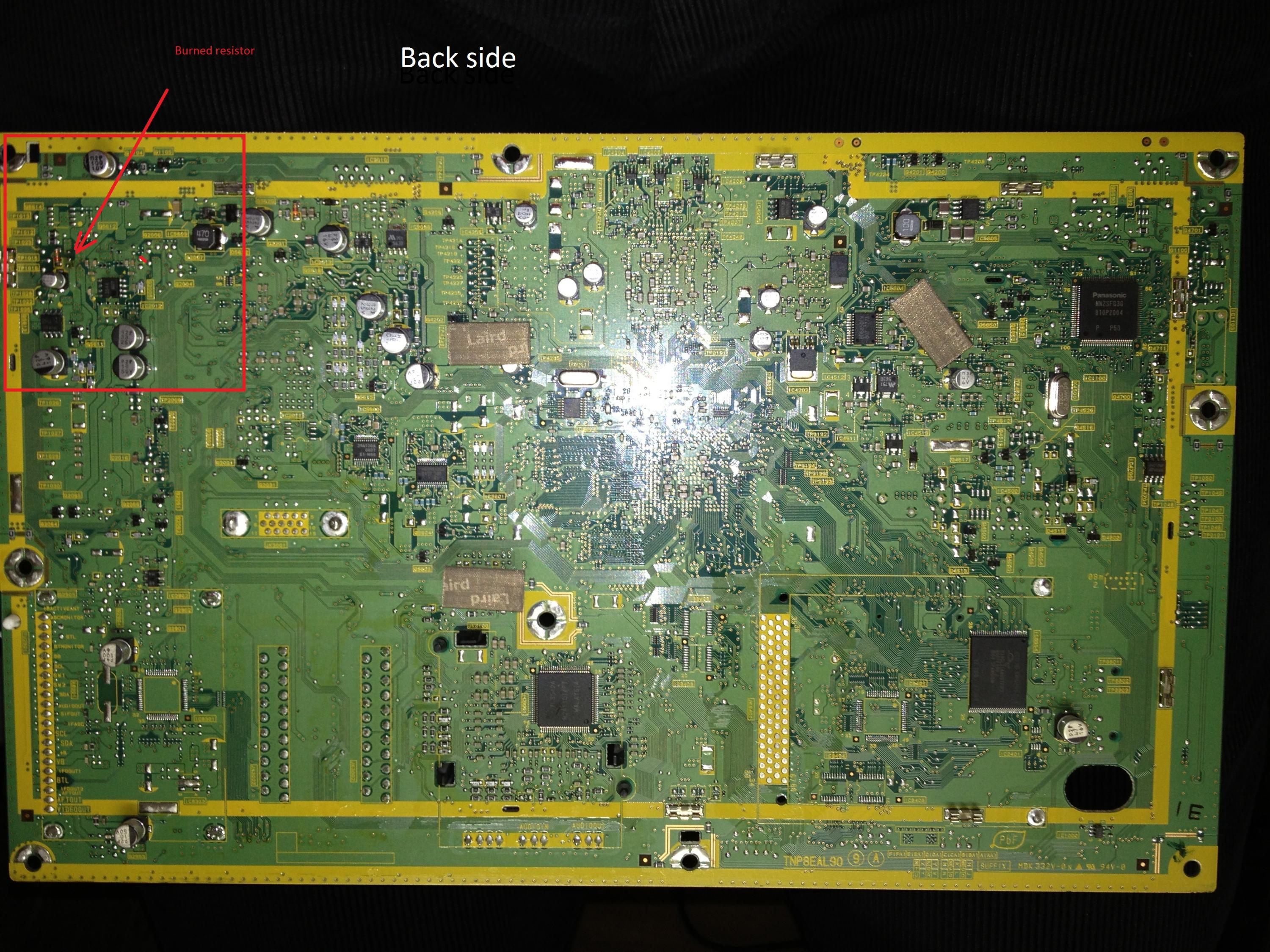

      oh thank you, i take it and have a look, and i see some burned SMD resistor. but don't know whats wrong.
      ...the quieter you become the more you are able to hear...
        The A Board 3 blinks SOS is built around a circuit shown on page 49, see AG_SOS. If one of the resistors in that area is burnt out the A Board may mis-detect a fault and do the 3 blinks.

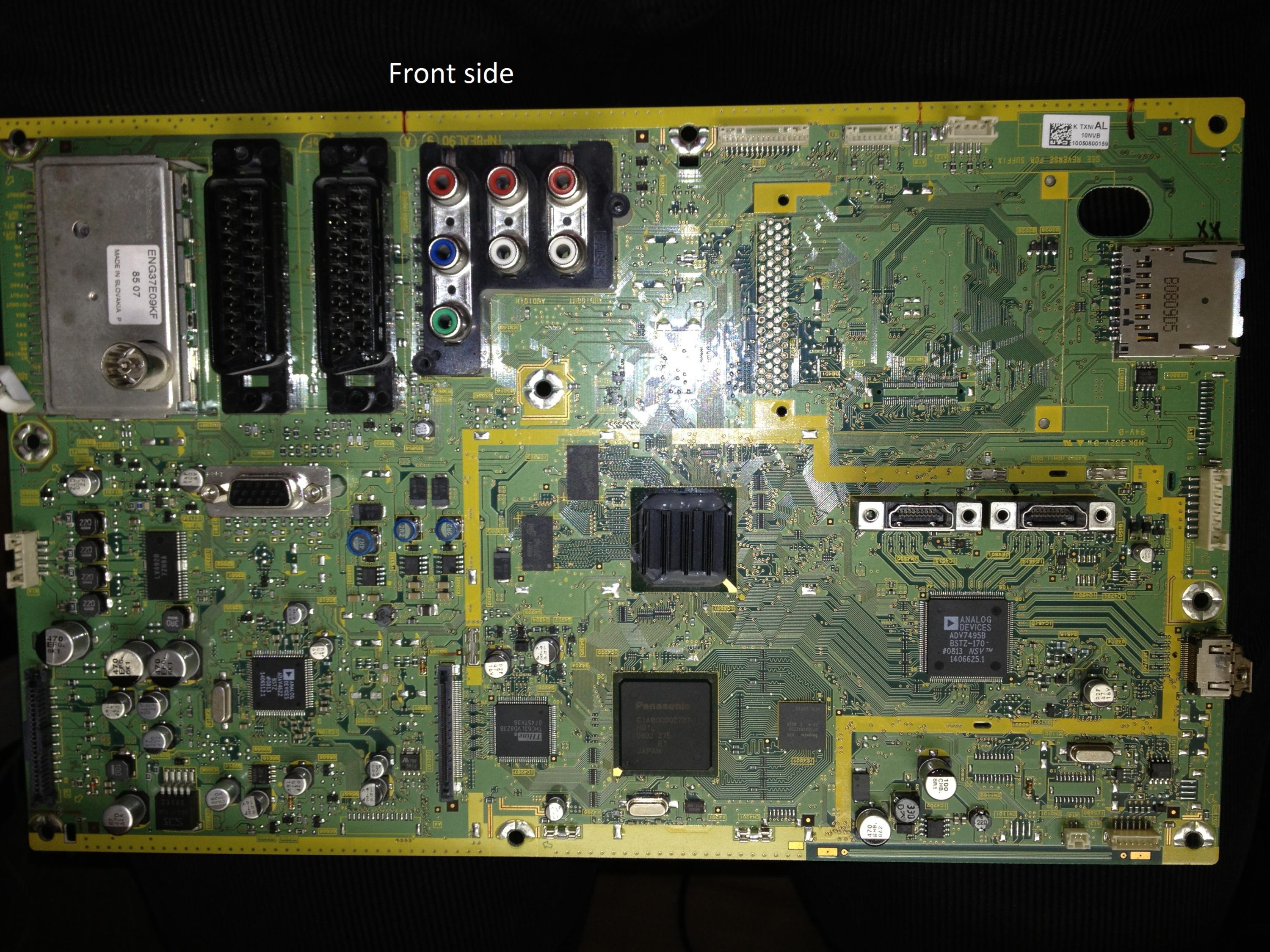

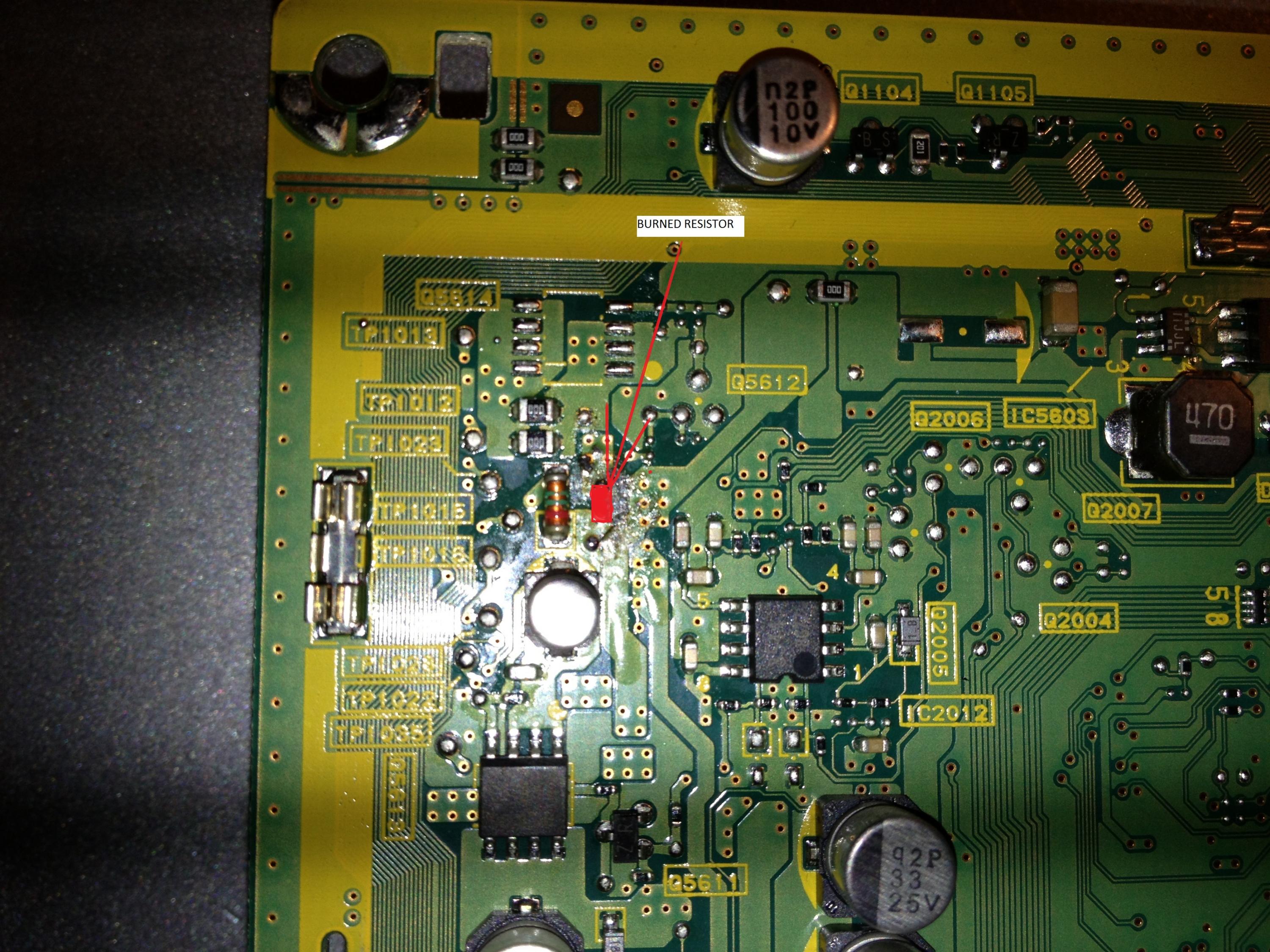

          I remove the burned resistor, and mark it on picture. How can i find it on TV manual scheme. There is no designation on resistor. I look under page 49, but can't understand the markings.
            Which board are you on?
              I am on A-board (TNP8EAL90), back side.
                can you read the part numbers on the two 8 legged devices?
                  1st part
                  tpc8105
                  h 7:43
                  2nd part
                  3544
                  8g77

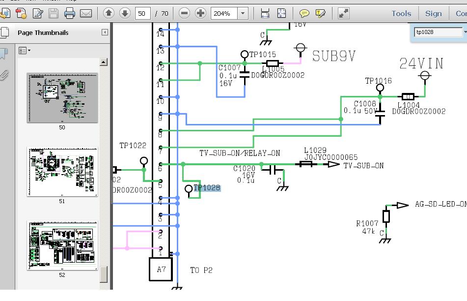

                    Clutching at straws here but you can see TP1028 in your pic. If you open the manual pdf and search for TP1028
                    it comes to page 50 of 70 If you pan to the right past c1020 16v 0.1 - check if that is the value of the round blob on your picture? (Clearer pics required) then it says
                    L1029 ( That is an inductor probably black surface mount) then it says TV-SUB-ON. Well just below that is a resistor R1007 47 It is the only Resistor showing in that area. So that is my guess, but its only a guess.

                      How sure were you of it being a resistor?
                      Could have been a ferrite bead.
                        i am not sure, i think it's a resistor. It was black with no marks
                          That is a ferrite bead.
                          Value is not critical.
                            so i can use similar? and then test it?
                              Yes, you can use basically any ferrite bead as a replacement. As long as it is the correct size.
                                i replace it, but no change, still 3 red blink
                                  OK, please locate test point TP7022 and check the voltage there.
                                    Oh, I just realised TP7022 isn't visible, but you can test the pins of Q5615, which is in section D4 (near IC5600)
                                      all 3 pins are 0V
                                        OK, there should be a capacitor marked 100 (metal can) nearby. Can you check the voltage across it? Can you post a picture of the area around that transistor?
