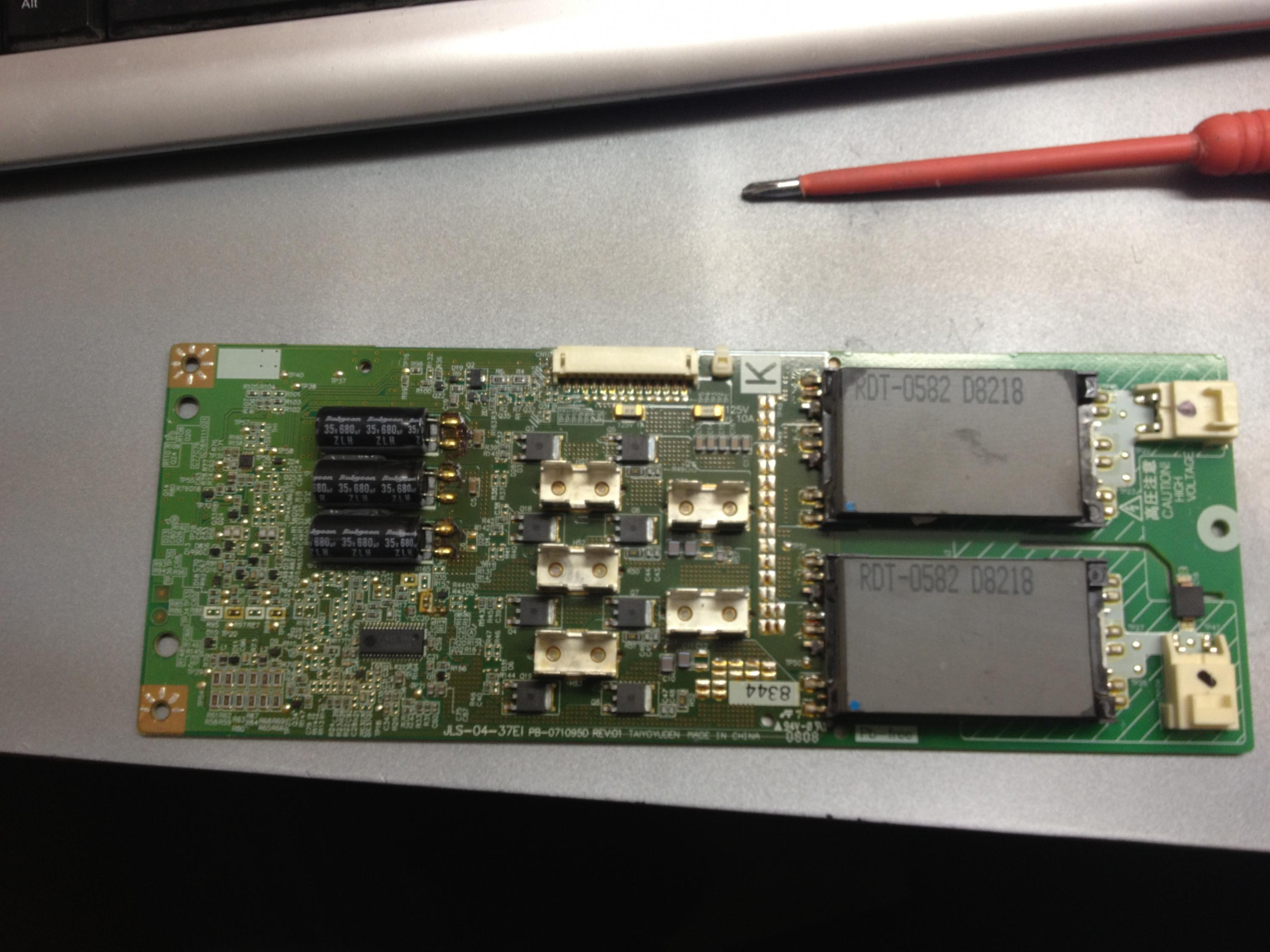

    Is there an error output on the inverter; are the pins marked at all?

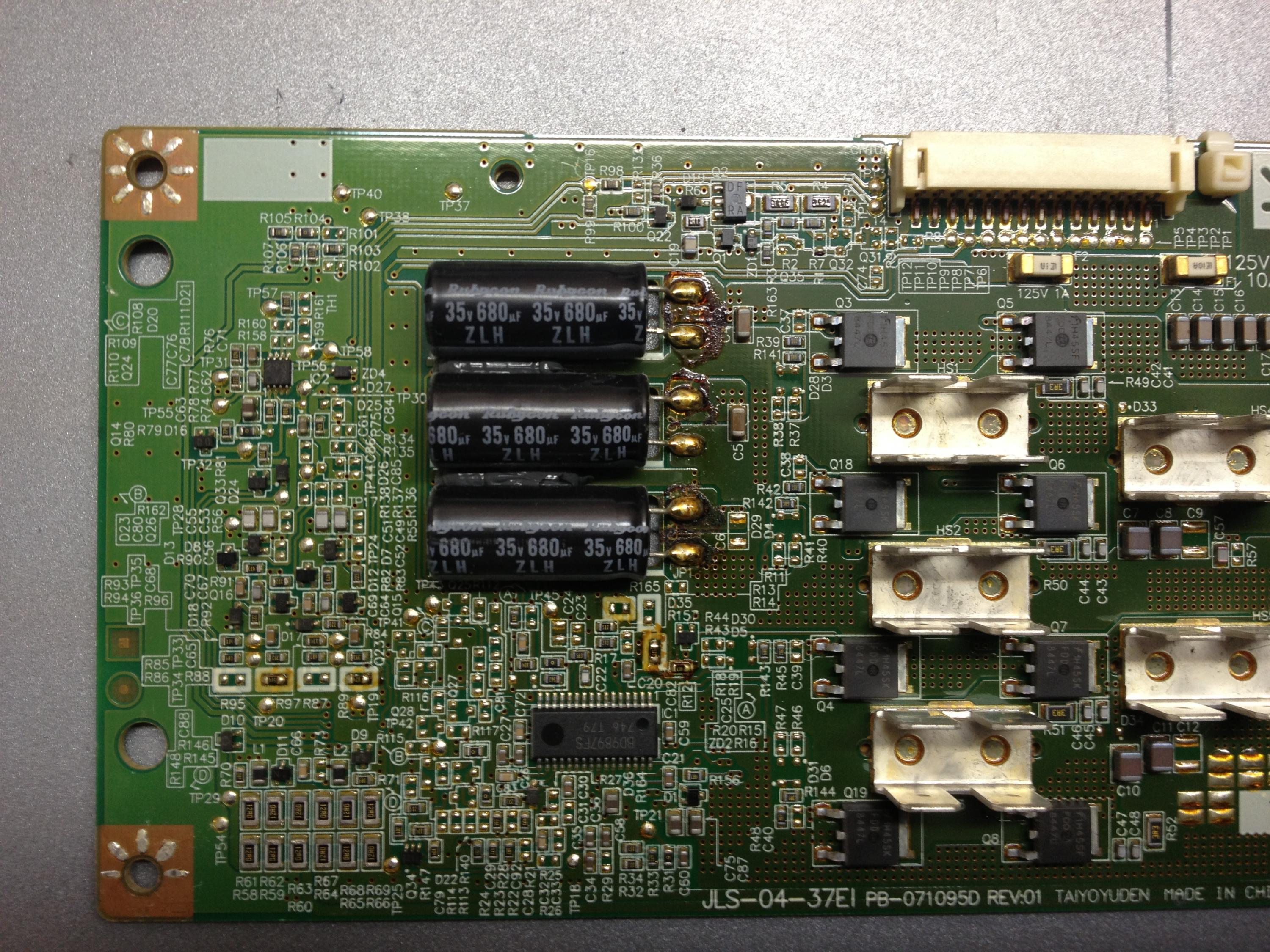

      Re: Panasonic TX-37LX85P blink 3 times
      should i check voltages on output in the picture?? I think this is high voltage, just to be sure? i see someone replaced the 3 capacitor

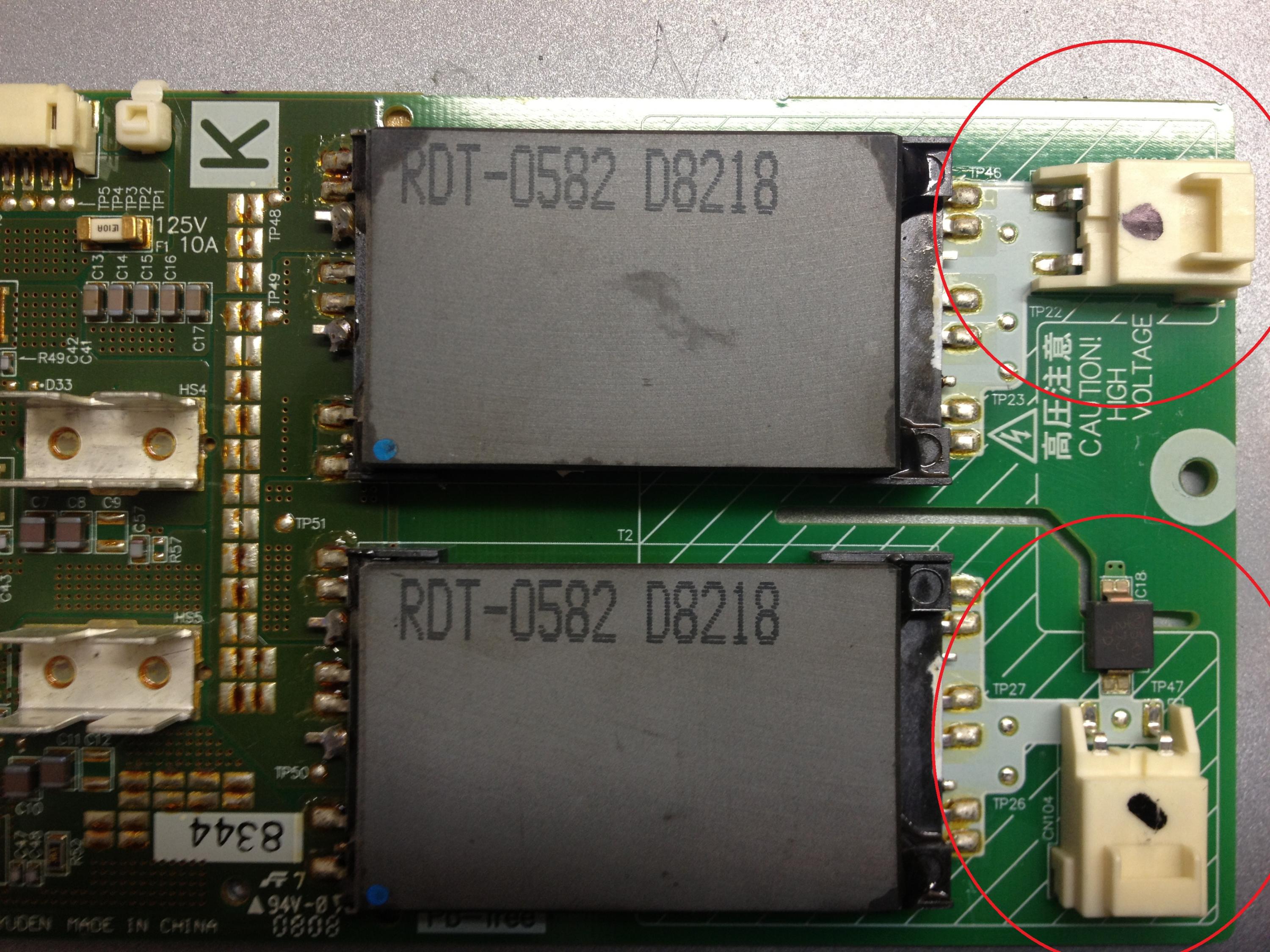

        Don't attempt to measure the high voltage output with meter - over 3000V present on some LCD TVs.
        How is the soldering on those caps? Try cleaning up flux.
        I see at least one missing - little SMD C6?
        I am trying to understand how the inverter is wired up to the main board. Looks like it goes through A13 perhaps?
          the solder is OK, i now cleaned it. Yes i see that someone is try to "repair" TV.

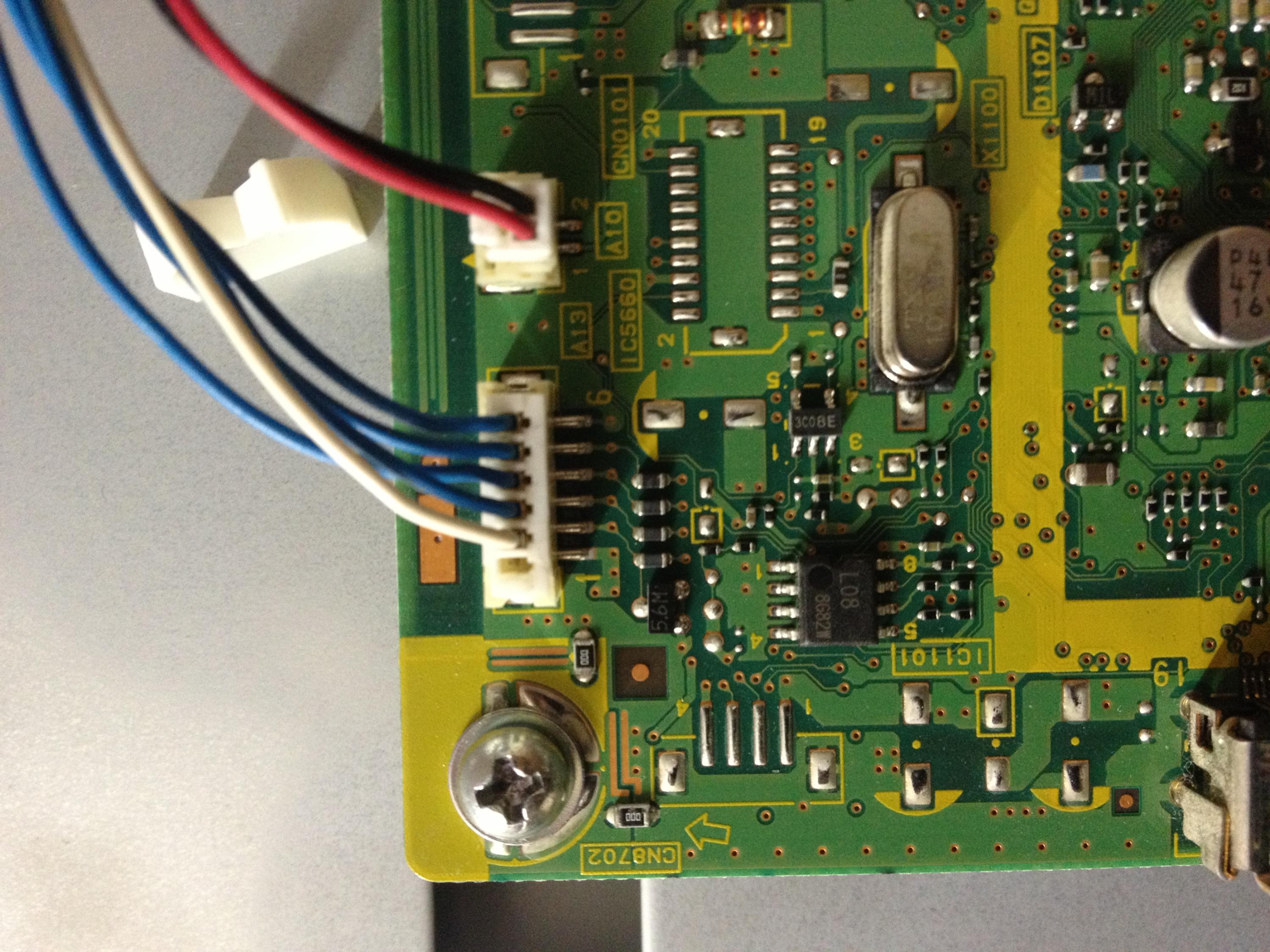

          Yes it is wired with the A board with A13, and with the power board with the P5
            On A13, there is a pin #4 called "INV_SOS". What does this measure? I think it should be low if OK, high if bad. Also, check INV_ON and INV_VCC; pins 2 and 1 respectively.
            Looking at the design of the board, it sends a 5V/12V power rail to the inverter for its logic power, alongside the 24V for the main power supply. I'm working right now on the assumption the power supply failed and sent 17V down the 9V line... this might have damaged the A board (causing your original 3 blinks)... then I think it may have reached the inverter VCC hopefully it's something simple like a blown fuse.

              #106
              #4 = 3.27V
              #1 goes to 12V but when clicks then 0V, then again 12V -> click -> 0V
              #2 = 0V

                #107
                OK, Vcc is OK, but the SOS signal should be a LOW. If you force it low (to pin 6 is fine) using 100~470 ohm resistor, does the TV do a blink code with inverter installed?

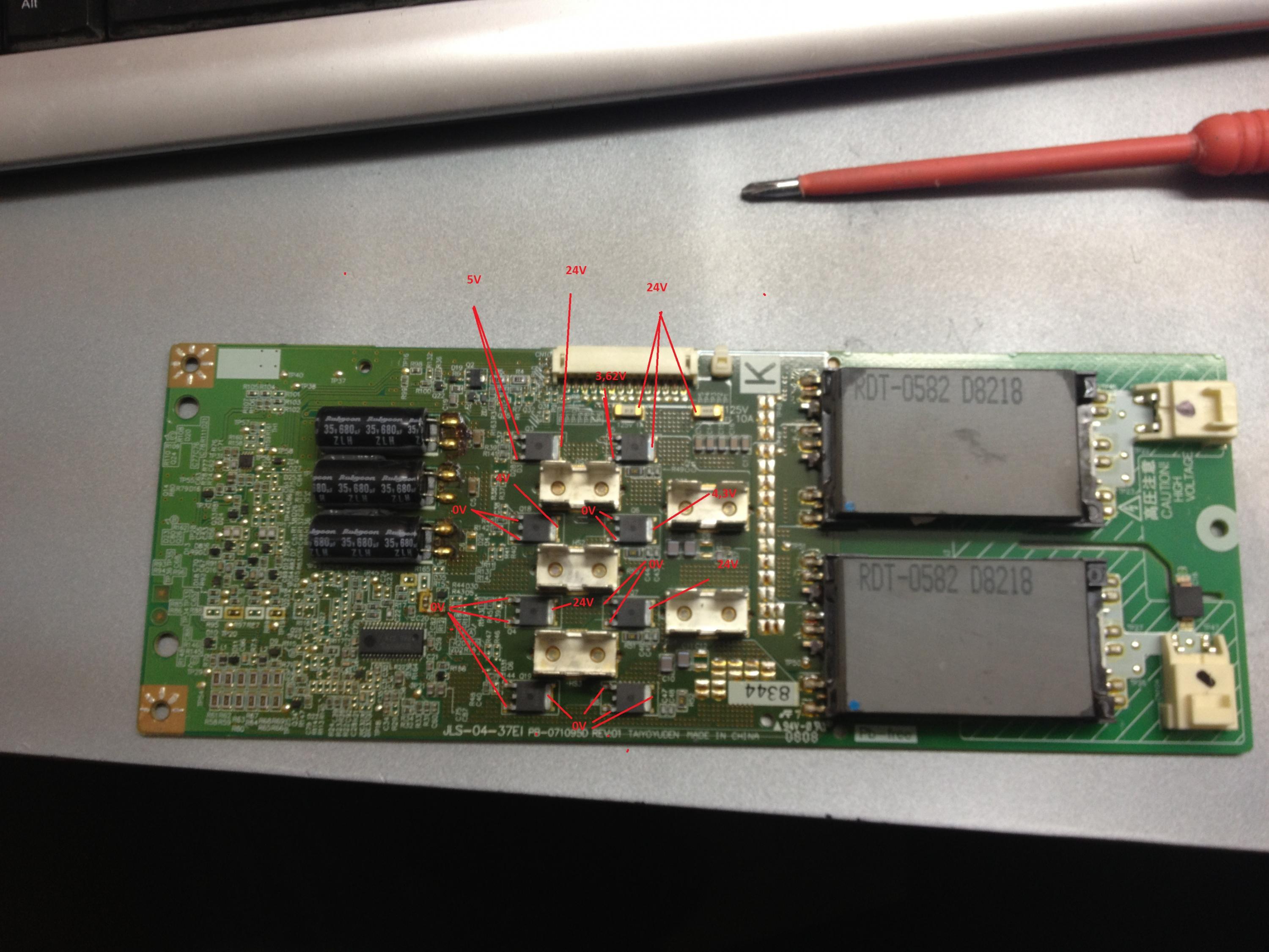

                                #115
                                i measured the voltages, please have a look at them. I think that something is wrong here.

                                  #116
                                  The 3~5V readings do not look good to me, something may be wrong there. With the board powered off, what resistance do you measure between the tab and each of the two pins? It should be >10kohm.
