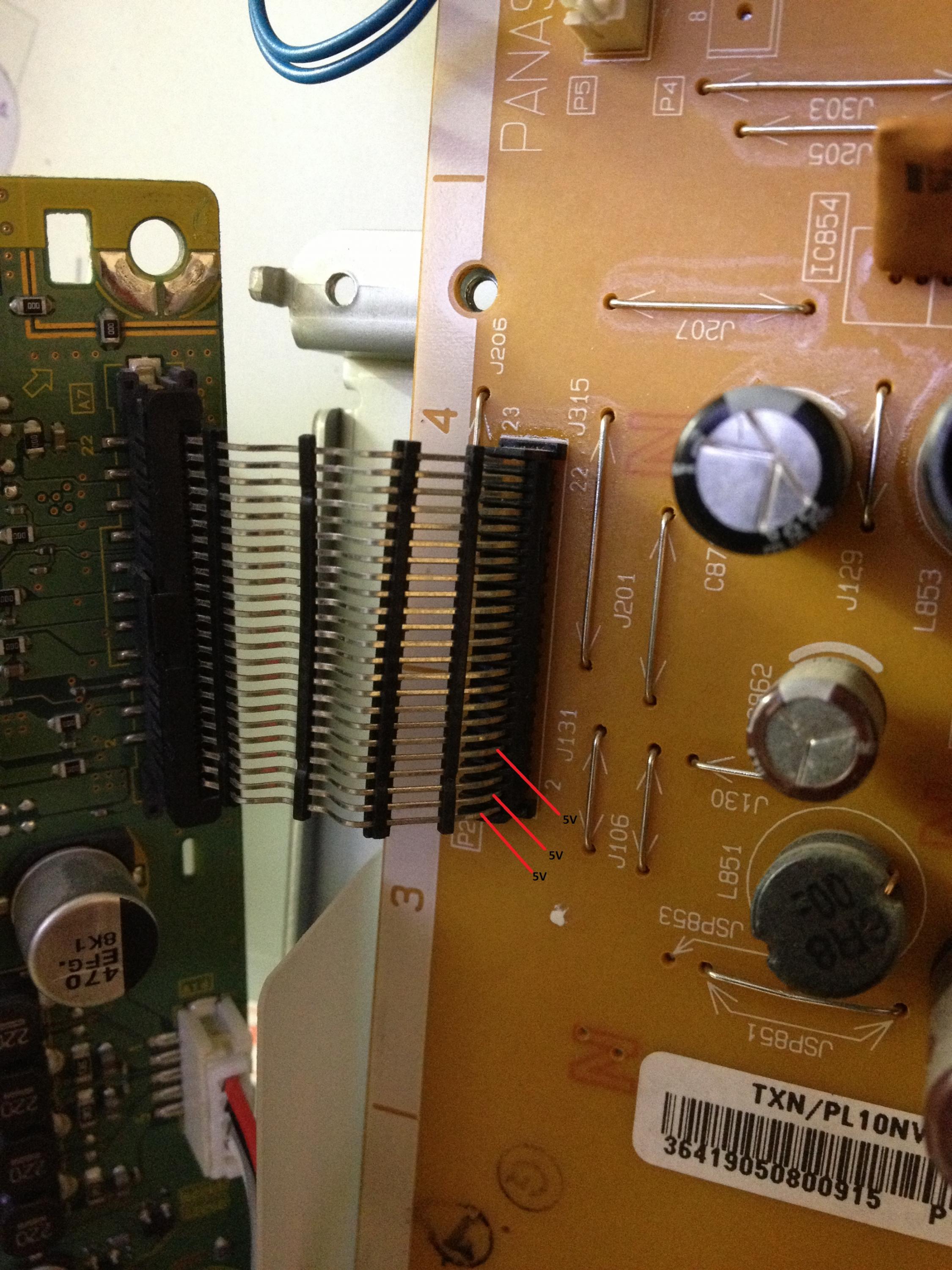

            Re: Panasonic TX-37LX85P blink 3 times
            OK, there should be a voltage, 17V, always present, but you do not see this?
            How are the voltages at pin 6 and pin 15?
            • rtstorm
              • Feb 2012
              • 971
              • Croatia
              0V both
              ...the quieter you become the more you are able to hear...
                Ok, what voltage do you see at RELAY_5V6 (pin #5)?
                • rtstorm
                  • Feb 2012
                  • 971
                  • Croatia
                  on #5 pin i have 5.75V

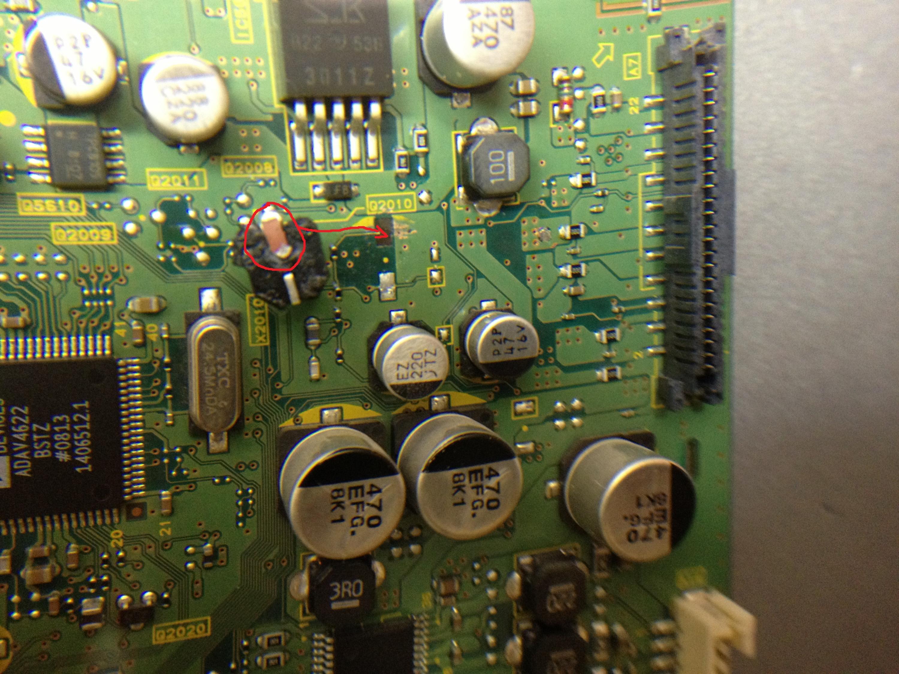

                            #33

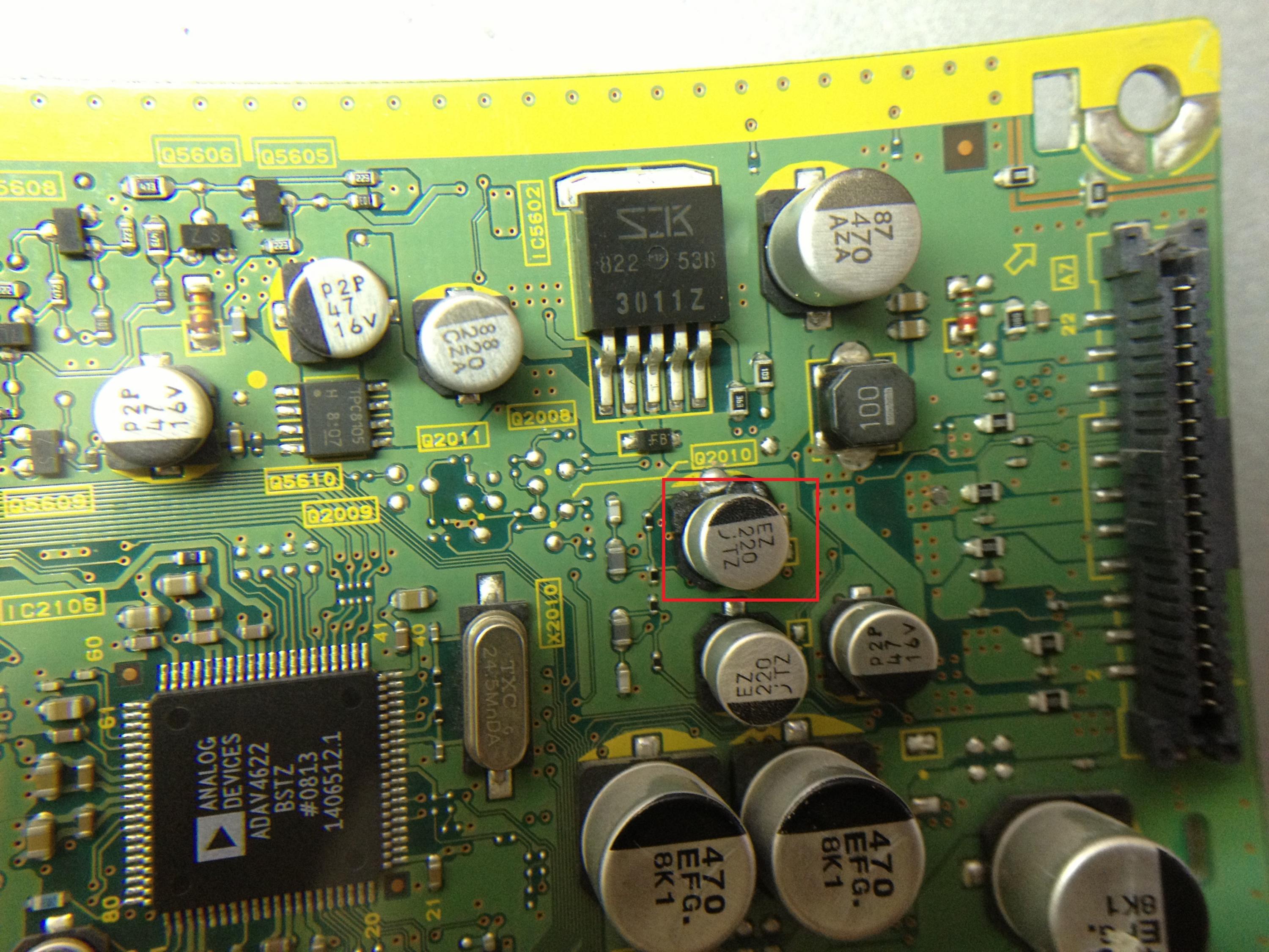

                            Nope, #20 and #21 os 0V when turning ON.
                            I find IC5602, and i find that one leg of capacitor is broken, (you can see in the picture), and i have no clue how will i solder it back. if you can see that the part of the board is still on the capacitor.
                              #34
                              Which end (positive or negative) was that lead connected to?
                              • rtstorm
                                • Feb 2012
                                • 971
                                • Croatia
                                #35
                                negative (the one with red mark)
                                  #36
                                  In which case you can find a ground on the board somewhere and just solder the lead to there.
                                  Closer the better.
                                  I'm pretty sure the green copper area right next to it is ground, you can scrape the soldermask (green layer) off carefully with a screwdriver, then solder to that.

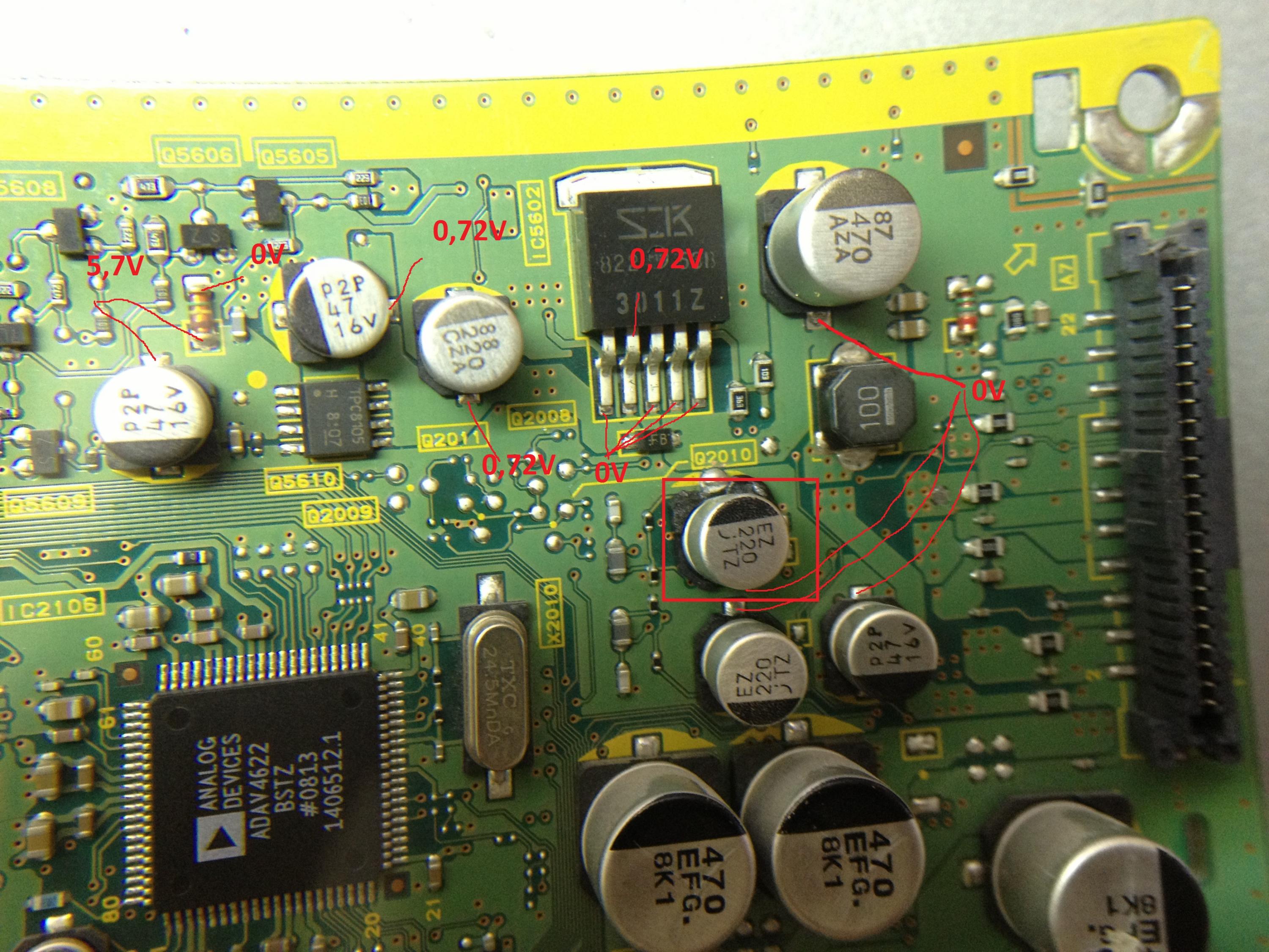

                                    #37
                                    Ok, i solder it to some ground nearby.
                                    Now TV blink 4 times red, no more 3.
                                    i wrote in picture the voltages
                                      #38
                                      Check your wiring, you just shorted that capacitor "470" positive to GND.
                                      • rtstorm
                                        • Feb 2012
                                        • 971
                                        • Croatia
                                        #39
                                        Ok, we are now back to 3 blink LED. I solder on wrong place. Check voltages, they are still the same as in the picture above.
                                          #40
                                          Can you check the voltage at pin #4 of the Q5610 device.
