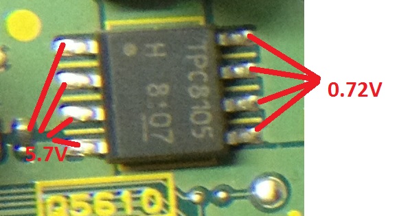

    Re: Panasonic TX-37LX85P blink 3 times
    I check whole IC, wrote voltages into picture.

      #42
      is it possible that transistor switch is bad? like Q5609 or Q5605 or Q5606 ?

        #43
        OK, so the device is not being turned on. The VGS is 0V.
        The power on signal disappears into the main processor IC1100.
        Right now I would be considering replacing the main board unless something else faulty can be determined.
        Did I miss something, or you get no +17V when power comes up (relay clicks?)

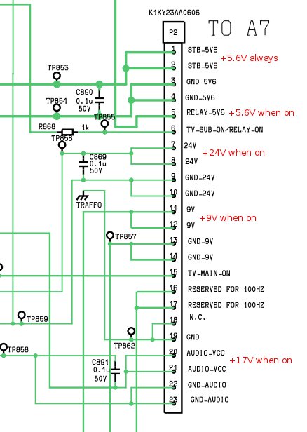

                            OK, see the image. If anything in the image disagrees with what you measure, say so.
                            A voltage "when on" in this case indicates the jumper connections have been made, you can measure the standby 5.6V with the jumper in place.
                            The ground should be chassis of TV with PSU board installed and all screws fastened.

                              #54
                              i tested it, and i get 18V on #21 adn #22, but on #11 and #12 i have 24V, should be 9V, right? All other voltages are ok.

                                #55
                                Ok, if there were 24V on the 9V I would say the main board would be damaged quickly, I guess it must be going into over-voltage protection (good idea from Panasonic, I guess.) I hope it hasn't been damaged but it is likely OK.
                                The +9V is generated from the +24V by IC854. What is the part # on IC854?
                                Does capacitor C850 get very hot when it is jumpered across?

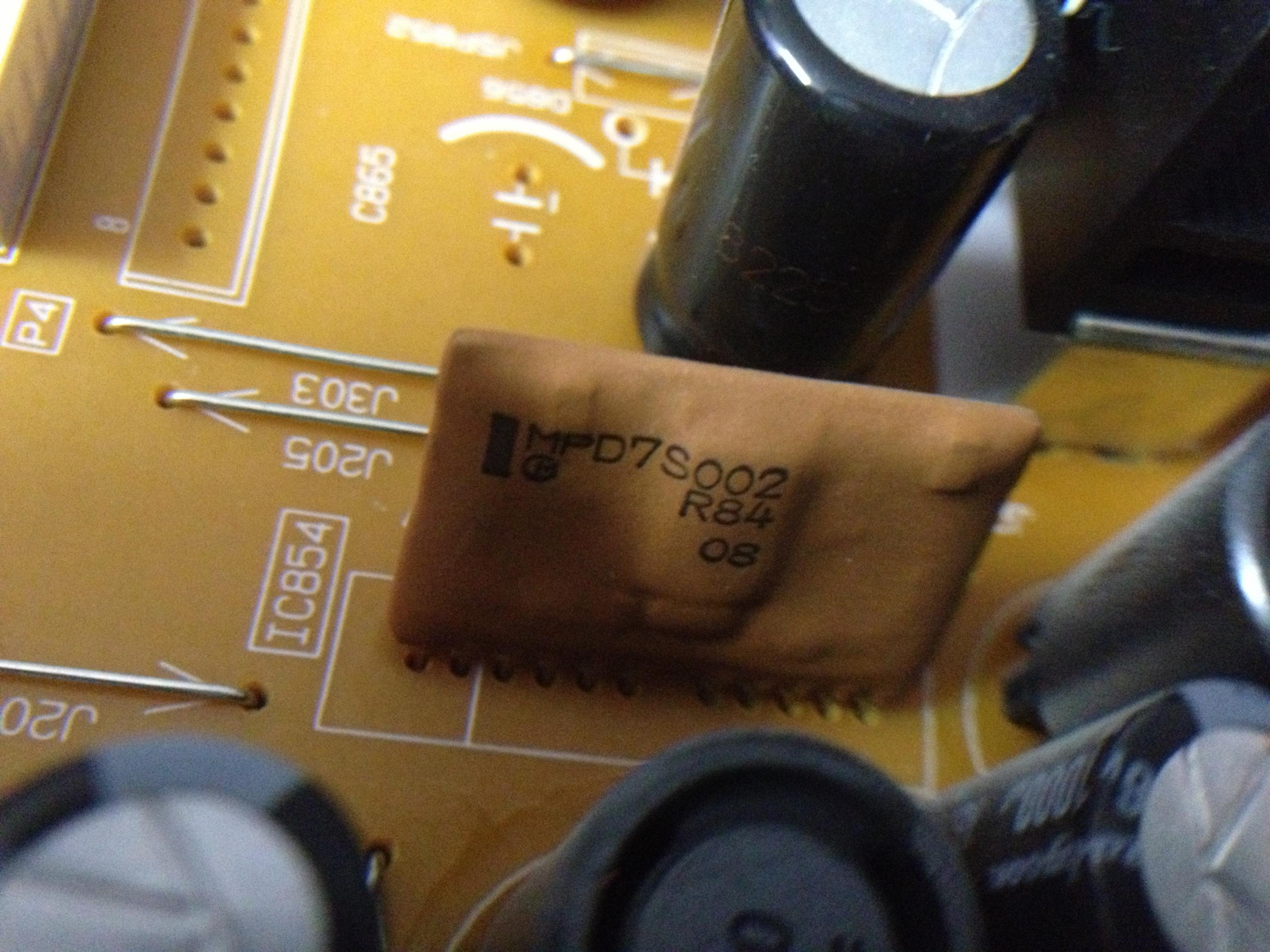

                                  #56
                                  IC854: MPD7S002
                                  R84
                                  08
                                  C850 and C875 are hotter then other Capacitor, i tested it with thermometer probe it's around 50Celsius
                                  ...the quieter you become the more you are able to hear...
                                    #57
                                    Hmm, no result for that part number "MPD7S002".
                                    Can you please double check it, if you cannot get hold of it you will need to find a way to give TV the +9V it needs (possibly by substituting in an additional supply, e.g. this one on ebay http://www.ebay.co.uk/itm/New-LM2596...item231ed973f5) or by replacing the power supply.

                                      #58
                                      I take a picture, you might recognize the image.
                                        #59
                                        Ugh, yeah, I've seen those before. Ugly hybrid modules you can't buy from anywhere which Panasonic likes to use a lot. I don't know why they use them. Must be a good reason for it.

                                          #60
                                          http://www.chsinteractive.co.uk/elec...-panasonic.htm
                                          i think this is it, i found it by PART NO.
