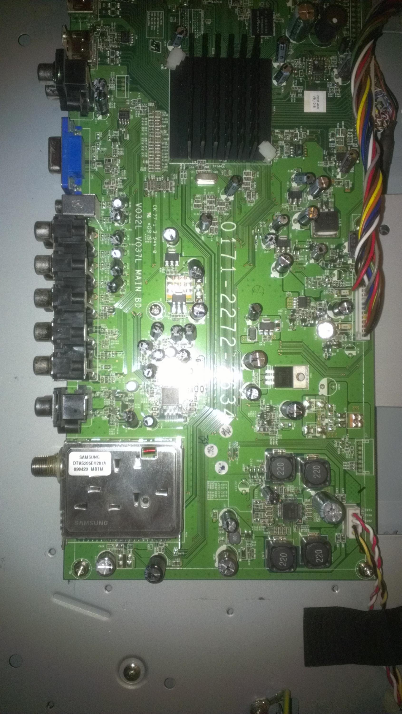

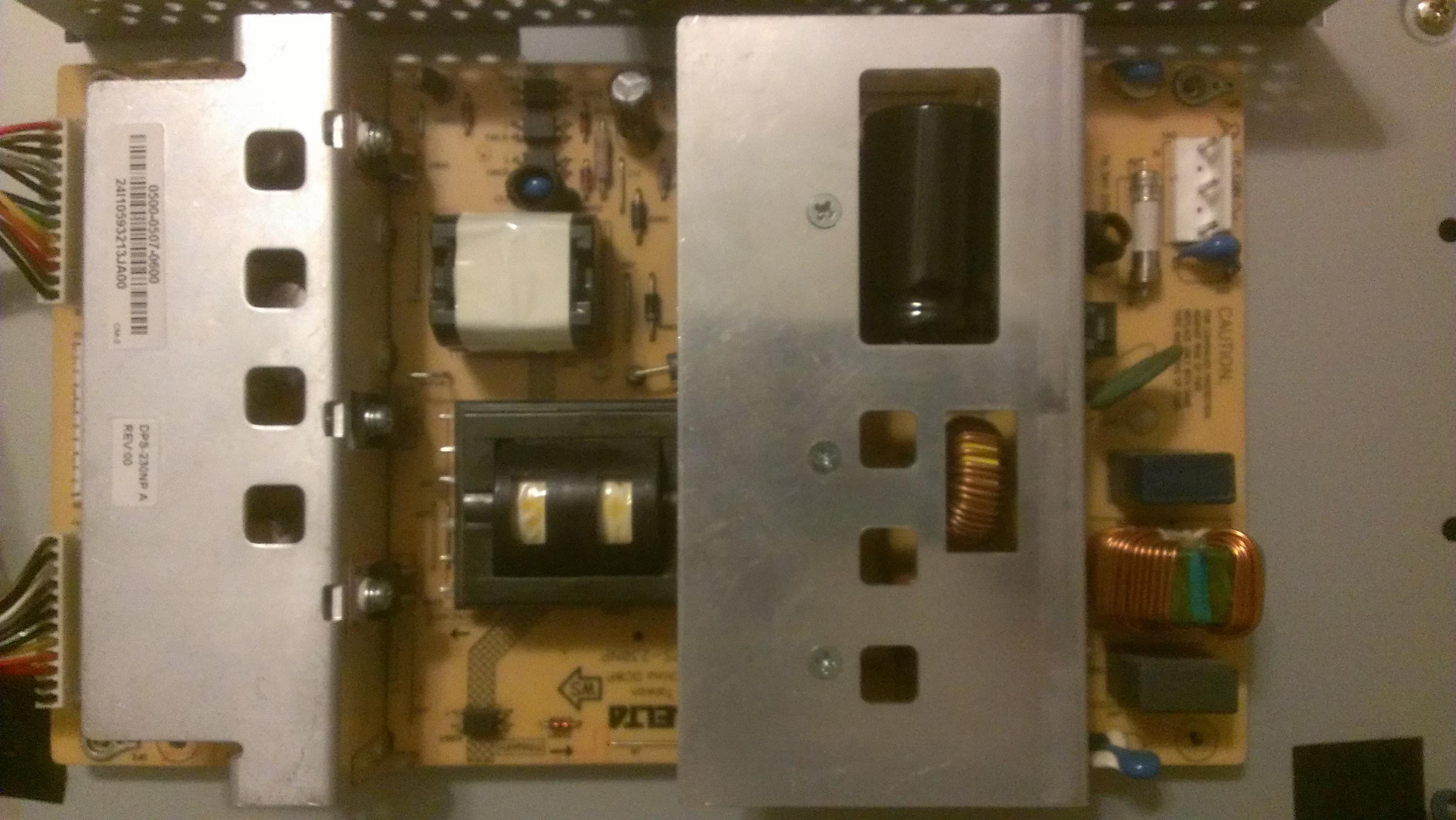

vizio v037l fhdtv20a no picture

    Re: vizio v037l fhdtv20a no picture
    Not on the main board just on the PSU.
      Are all the fuses on the PSU OK then?
        Not on the main board.
          Sorry, I'm lost. Are there any fuses on the PSU (apart from the 8mm x 20mm mains ones.)
            Not that I can find
              The big capacitor rated 648 I'm only getting 604 uf.
                Which capacitor is rated 648? That is a very unusual rating.
                • beer-b-q
                  • Nov 2012
                  • 38
                  • usa
                  Actually its rated 680. The one on the right under the cover.
                    #29
                    The problem seems to be in your main board from the reading of the LDO outputs and also bad PS_ON signal by the main board.
                    Can we see the pictures of the whole main board?

                      #30
                      The 1st pic I uploaded is the whole board minus 3 caps.
                        #31
                        As log as there are no LDO regulator to the right of the pciture.

                          #32
                          Here's the right side.
                            #33
                            u21
                            l112
                            g1117
                            1. .6
                            2. 1.240 (The output should be = 1.25 +0.6 = 1.85V)
                            3. 2.514
                            u19
                            l112
                            g1117
                            1. 1.12
                            2. 2.515 (The output should be = 1.25 +1.12 = 2.37V)
                            3. 5.02
                            This is the way to figure out if the adjustable regulator is good or not:
                            Notes: we are looking at the regulator with the Big tab up (the big tab is tied internally to the center pin).
                            Adjustable regulator will have two resistors attached to it, one resistor (Rfb) is between pin1 and pin2, another resistor (Rg) is between pin1 and ground. Pin3 is an input pin.
                            The voltage between the Adjust pin (left pin) and the center pin (Pin2, output) will always be 1.25V +/- 2% (this is the precision voltage reference), if it is not, it is bad.
                            To figure out what the output voltage should be: measure the voltage between pin 1 and ground and add 1.25V to that number, that is the output voltage on pin 2 but you have to make sure you do have 1.25 between pin 1 and 2 as noted above
                              #34
                              Good catch on U21. I completely missed that.
                              Not sure about U19 though. It would be rare for an LDO to fail with increasing output. But I suppose anything's possible with the cheap LDOs vizio used.
                                #35
                                I have MAC Cinema Display monitor with 3.3V that puts out 4V, it can be due to leaky pass transistor inside. Anything possible.
                                  #36
                                  I have also had temperature sensitive LDOs. Freeze-spray them and they come right back to life for a few minutes.

                                    #37
                                    I am very new at this and I am trying to understand what is going on. I tested all of the regulators vdc between 1 and 2 pins and I get 1.25 on all but u44 and u16. I soldered a fuse on top of f3 and jumped the 5dcv to pson and the screen is on.
                                      #38
                                      Screen lit up? Or did you get an actual picture?

                                        #39
                                        Just screen. Should I in cable and see what happens?
                                          #40
                                          I think the regulators Budm pointed out need replacing, but it confirms the power supply is working properly.
                                          You will likely not get video (no menus or cable, HDMI, etc.) until the regulators are replaced.
