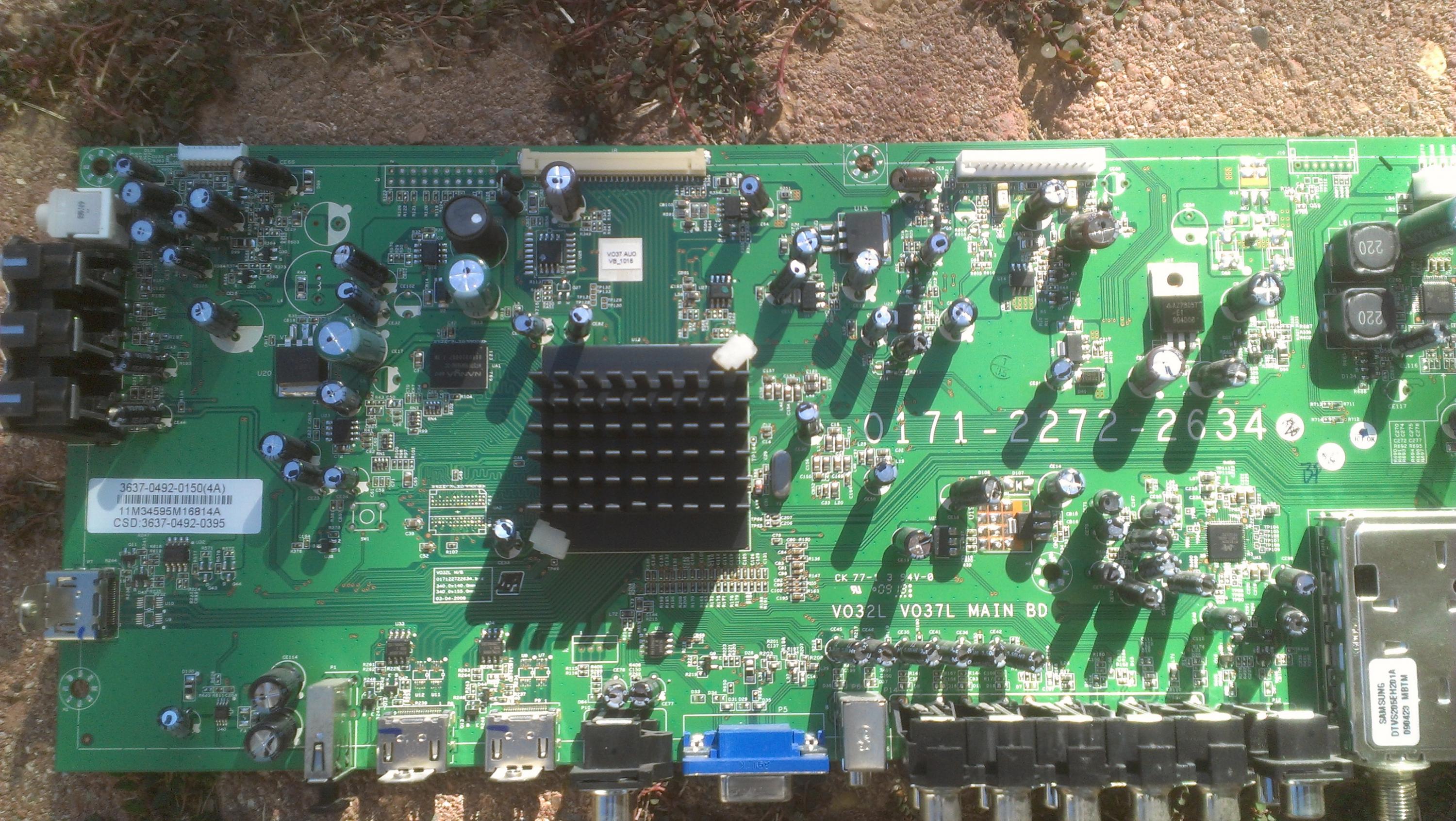

            Re: vizio v037l fhdtv20a no picture
            Upload a good pic of the main board
            • beer-b-q
              • Nov 2012
              • 38
              • usa
              Here are some

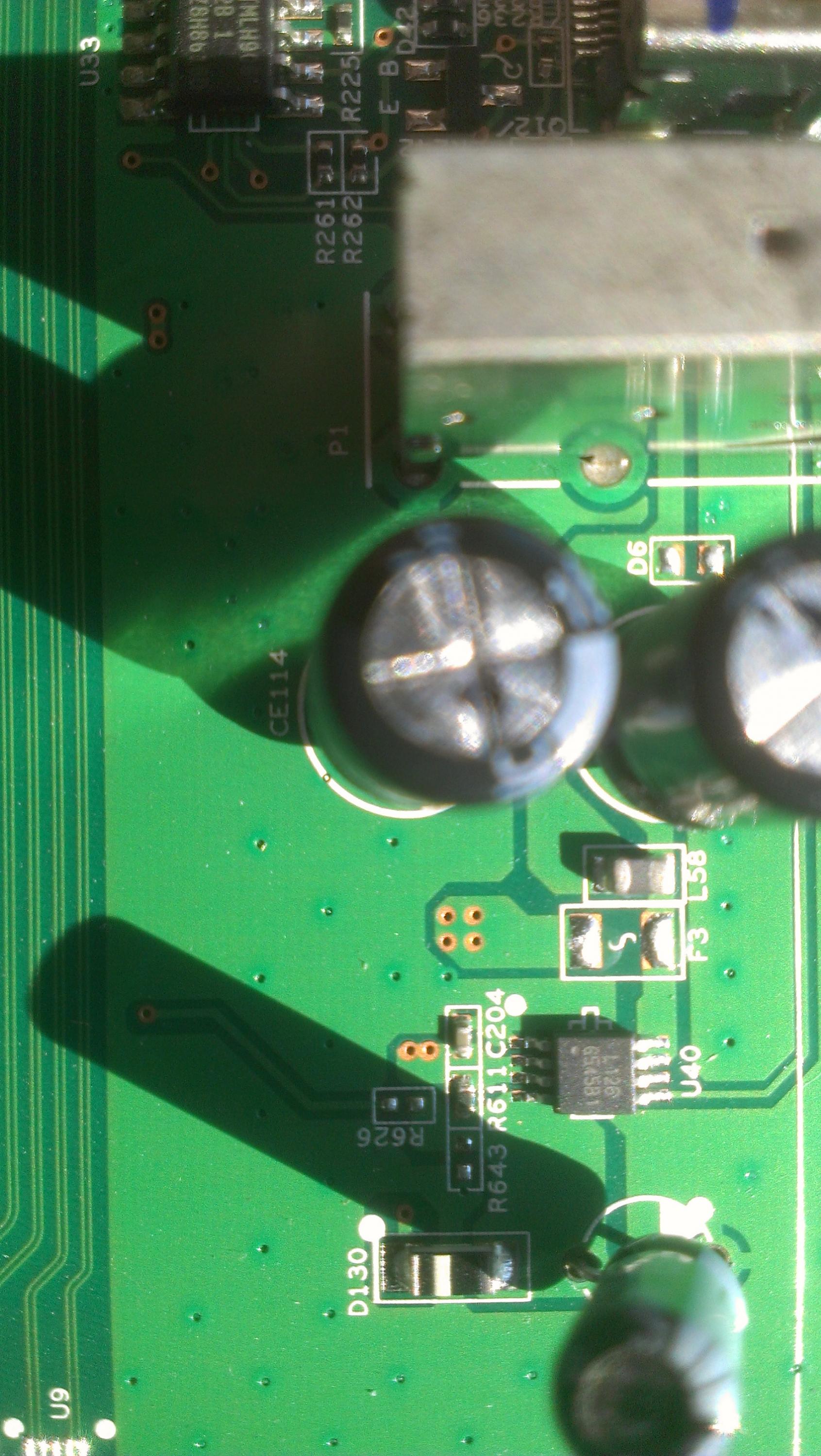

              • beer-b-q
                • Nov 2012
                • 38
                • usa
                The second pic f3 is not good.

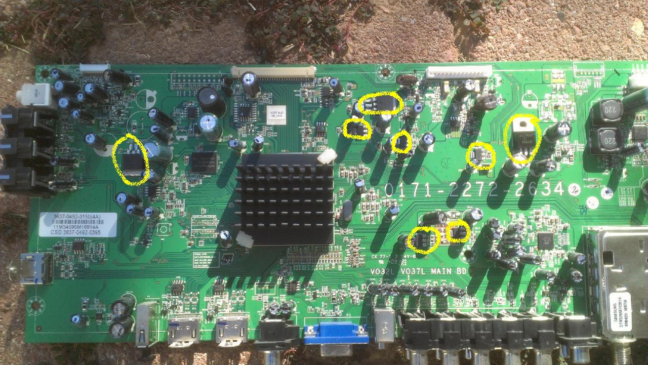

                  Originally posted by beer-b-q
                  Do you know how many I have I can only find one.
                  You have at least 8. Report your findings exactly in the format as described in the how to test a voltage regulator link.

                  • retiredcaps
                    • Apr 2010
                    • 9271
                    A good fuse should measure less than 1.0 ohms.
                      The f3 OL.
                      U17
                      1. 2.08
                      2. 3.33
                      3. 5.02
                      U22
                      1. 2.07
                      2. 3.32
                      3. 5.07
                      U20
                      1. .558
                      2. 1.80
                      3. 3.306
                      U15
                      1. 2.086
                      2. 3.33
                      3. 5.02
                      U21
                      1. .6
                      2. 1.240
                      3. 2.514
                      U19
                      1. 1.12
                      2. 2.515
                      3. 5.02
                      U44
                      1. 2.5
                      2. 2.9
                      3. 3.2
                      I need help finding fuses.
                      • retiredcaps
                        • Apr 2010
                        • 9271
                        Repost with the part numbers included. Without them, we have no 100% way of verifying if they are good or bad.
                          F3 is OL? That sounds like a problem. Can you check the DC volts on each end, relative to case.
                            U17
                            l112
                            g1117
                            1. 2.08
                            2. 3.33
                            3. 5.02
                            u22
                            l112
                            g1117
                            1. 2.07
                            2. 3.32
                            3. 5.07
                            u20
                            1084
                            0917al
                            1. .558
                            2. 1.80
                            3. 3.306
                            u15
                            1084
                            0917al
                            1. 2.086
                            2. 3.33
                            3. 5.02
                            u21
                            l112
                            g1117
                            1. .6
                            2. 1.240
                            3. 2.514
                            u19
                            l112
                            g1117
                            1. 1.12
                            2. 2.515
                            3. 5.02
                            u44
                            119cg
                            1117l
                            1. 2.5
                            2. 2.9
                            3. 3.2

                              • retiredcaps
                                • Apr 2010
                                • 9271
                                u21
                                l112
                                g1117
                                1. .6
                                2. 1.240
                                3. 2.514
                                u19
                                l112
                                g1117
                                1. 1.12
                                2. 2.515
                                3. 5.02
                                u44
                                119cg
                                1117l
                                1. 2.5
                                2. 2.9
                                3. 3.2
                                Recheck/remeasure the 3 above. All are suspicious readings.
                                  u21
                                  l112
                                  g1117
                                  1. .6
                                  2. 1.240
                                  3. 2.514
                                  u19
                                  l112
                                  g1117
                                  1. 1.12
                                  2. 2.515
                                  3. 5.02
                                  u44
                                  119cg
                                  1117l
                                  1. 2.5
                                  2. 2.9
                                  3. 3.2
                                  THESE WERE MV
                                  I found another
                                  U16
                                  AZ7805T
                                  E1
                                  904D08
                                  1. 3.3
                                  2. .4
                                  3. .4
                                  mv
                                    The readings are in millivolt? All of them?
                                    • beer-b-q
                                      • Nov 2012
                                      • 38
                                      • usa
                                      No just u44 and u16.
                                        I cannot spot any fault with the regulators. Is there an additional fuse on the board?
