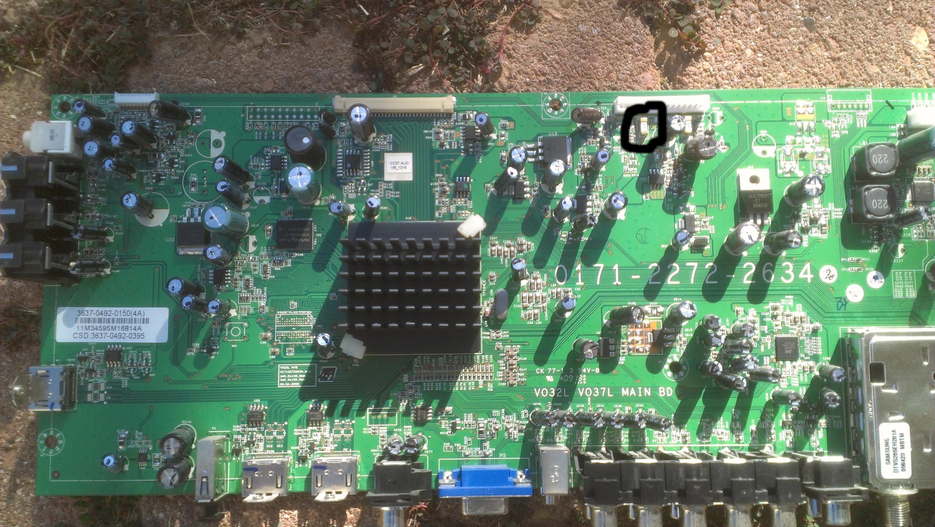

                          what is this part?
                            #73
                            Re: vizio v037l fhdtv20a no picture
                            Fuse.

                                #75
                                I can't remember which one is what but one of those fuses is on 5v supply and the other is 12v supply, you can check them for continuity with an ohm meter to see if either one is open, or check voltages on both sides of each fuse to verify they are good. If one or both fuses are bad you may have created a short somewhere while re-soldering the regulators. I messed up my main board doing a heat gun re-flow but it wasn't working right anyway,I ordered a replacement board and waiting on it to arrive. Good Luck with yours.
