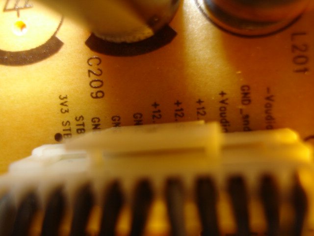

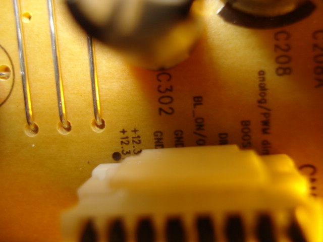

    Can you take close up pictures of the two white connectors on the top right of the power board? You may be correct that the Main board is damaged. Try disconnecting the T-CON board connector to see if the TV will start.

      Disconnected T-CON board, TV still not powering on. here are the close up pictures of Power Bd. Connectors.

            Okay, on the connector in the left picture above, at the bottom 1st pin is labeled 3V3 STBY and the 2nd pin is just labeled STBY, the 3V3 STBY has 3.3 volts no matter what, hitting the power switch or using the remote power does nothing, no change in voltage. The other pin 2nd pin up labeled STBY does Not have any voltage at all, power switch does not affect it.

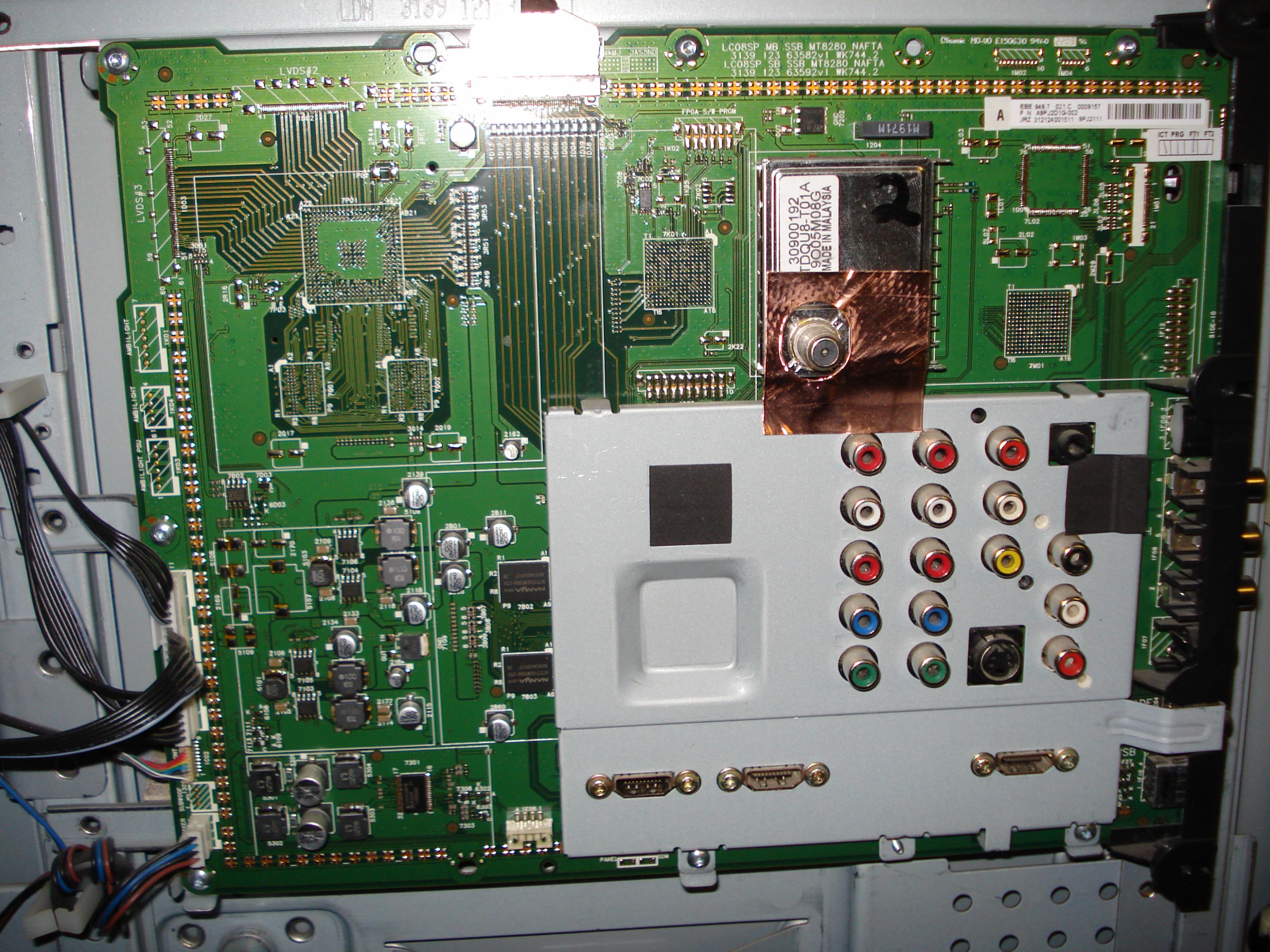

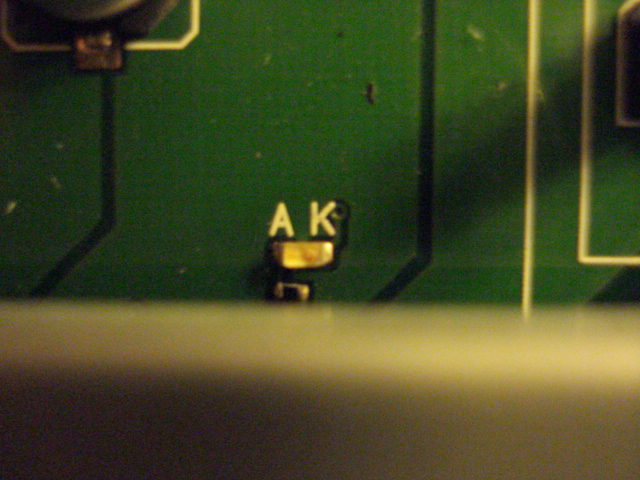

              Does anyone know what this is? it is very small and also almost looks clear on top with a round yellow ball or dot inside. It is located on the Mainboard of this Philips TV, it checks open both directions on 400 ohm scale.

                I removed and inspected the Main board, didn't see any fuses or anything obvious,this looks like another one where I will have to purchase a new/used Main board as a process of elimination, not getting much help, Since the Power Supply board was already replaced I assume it is good...looks like I'll have to remove the complete chassis from where it mounts just to get to the TCON board if it's bad. Any advise would be greatly appreciated.

                  What you can do to see if the backlights inverter is working or not, you can remove that connector (3.3v, stby) from the power supply board and use 1k resistor to jump between the 3.3V pin and the STBY pin next to it, and another 1k resistor between 3.3v and the BL_ON pin on the other connector, the backlights then should come on, that way you will not get a surprise that you also have bad backlights.

                    does that mean when applying approx 3.3 volts the BL_ON on pin on the power supply bd. that it should make the backlights come on by switching on the 24 volts to them?

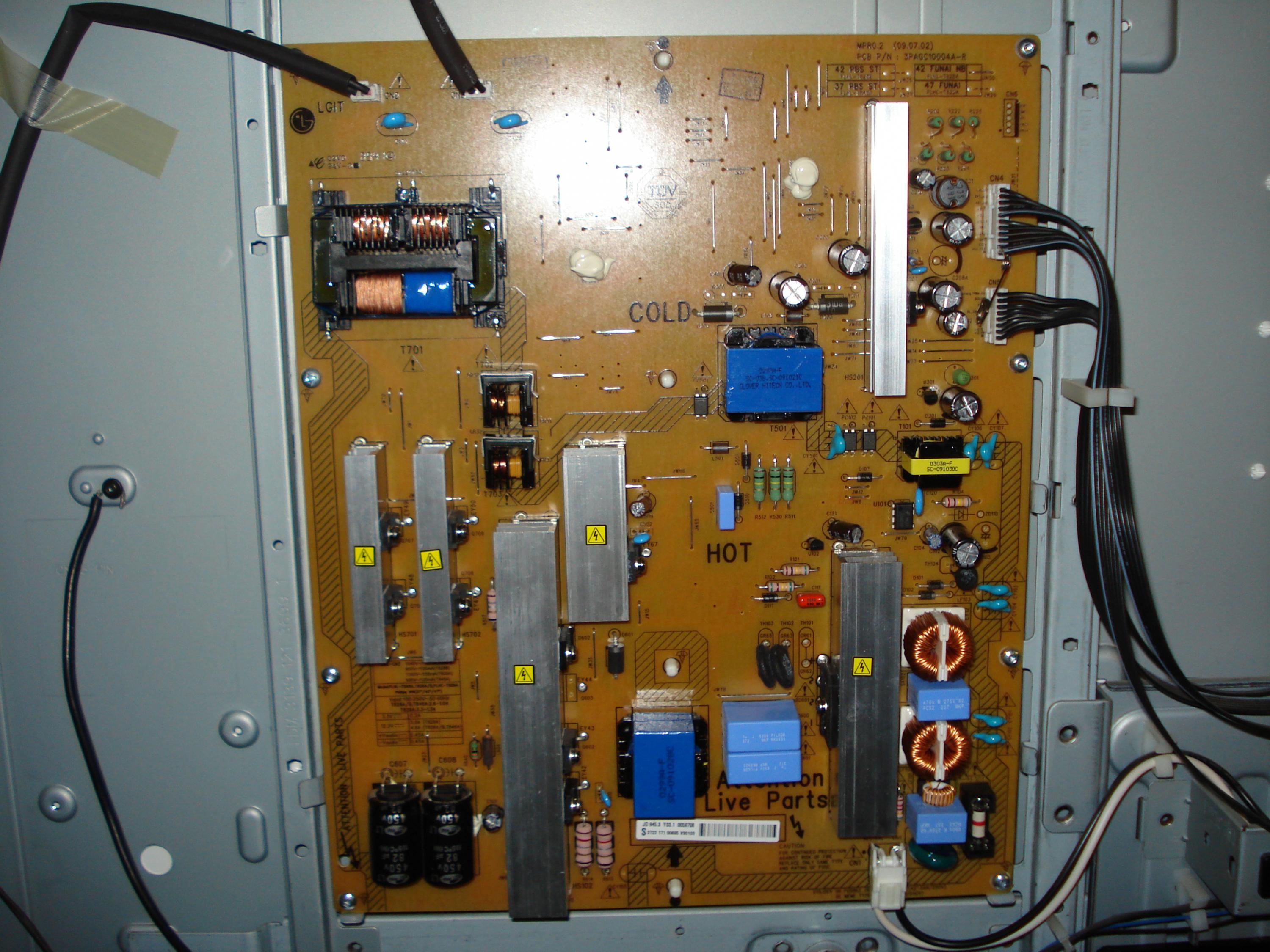

                                    I get 12.3 volts at the power supply anyway without installing a resistor on 3 pins of one connector and 2 pins on the other connectors shown on post # 3.
                                    Also If I remember correctly while measuring some voltages on the power supply board I got either 18 or 24v on the cathode of the 2nd black diode marked 31DG going left to right from the word cold at the top of the PS Board.
