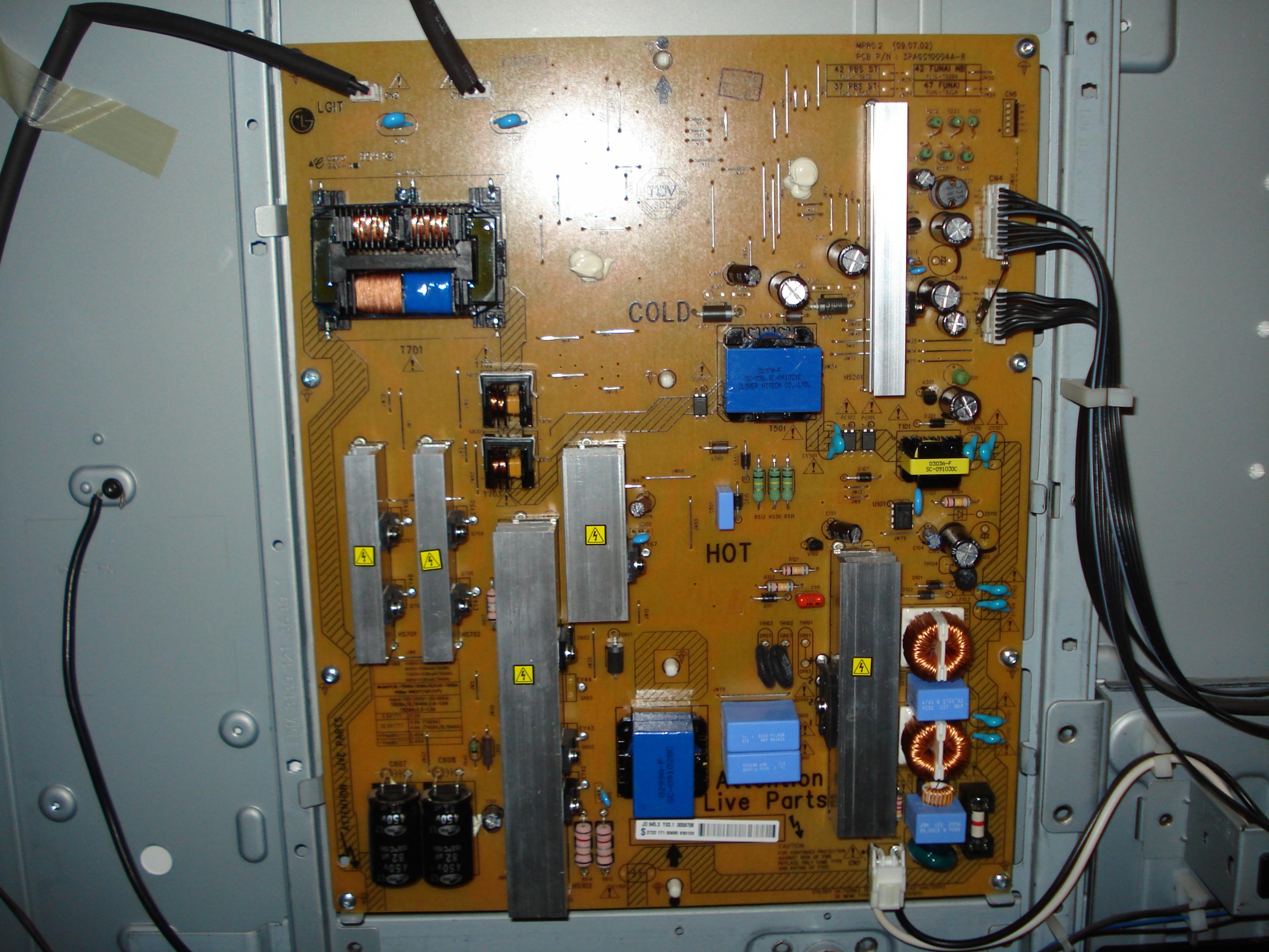

    Looking at Post # 3 you can see pictures of the two Power Supply Connectors. I'M NOT SURE OF WHAT TO DO NEXT, the power supply board was replaced by someone else prior to them giving me the TV, I also posted earlier that the part number of this board is not exactly the same as what I think it should be.

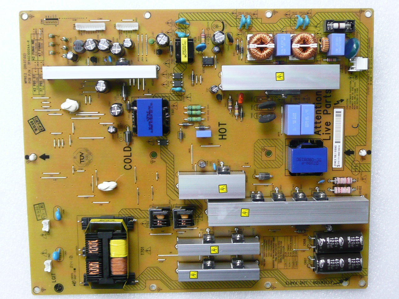

      Here's Pics of the the two different Power Supply Boards..the one on the right is the board the guy replaced in my Philips 47 LCD and the other one on the left is on ebay and it's supposed to be the exact replacement for my model TV...The only difference I can see is that there is one less mosfet on the board I have now compared to the other having 4, mine only has 3. this is on the longer heat sink close to the two 450V Electrolytic Capacitors. I also noticed my board has one less capacitor near the rail voltage/pin connectors.

                OK, the two power supply boards you have. Do the two white connectors cn4. cn5 have the same labeling on them I.E.: 12V STBY, ETC. and the pins match each other?
                This is power supply-inverter board combination, the inverter section uses 380~390VDC for driving the inverter transformer, it does not use 24V for typical inverter setup.
                      Bud, Unfortunately I don't have the old Power Supply Board, the guy I got the TV from said he didn't have it, I don't know what he did with it, I wanted to get it along with the TV.
                      but I have compared the different boards available and I'm almost sure they have the same connectors cn4 and cn5 labeled the same
                      Please go here and look, the board he put in the set ends in 0695, shopjimmy shows this model using 0692 or 0696. http://www.hdtvparts.net/products/38...t828a-phi.aspx
