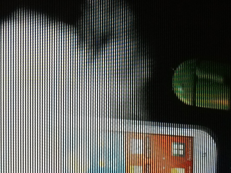

    Is this 55" Hitachi a good buy? (lines on screen)
    Model 55HDT79
    Screen has horizontal lines
    Price is $80 USD
    Sorry this is this only picture, and I can only see one distinct line around the bottom 1/4. I think I see see faint lines throughout but It could just be the camera...
    If its a bad board, I think I will snatch it up. I don't think I want to hurt my back for a bad panel.

    Re: Is this 55" Hitachi a good buy? (lines on screen)
    Can't see the fault, but:
    Lines from top to bottom = Don't buy
    Lines from left to right = Buffer failure, will need buffer replaced (~$50) plus a big cap
      Look at the bottom 1/3 of the picture, there's a (fairly unobtrusive) line from left to right there. I would agree it's not a bad panel.
        Ah, I see it now. The only way that could appear like that is a bad buffer. Shouldn't be too difficult to fix. Usually it'll short out the whole lot though, it's quite rare to see single lines fail on a buffer. However, I believe when the buffers fail they take out a cap on the PSU. Or, the cap failing on the PSU takes out the buffers. Not sure which way around it is... haven't done a real Hitachi plasma yet (only an LG based one.)

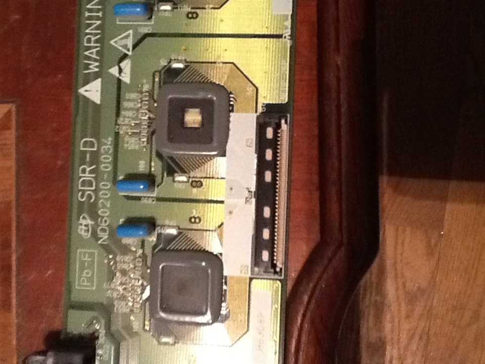

                It has boards X-SUS PWB, X-BUS PWB, Y-SUS PWB, SDR-U PWB, SDR-D PWB.
                Which is the lower buffer?
                  SDR-U is Upper (Up)
                  SDR-D is Lower (Down)

                            Ok, I got the tv up and running. I will try to describe the problem better. That one 1cm line you can see is the only part of the picture that is displaying correctly. The entire remainder of the screen has one horizontal line of working pixels followed by one line of black pixels and this pattern repeats all the way through. So every other row seems to be working. Still a buffer board problem?
                              I have seen that both with loose buffer connections and with bad buffers. The displays on some older plasmas are interlaced. I suspect you only need to replace the one with the line on it.
                                  No, the buffers control each part of the screen themselves, but when one goes bad, it can cause a problem with the -whole- of that scan. So the odd lines are energised, but the TV sustain senses that short, the TV goes blank for that field, then the evens are fine so you see all of those light up, etc. That's my theory. I've never seen a buffer line failure, only a completely dead buffer.
                                    I think you nailed it! This is the bottom buffer board. Is there anything else I need to check before powering on with a new board?
                                        Is there anything that may have caused this IC to explode other than just old age? These boards are kind of expensive. I don't want to hear a pop when I plug it in. Should I check anything on y-sus?
                                        By the way the square in the middle of the right IC is hole where is failed. It's hard to tell from the picture.
