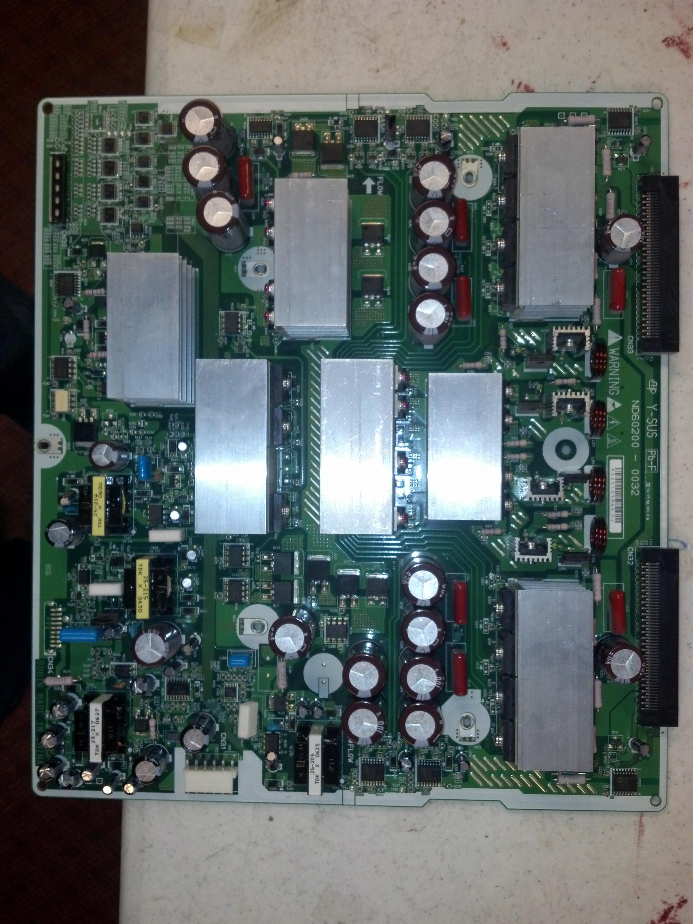

      The harness that goes from psu to xsus does not include Vs in any of the labels. Only the harness that connects X and Y have the Vs label. In the service manual it shows where a test pin for Vs on the PSU. I tested it, and I get nothing...
      EDIT: The harness that is going from PSU to Xsus is labeled "VSI" "VAI" and "VCC"... Is VSI the same as VS?

          With the power unhooked from Xsus and Ysus (all the ribbons are still connected, is this ok?) there is no Vs coming off of the PSU. So I guess the pop came from the PSU? But the TV still powers on with sound... Possible just the Vs rail broke?

            Possibly, do you have Va/Vda/Vdata?

                I have read that IPMs often produce a pop when thy fail. How can I identify which chip is an IPM?
                Also, aren't the two boards on the sides of the plasma panel normally called y and z? I just noticed this hitachi calls the one to the right x.

                  I doubt this set uses IPMs. It will all be discrete if it is a Hitachi. That is, all MOSFETs, IGBTs and diodes. But if you post a picture, I'll be able to tell for sure.

                    It would be a rather large chip under a heat sink, right? I don't see one...

                      No IPMs, all discrete. Good on Hitachi...

                        Do transformers go pop when they fail? I have been over the board with a jewelers loop and cant find anything that looks broken.

                          No, they very rarely fail.
                          Things to look out for would be ICs near the MOSFETs/IGBTs.

                            Just out of curiosity I put my blue ring tester on the transformers and there is one that does not ring at all. I tried all combinations of pins.
                              #74
                              Re: Is this 55" Hitachi a good buy? (lines on screen)
                              That's odd.... which one is it? (Can you highlight it on the image for me.)
                                #75
                                White one that is in the bottom left corner. 25-217
                                It rings on the pins to the right, but nothing but shorts on the left.

                                  And on the other white transformer, the best result I can get is 1 yellow LED. This one rings OK on the left side, and not so well on the right side.

                                    That might indicate a short on the board somewhere. Sorry I'm not much help... I have no experience with Hitachi plasma panels. What's the part # of the board? Maybe it's cheap somewhere else...

                                      Its ND60200-0032
