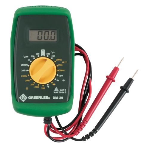

              Measured Voltage at Q201 it is double again at 50.7v, I am going to get my neighbors volt meter to double check, but both my meters can't be wrong lol...all the voltage spots through out the house, appliances, batteries, cable boxes are all correctly reading
                #147
                Re: Magnavox 32md359b/f7 White Screen and with sound only
                Very odd, how are you measuring voltage, can you show a pic of your meter with it in the normal measurement setting, also try repeating the measurement on the 500, 600 or 1000V range.
                • YEROC37
                  • Sep 2012
                  • 119
                  #148
                  I'm using the 300 and 200 readings on right side of my meter
                    #149
                    Well by all means that should work although it wouldn't surprise me if the 300V and 200V are somehow sharing components (part of a voltage divider ladder - it's complicated...) But you get the same results with a different meter?
