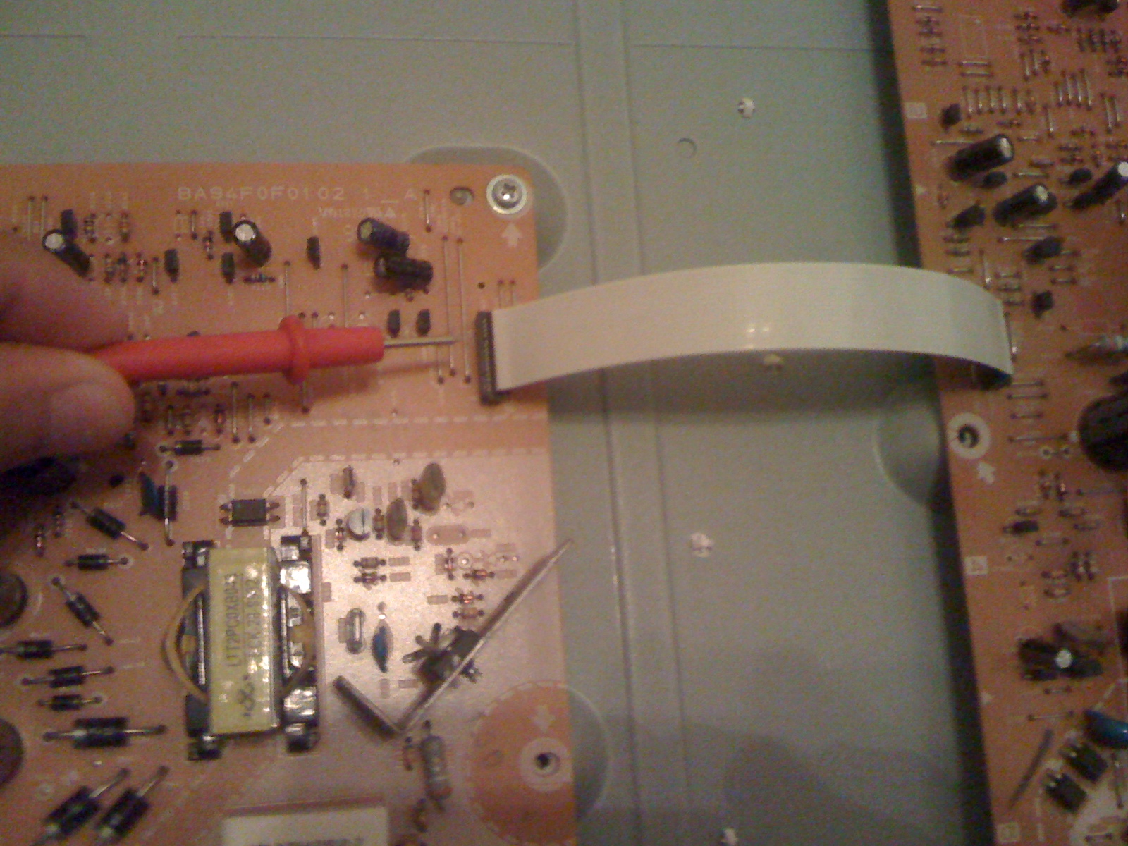

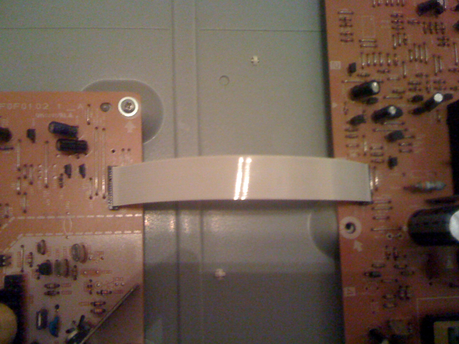

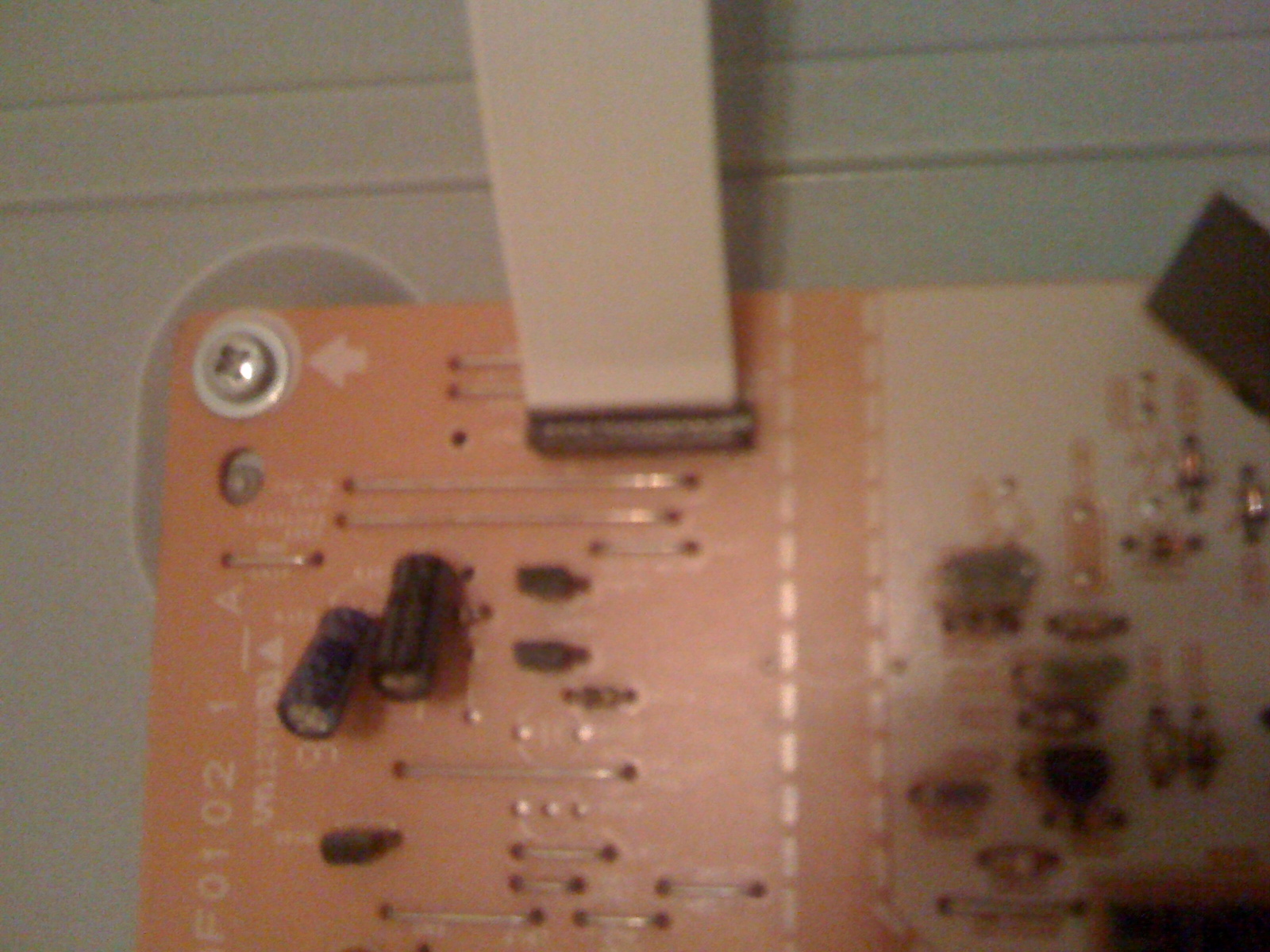

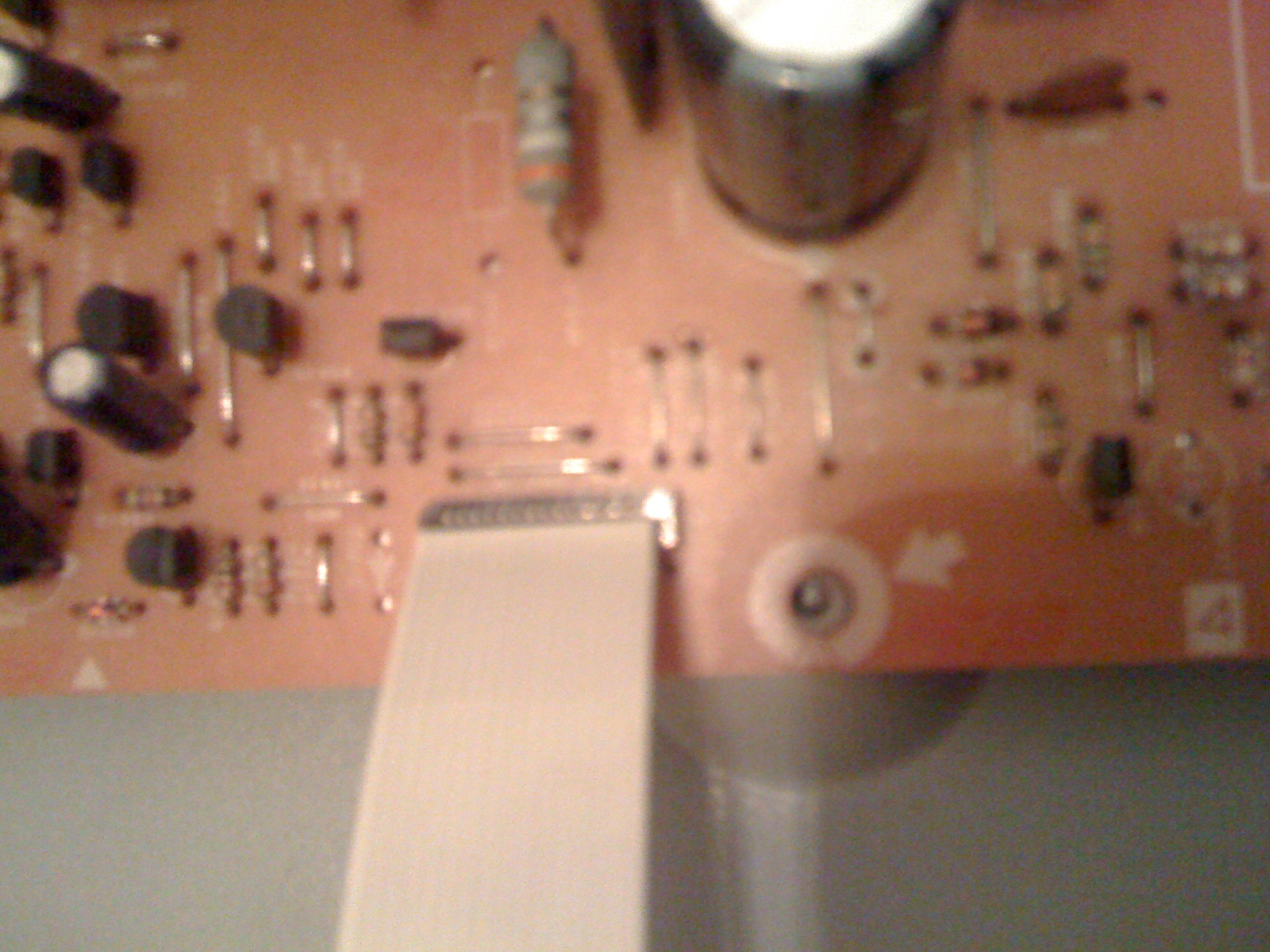

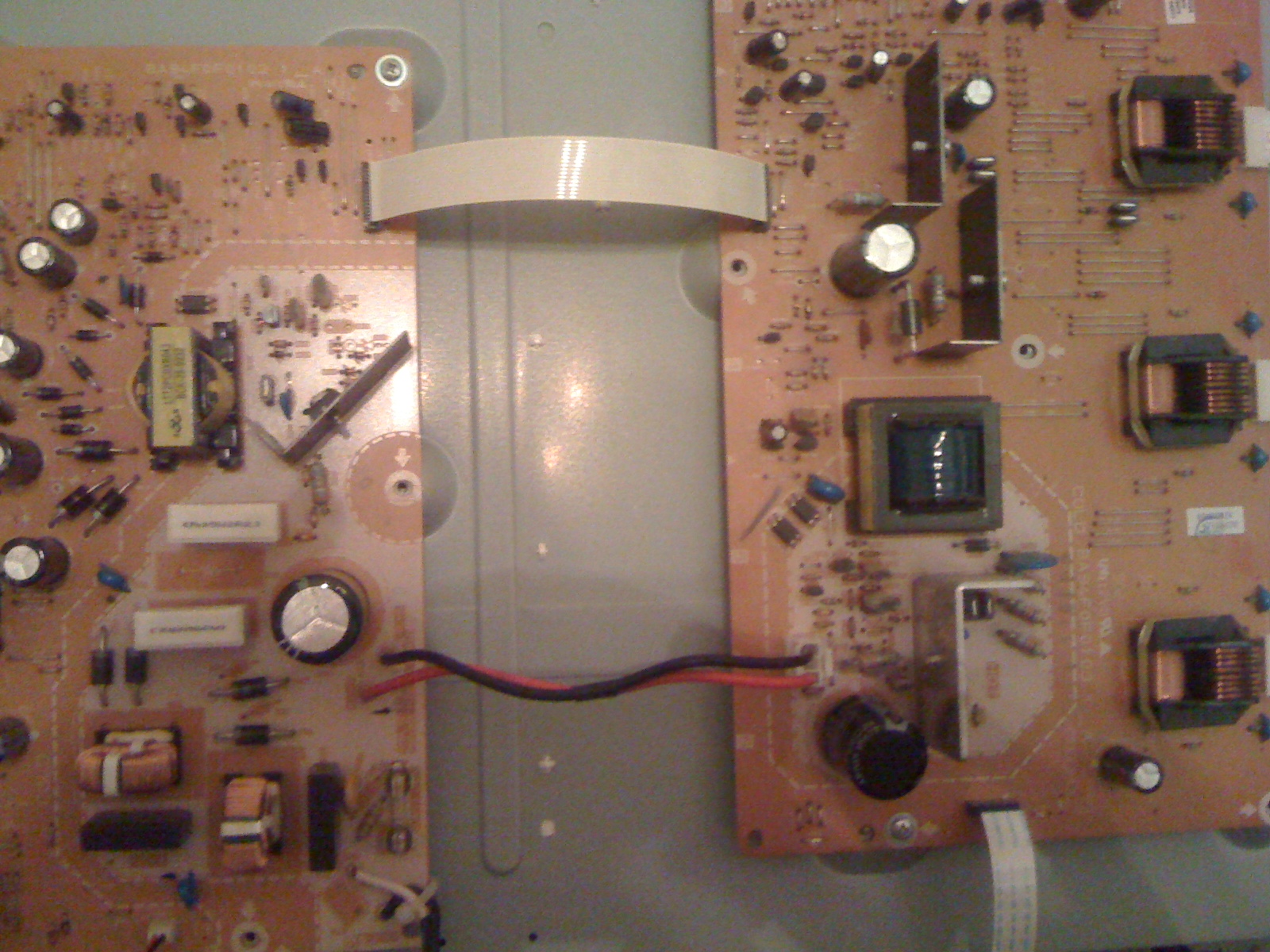

                                        #59
                                        Re: Magnavox 32md359b/f7 White Screen and with sound only
                                        I hope this helps, I placed testing probe next to pin slot I'm testing
                                          #60
                                          Oh, I didn't expect that. I thought it would be some kind of multi-wire connector but it's flat flex.
                                          Can you see an R1035, or R1036, or Q1005 on the top side? They will probably be near that connector you have been probing, on the inverter side.
