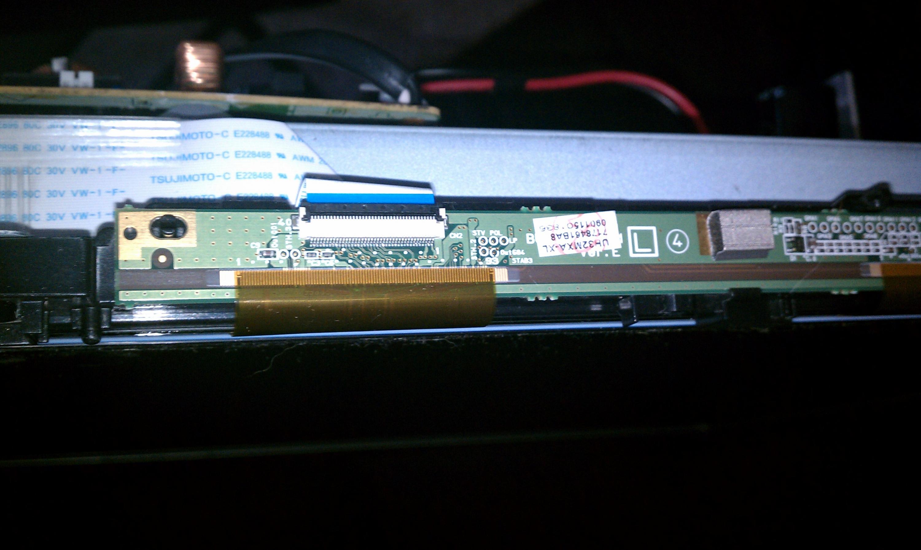

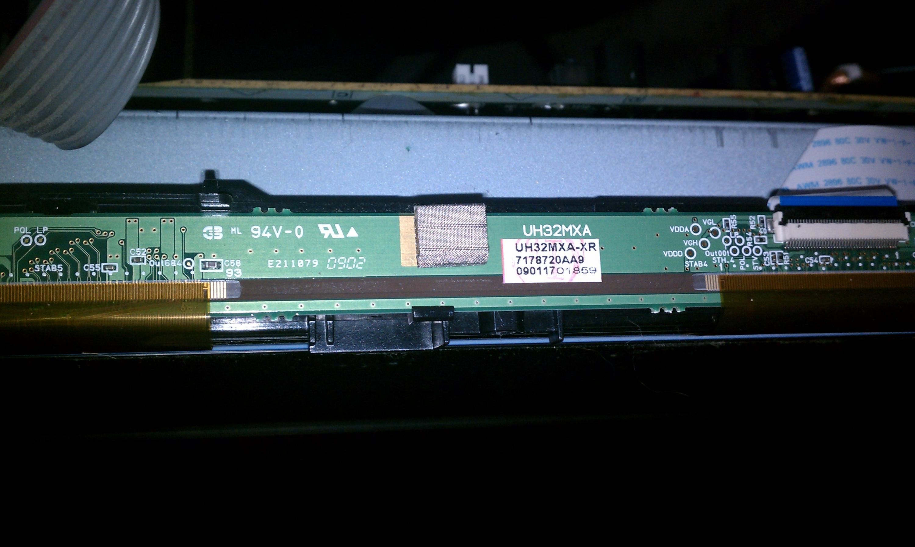

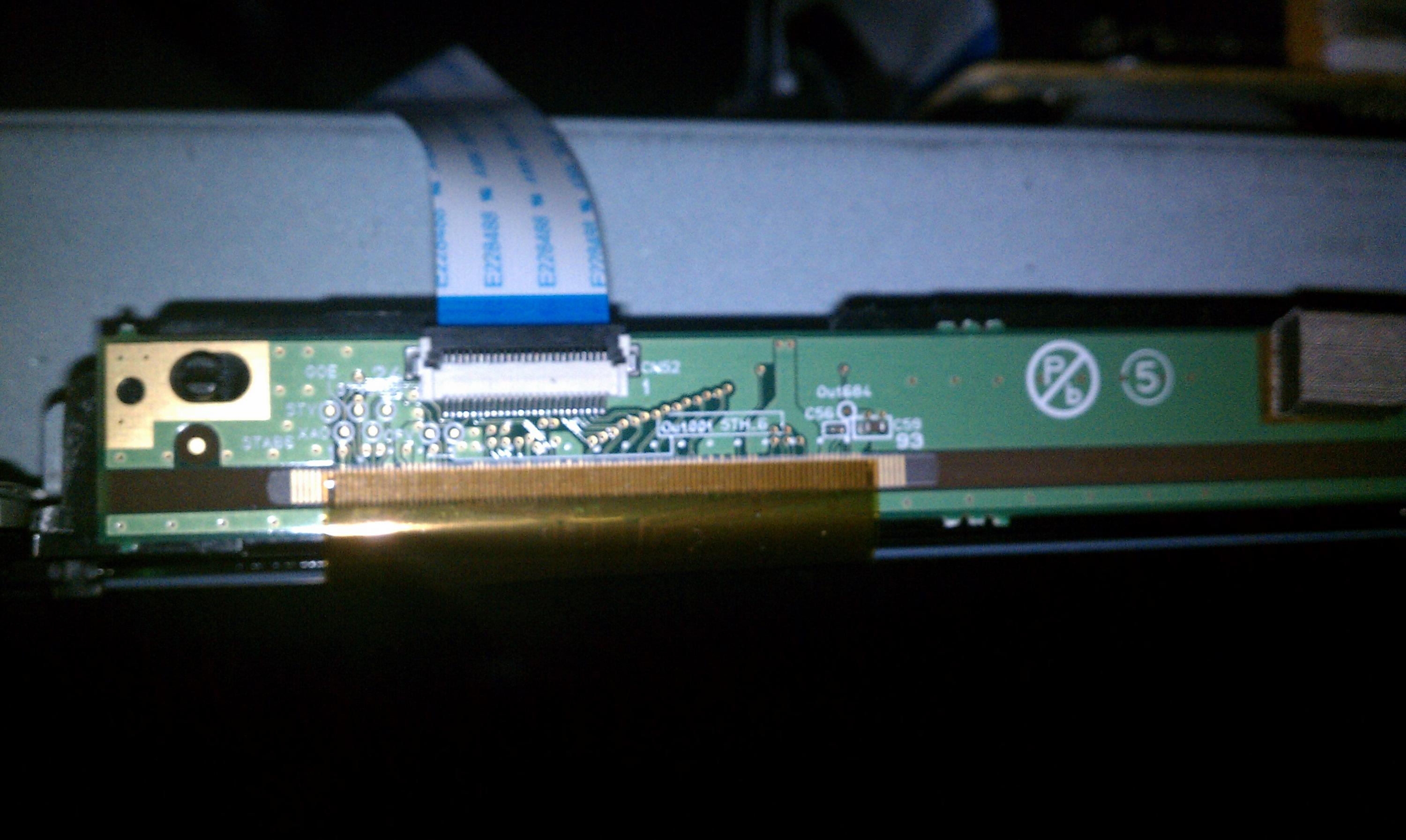

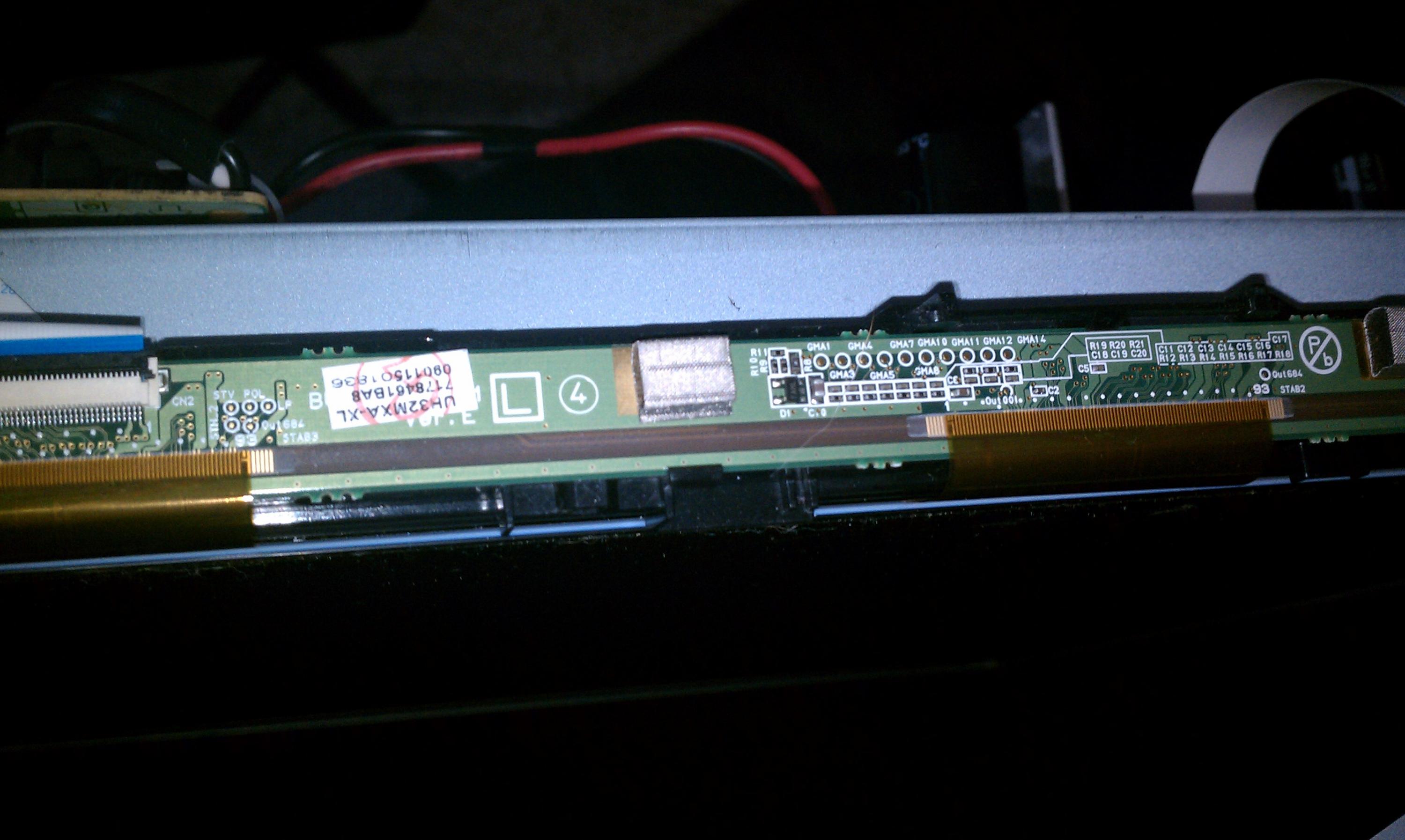

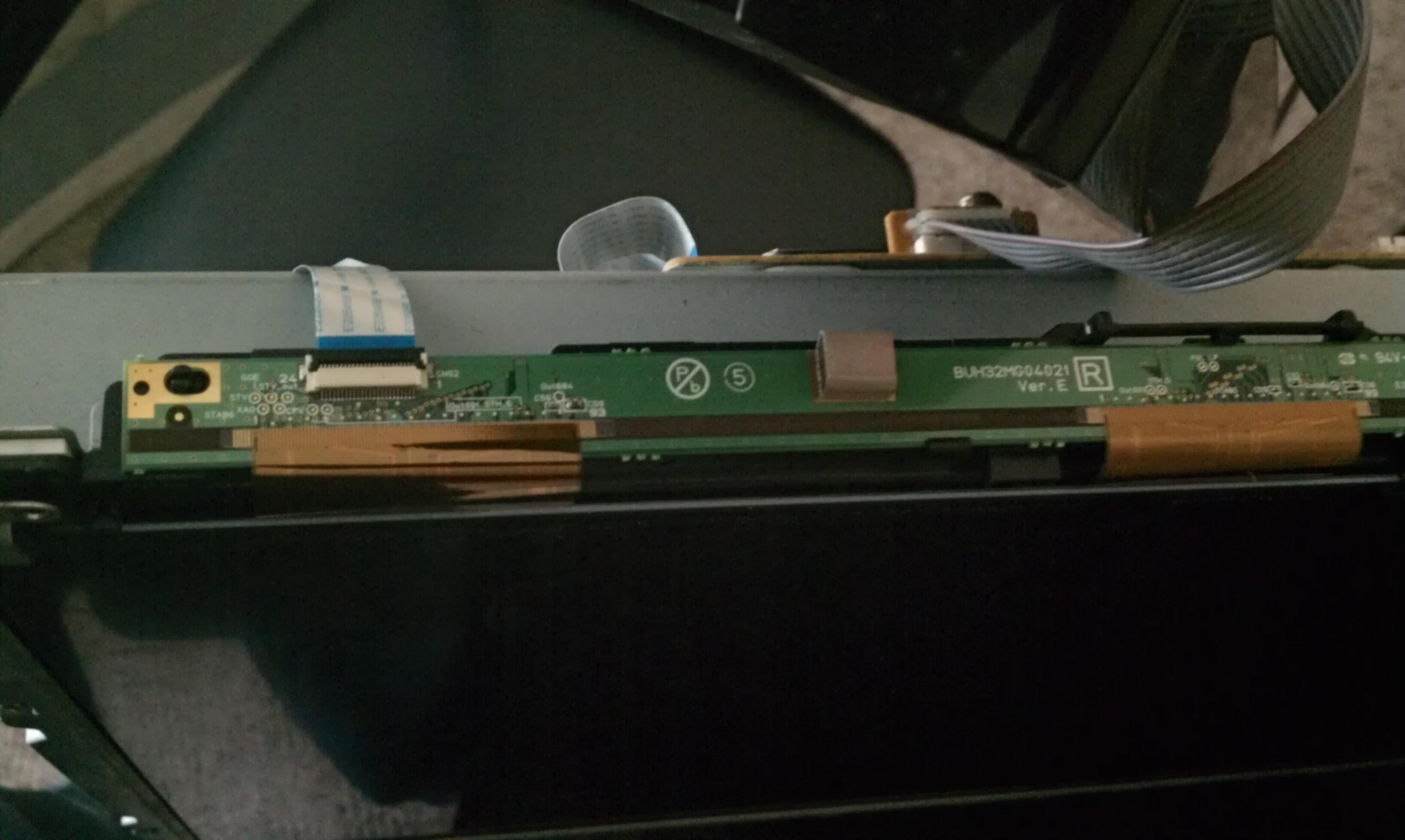

                            Can you get a picture of those boards? Schematics for those aren't provided. I'm just hoping there's a fuse on one of them.
                            • YEROC37
                              • Sep 2012
                              • 119
                              #174
                              Re: Magnavox 32md359b/f7 White Screen and with sound only
                              Pictures coming in a few ....Thanks again..Your pretty awesome to be teaching me this
                              • YEROC37
                                • Sep 2012
                                • 119
                                #175
                                Here are some pics
                                • YEROC37
                                  • Sep 2012
                                  • 119
                                  #176
                                  Here is another
                                    #177
                                    As I suspected, there isn't much on those boards. A few test points though. VDDD, VDDG, etc. Can you test them? Red probe on test point, meter on DC, black on chassis, TV displaying white screen.
