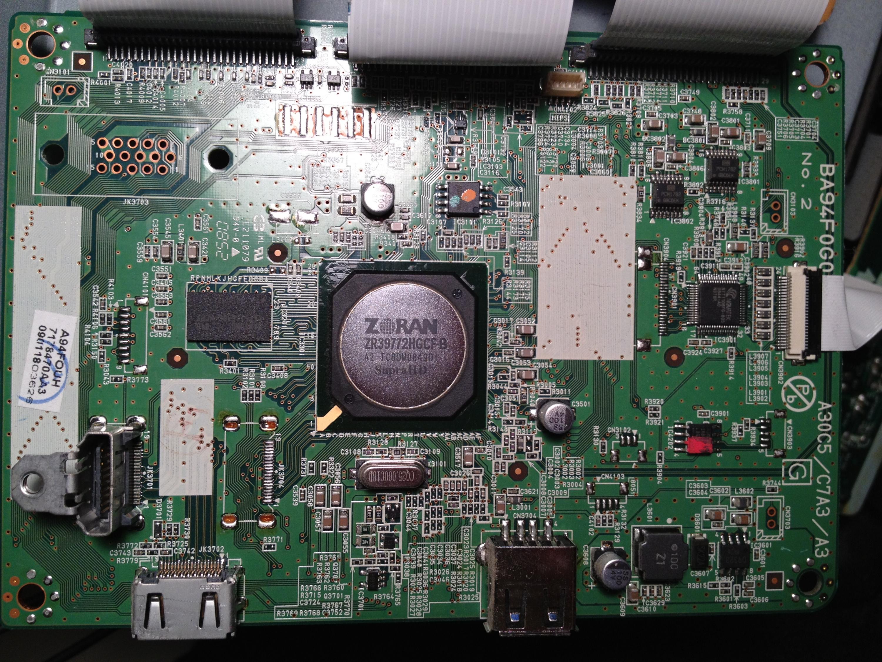

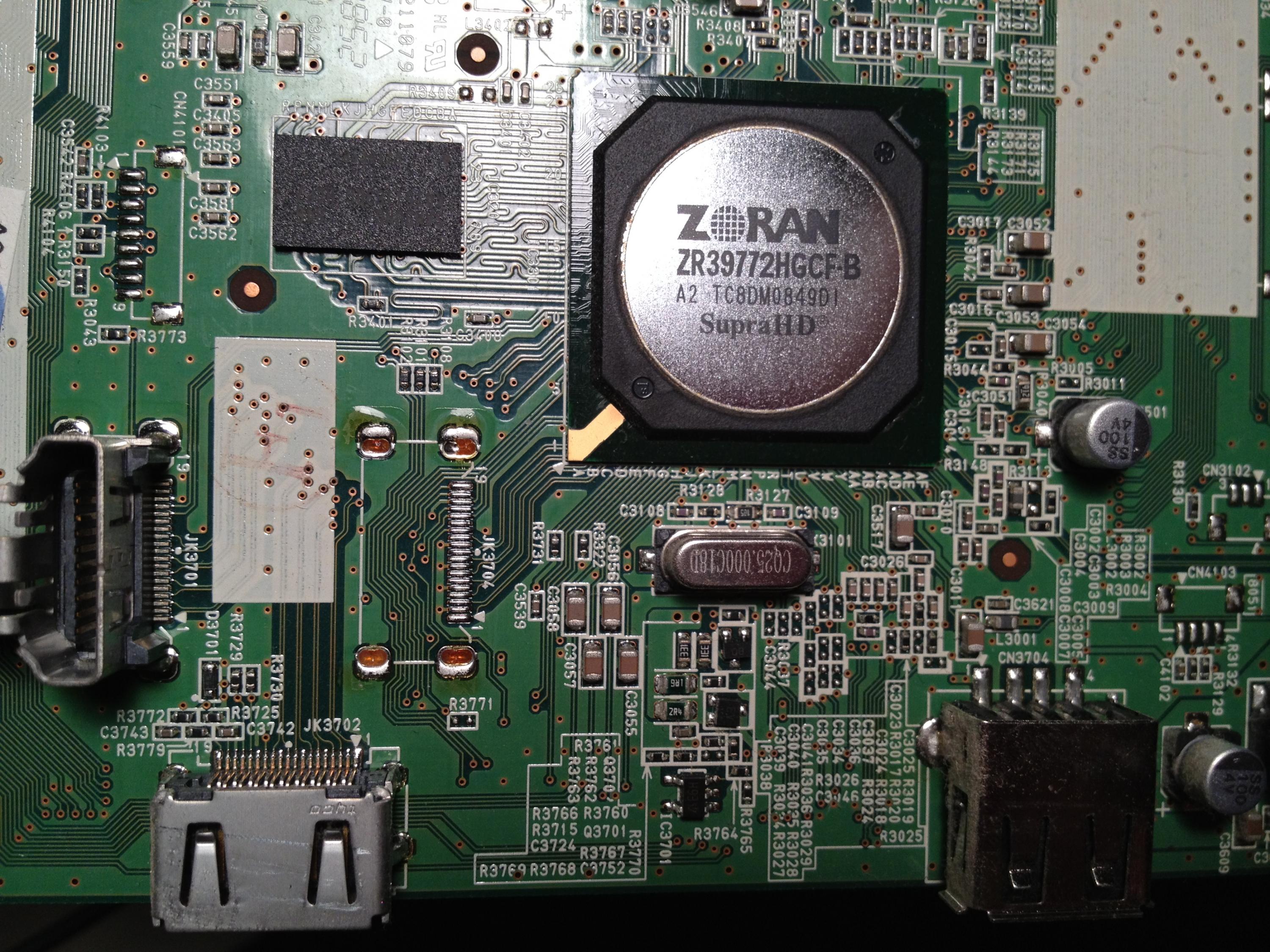

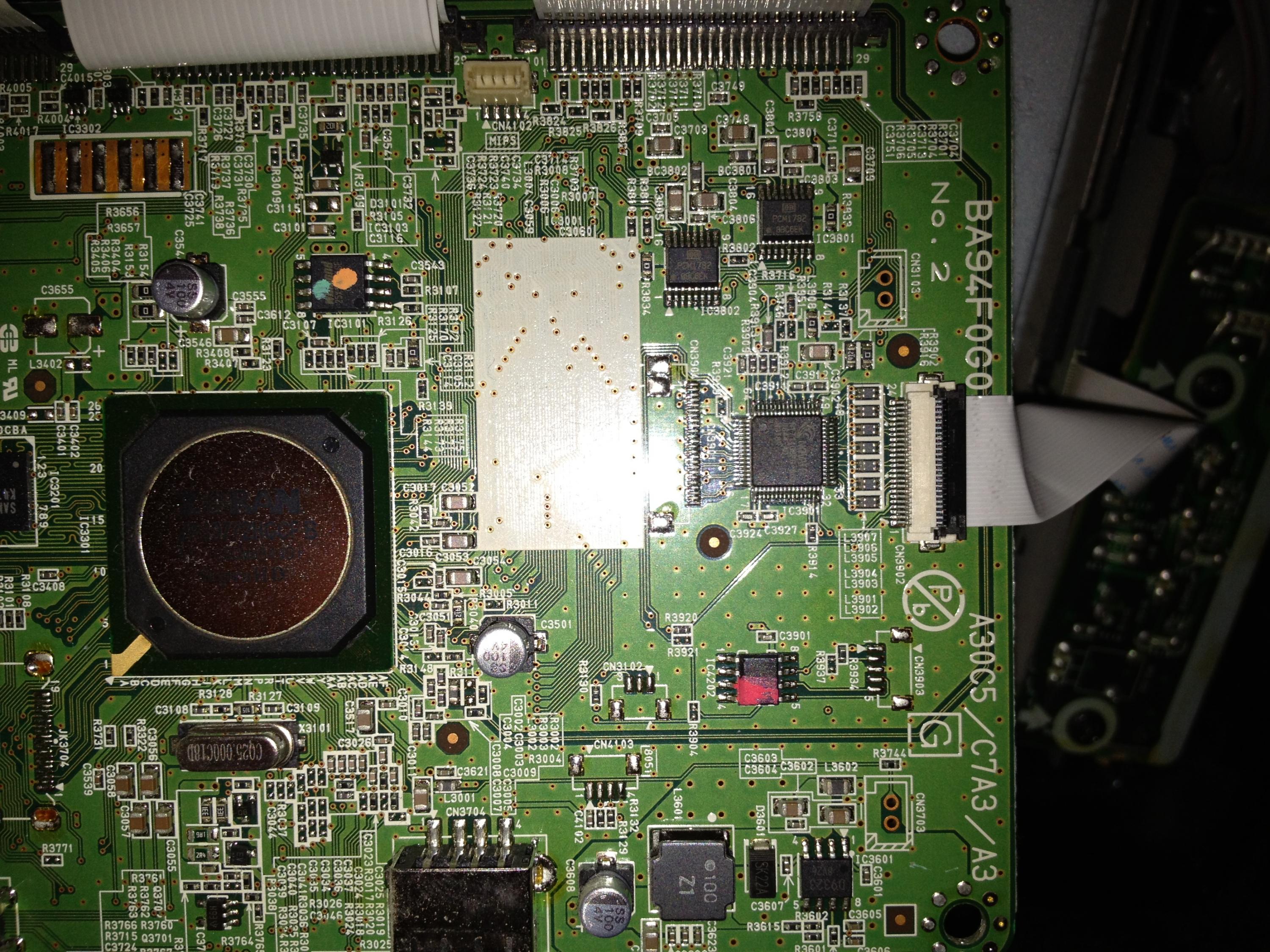

                OK couldn't resist - got to sleep soon though! Which end of the the board plugs into the LCD panel (it will go up into the metal frame, possibly onto another board) and which end into the yellow/orange boards?
                • YEROC37
                  • Sep 2012
                  • 119
                  #128
                  Re: Magnavox 32md359b/f7 White Screen and with sound only
                  the last pic shows the flat flex, that is it
                    #129
                    All three go to the LCD?
                    • YEROC37
                      • Sep 2012
                      • 119
                      #130
                      CN3902, it sits at base/bottom
                      • YEROC37
                        • Sep 2012
                        • 119
                        #131
                        No, it's the single flex in the pic...its on the right hand side
                          #132
                          Odd arrangment; the other two go to the yellow boards? I'm trying to figure that out, have the bent the cables over for one set?
                          • YEROC37
                            • Sep 2012
                            • 119
                            #133
                            No the three go to the power supply board and the flex flat cable that is off to right side by itself goes to the LCD
                              #134
                              Oh OK. That cable is just smaller than I expected for the kind of data but this TV is designed in a unique way.
                              • YEROC37
                                • Sep 2012
                                • 119
                                #135
                                There are two flex cables going to that LCD ...One from Inverter board and the one which is shown on the system board in the pic above
                                  #136
                                  Is the board on the LCD just a long thin strip? I am hoping it might have a fuse, but I don't think it will.
                                  • YEROC37
                                    • Sep 2012
                                    • 119
                                    #137
                                    Yes it is
                                    • YEROC37
                                      • Sep 2012
                                      • 119
                                      #138
                                      I see no sign of a fuse on board,
                                        #139
                                        Hmm, you are getting sound, so most of that SupraHD chip is working. I think the only possibility is something on the LCD isn't working right. But they included no fuses... There are some drive voltages, -6.8V, +16V and +22V. These are available on CN1001, which goes to the inverter.
