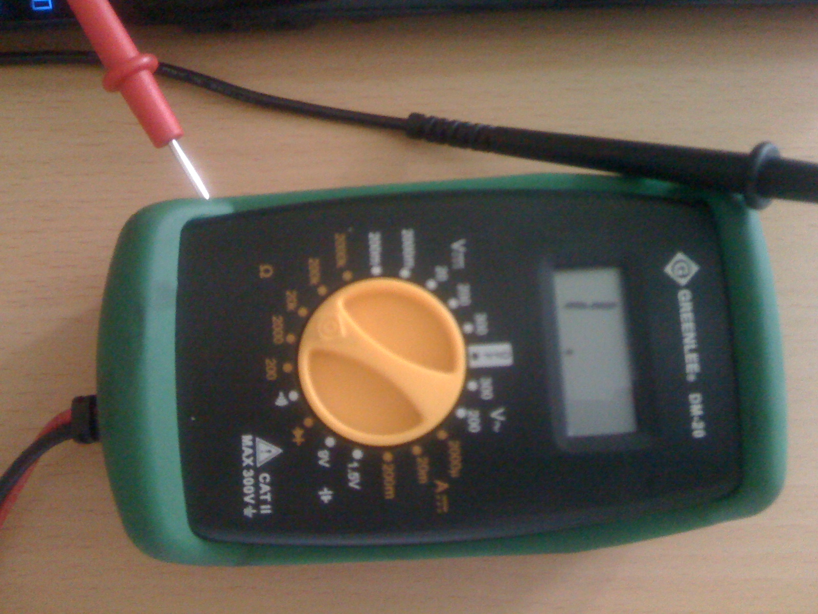

            Can you show a picture of the meter in the setting you are using just so we can be sure it is OK. When probes are not touching do you see a "1"?

              Re: Magnavox 32md359b/f7 White Screen and with sound only
              On 20k ohm 13.87 13.84 13.92 13.99
                yes when probes aren't touching I do see a one, sending picture now

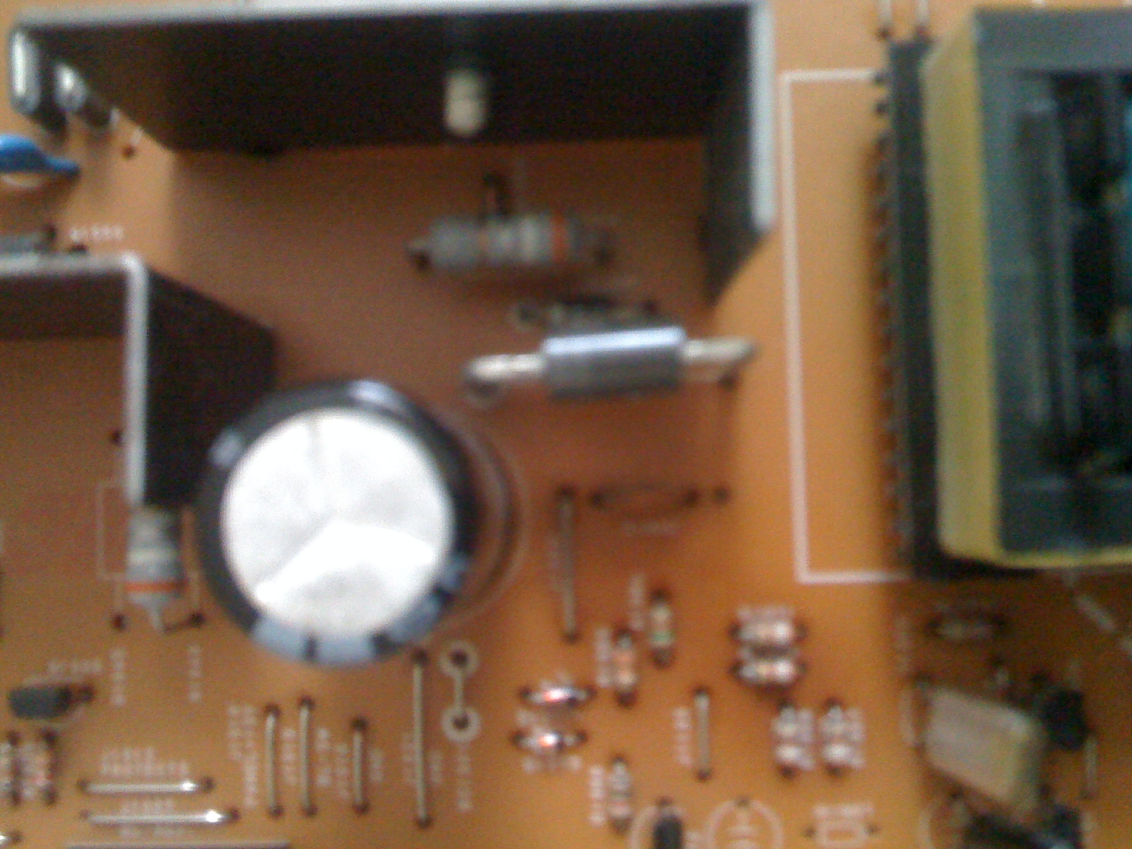

                    I am happy to help. Any TV saved from landfill is a victory.
                    All your transformers are fine they are well within spec. Next check, see picture. Use 200V DC range. I have no idea what it should be, other than around 50V, from what I heard of this chassis, but it is really unconventional.
                    I am suspecting you may have a broken CCFL tube inside the screen, but to find out you will need to take it apart - literally pull the LCD off - and it's not an easy operation and one that is easy to mess up.
                      186 volts tom66,
                      • YEROC37
                        • Sep 2012
                        • 119
                        #31
                        I don't understand why it would be broken unless it fell right? So in taking this off, is this a repairable job at a low cost?
                          #32
                          We have seen bulbs on this forum which have cracked without obviously being dropped - at least according to the owners. I don't know how or why it happens, but it seems to be happening. Perhaps some internal pressure of small crack introduced at the factory damages them.
                          What is the voltage rating on that nearby big capacitor? 186V is very high. Far higher than I expected. Again this chassis is alien to me though so I am not sure what it should be.

                            #33
                            470uf/100V that is the rating on the Cap itself
                              #34
                              It shoudn't be 186V then if the cap is only 100V rated. Maybe that test point is incorrect. I am checking the SM now.
                                Ok on one side the left side it reads 186 on the right side it reads 56, from description points from above picture...
                                  It's definitely 186 volts though...
                                    Point closest to Cap reads 186V....furthest side reads 56
                                      It may be that I told you to test the wrong side. 56V seems much more reasonable I recall someone else here had around 50V.
                                      I have looked at the schematic and they use a very dodgy feedback scheme which looks like it doesn't have a specified voltage.
                                      There should be a pin marked BACKLIGHT-SW on the connector "CN201". Can you see it?
