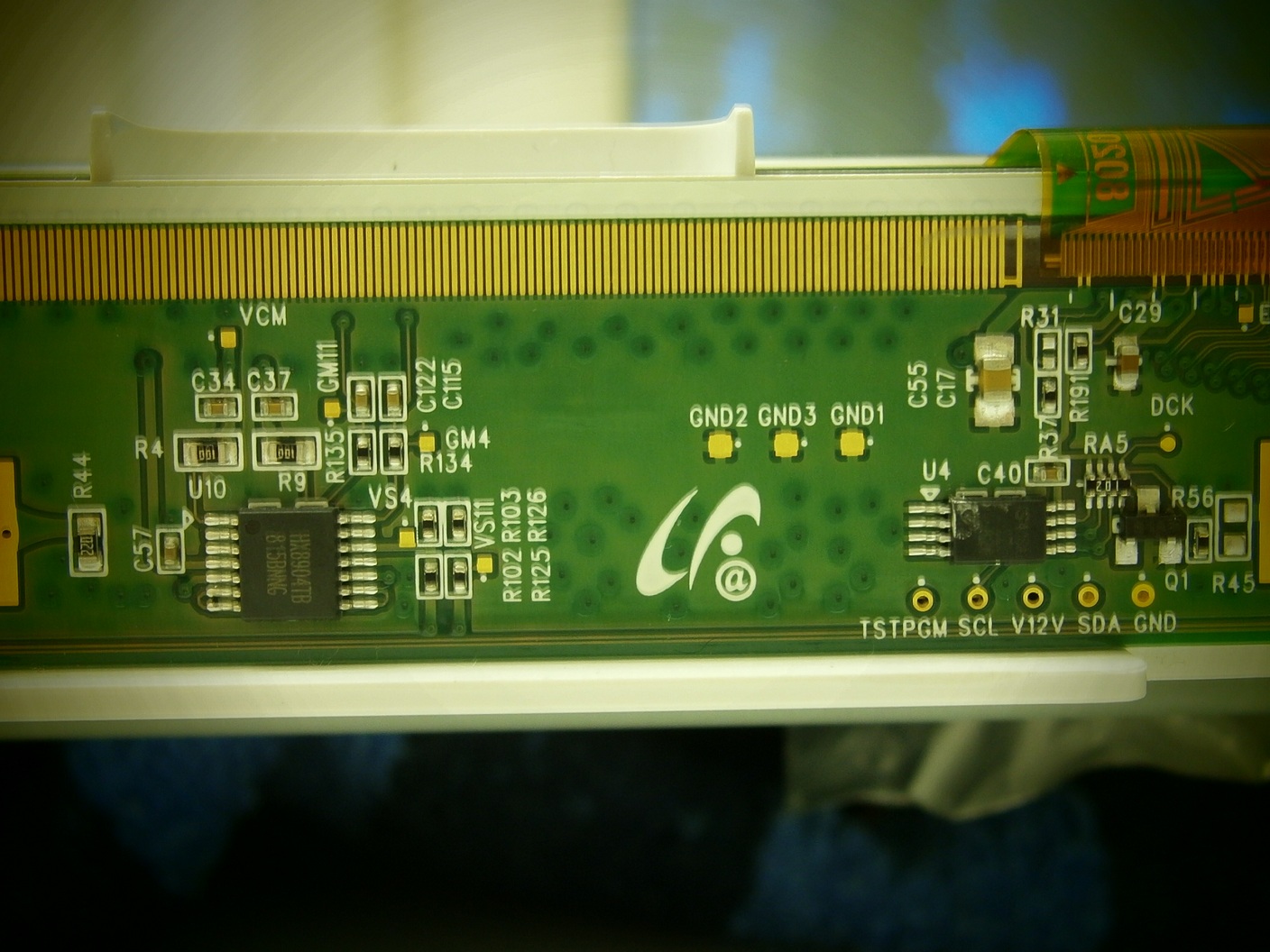

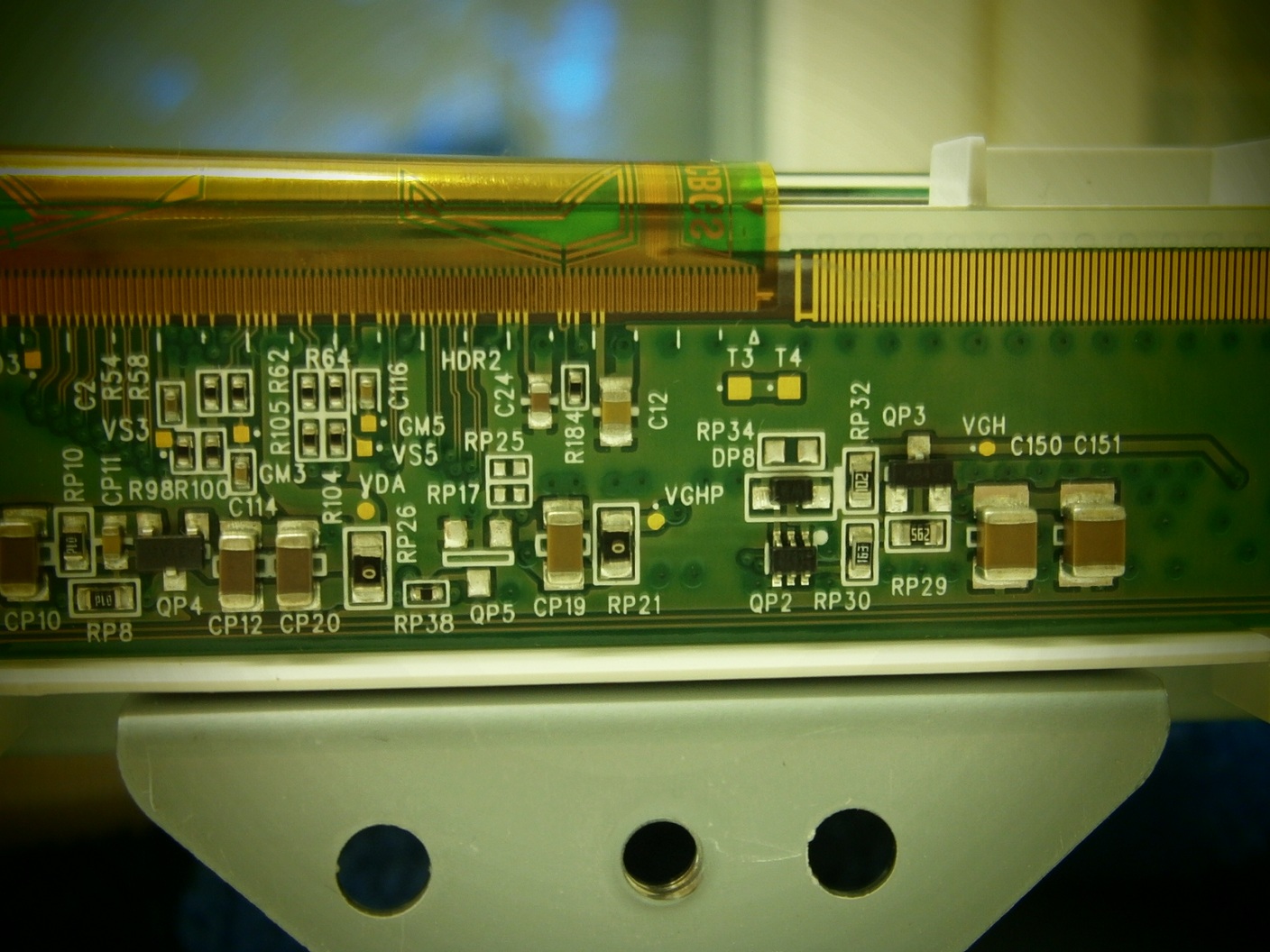

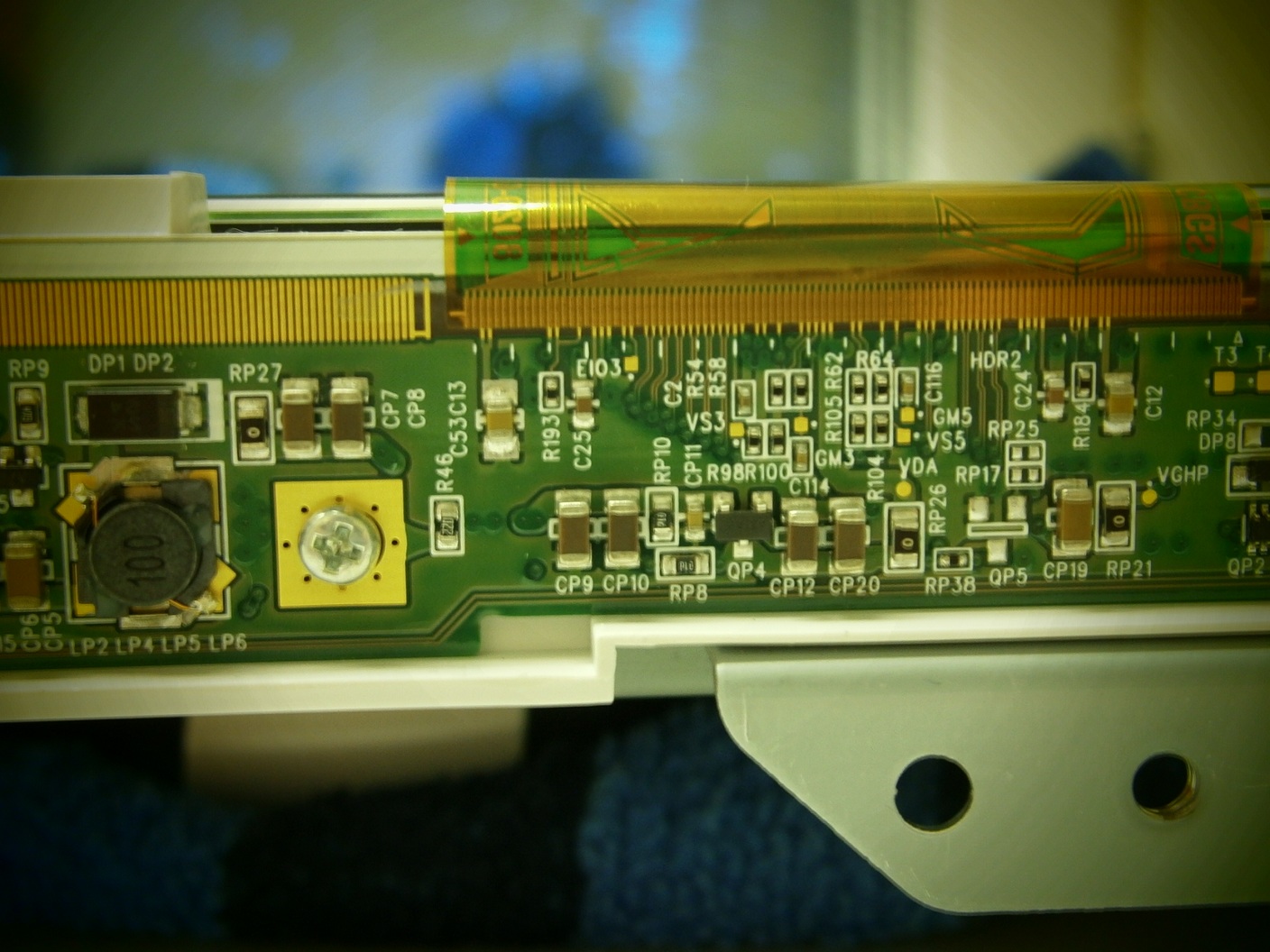

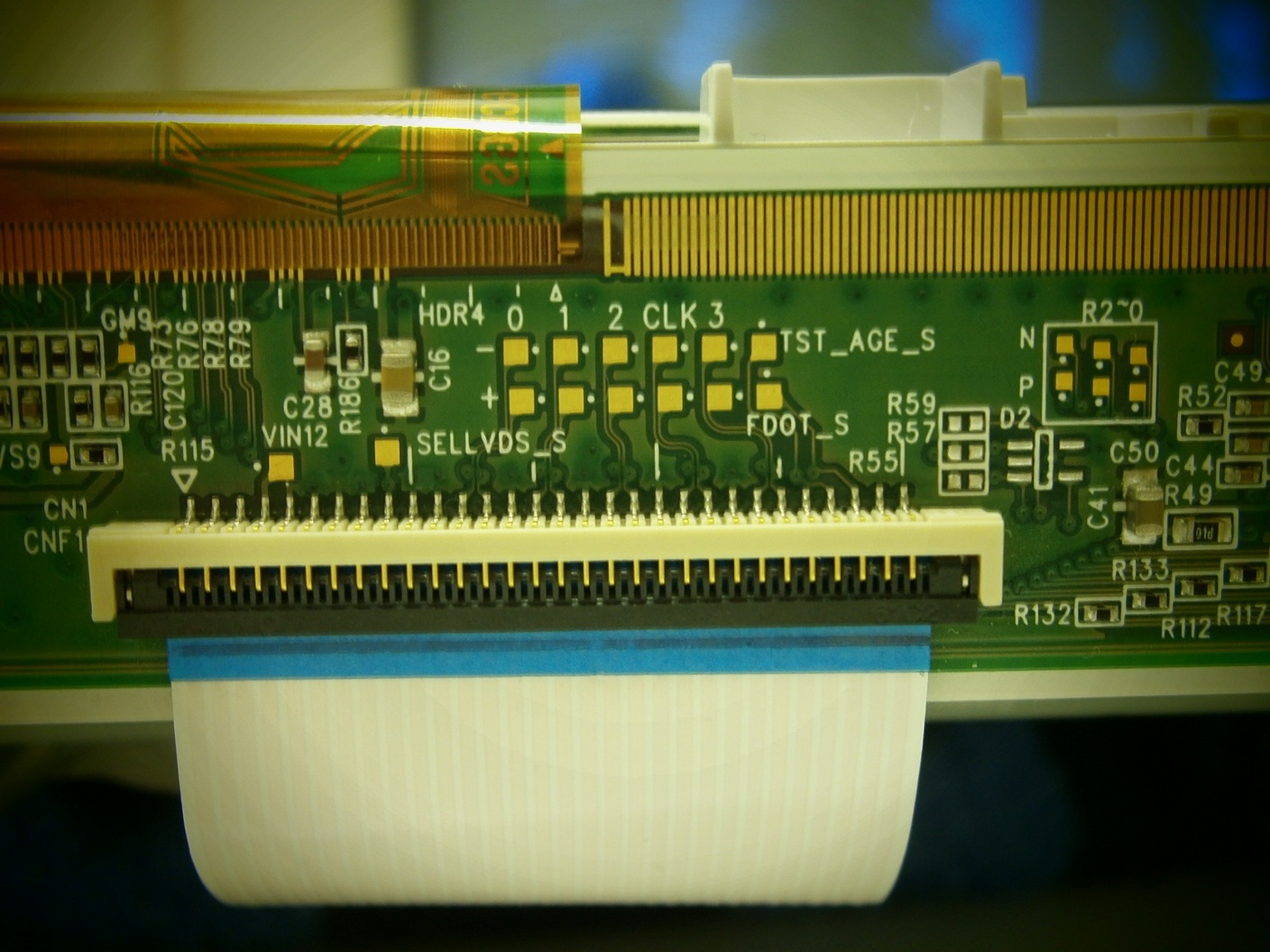

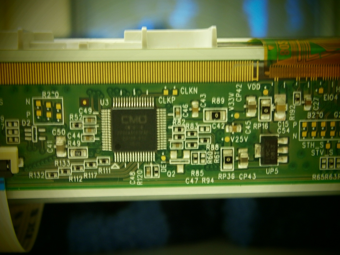

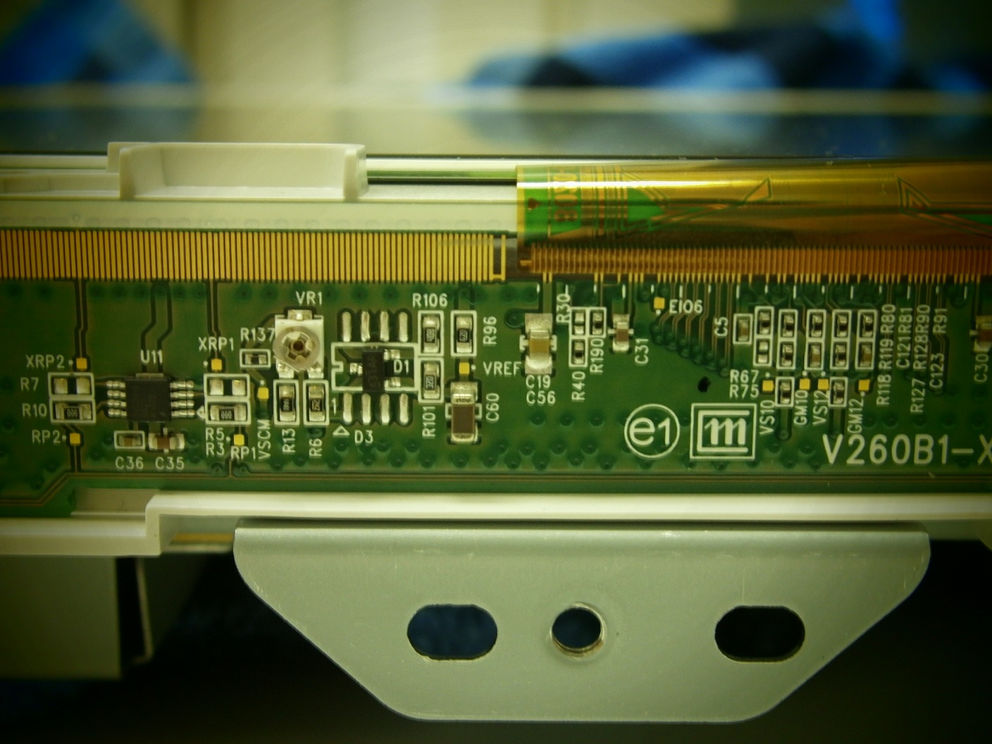

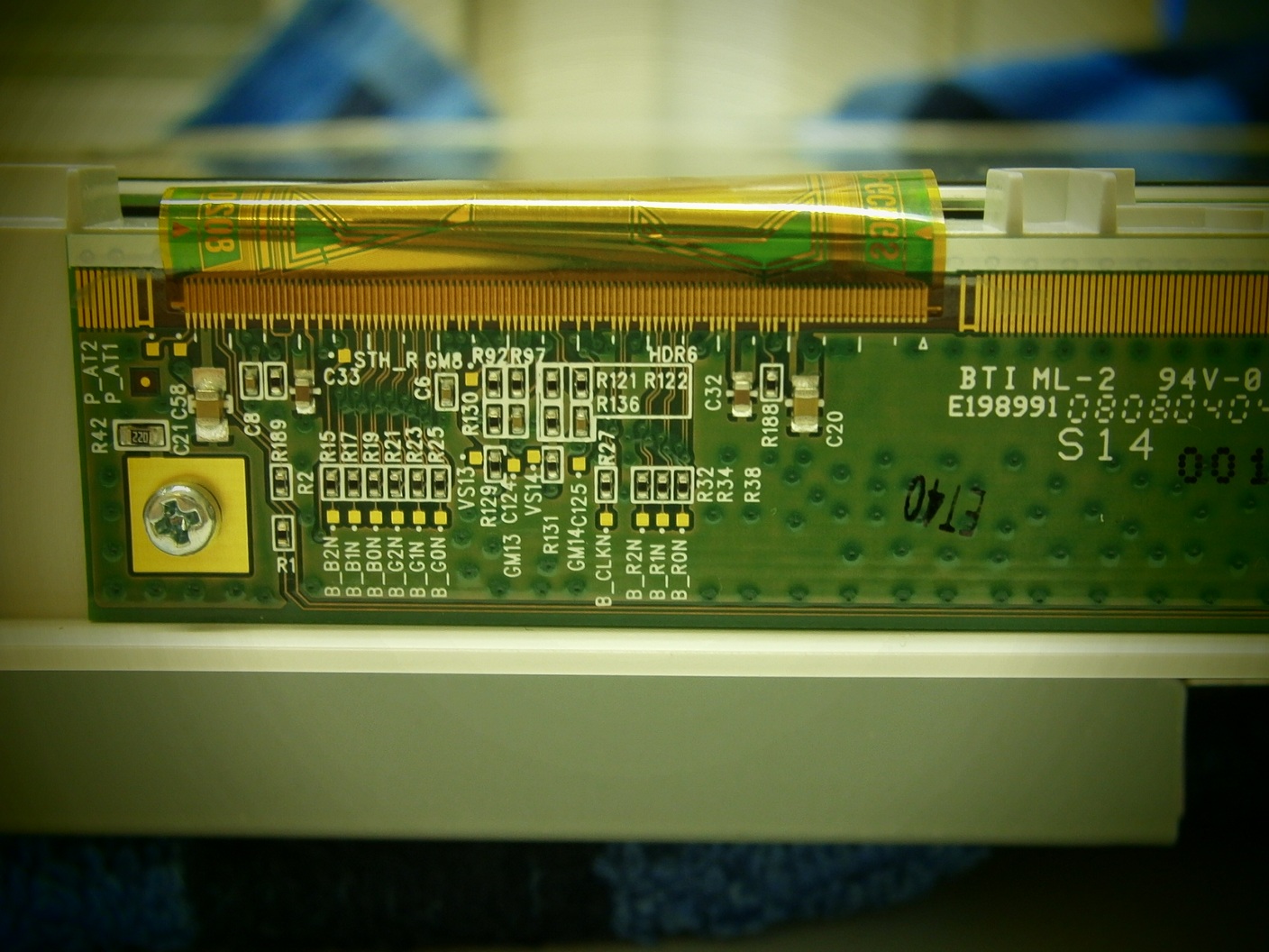

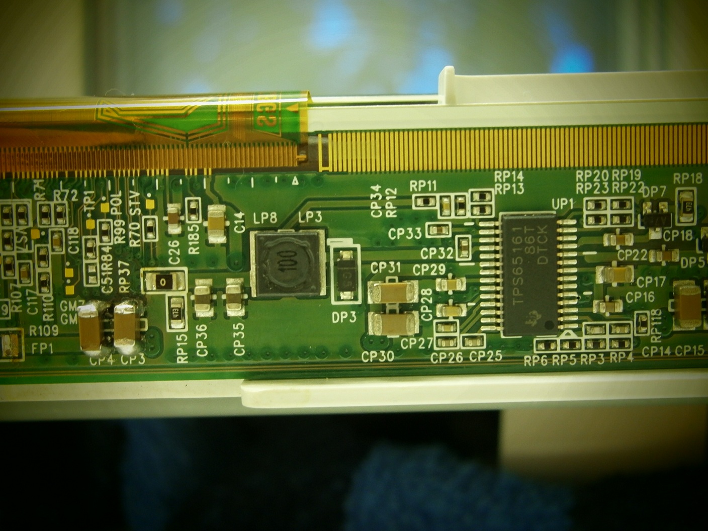

    The screen for this is CMO V260B1-L11, problem is bright white screen only, otherwise working ok. T-con is I believe integrated with the lcd driver board (?) that's bonded to the screen itself. Fuse FP1 bad, gives infinite readings, when cable connected to the T-Con/driver board I get no voltage readings, if I disconnect the cable I get the 12v etc... so I guess mainboard is ok. I think this indicates a short on the T-Con? Uses littelfuse 1206 1,5A which I don't have yet.
    Where to start the troubleshooting? There were some ceramic caps thet were next to each other and showed 0 ohm rating in-circuit, but when desoldered couple of those (CP3 and CP4) they measured fine. That's why those ones might look bit different from others.
    Some pictures attached...
      CP3 and CP4 seem to be on the main 5V rail that feeds the t-con. There are likely other ceramic caps with them in parallel. It takes one to be shorted to make it seem as if they are all shorted.
      My usual approach is to find all parallel caps that show 0 Ohms and remove them until the rail they were on no longer shows shorted (0 Ohms).
      Before removing anything, though, I would like you to check the following items first:
      1) resistance between test point VDD and ground, VDA and ground, VGHP and ground, VGH and ground, and V25V and ground (all with the monitor turned off and unplugged, of course)
      Note: if your multimeter is manual, make sure to use the lowest resistance scale (i.e. 200 Ohms).
      2) resistance across diode DP1 (or is it DP2?) as well as resistance across DP3.
      Post what results you get.
      As tom66 said, the fuse can indeed sometimes blow for no apparent reason, but given the low Ohms reading you got across CP3 and CP4, there's likely a shorted cap somewhere on one of the main power rails of the t-con.

        I agree with momaka method of removing them until the shorts is gone, these MLCC failed short, does not take much to crack these MLCC. I repaired a T-CON board that has 6 MLCC in parallel, and guess what happen, it's the sixth one that I removed was the shorted one!
        Be real careful if you are going the put the good one back in place, put it back one at a time and check to make sure there is no shorts before installing the next one.

            1) All those test points gave infinite readings? Did I do everything right here?
            2) DP1 (or DP2? strange marking) measured 140 ohm and infinite in opposite direction DP3 gave 470 ohm and 178 in opposite direction. Tested in-circuit. DP3 possibly bad? Other ceramic caps that show near zero reading are the CP30 and CP31 that are next to DP3. Also CP5 and CP6 give near zero ohm reading.
              DP1 and DP3 seem fine. You can also try measuring them with the diode function of your multimeter but you'll probably get similar results - if you do, then they are fine.
              All of those are probably in parallel, then. Looks like the 5V rail going to the t-con is shorted. A bit unusual, but anything is possible with ceramic caps.
              I would suggest to remove those shorted caps one by one and see if any are shorted. Also, after removing each cap, check the resistance of the spot the cap was in. If the spot still shows 0 Ohms, then the short is still there.
              Also, can you check the resistance of CP35 (or CP36 - either one is fine since they are in parallel) as well as CP7 (or CP8). CP7 and CP8 seem to be on the main boosted rail (more on that below).

                                  A little update on this one and some light at the end of tunnel: I went through the caps again as adviced and now found the shorted cap, it was CP29 next to the IC TPS65161. It can be seen in pic 6 in the first post that I made. After removing this there's no shorts! Now I would need to know with what kind of cap should I replace it?
                                    Re: LG 26LG3000 white screen problem
                                    Can you post of a picture of the surrounding components? We can make a guess.
                                      There are pictures in the first post? Don't have a camera right now here with me.

                                        Going by the typical application in the datasheet of the TPS65161, it should be 1uF.
