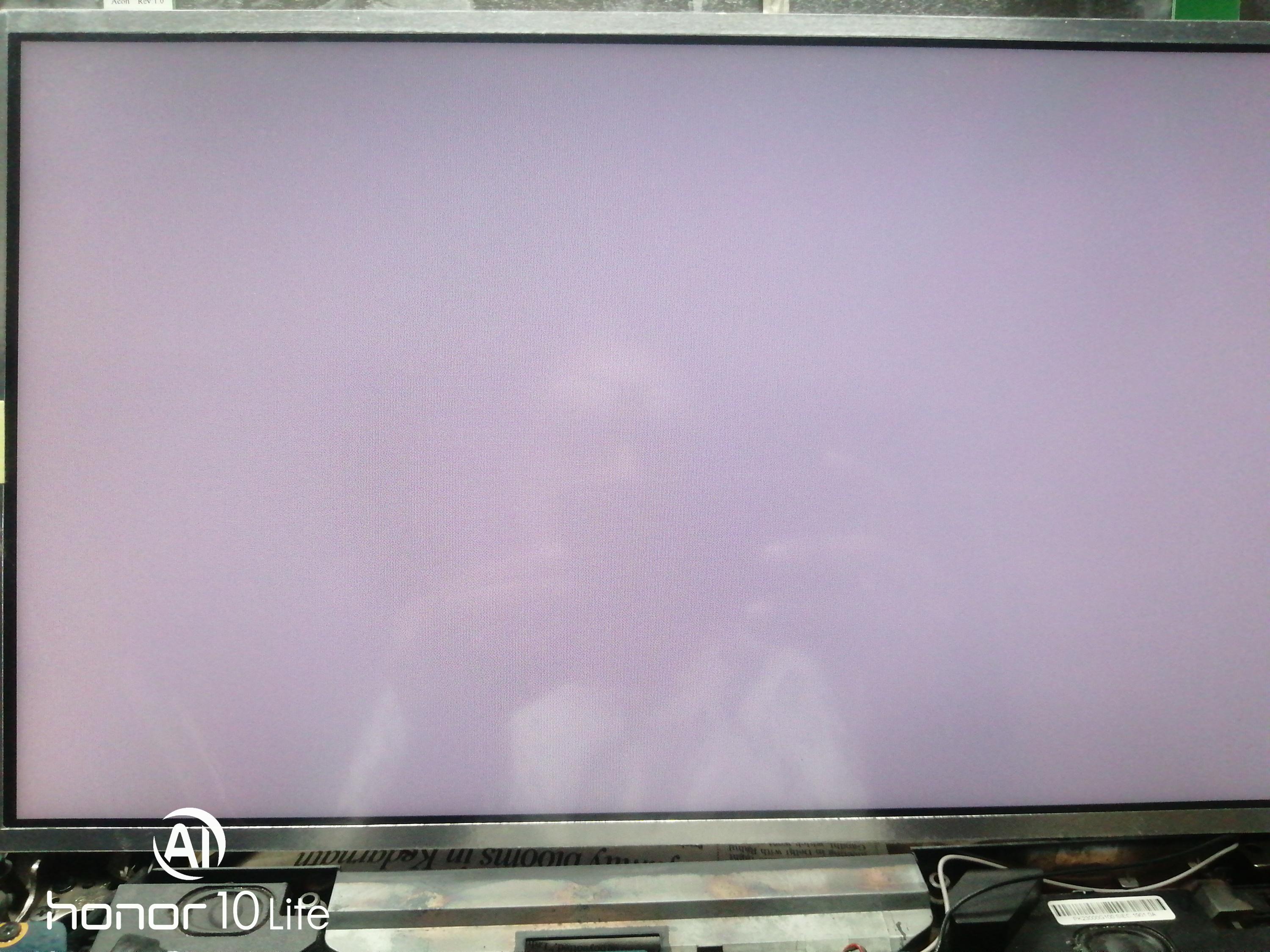

    My asus laptop motherboard la-7322p has white screen. Have tried new screen but same problem.lcd vdd is 1.8v when i removed the mosfet an short 3vs with lcdvdd white screen is solved but no data on screen

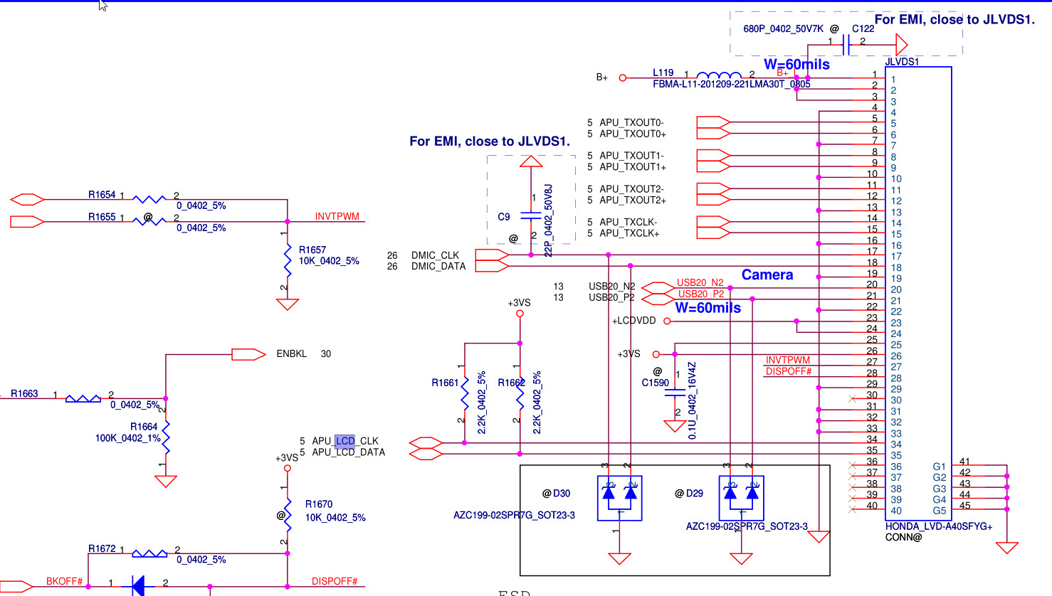

    Re: Asus la-7322p white screen problem
    What is the voltage on pin # 28 (DISPOFF#) of the LVDS connector ?
    Voltage on pins # 1-2-3 (B+) of the LVDS connector ?
    Boardview file is attached if required.
    Q: Does the external HDMI display work with this logic board ?
      Pin 1-2-3 has 18v and dispoff has 3v. Yes display comes from external vga port properly
