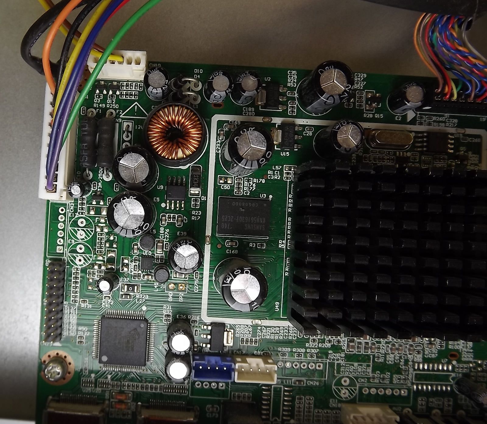

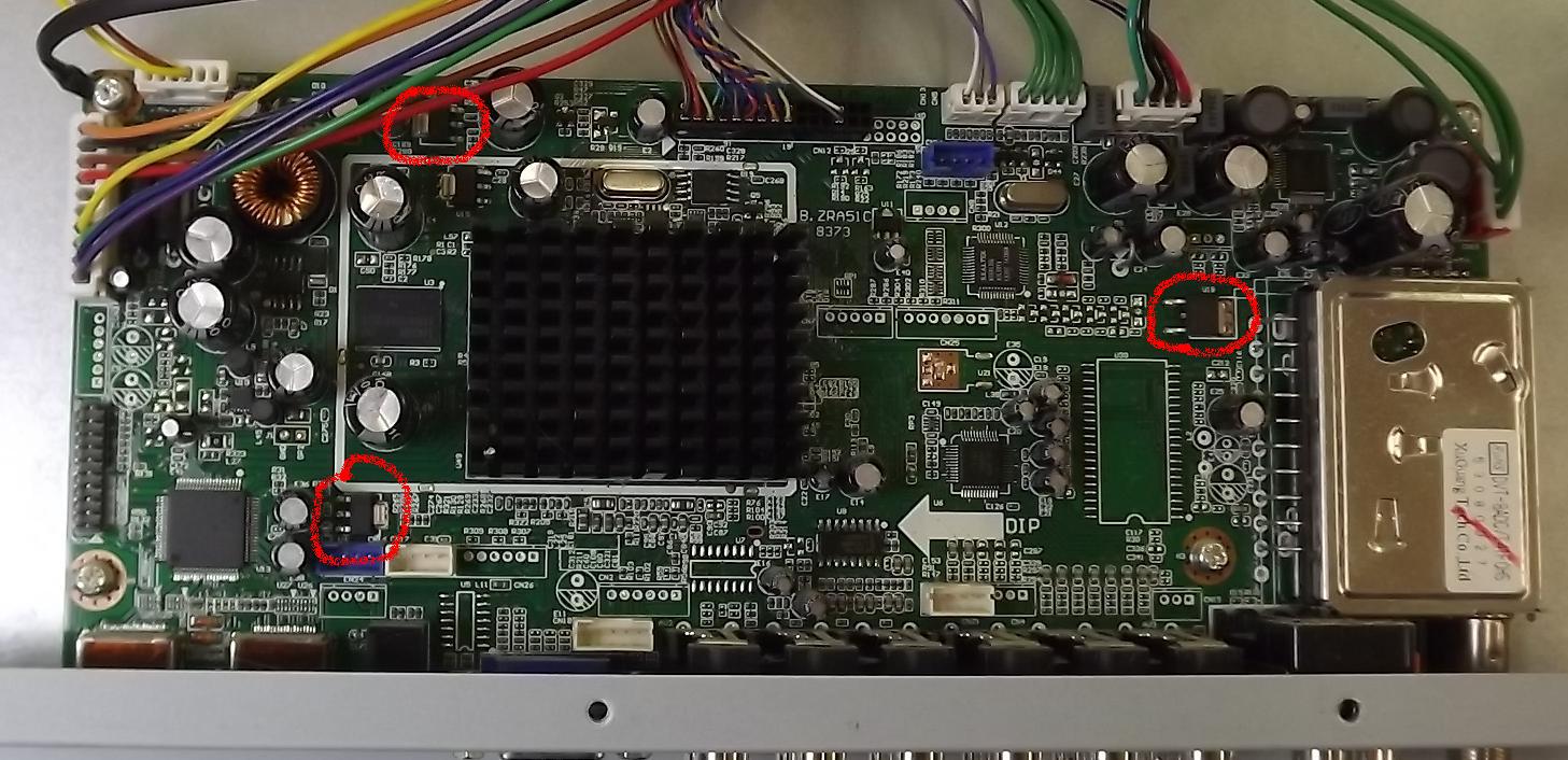

    You have at least 3 voltage regulators on your main board, possibly more, but the main board picture is obscured by wiring and the angle shot.
    See my sig file on how to test a voltage regulator.
    Note to selldoor. There are no regulators on the back although I do see a few diodes.

      Thanks !! I tested 5, U designation regulators on main board,here are the results..
      u18
      78d051
      ebvhab
      pin 1 = 0.39v
      pin 2 = 0.00v
      u11
      vc33c
      r133al
      pin 1 = 0.00v
      pin 2 = 5.11v
      pin 3 = 3.30v
      u15
      eh13a
      828n90
      pin 1 = 0.00v
      pin 2 = 0.00v
      pin 3 = 0.45v
      u2
      eh11a
      839k32
      pin 1 = 0.00v
      pin 2 = 0.00v
      pin 3 = 0.45v
      u4
      eh13a
      828n90
      pin 1 = 0.00v
      pin 2 = 0.00v
      pin 3 = 0.00v

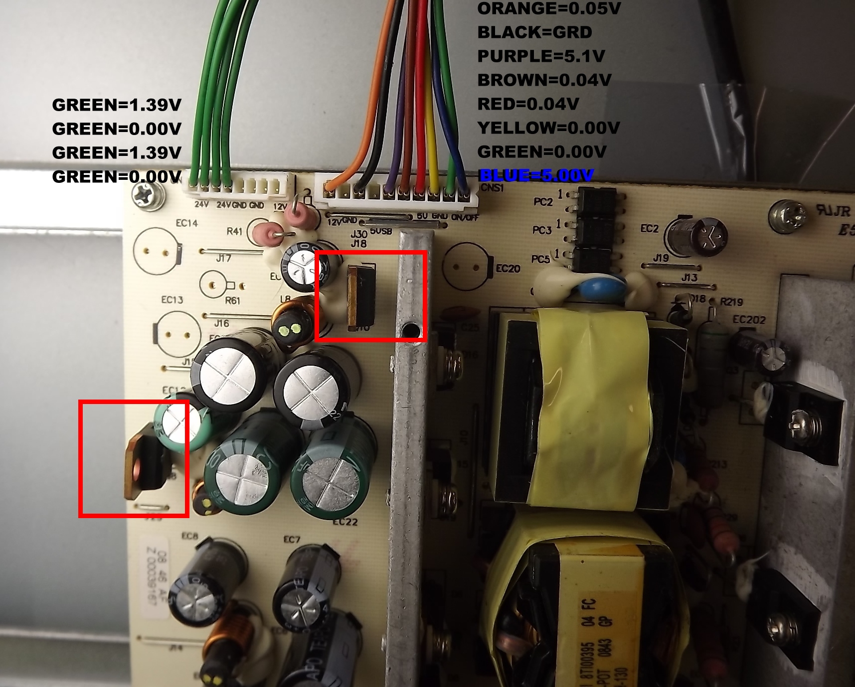

        Re: Curtis lcd3215a Standby power only
        Quote from retiredcaps''The main board uses the PS_ON pin to tell the rest of the power supply to start. If PS_ON is low, then the power supply will not start.'' end quote
        I might be misunderstanding you,but the blue wire that is PS_ON, only has voltge (5v) on it when power button is turned on.
        No voltage when power button is off.
        The purple wire has 5v on it at all times.(would that mean that is the standby power for the main board?)
        So if the main board is sending 5v through PS_ON to the power supply,wouldnt the 5v its getting be HIGH(on) and 0v be low (off)??
        Or is it suppossed to be higher than 5v to trigger power supply??
        Sorry if i'm misunderstanding you.

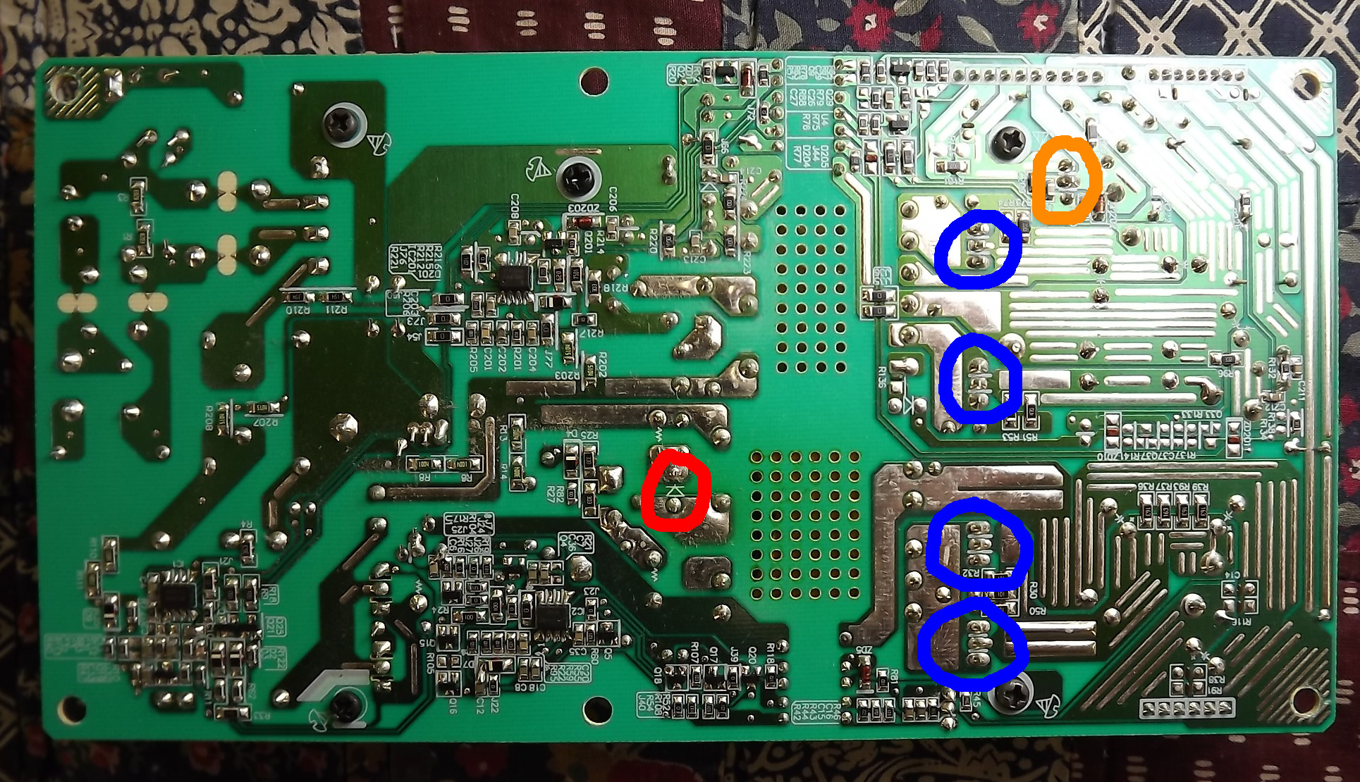

          I think the main board is fine. Since PSON is rising, the PSU is the fault.
          There are a few possibilities, the most likely is a shorted diode or startup cap.
          Let's try diodes first -
          All tests done with power supply unplugged and removed from TV.
          Red circled diode: Test from the indicated arrow direction (positive) to the bar (negative) - you should get around 300 to 800. Then reverse the leads, it should read "1".
          Blue circled diodes: Check each other pin to the center pin, in all directions. For example, if you numbered the pins from 1 to 3 starting from the top, you should test: 1->2, 2<-1, 3->2, 2<-3. And you should get readings of around 100 to 600 for each of the "->", but "1" for each "<-".
          Orange circled device - please check what the designator is. Is it "Dxxx" or "Qxxx"? (where xxx is a 3 digit number)

              Diode circled in red...DMM on diode test
              Positive to bar=540
              reverse=1/OL
              Devise in orange is designated as Q10(I believe is a mosfet,too close to heat sink to read part#)Test done with DMM set to diode test=
              Q10
              1-2=540
              2-1=1/OL IS Q10 reading failed open here?
              2-3=1/OL
              3-2=1/OL
              Devises in blue are from top to bottom of pic
              D10
              B304G
              switchmode rectifier
              D15
              sf1603g
              rectifier
              D6
              stp520150ct
              high voltage
              schottky
              rectifier
              These D designation devises are the ones im having trouble testing
              originaly i tested them on 200 ohm setting and find all of them to read shorted
              how would i test these rectifiers??
              With diode test or ohm test
              Diode test is erratic and will even cause the Dmm to beep continuity

                    Q10 may, or may not be open. Without giving a part ID i can't tell for sure.
                    As for the diodes, try unsoldering one and and testing them that way on the diode test.
                    Q10
                    P40NF03LA
                    n channel mosfet
                    test in circuit Dmm set to diode
                    1-2=OL
                    2-1=OL
                    2-3=OL
                    3-2=540

                      OK so this means pin 3 is source, pin 2 is drain and pin 1 is gate (by deduction). The FETs look good. I am trying to work out a way to test controller Vcc. It may involve soldering a wire to a pin and testing that instead (as the Vcc pin is on the bottom), if you are OK to do that?
                          Sure i can try anything you want me too,i appreciate the help!!
                          Now are we talking about the 4 rectifiers on the one heat sink,that are giving me trouble testing? Or are we good there and your onto something else?
                          Explain to me what the contoller Vcc is please
                          Not exactly sure what that is

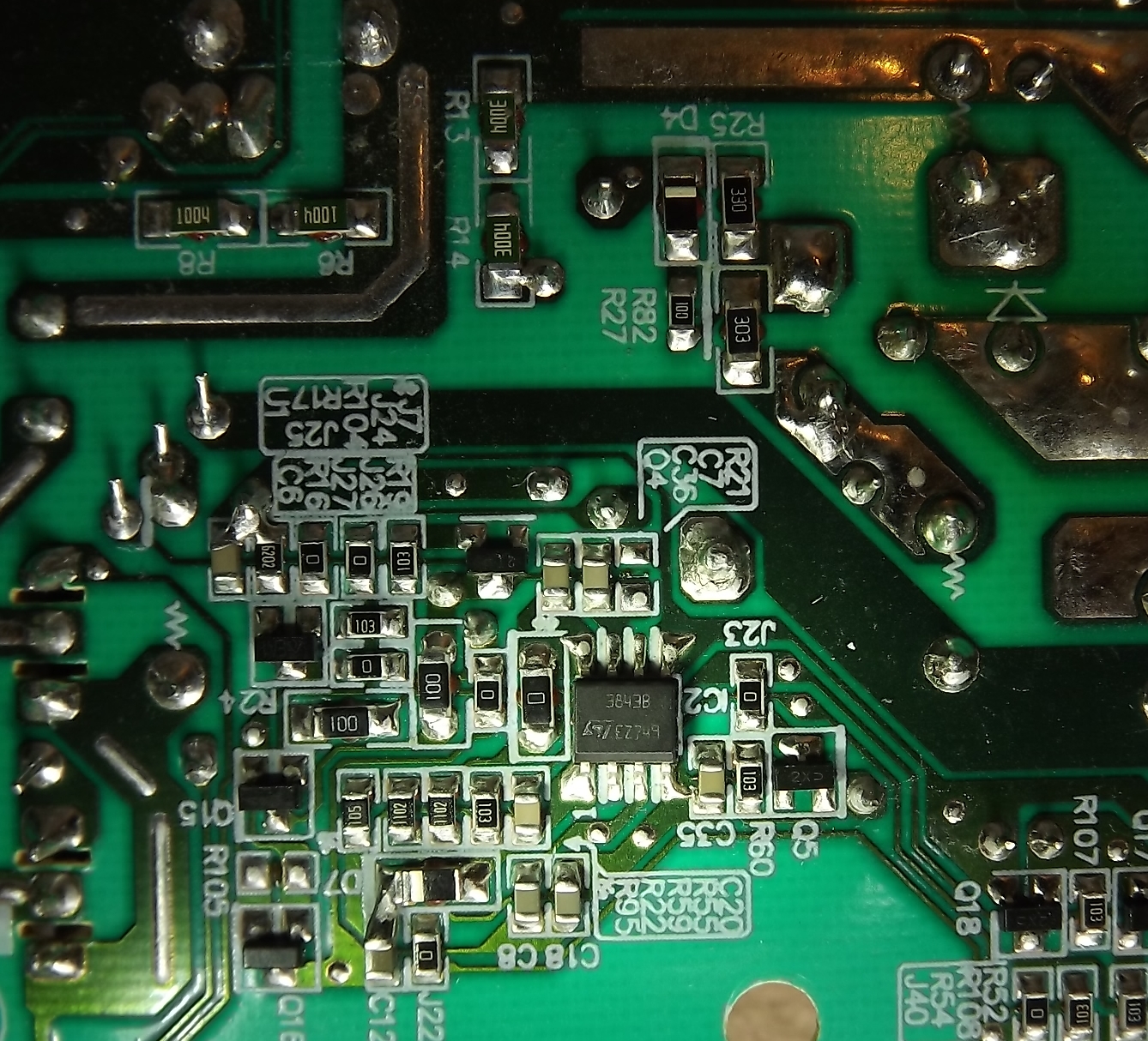

                            I'm talking about the little black chips on the bottom of the board. Each of these has a voltage supply called Vcc. A failed Vcc supply could explain the problem and it's a fairly common problem with power supplies. It looks like the only way to probe is from the bottom.
                            Since the standby is good (you have a standby LED and PSON goes high to 5V), the problem is almost certainly with the main power supply, which generates the 24V, and likely other rails like 12V, too.
                            Can you get the part # of the device I've circled in the image?

                              ic2
                              3843b
                              stez749

                                  OK pin 7 is Vcc.
                                  Next to pin 1 there should be a small dot (sunk in the epoxy package)... could you mark this dot on an image as I'm having difficulty making it out on the image.

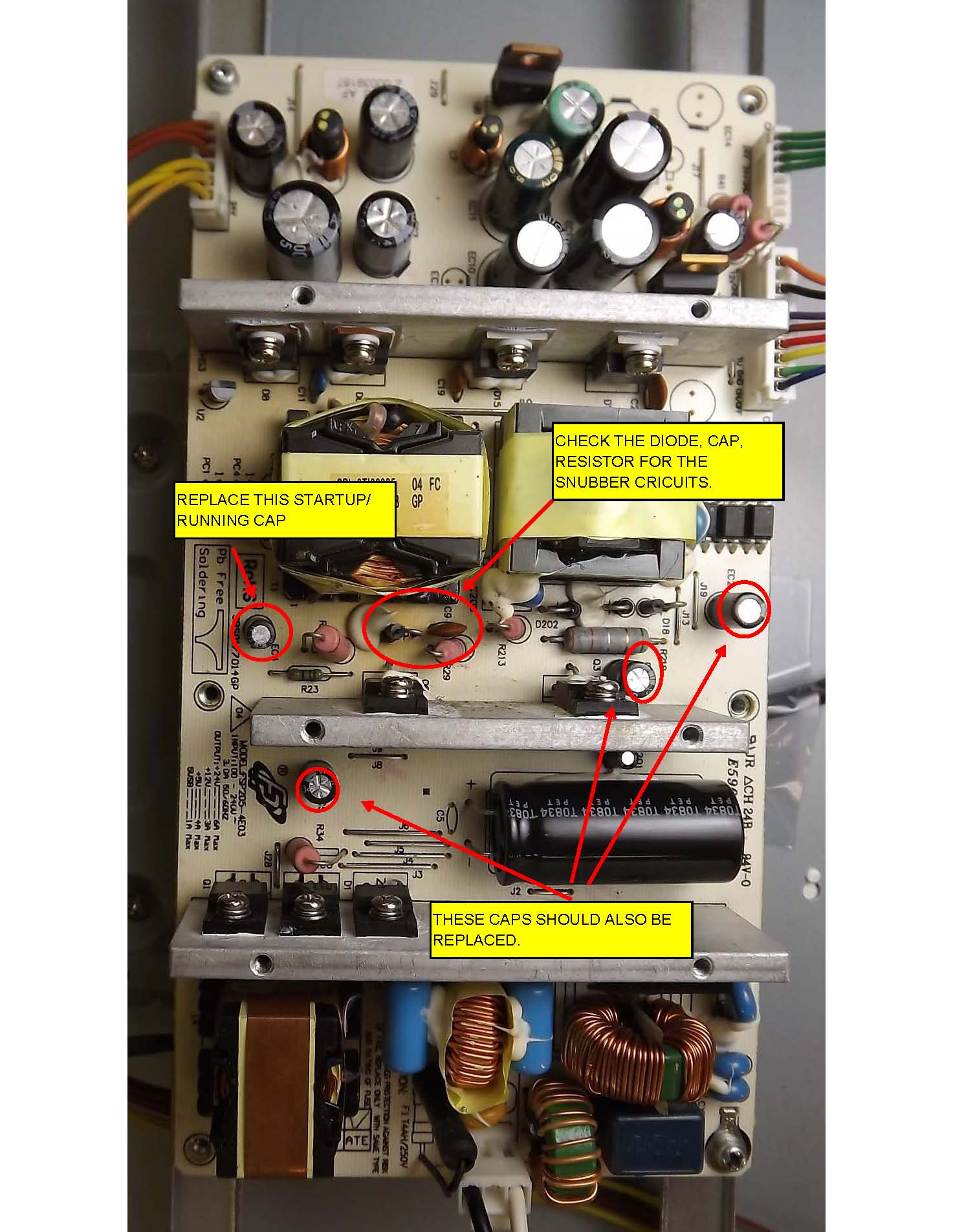

                                    Not sure if you have already changed/checked these components or not.

                                        Sorry Tom,there is no indent circle on KA3843B,Even tried 20x magnification.
                                        I hope it wasnt painted on and it rubbed off when i quickly cleaned the devise with a q-tip and rubbing alcohol! The other IC's on the board have the indent,Have you ever seen them painted on??
                                          #40
                                          "1" is printed right on the board, at the bottom left pin where the IC is. Number 8 is printed right on the board by the top left pin of the IC.
