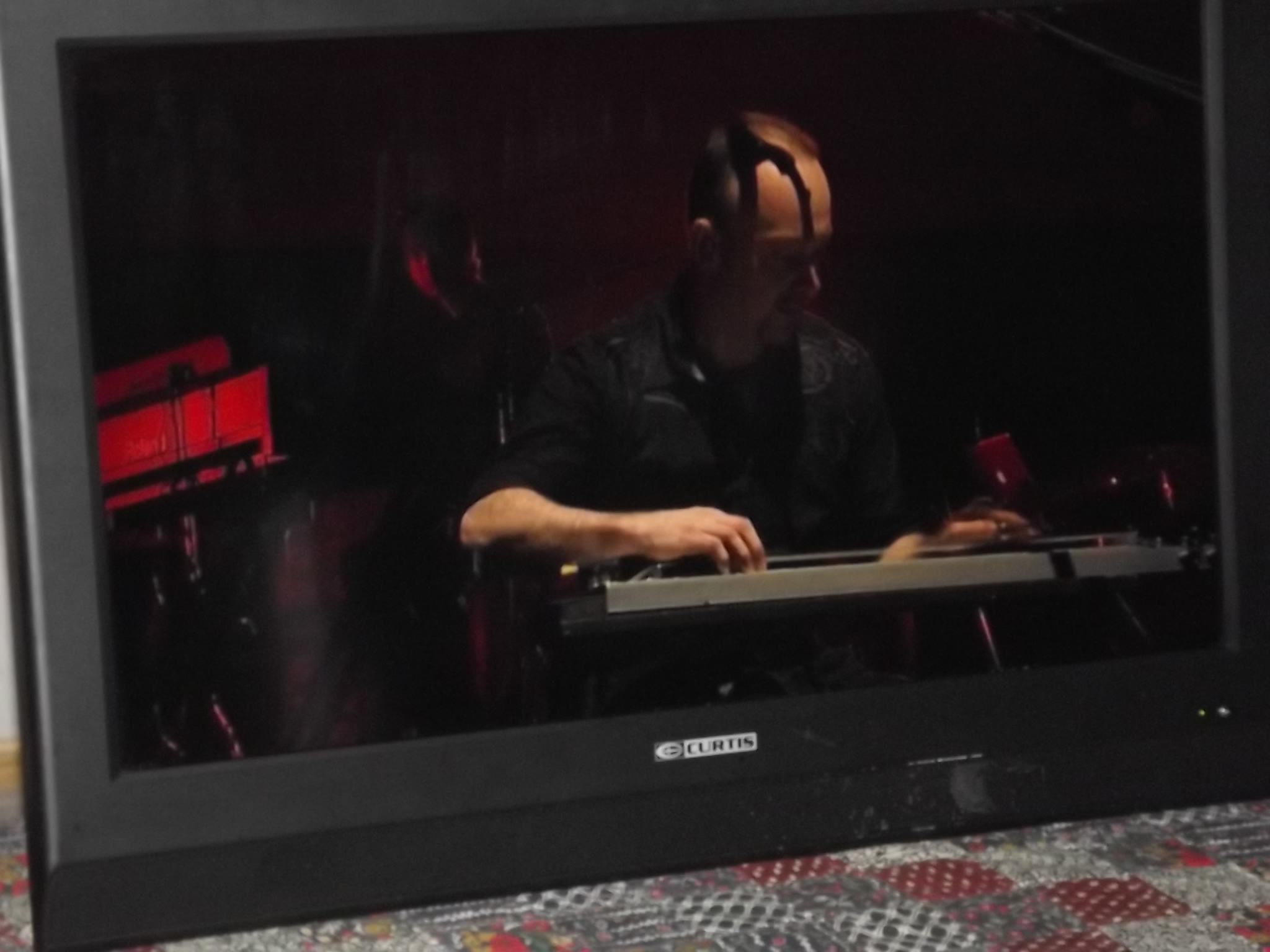

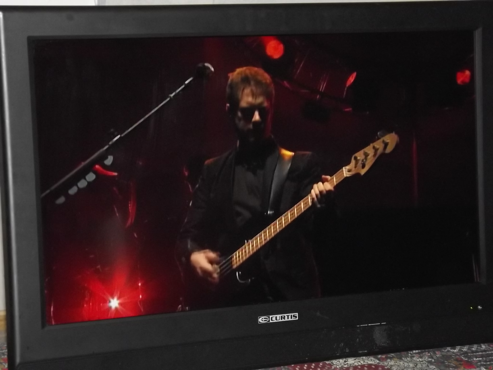

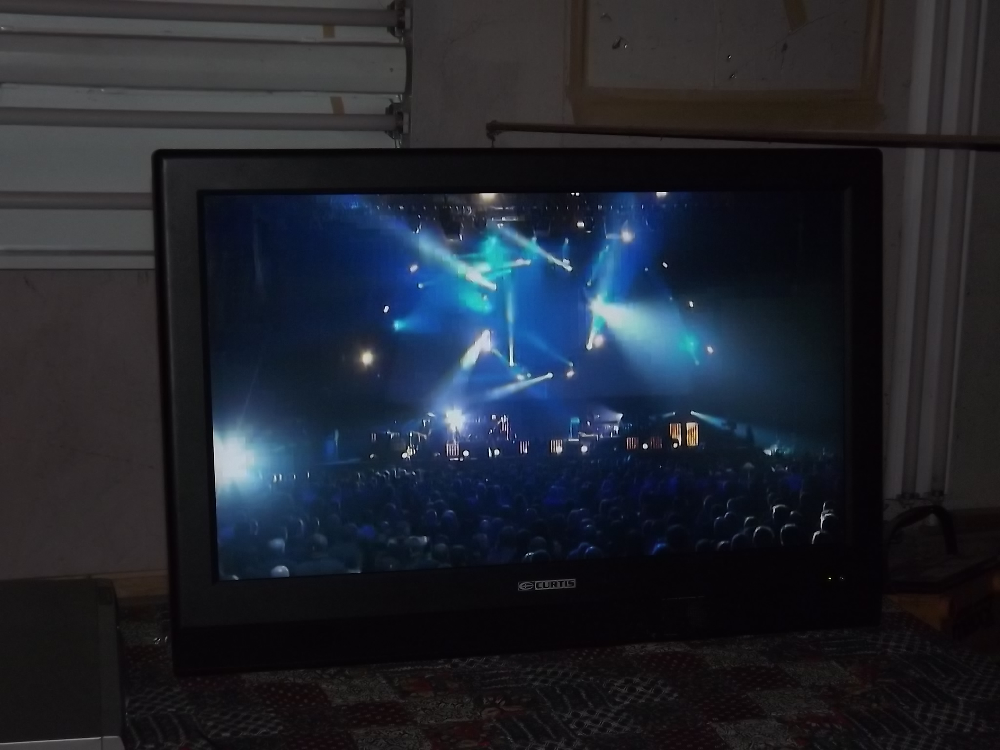

    Glad to hear you got it working! As everyone here suggests, replace ALL the caps except possibly the 450V one (though those have failed too in the past, especially CapXon ones, and they're only a couple of dollars each.) It will save you much hassle in future. Remember to use good low-ESR caps, such as Panasonic, but also Nichicon, Rubycon and Chemicon are good as long as they are low-ESR types (just ask if you aren't sure.)

      Sounds good i really appreciate all your help!!
