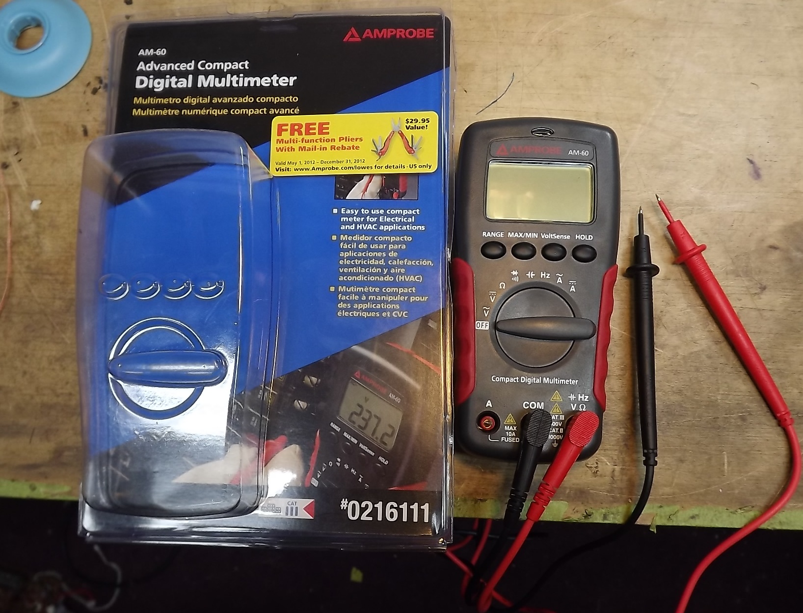

                              I just bought a new DMM today thats cat3,65 dollar amprobe,Not sure if its a very great meter but its got to be better than the 8 dollar cheapy that i was using!!
                              For one retiredcaps' bonus point, post a picture of the new Amprobe. I have 2 Meterman multimeters. Meterman was eventually bought by Amprobe and Amprobe just name rebadged a lot of their models.

                                  #56
                                  Re: Curtis lcd3215a Standby power only
                                  Here she is,
                                  They sell them at lowes,my local home improvement center.
                                  Is it a decent meter?

                                        #59
                                        One retiredcaps' bonus point for you.
                                        I totally forgot I had an Amprobe AM-60. I got mine off ebay. When I had it, I liked most things about. I eventually sold it because I got a Fluke multimeter that did the same thing.
                                        The AM60 should serve your purposes.
