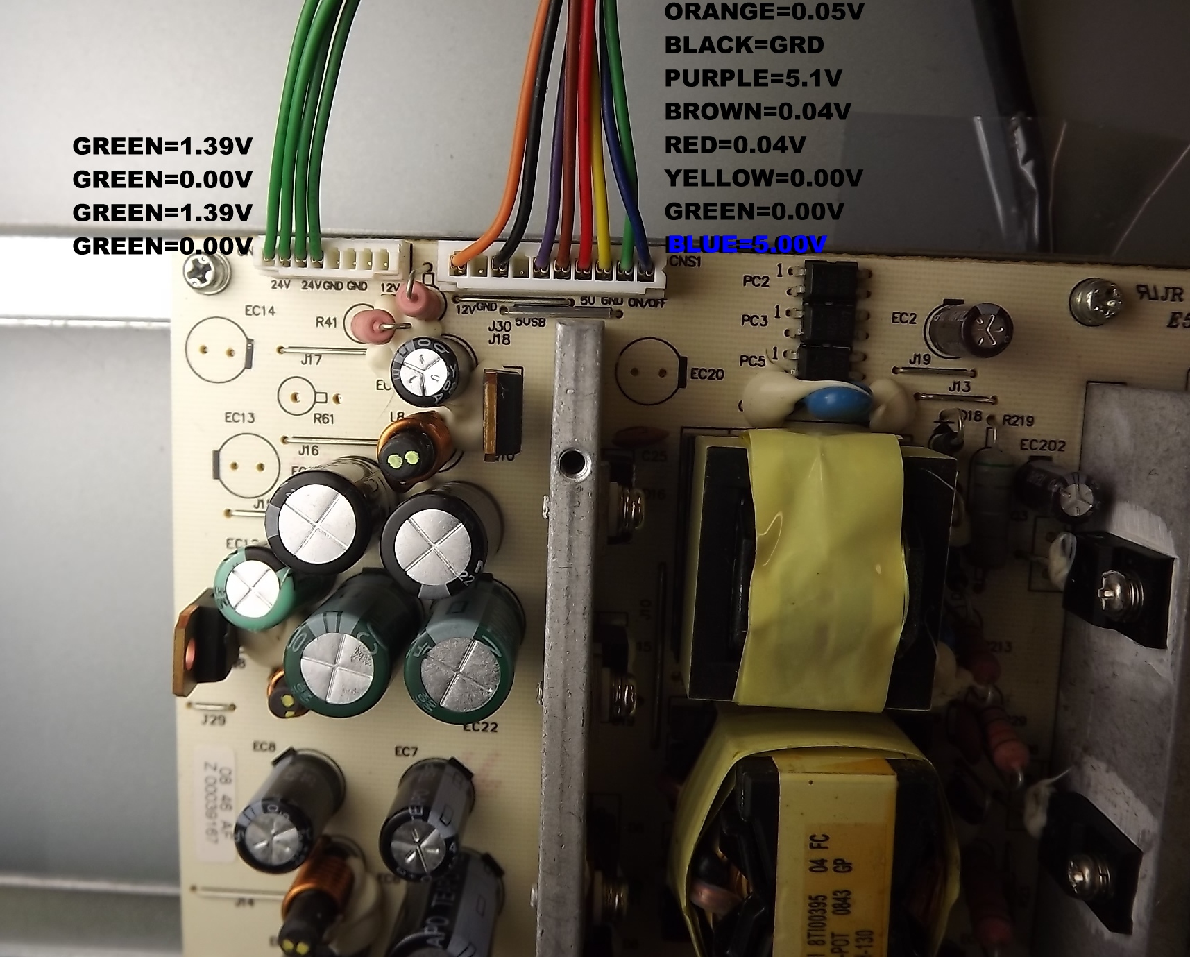

    Symptoms=
    Red led when plugged into wall
    Steady green flashing led when power button is pushed
    Steady green flashing led stays after pushing power button to turn off

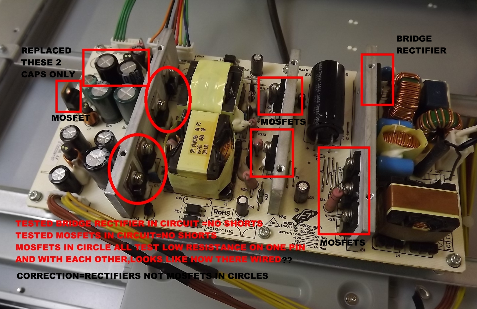

    Visual inspection=

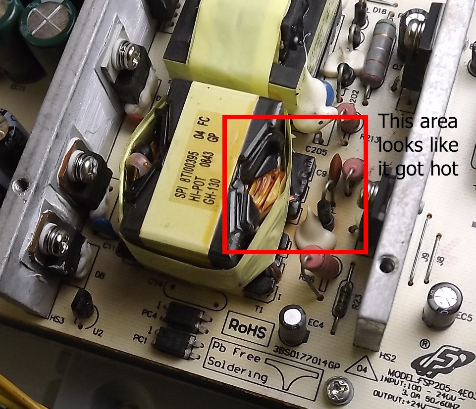

    found 2 slightly puffed caps on power supply & heat signs around transformer.
    Replaced the 2 caps,symptoms did not change.
    I tested for shorts on all large mosfets and bridge rectifier(none found)
    Tested for shorts on 4 large diodes (none found)
    Tested the 4 rectifiers and all 4 test for a short,But looking at how there in circuit, that could be the way they would test in circuit, but im not sure on that.
    I also hunted for a fuse but cannot find one.
    I tested for voltages on pins going to main board and to inverter
    found 5v on two pins going to main board
    (actual voltages on my pics)
    Do you guys think the two pins going to the main board that i found 5v on are standby for the main board and a signal voltage coming back from the main board to tell power supply to turn on??
    Should i replace the rest of the caps on the power supply??
    Should i pull the 4 rectifiers out of circuit to test??(I can post pic of how there in circuit if needed)

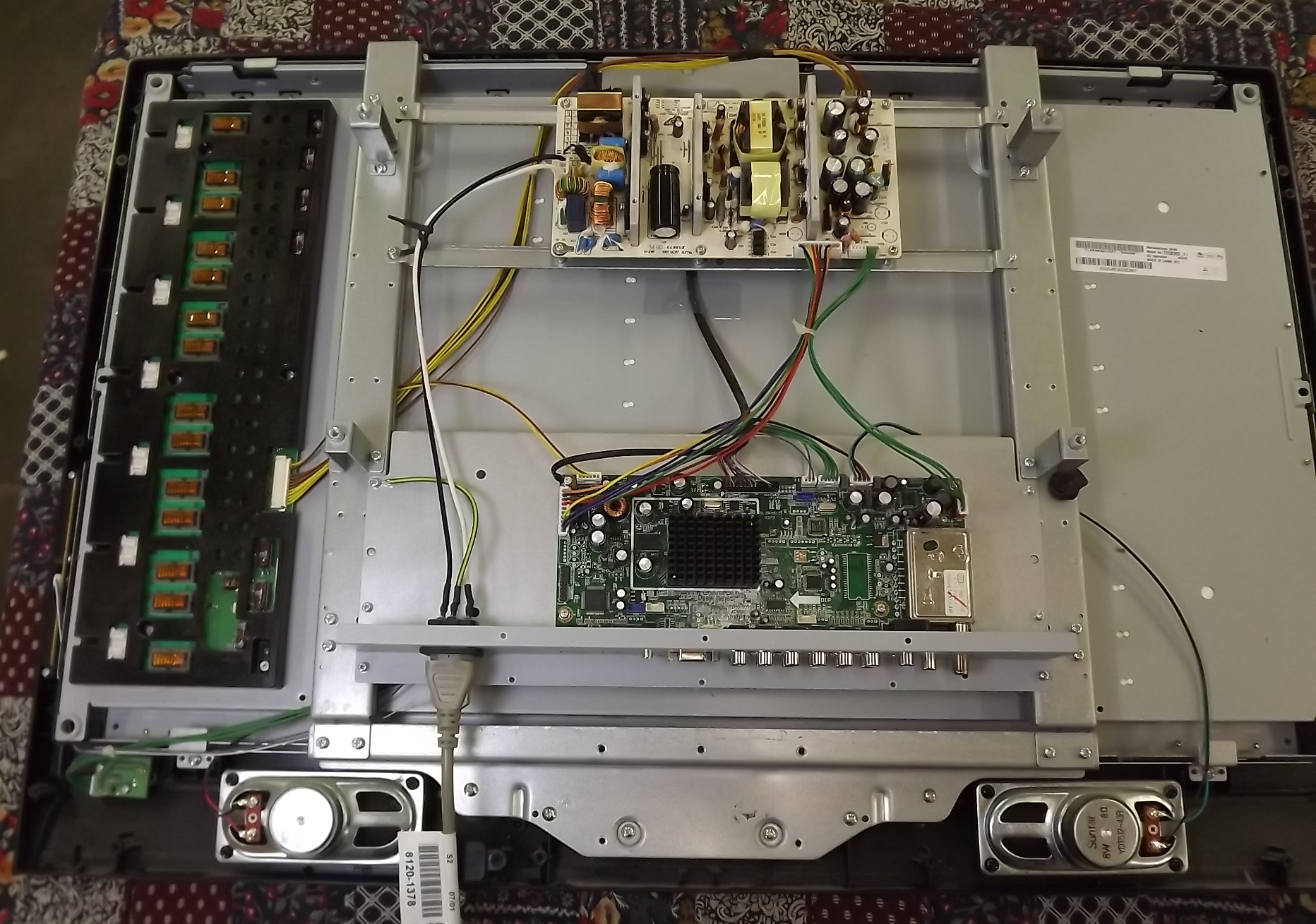

    Re: Curtis lcd3215a Standby power only

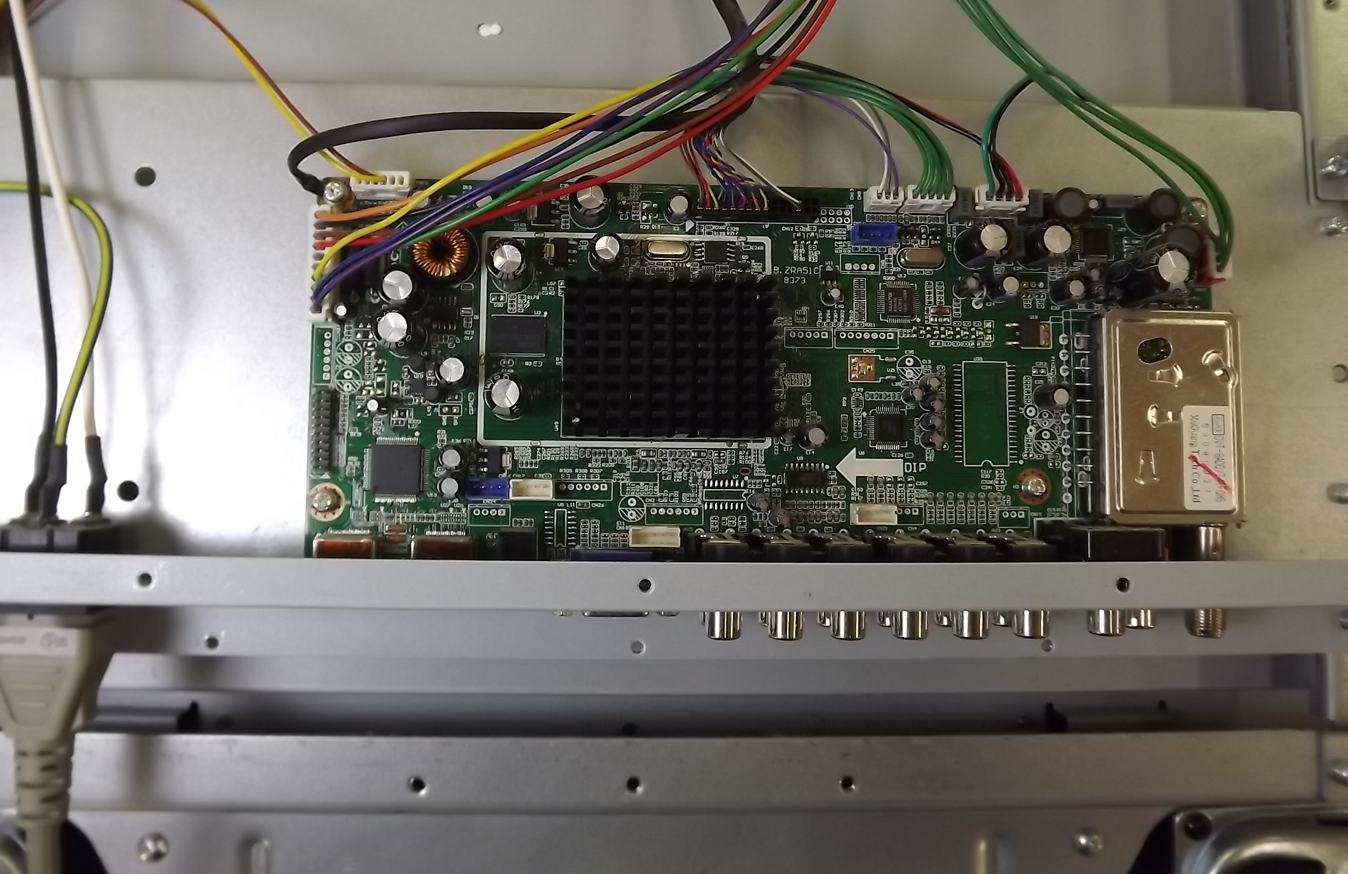

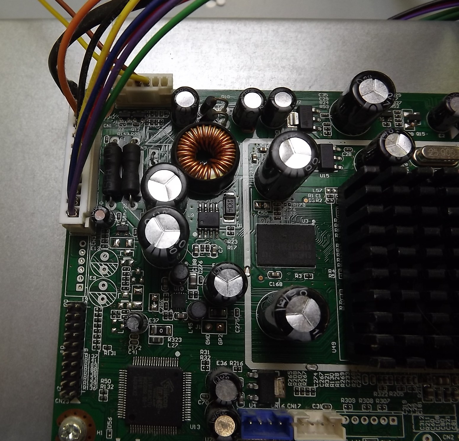

    There looks to be 2 black fuses on the main board top left under the wires
    • allsmith
      • Aug 2012
      • 179
      Good eye!!! Thanks! I never thought to look for fuses on main board.
      Both test at 0.08 ohms,meter set on 200 ohm scale

        Pity - they look ok Is there anything to see on the back of the singed area. Did you check that diode - use diode setting on meter and post results.

          Does ON/OFF (blue wire) change when you press the power button?
              Blue wire goes to 0.10v when tv is plugged in. DMM set on 20v
              When power button is pushed voltage on blue wire goes to 5.0v
              Stays at 5.0 even after hitting power button to turn off

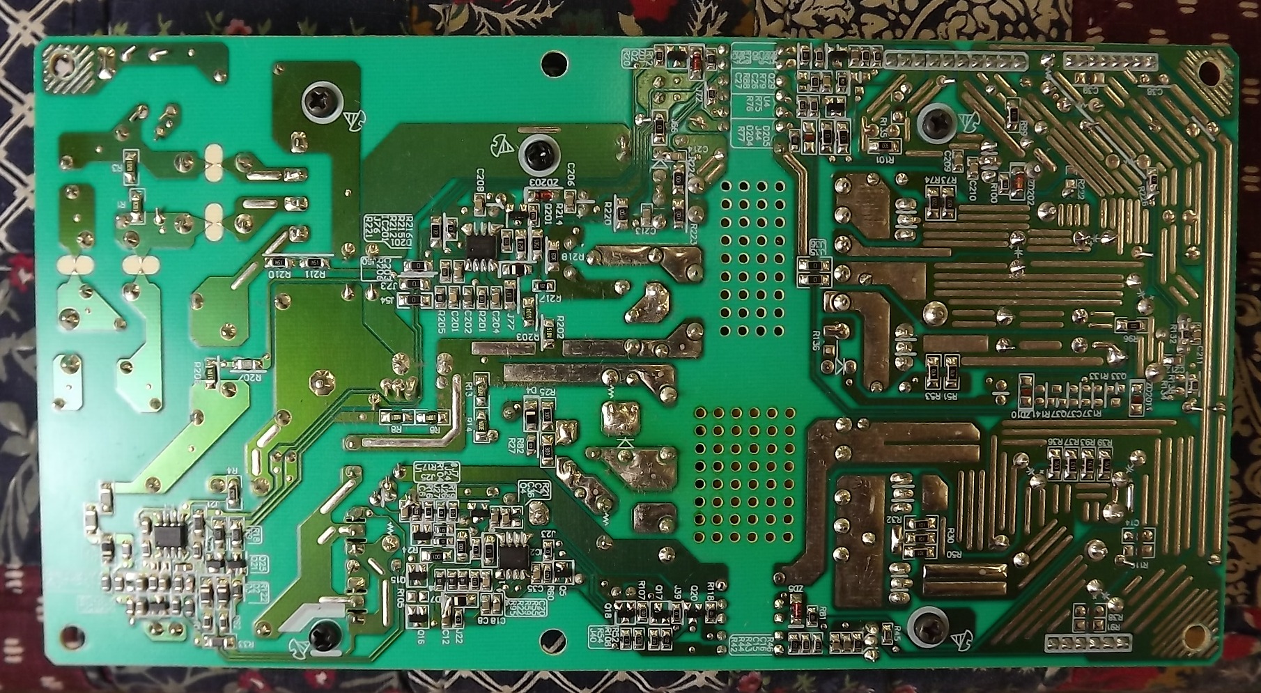

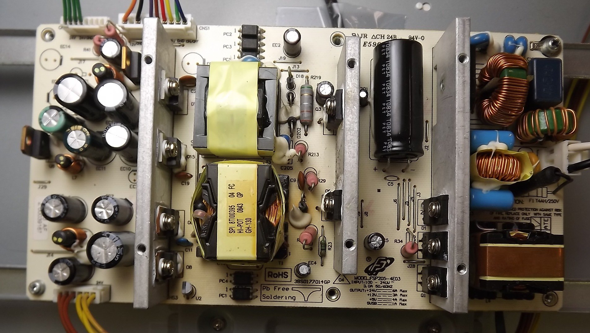

                Here are pics of the back of the power supply board

                  OK, so main board is probably okay, but voltages aren't coming up.
                  Can you try without the inverters and other 24V cables disconnected?
                    Another test - voltage across 450V cap should increase when you press the power button - should be around 400V when running, 165V when "off".
                      I left the inverter wires and green wires unpluged from power supply
                      Same test results as before
                      0.10v when pluged into wall
                      5.0v after hitting power button
                      Green led stayed solid on this time

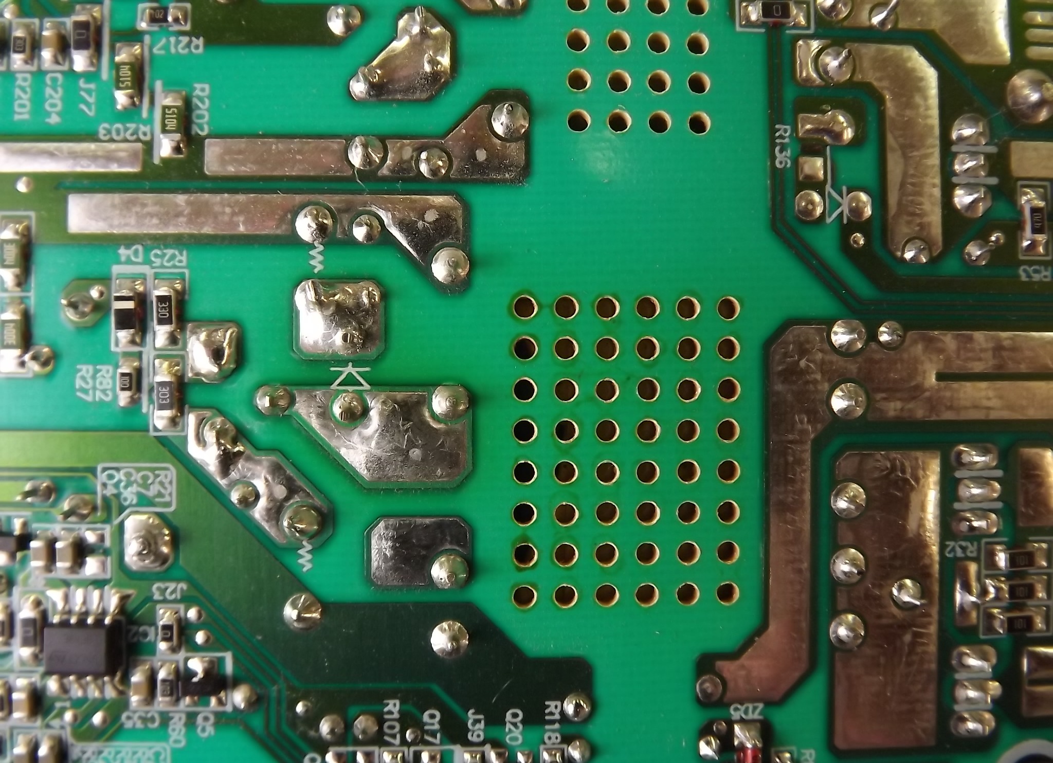

                          Perhaps check the soldering on the transformer the pin just to the left of the third row down of 6 wide ventilation holes looks a bit off and this is in the hot (singed)area.
                          • allsmith
                            • Aug 2012
                            • 179
                            It seems to look ok to me.
                            Here is a close up pic
                            Thanks!!

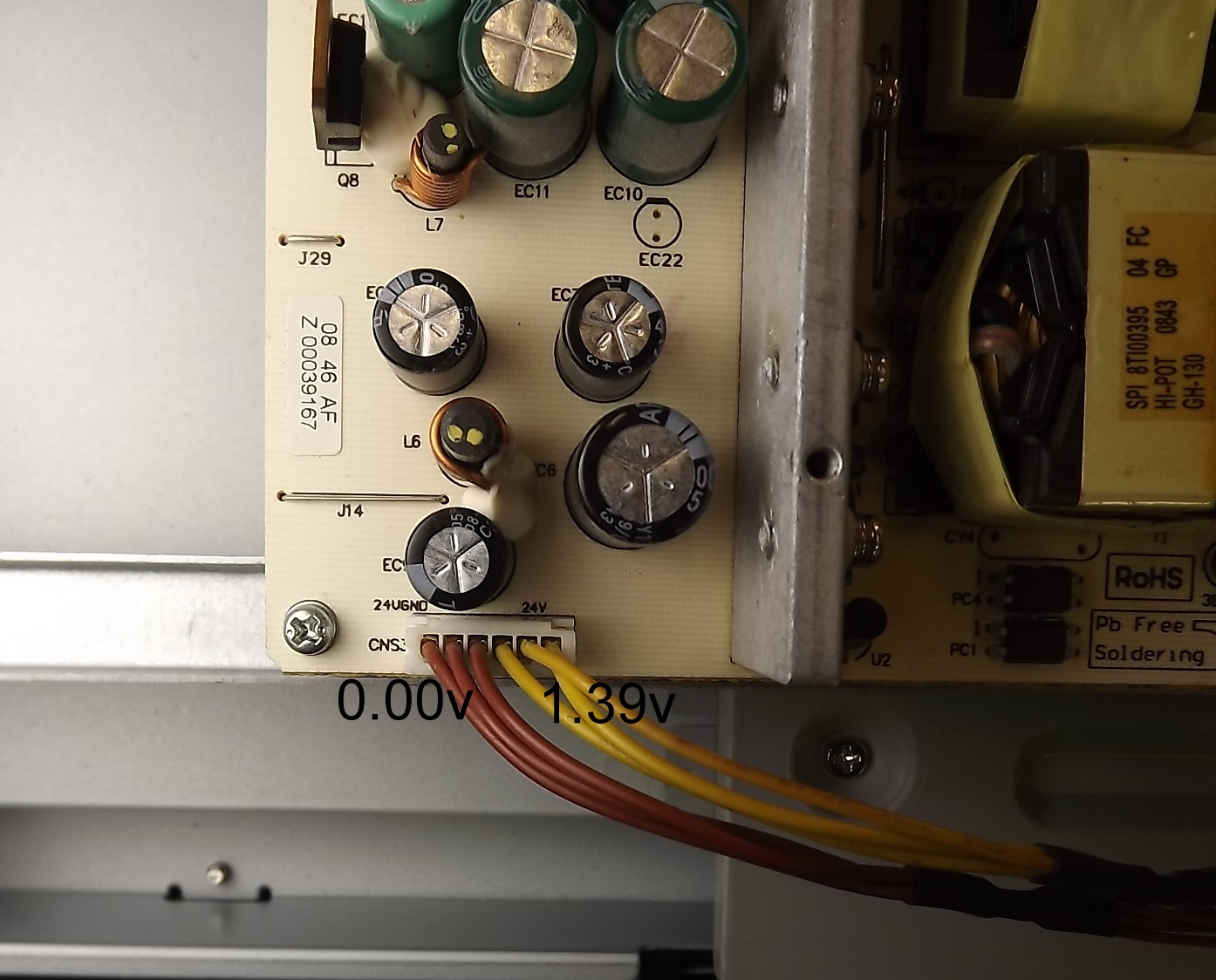

                              Please can you check if the 24V comes up without the inverter connected.
                              • allsmith
                                • Aug 2012
                                • 179
                                tested 1.5v at the pins where i disconnected the inverter wires
                                sorry gotta go to work,be back on here in about 8 hrs
                                Thanks i really appreciate it!!

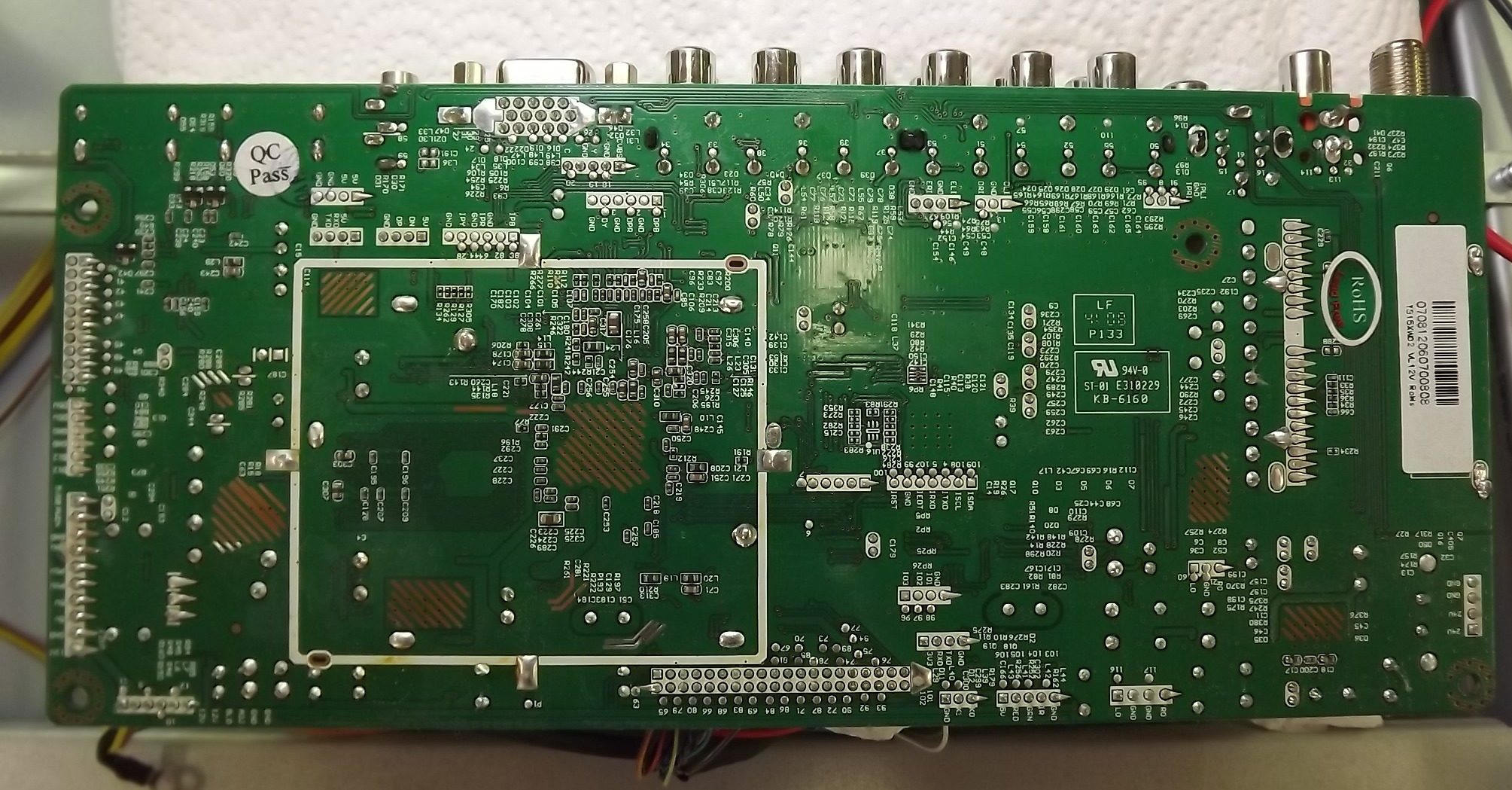

                                  can you check what voltage you get at each end of the 2 main board fuses
                                  can you post pics of the back of the main board
                                  • allsmith
                                    • Aug 2012
                                    • 179
                                    0.00v on all ends when first plugged into wall.
                                    0.40v on all ends when power button hit, but steadily drops to 0.05v on all pins within about 30 seconds.
                                    Meter set to 20v scale

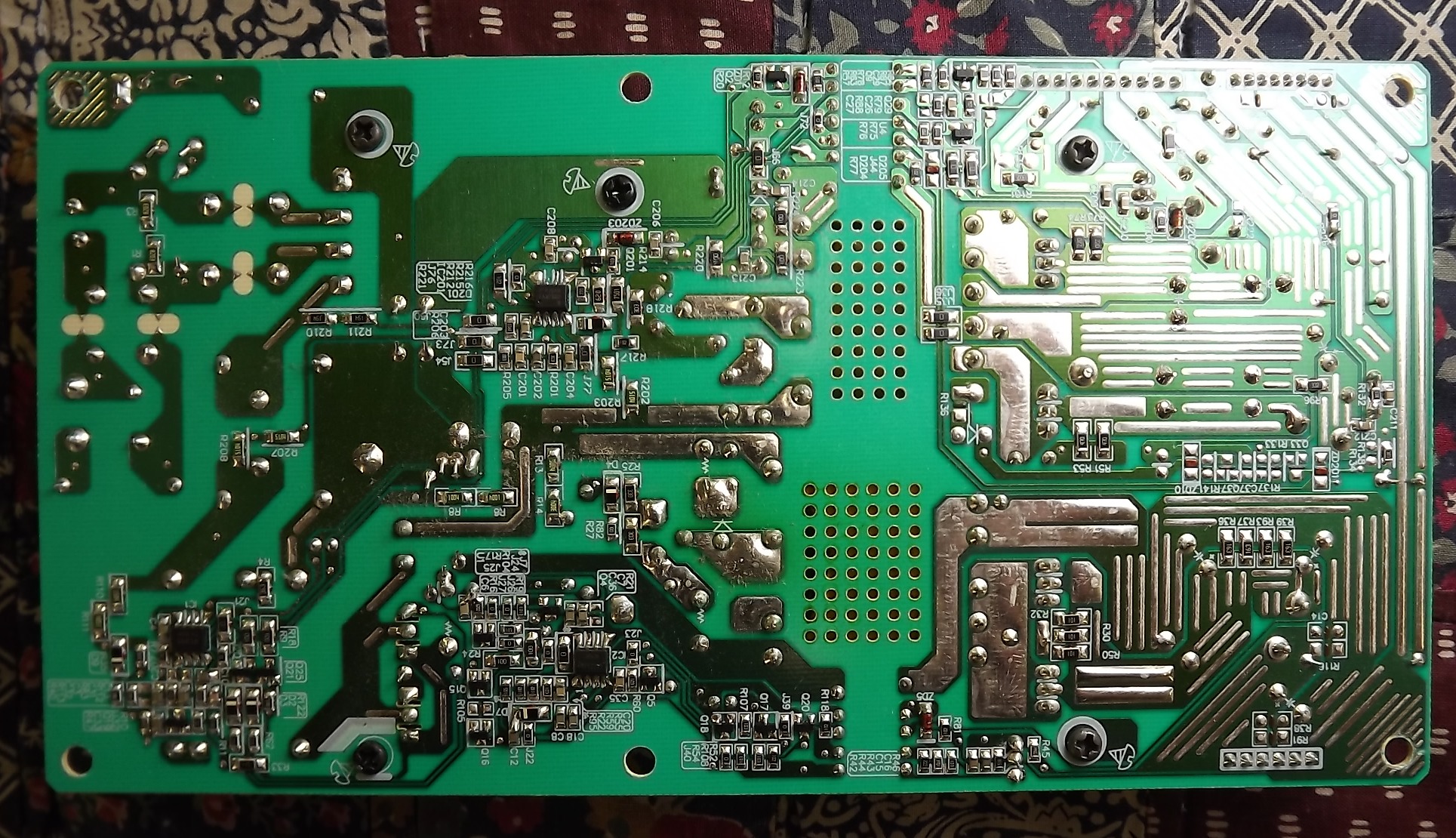

                                    • allsmith
                                      • Aug 2012
                                      • 179
                                      Here is a pic of the back of main board
