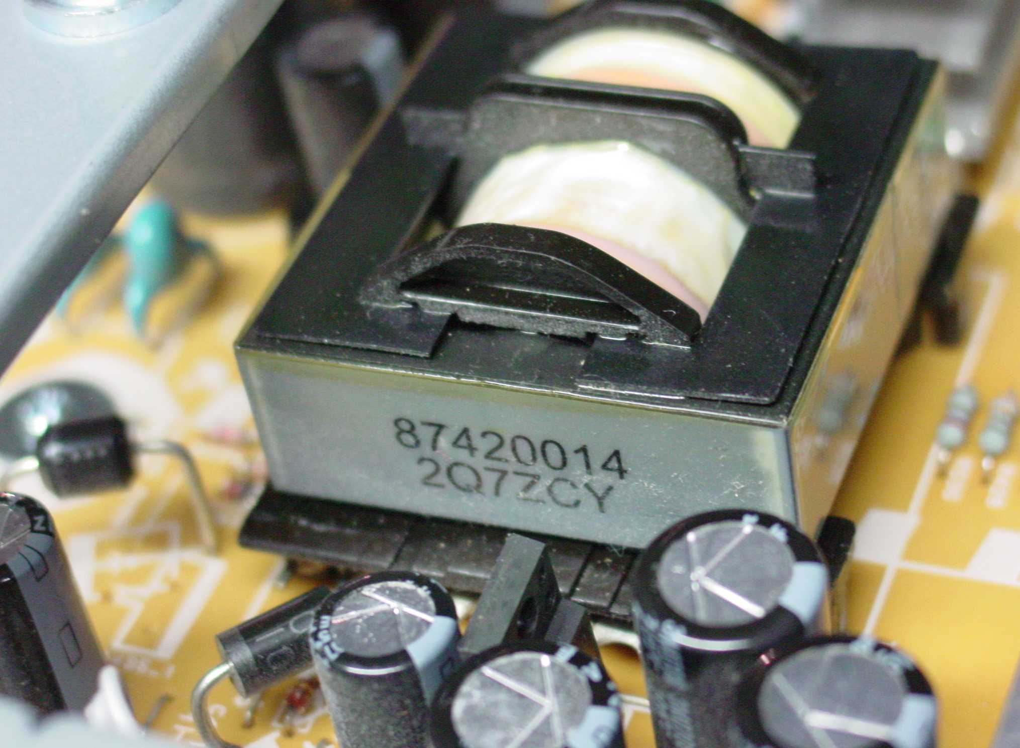

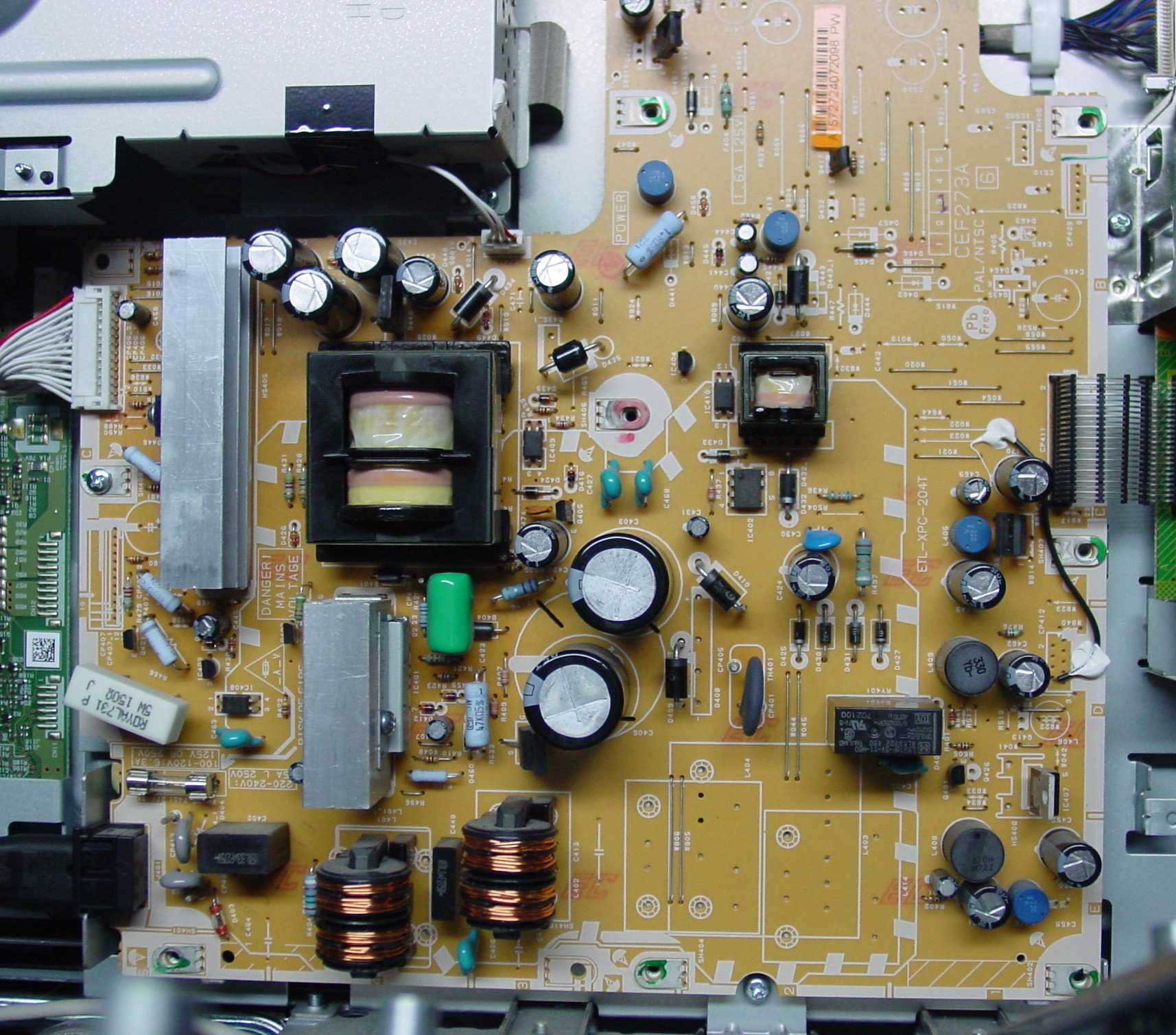

    Hi, I picked up a Sharp Aquos LC-26DV22U for $20 at a garage sale. Figured I would find some puffed up caps and replace them for $5. No such luck. I hit the power button and the light turns green on the front. No picture, backlight or sound. I do hear some buzzing noise from the large transformer on the p/s board (CEF273A). After reading that pins 1-5 on the white connector (far left) needed 24v and they only had about 8v, I wondered what would happen if I 'introduced' 12v from a wall wart. Well, I touched pin 1 (red wire) with the 12v adapter and now the TV & DVD work fine! The noise from the transformer goes away, too. Could this transformer be going bad or would another component keep it from working properly? Thanks for any suggestions.

      Have you tested the small green fuse top of your picture to the left of the yellow barcode label

        The sound I hear from the transformer is buzzing sound (or maybe a sizzling sound). When I power-on, the relay clicks right away. When power-off, there is a 10 second delay before relay clicks.

              When it doesnt come on can you locate the startup cap in the primary section maybe
              50v 68uF and see what voltage it has.
              EDIT could be C431 50v 10uF

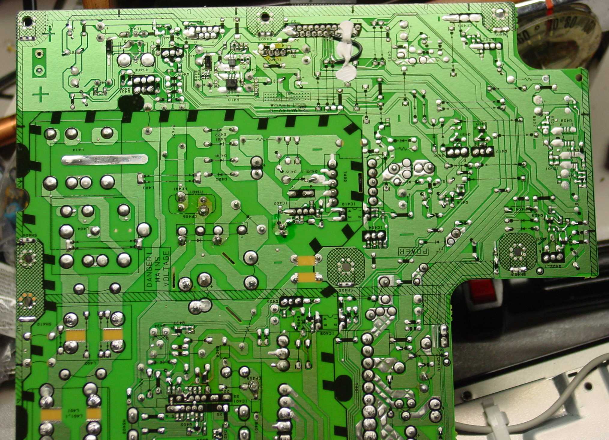

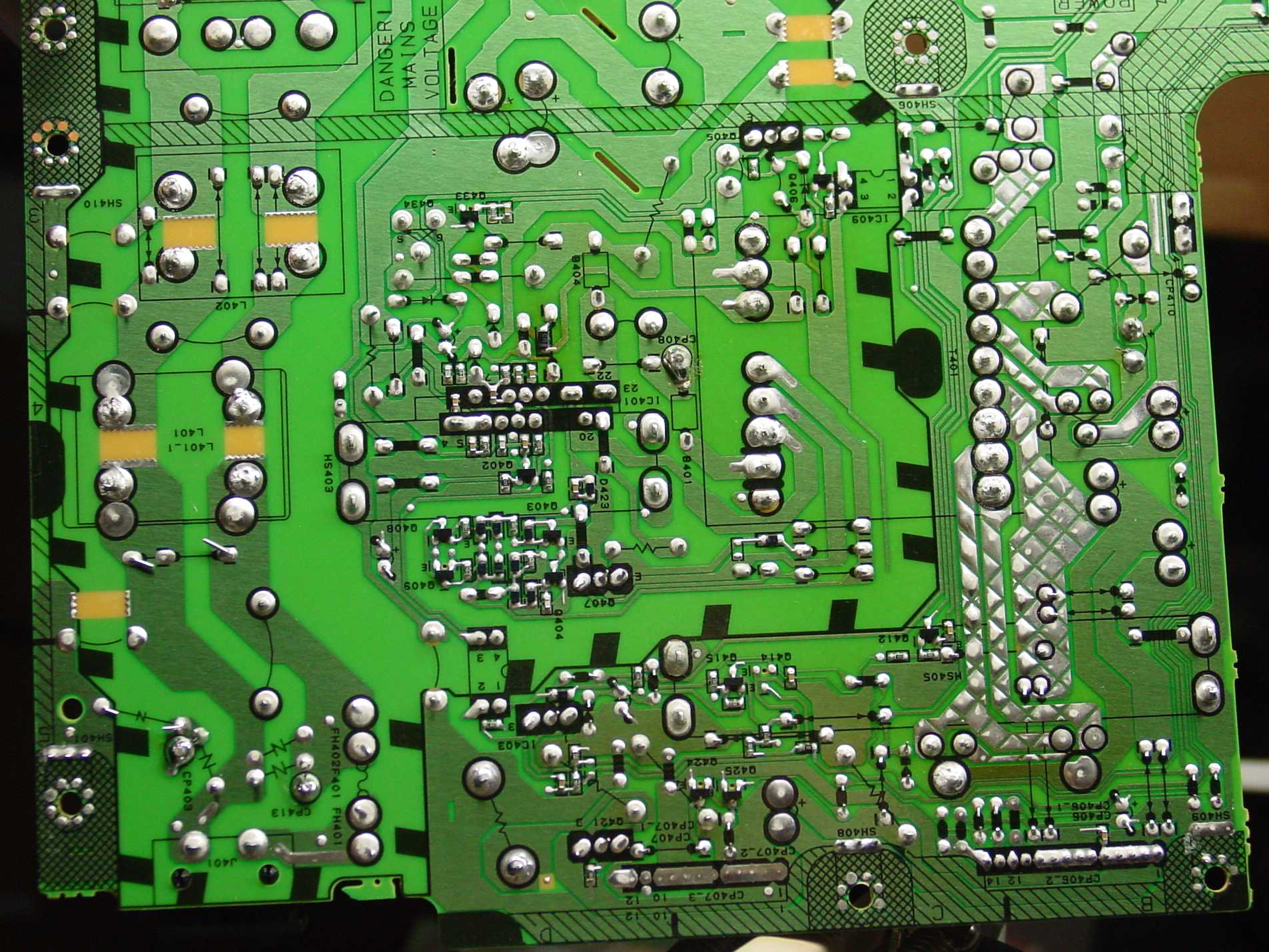

                      Can you get a picture of the back of the board - perhaps a poor joint. In fact
                      before you do that, while its in the non start stage, try just pressing gently on the board with a stick or piece of plastic just to flex it here and there- try near the connector and around the transformer.
                      You could also try gentle heat with a hairdryer
                        Re: 26" Sharp LC-26DV22U LCD power problem.
                        Well, I poked and prodded the whole board. I did notice the sound of the buzzing changed on the transformer when I prodded it. No change to voltages though. I touched each joint on the big transformer with a soldering iron with no results. I didn't try the hair dryer but earlier, I had left the TV on for about 2 hrs to play a DVD. Everything was nice and hot, but still no 25v when I tried to turn it back on. Attached are two pics of the back.

                                    Did you replace any caps?- looking at c431 on the back the joints dont look too good.
                                    What make of cap is that? There are other odd looking parts perhaps budm will identify where we should be concentrating on
                                      C431 is the one you had me check earlier. I did replace it (with no effect) and that's why the joint looks bad.

                                        Replaced it with what make/series - should be low esr - can you check the soldering - probably looks worse in the pic than it is but the joints look pretty close together and the trace looks a little lifted.
