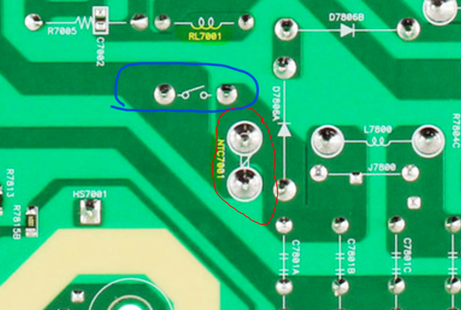

    I just picked up a Sharp LC-80UQ17U here in Denver on Craig's. The previous owner said he was watching it and "pop" it stopped. Opened it up to find a blown fuse on the high Voltage side of the PS. I bypassed it with a 7.5 Ampere automotive fuse and saw a flash in component NTC7001 (as the fuse popped). I am not going to try to apply any more power to the board until I can locate a schematic. Does anyone have the schematics to RUNTKB217WJQZ?

        It would appear as though some sort of schematic is on the back of the board. Is it safe to assume that these boards are single layer? Sorry for the DQs - I did avionics in the Navy but never at a board level. Click image for larger version

          Okay so here's a question for the experts. RL7001 on the back of the board (HF12FF marked on the relay package) is showing 300 Ohms or so on the relay coil but short across the switch contact. The datasheet for HF12FF doesn't show if its normally open or normally closed. The icon on the backside of the board shows open. It just so happens its adjacent to NTC7001 that gave off a small flash when I did my "fuse testing". Anyone have specific knowledge or experience with this part? Click image for larger version  Name:	HF12FF.png Views:	0 Size:	1.15 MB ID:	3218674

            "The datasheet for HF12FF doesn't show if its normally open or normally closed."
            Sure it does. It shows a normally open diagram, and the switch contacts will be closed when the coil is energized.
            If you measured almost no resistance (0 ohm or exactly the resistance of your probes being touched together) then yes, it is shorted.
            Most likely because the contacts have fused together, or just simply stuck. If stuck, you can try applying 12V DC to the coil and check if that will make them unstuck, if not then replace the relay.
            Also, it is recommended when working with power supplies to use a DBT (dim bulb tester) so you won't end up with components blown to bits when there is still a failure in the circuit.
            When the main fuse is blown, what you need to check first is always the bridge rectifier in diode mode, then the semiconductors in the primary side (more diodes, transistors or mosfets)
            After the primary side is confirmed to be ok, then you can move on to the secondary side where the low voltages are.

                              On the relay contacts there is a low resistance thermistor in parallel for a soft start and it seems to you that the contacts are stuck together.

                                I think that is true too. But I cannot source the relay so I sent the entire board out for repair
